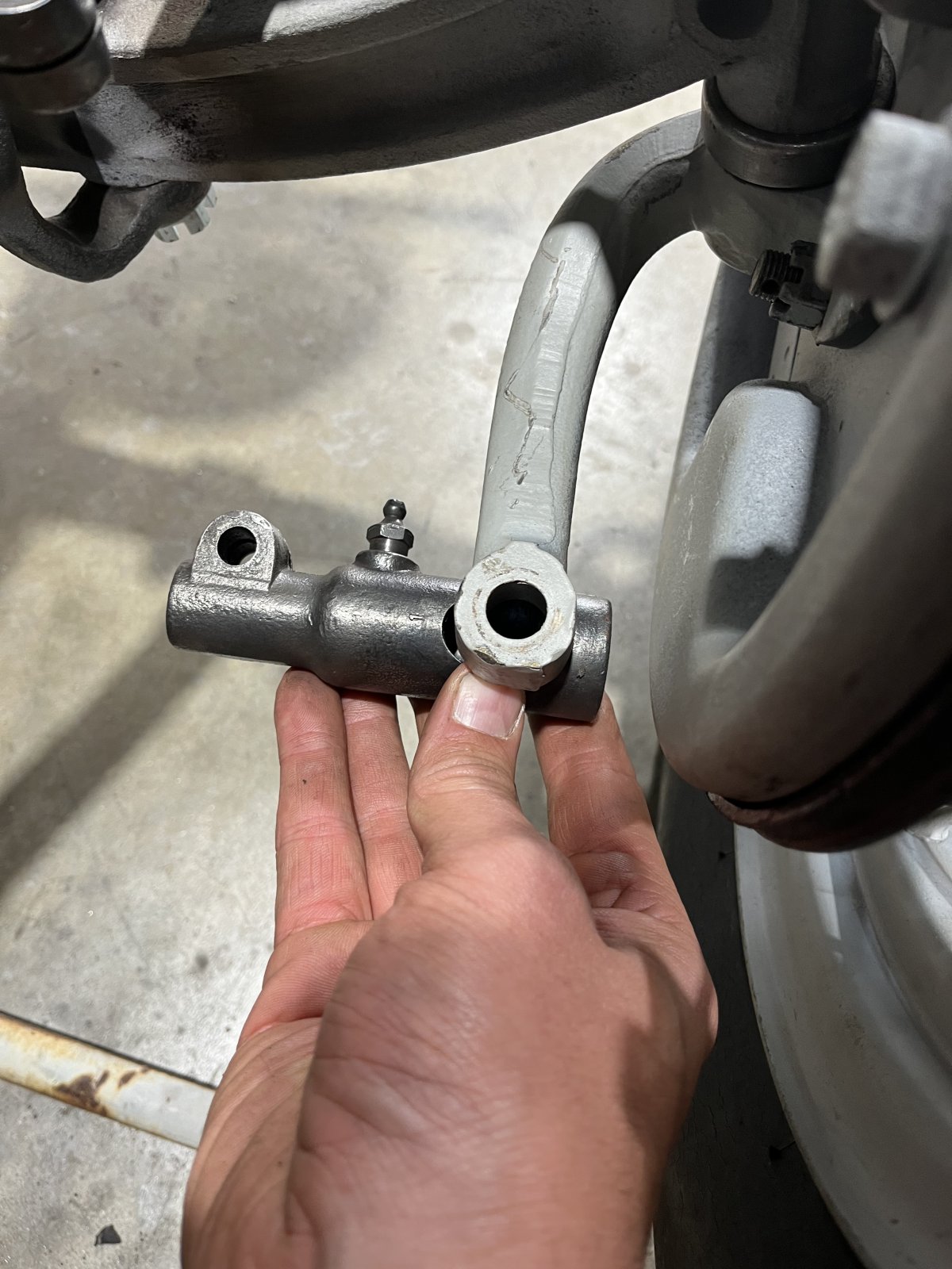

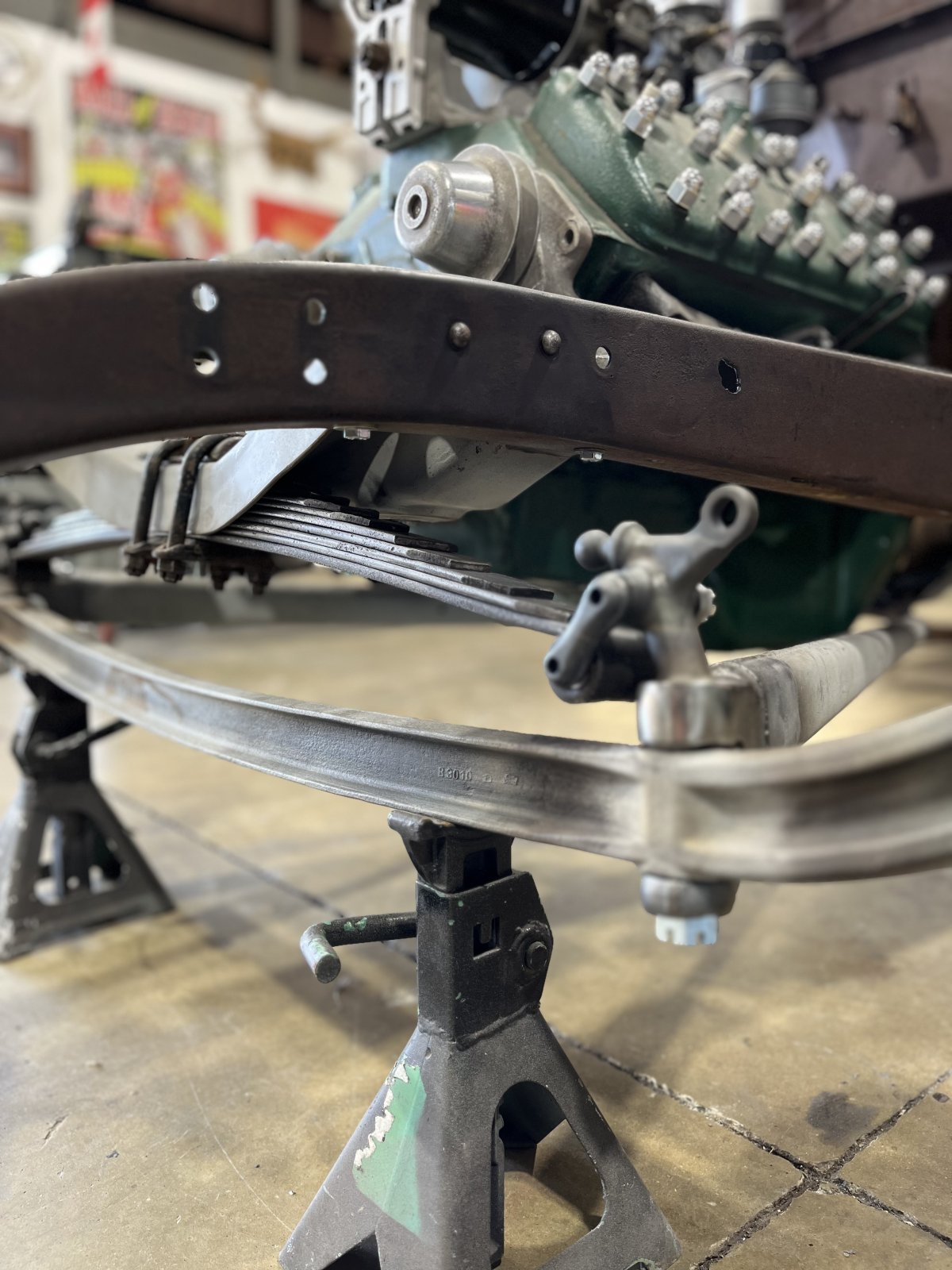

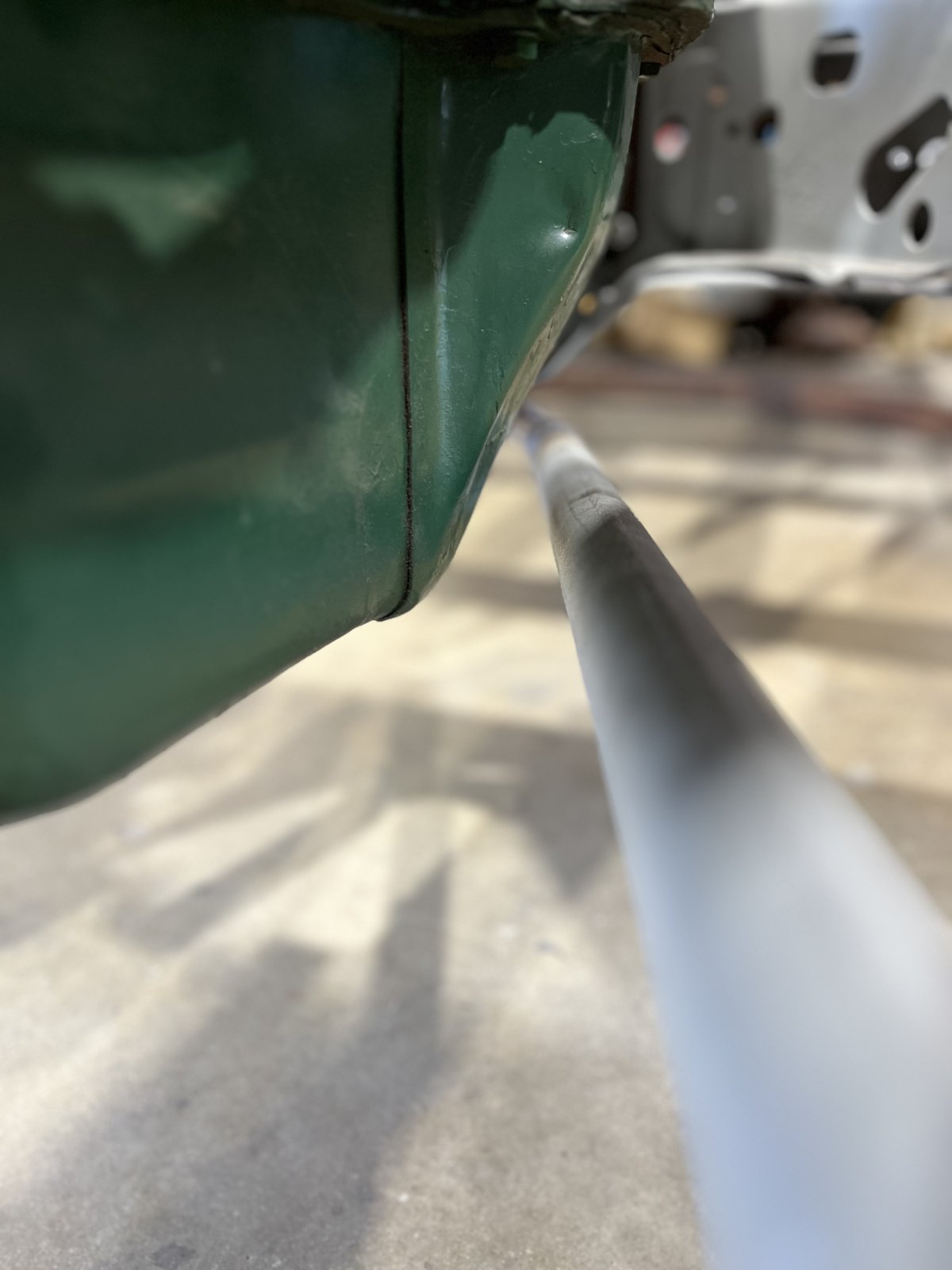

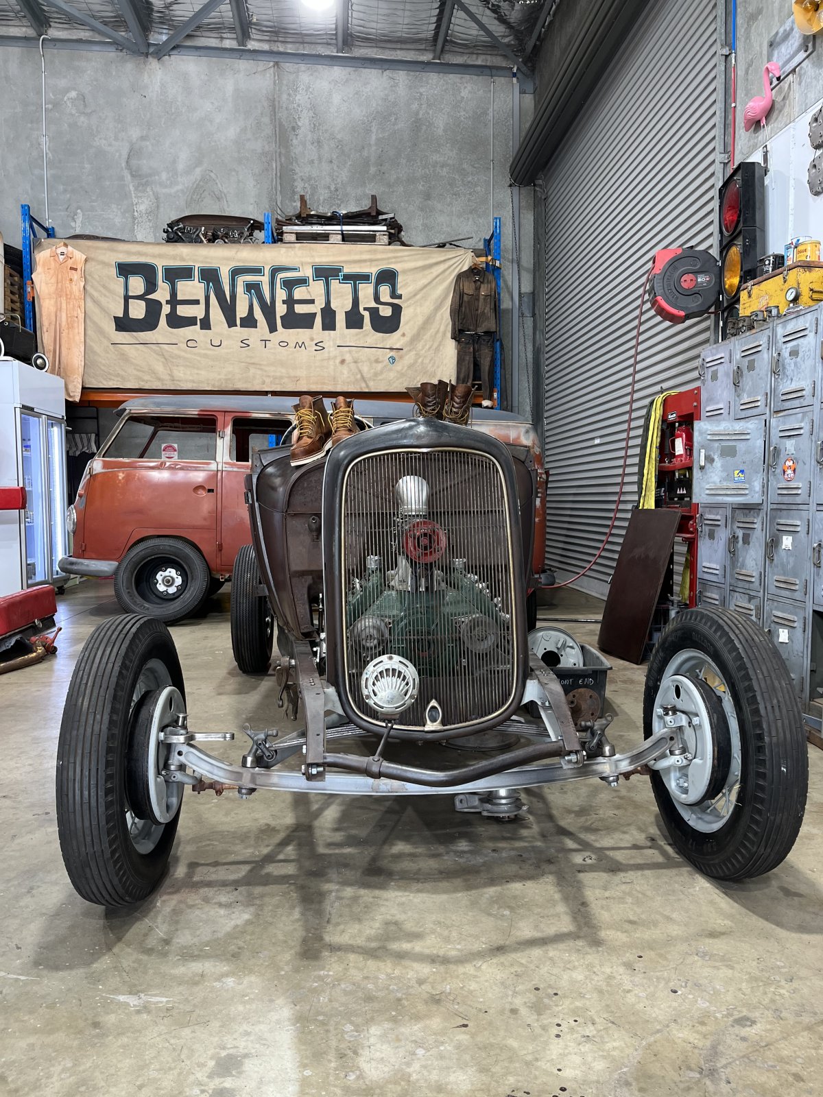

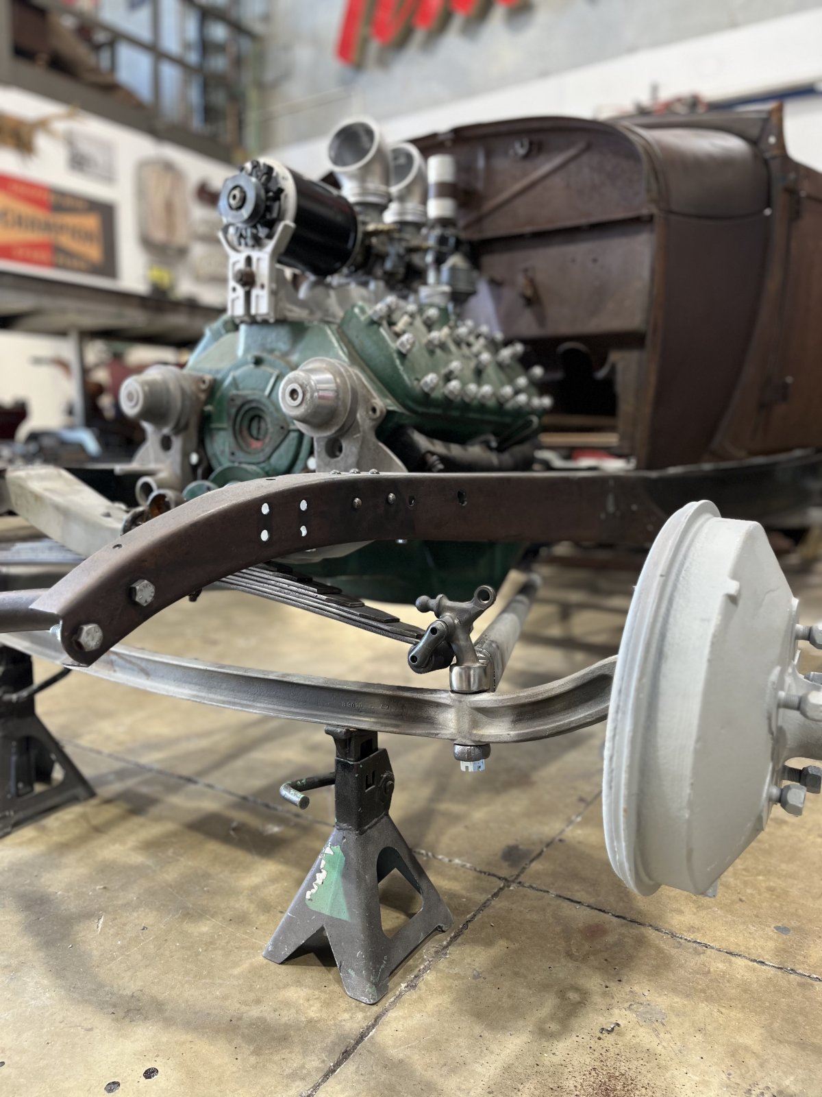

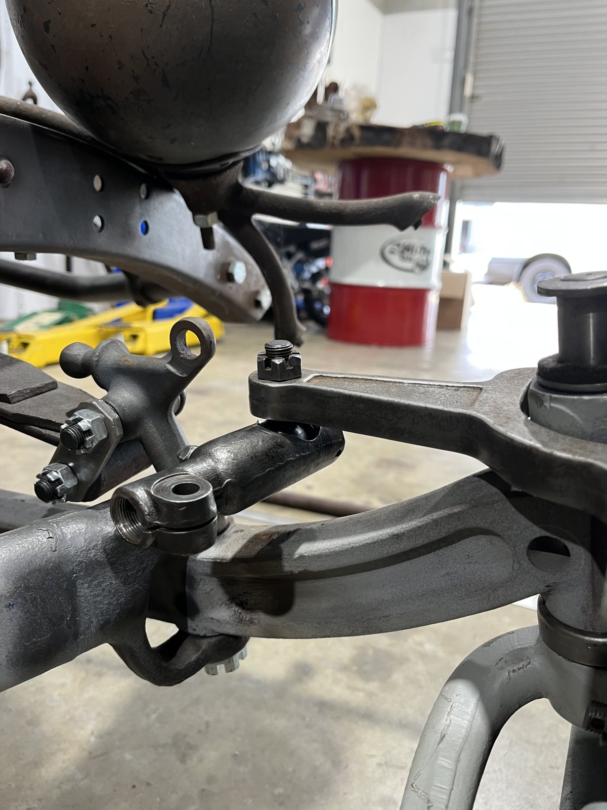

  1. yeah it’s a later one forsure, I haven’t tried this one yet but the smaller one didn’t seem too work, clamp bottomed out and still has slop
  2. Still sussing out the ball. But it’s bolted in for mock up. I removed a few leafs, and will changed the model a perches to 32 ones but it seems to be working! Another step closer! CB28B808-8381-44F6-8D8D-99F783A2D29C.jpeg 0ED3B78D-9F16-4076-BD7E-7322DC5056EF.jpeg D563C544-E9E2-478F-B628-B7B6FC402067.jpeg 40495730-6233-455B-A259-2B183FB7847B.jpeg 4CAF2B6F-B6FF-4CEA-BEB4-629578F673D1.jpeg 91641040-8EB7-4CA5-A917-51FB5EB1E7FA.jpeg

    Can you get a nut on the perch? Might need to deepen the top bevel on the late wishbone.
  4. N
    just A few threads, I’ll swap these model a ones for 32s and should get better purchase
  5. Stovebolt
    Joined: May 2, 2001
    Posts: 3,661
    Stovebolt
    Model A and 32-34 perch bolts only have enough thread to run on 28-32 bones. 35 and onwards are thicker and require longer perch bolts
    Big Al likes this.
  6. I just figured this out too, I might have to take some off the top of the 36 bones to get some more thread through

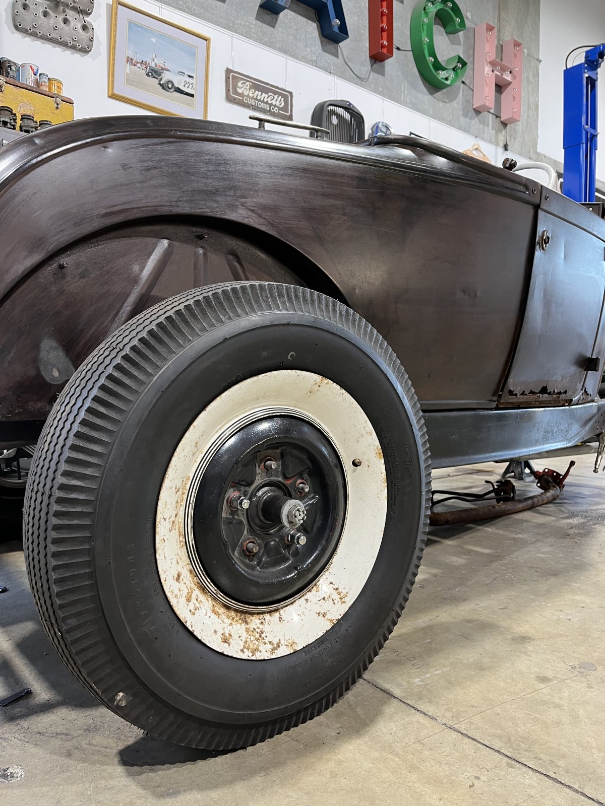

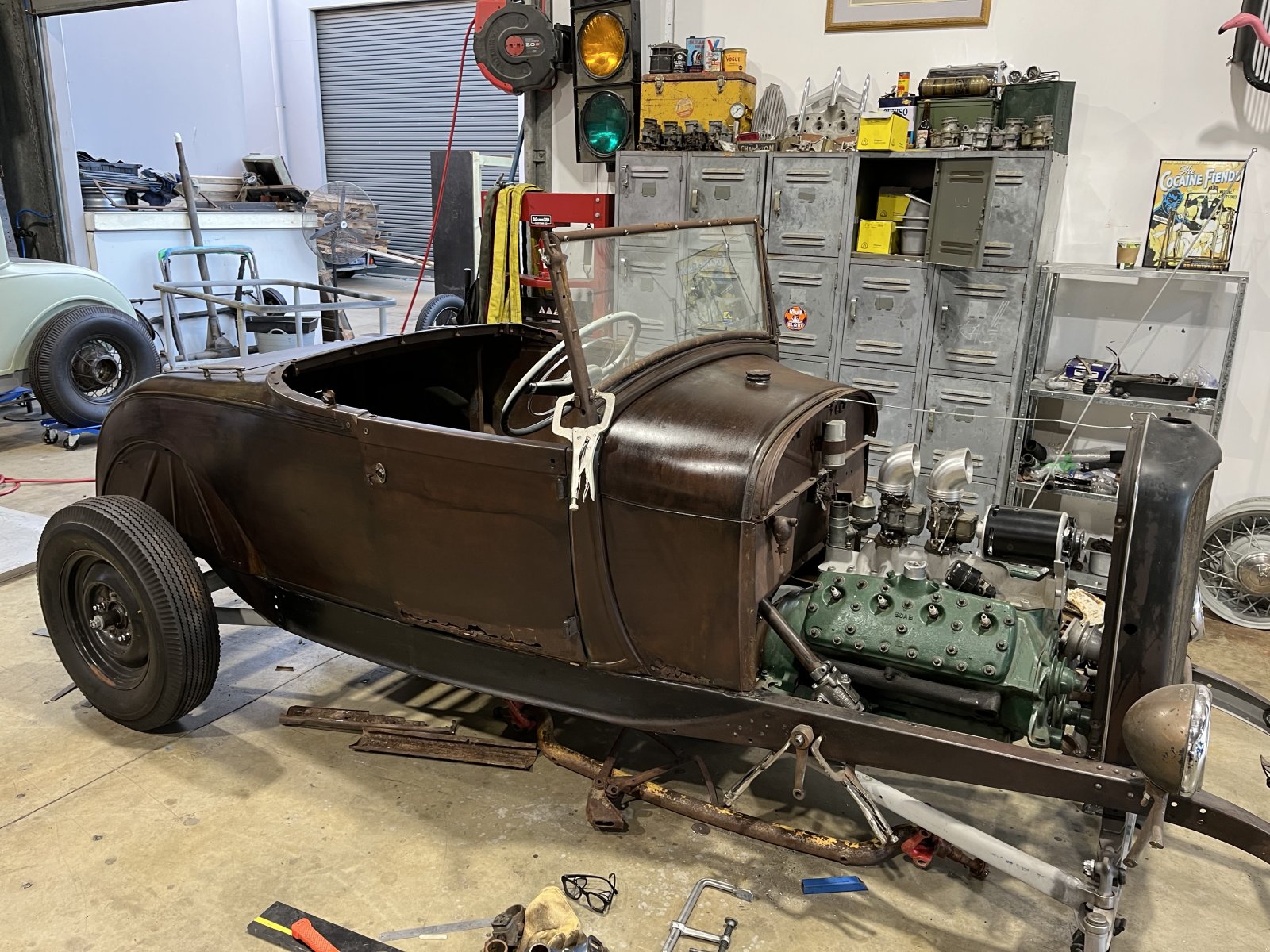

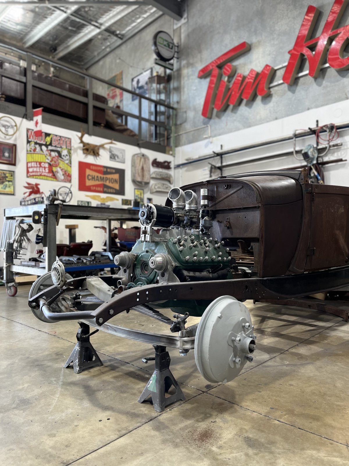

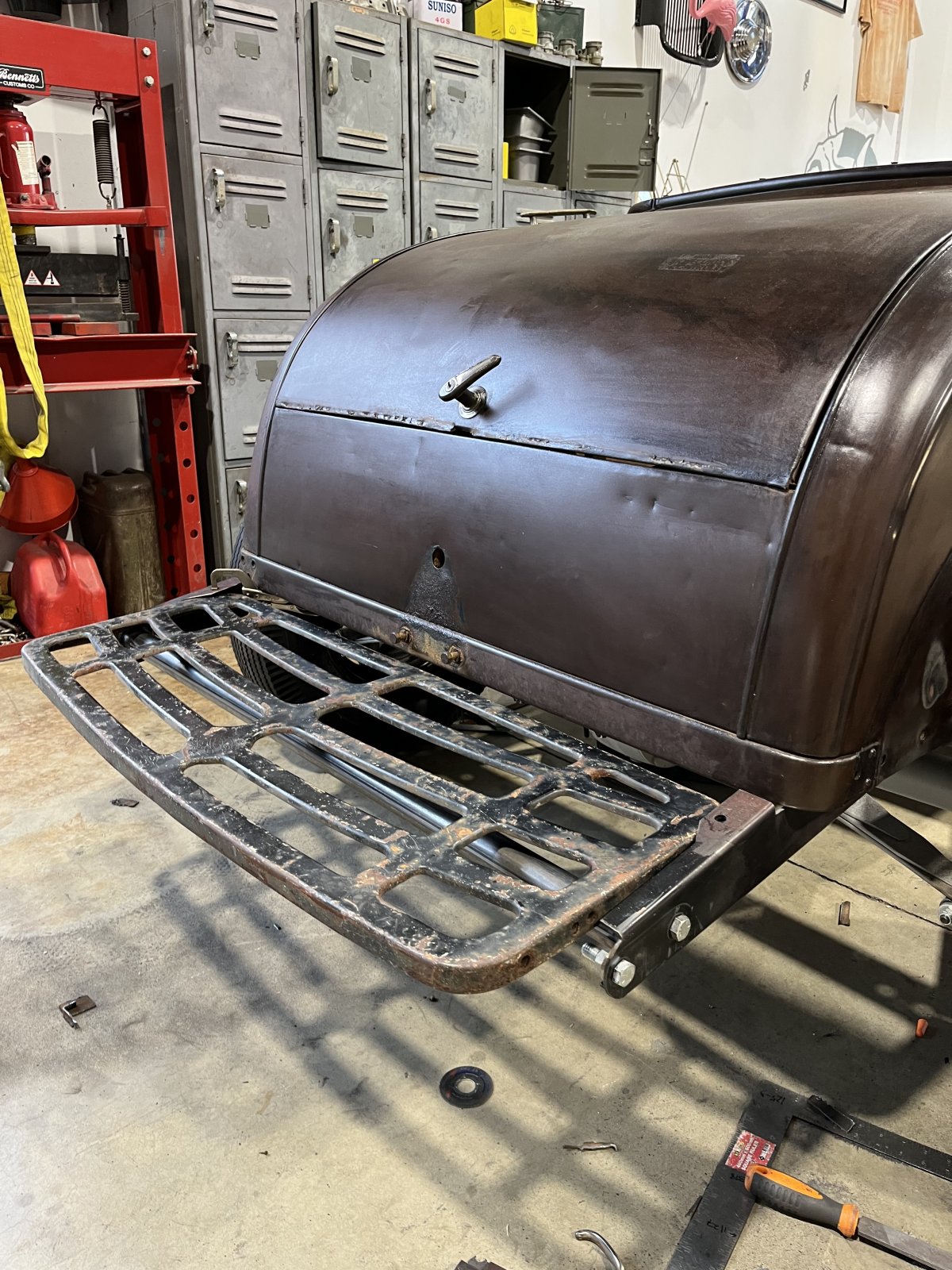

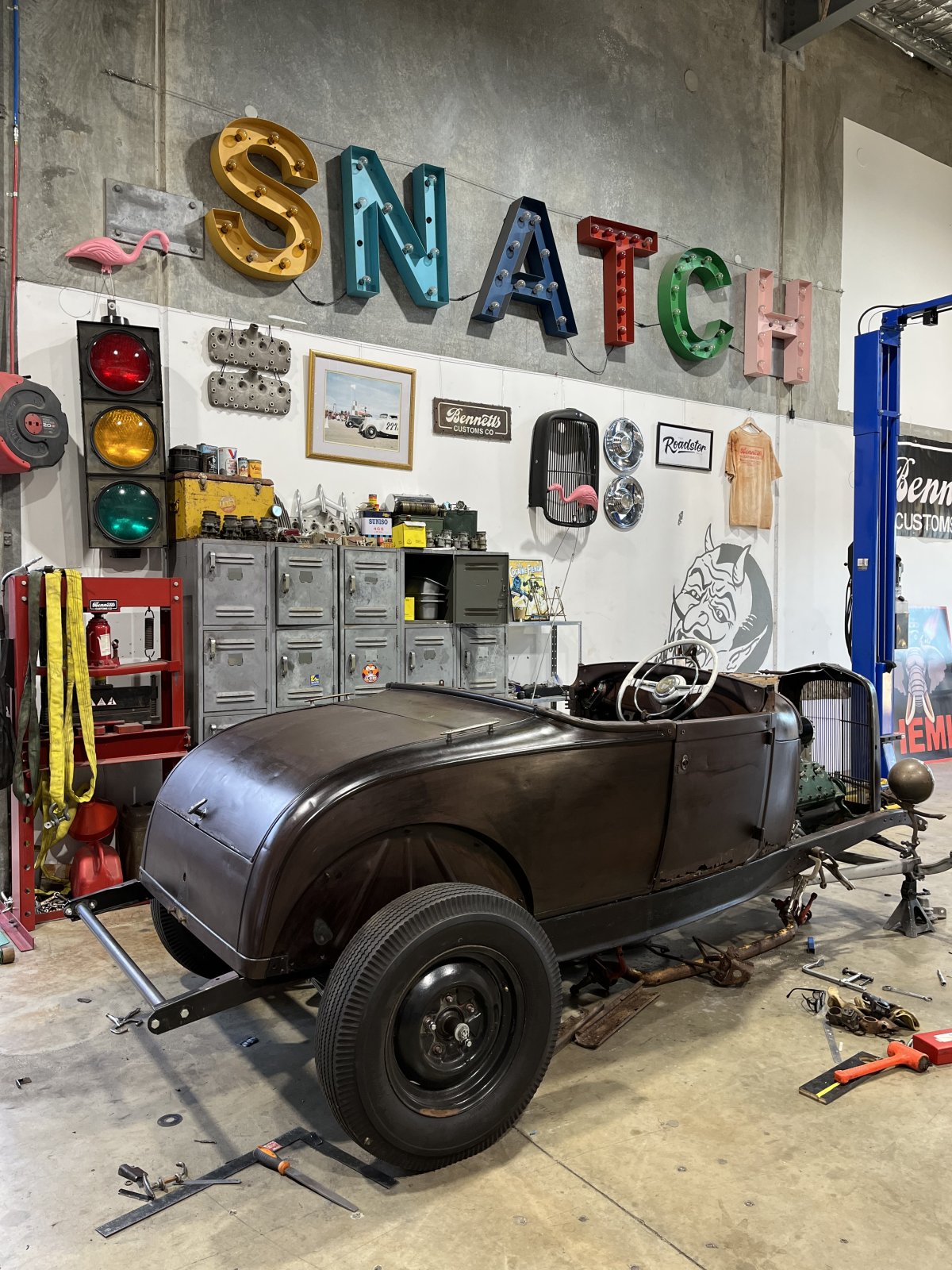

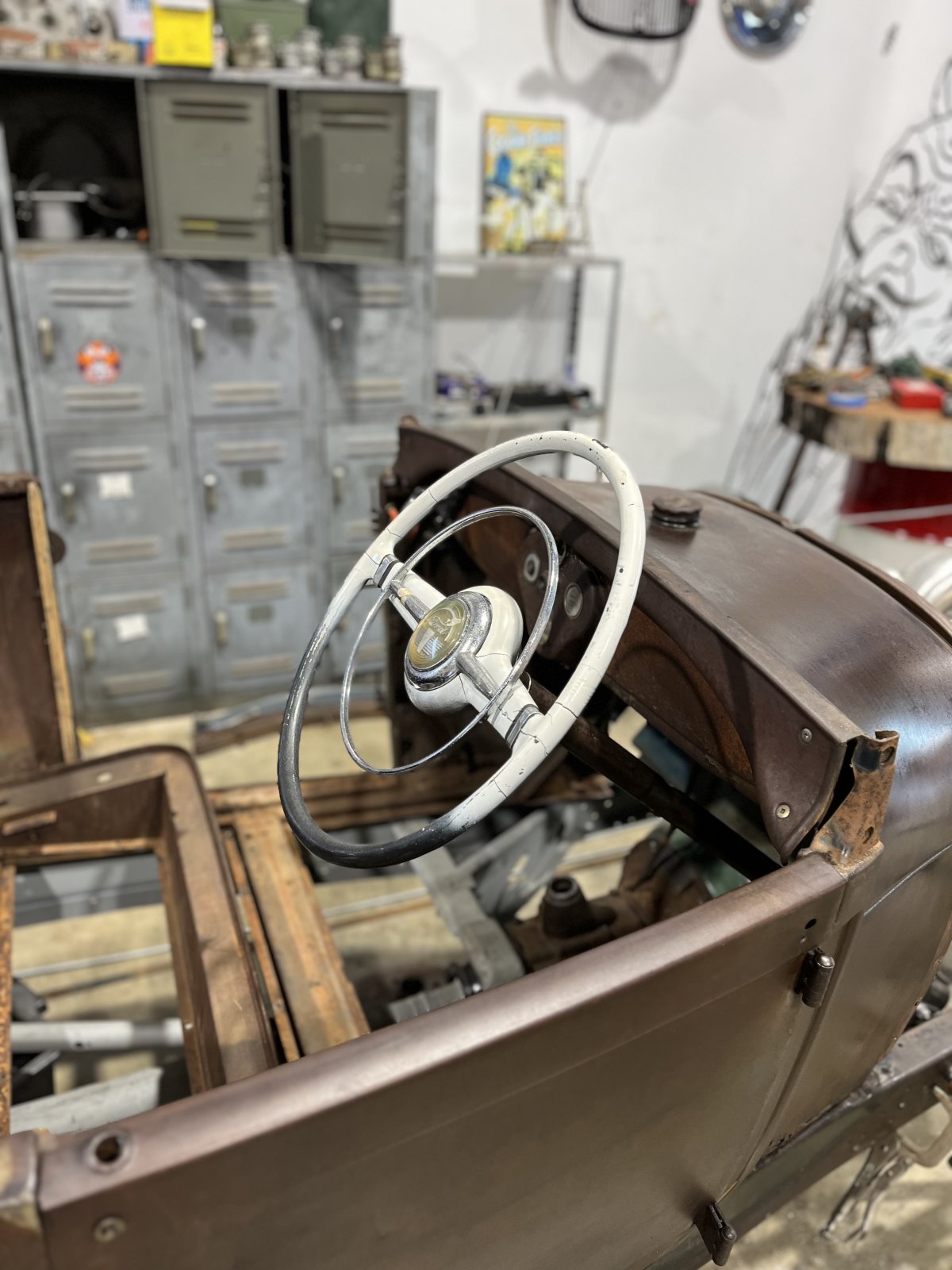

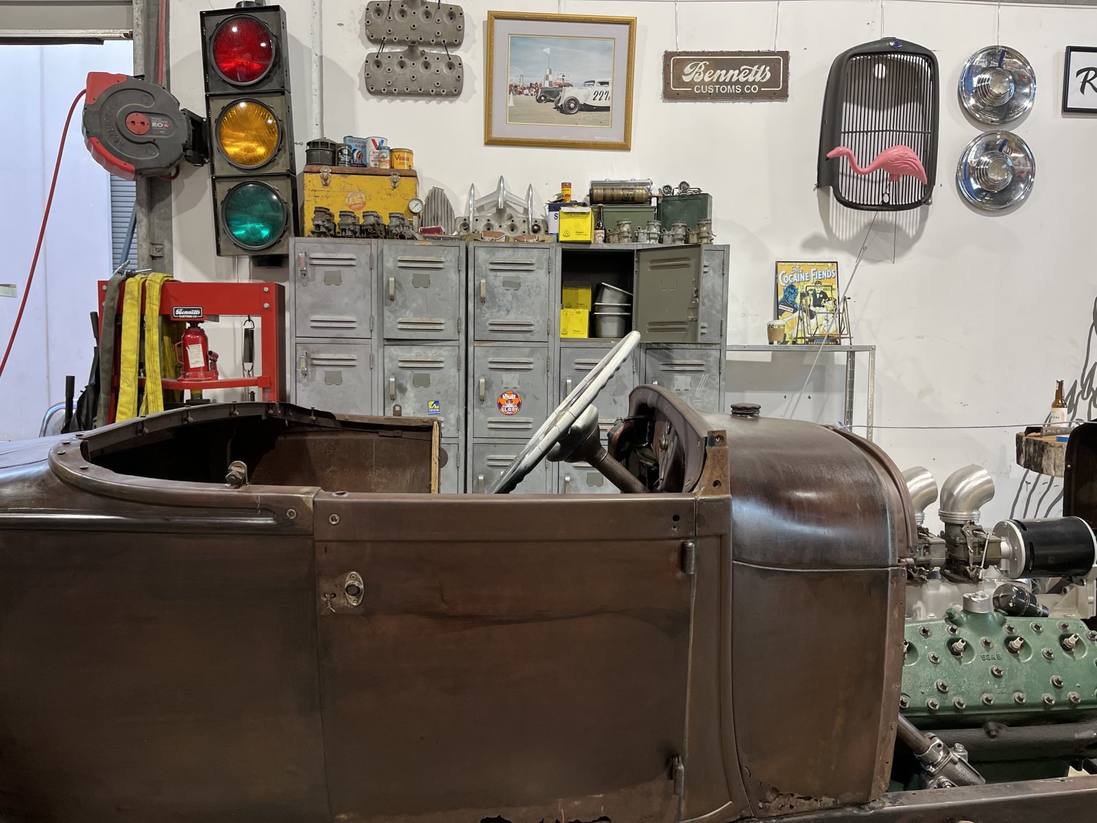

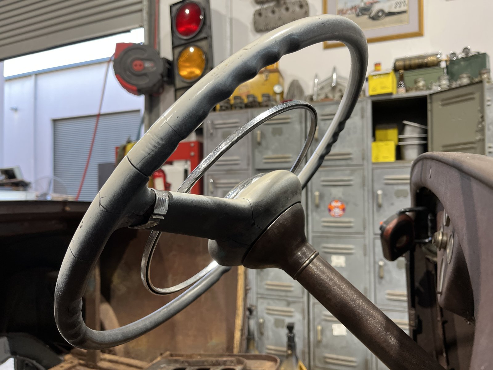

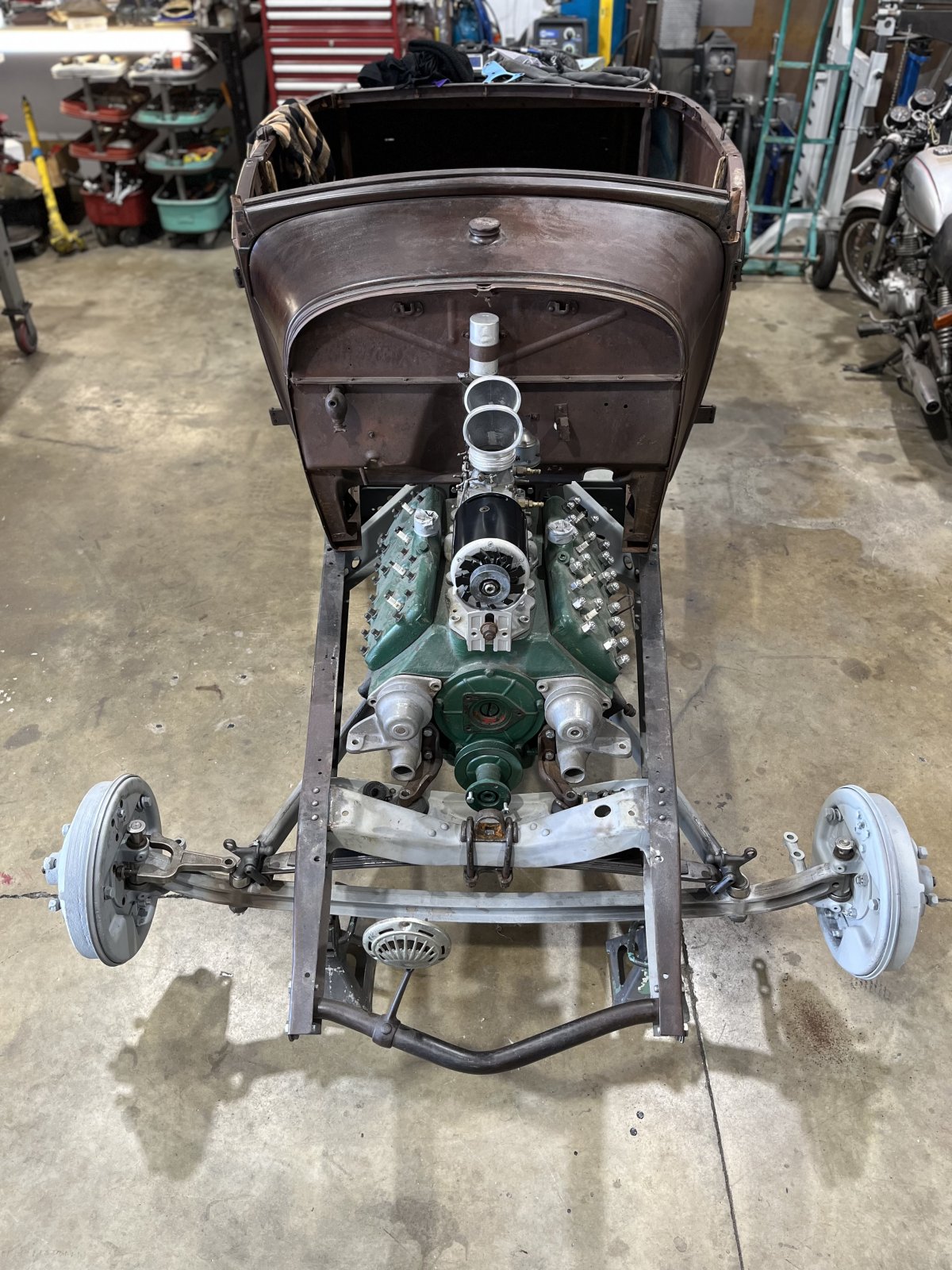

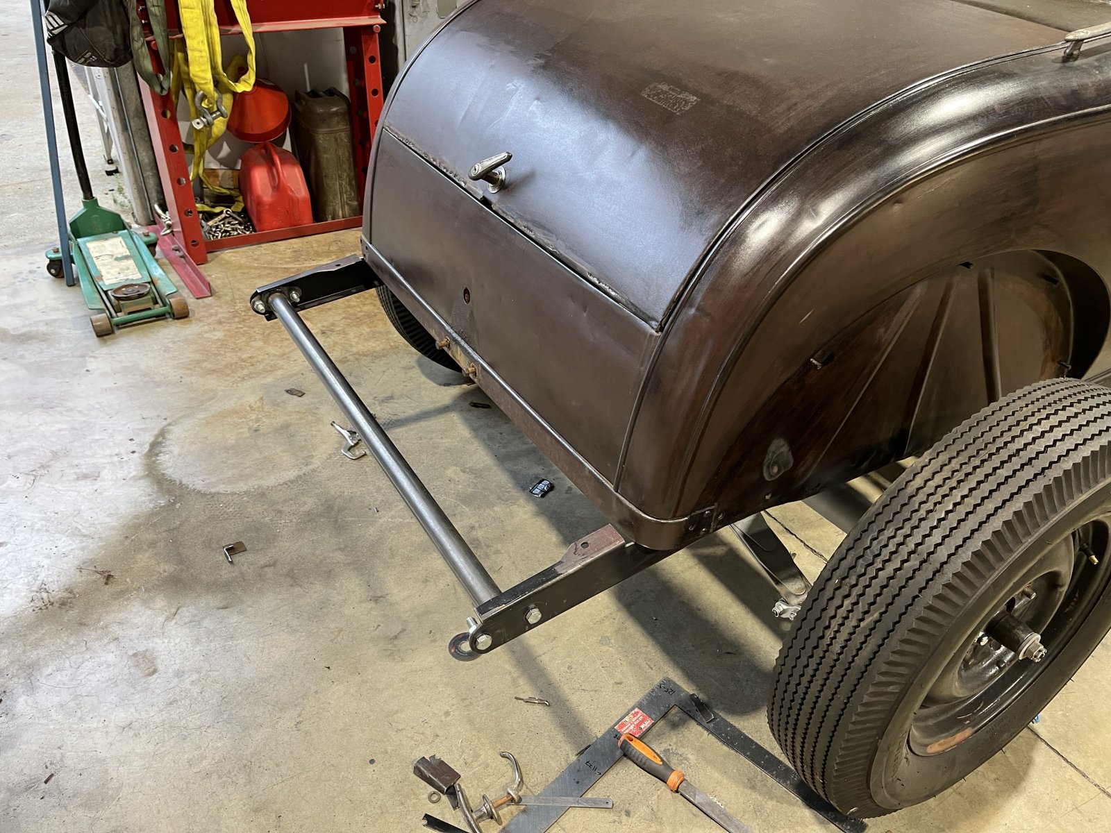

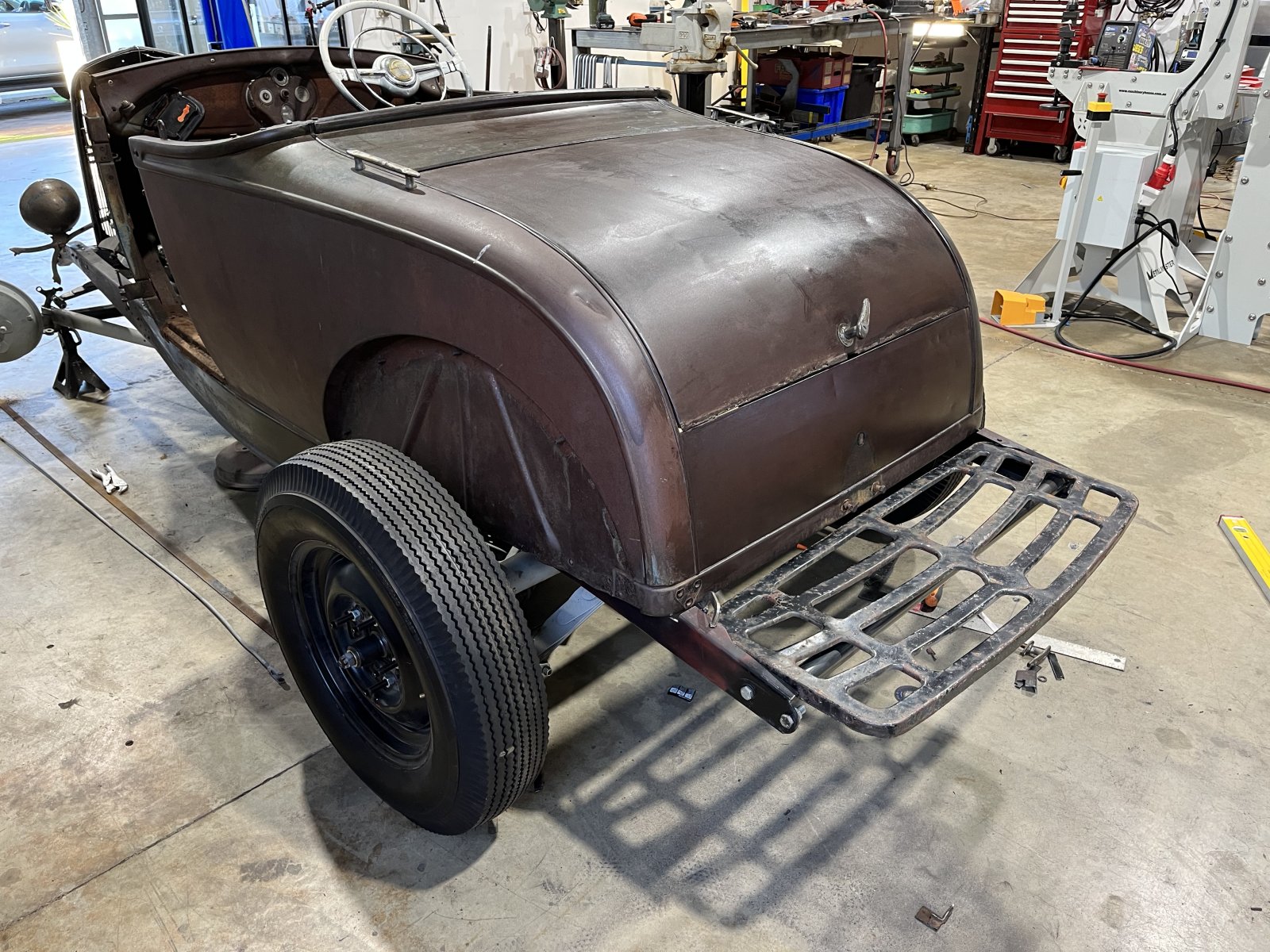

  9. Little update! rear mock-up wheels on and will continue to finish off the front to get it on all four wheels, the body is sitting level on the frame. Karl started to fix the very badly damaged door, I started to install the 32 box, made a coloum and got the wheel installed. Need to make a coloum drop next. And figure out where the seat will sit to get the pedals figured out. 7.50 rears will replace these and either a 5.50 or 6.00 (pictured) for the front.
    I haven’t decided what to do with the rear frame rails. I seem to like them but at the moment they will stay until further notice- I do how ever line the idea of using this 36 Chevy luggage rack for road trips and loading. FAB228E8-08E1-40A8-9677-B9A7FB8E45E8.jpeg D7E2CC42-368C-40B9-BF7E-FC974823D0D1.jpeg 53F6DC94-4D59-4607-BB8A-C17ECE1B9045.jpeg EB23A354-1D64-487F-A112-052DF136D0CE.jpeg EFCFD0BF-BC62-43F1-92AF-93F7E6FB5DE3.jpeg AA8773A4-3440-486C-AA24-F62E0C2970C3.jpeg 49A32471-EE79-4FC8-A8B0-A4F3245AB0E7.jpeg 01E43676-5C09-43A9-9653-90930A131A20.jpeg BDF4A582-BB29-4F51-B874-D786A47AFA05.jpeg C796242C-23CB-4C44-95A5-3E8BFB8A08CF.jpeg FE8B234F-19AB-4DA3-82CF-F57CFC181109.jpeg 168A6C47-6E6F-46BE-9D56-D98880F74D8A.jpeg 5DEB9180-B26A-4C44-9DB4-3F5A93FE8EB4.jpeg AE59CB6A-3303-460C-AE42-0387FA23DC25.jpeg

    Posts: 2,175
    Mark T
    You put the steering wheel on the wrong side.
  11. ****** aussies.

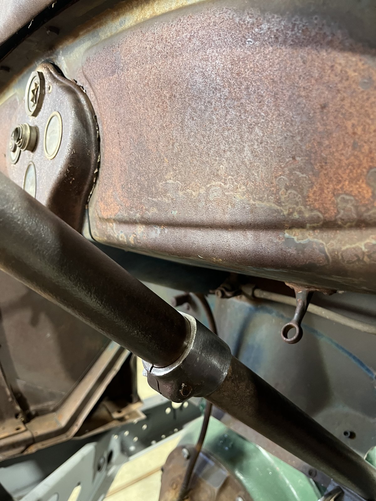

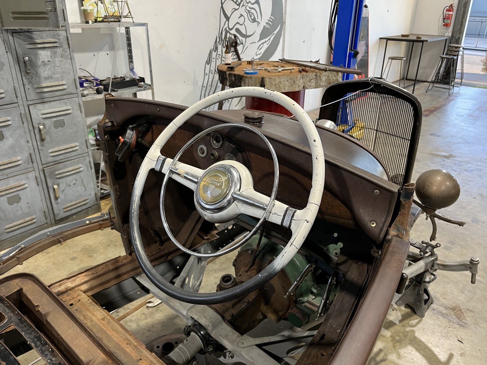

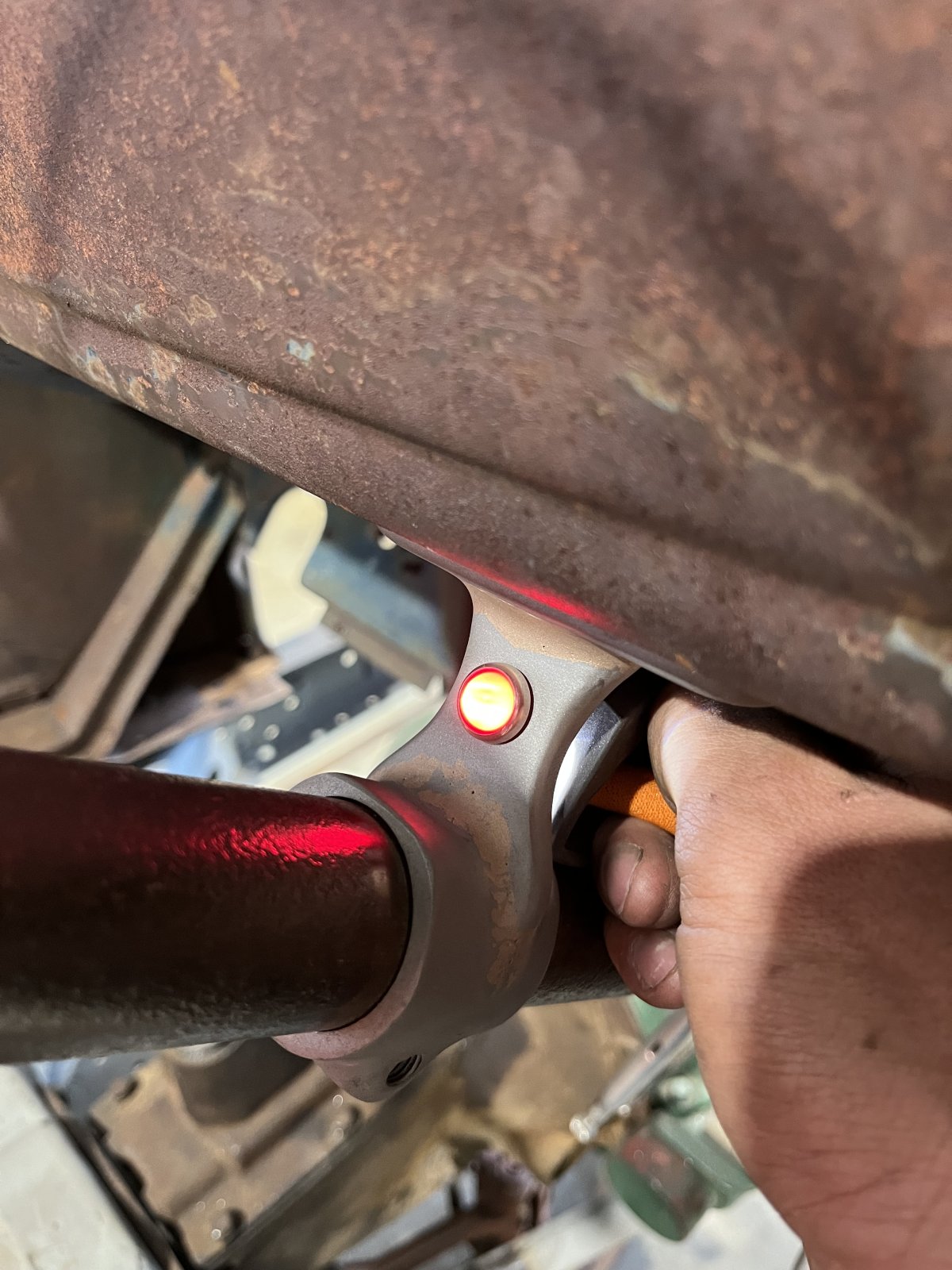

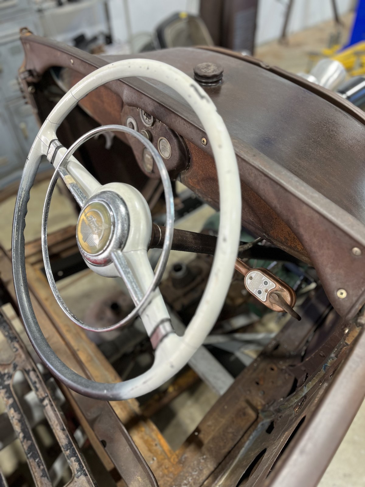

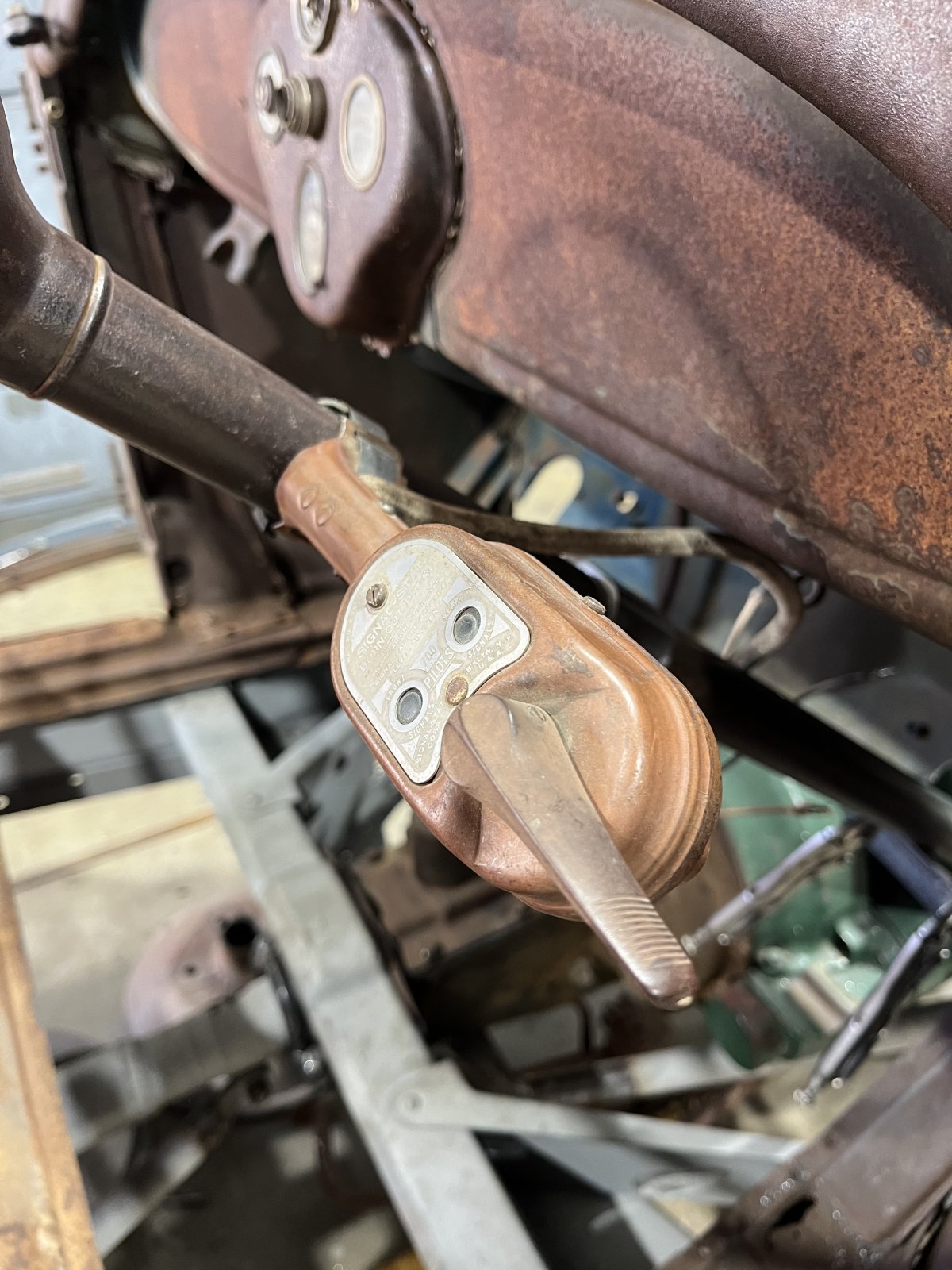

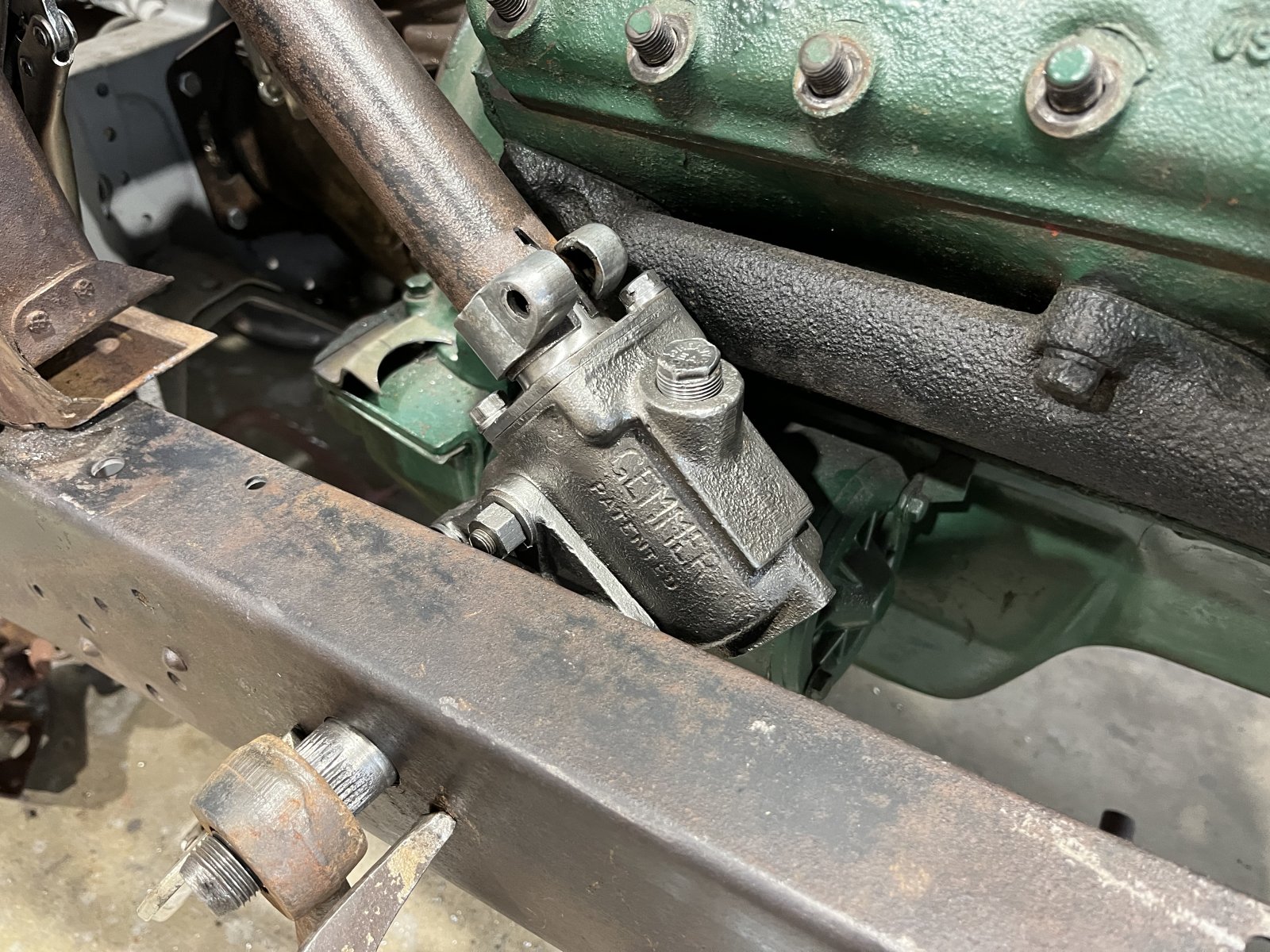

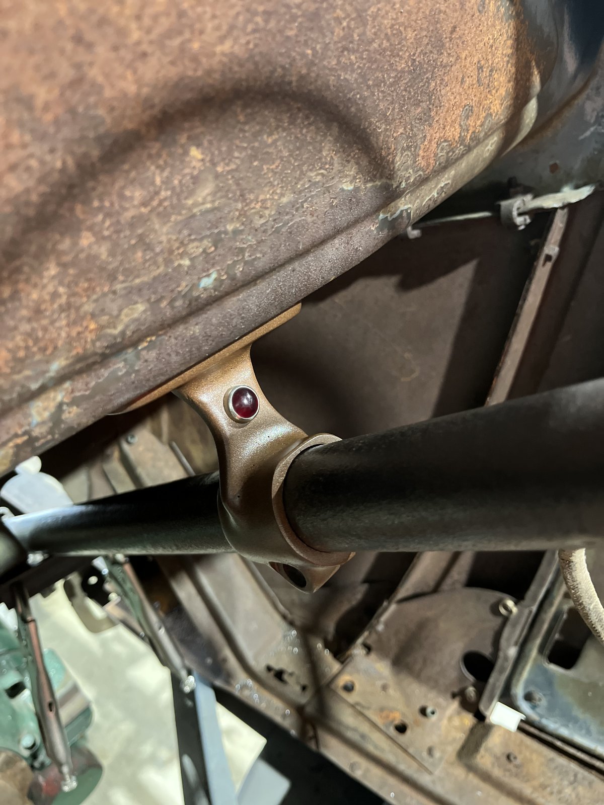

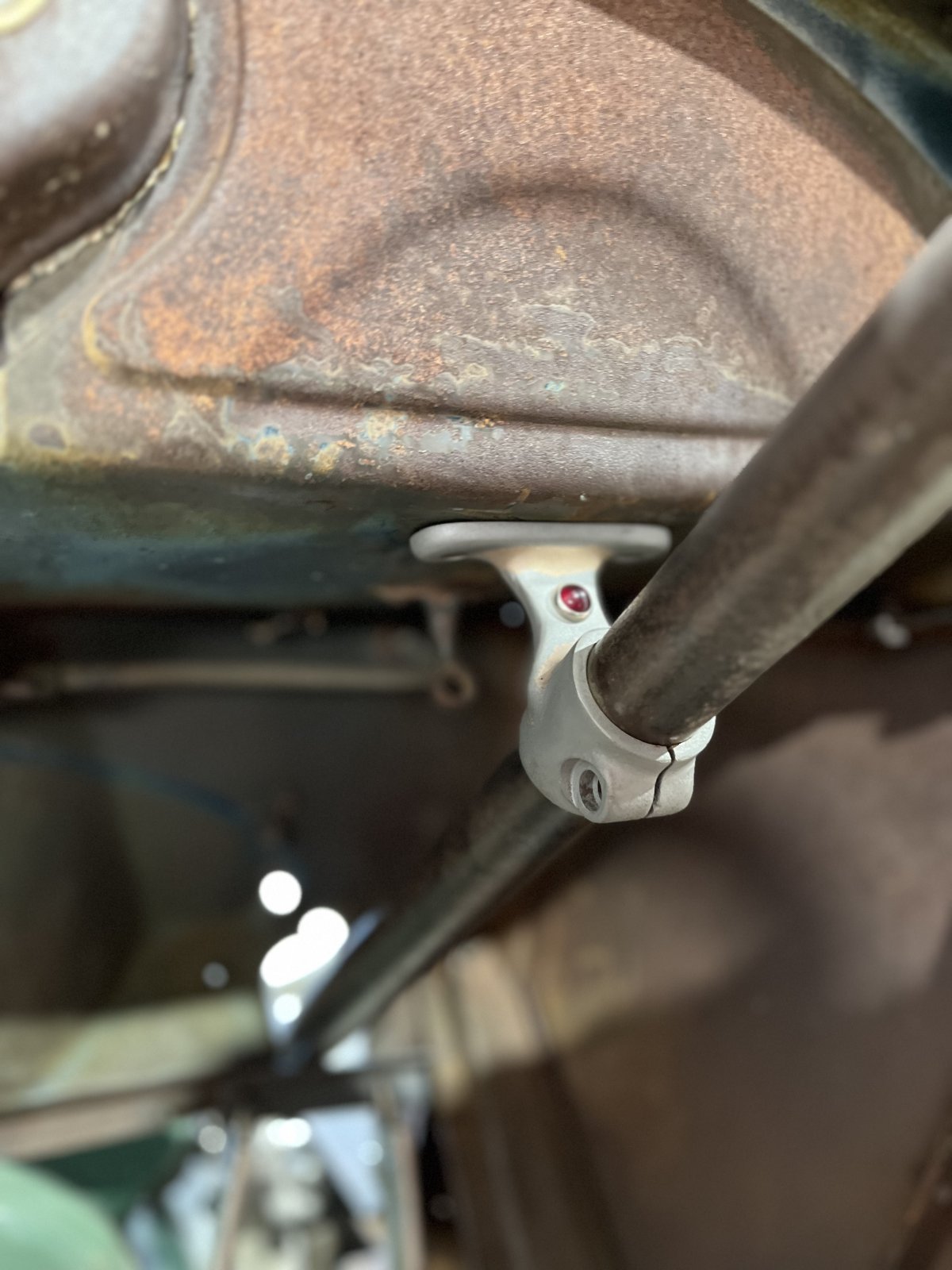

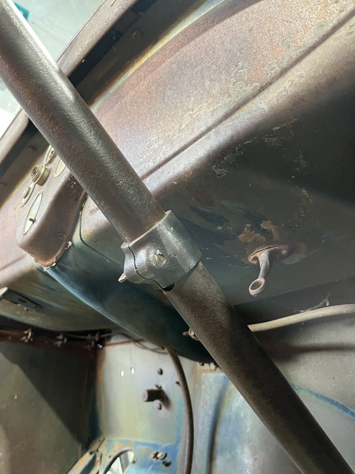

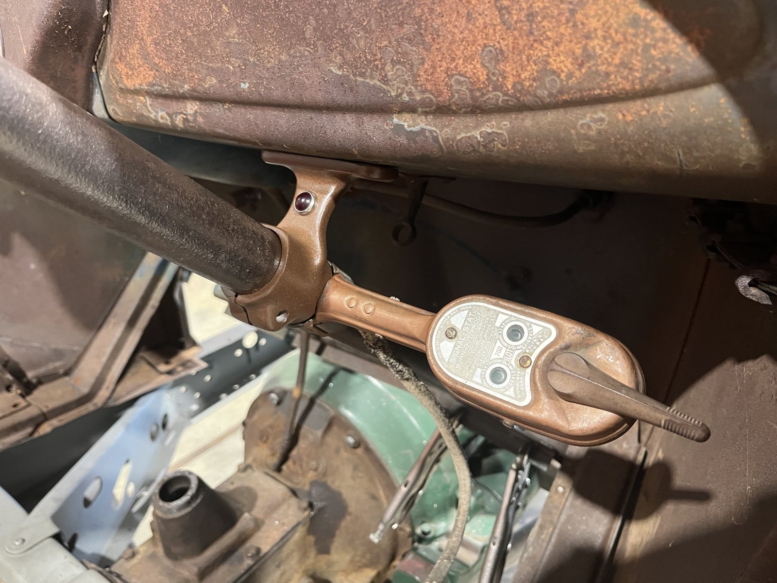

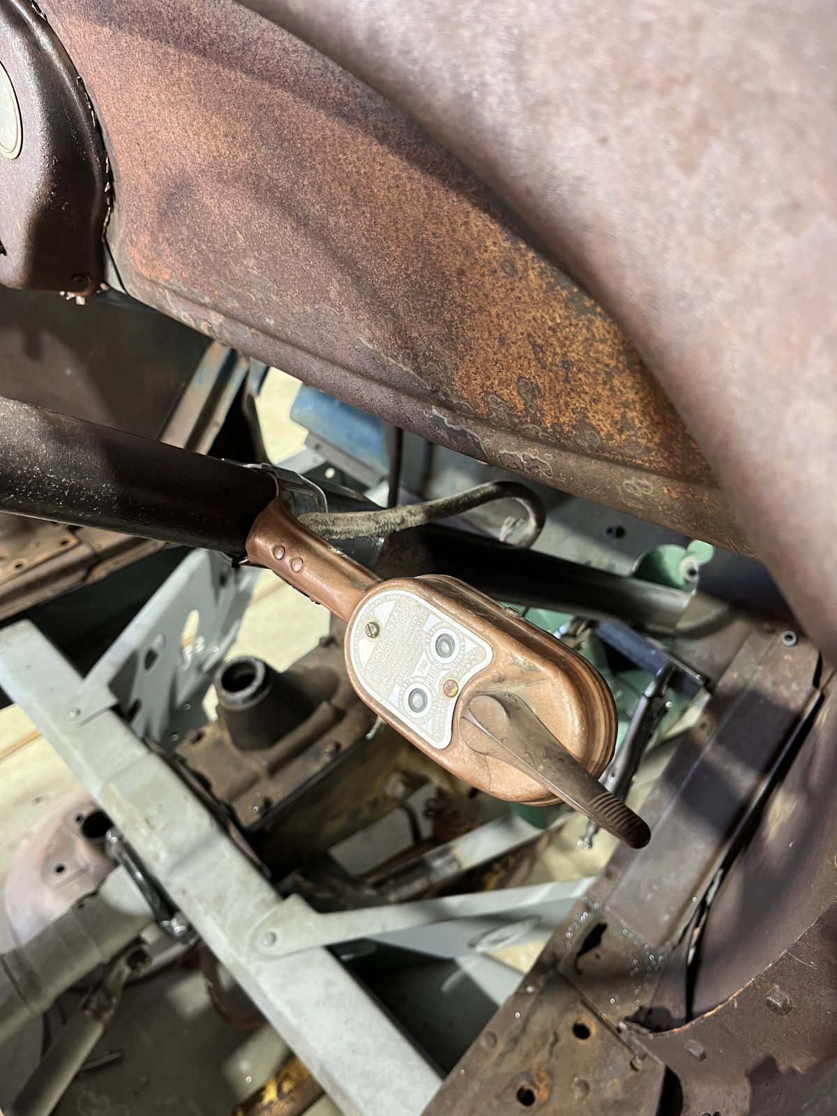

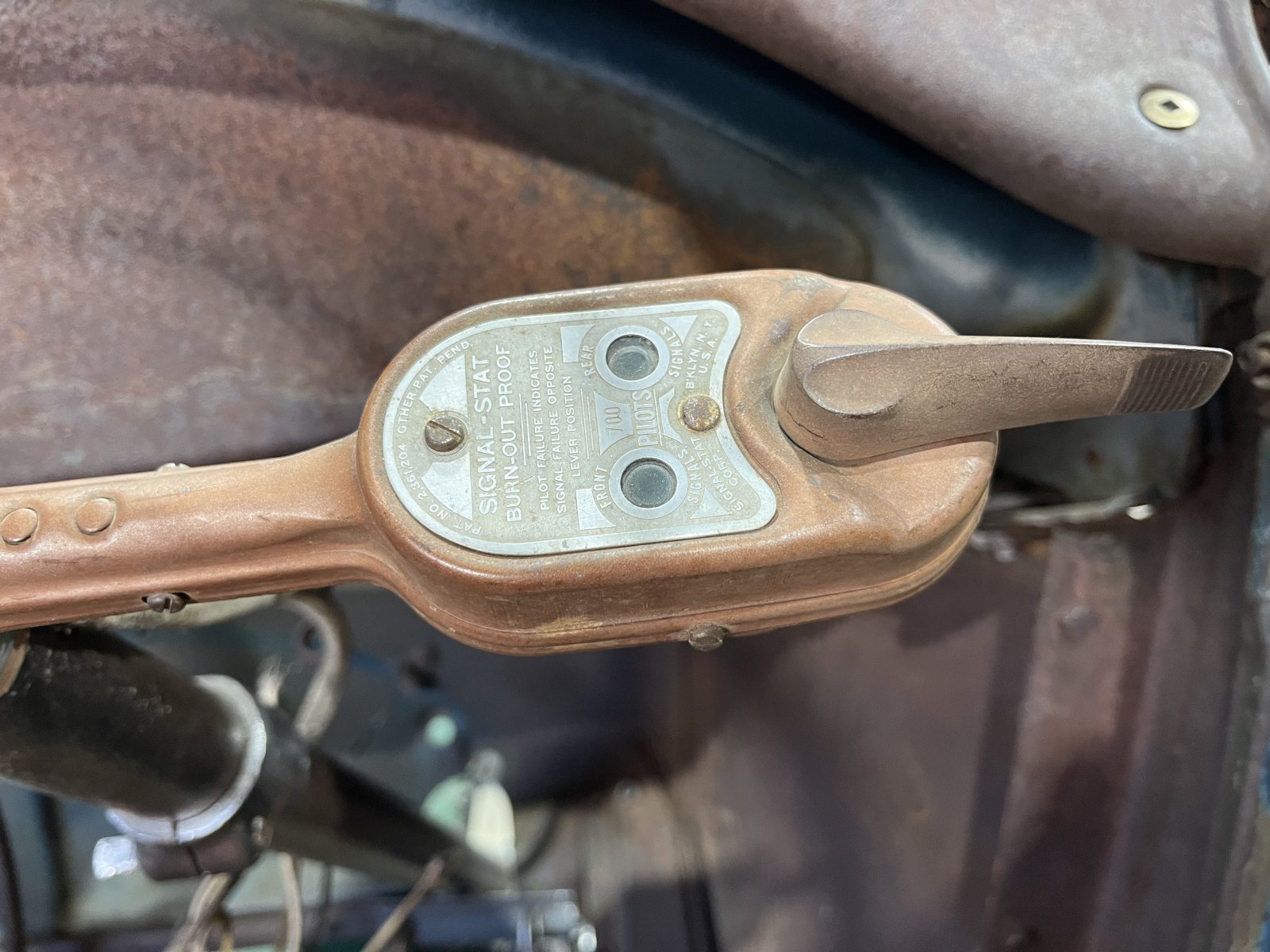

  14. Getting the measurements for a coloum mount, fitted the signal stock too. Nice old clean Signal stat 700. Suits it I think’ 916C61E5-9520-41A5-AD15-578B8D92947C.jpeg A5ECF995-70F7-478E-9550-9E310200CB39.jpeg F9F807B2-585F-490D-8544-044348637856.jpeg 97B1E251-67D4-4C26-B6AB-1ED02D9D2CAE.jpeg F27DEF08-C549-4557-A9F9-EFE69F3ADD59.jpeg 59A5BF7E-421C-4E61-AD75-0C632D526B72.jpeg

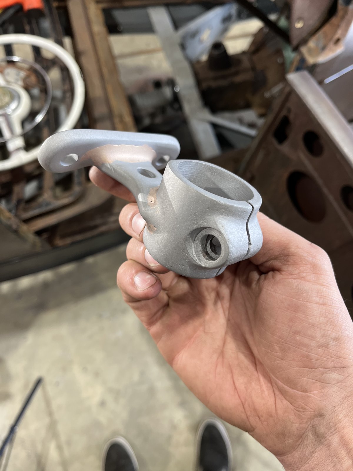

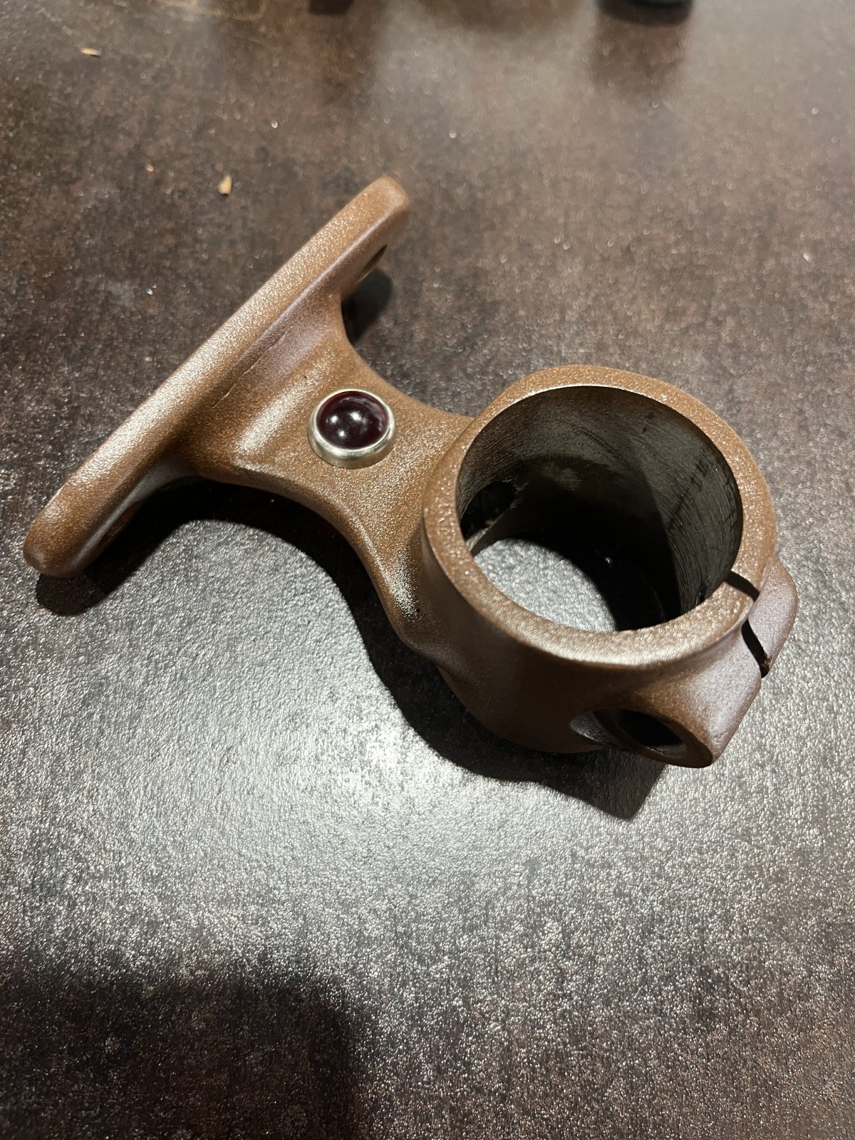

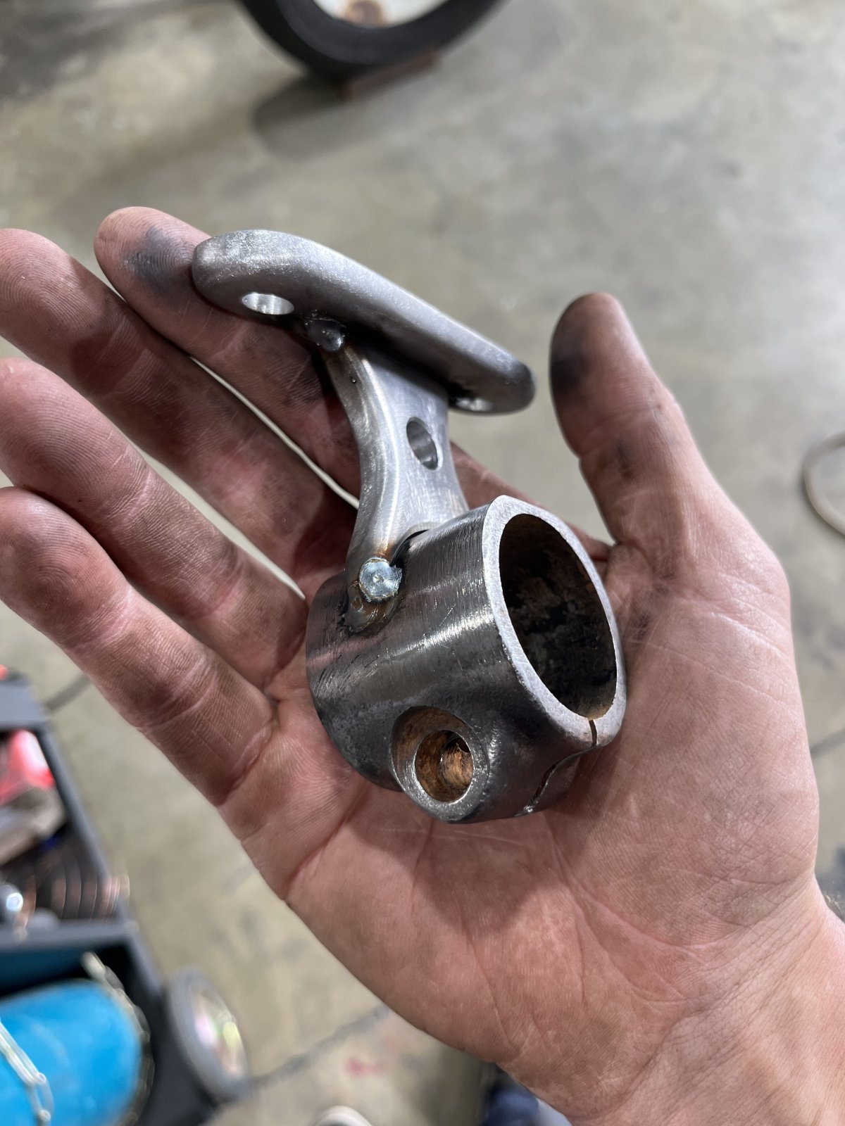

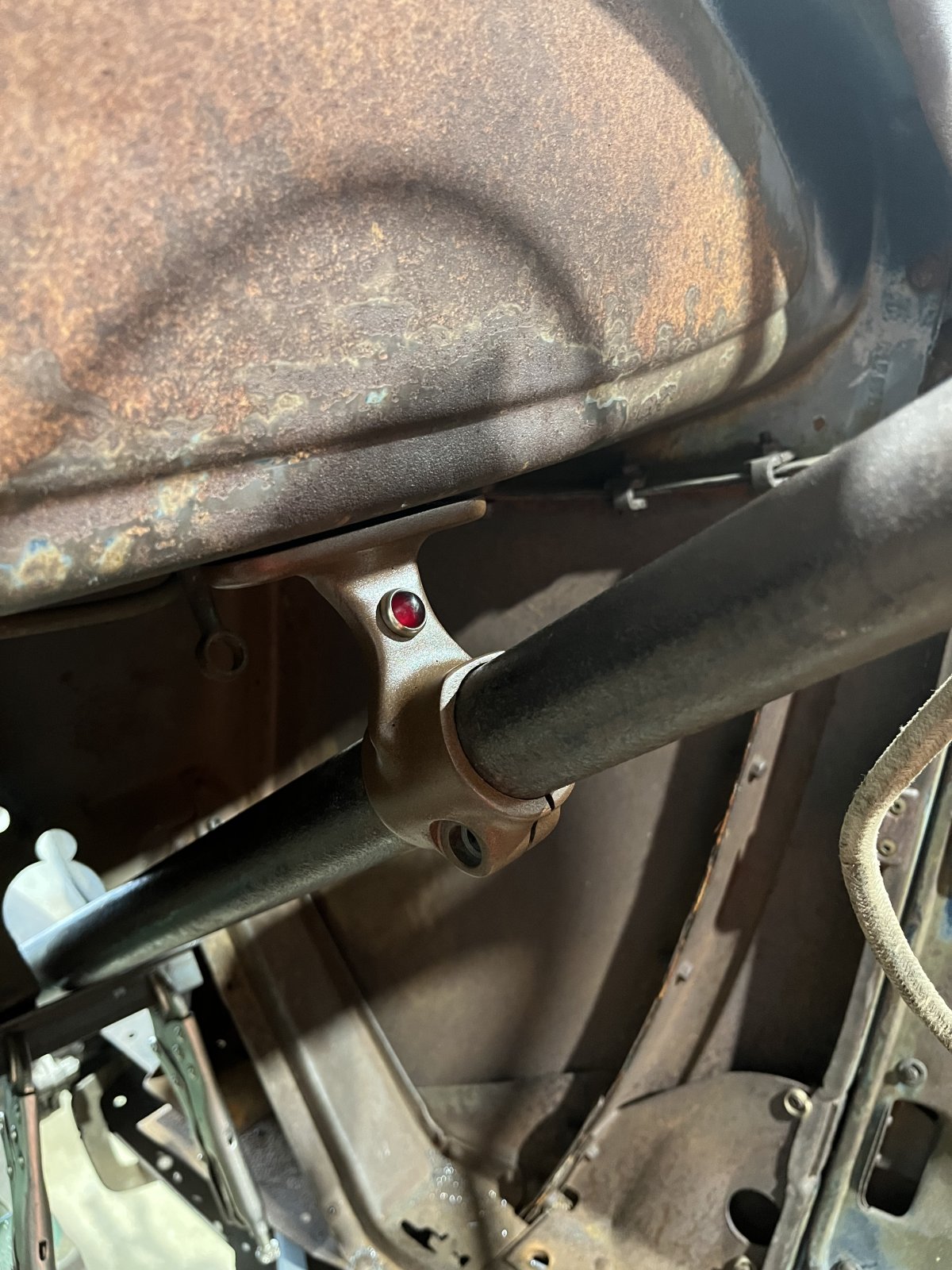

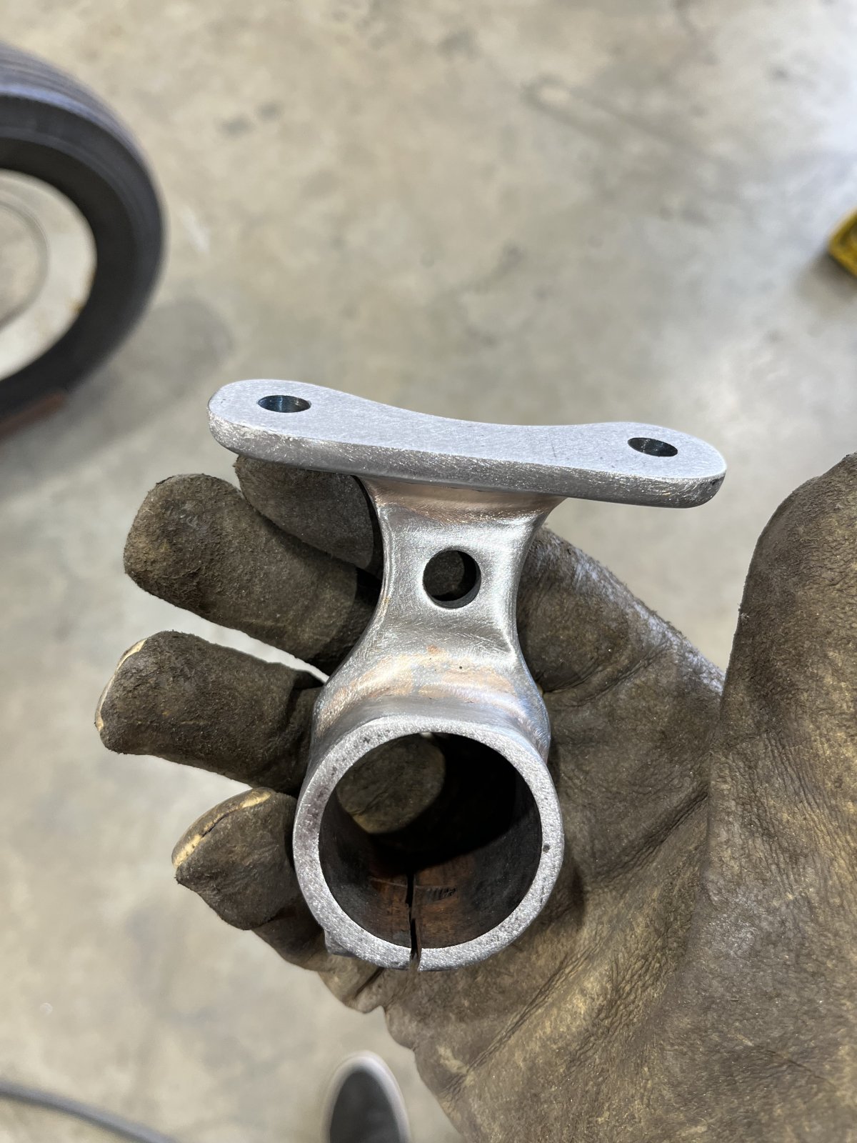

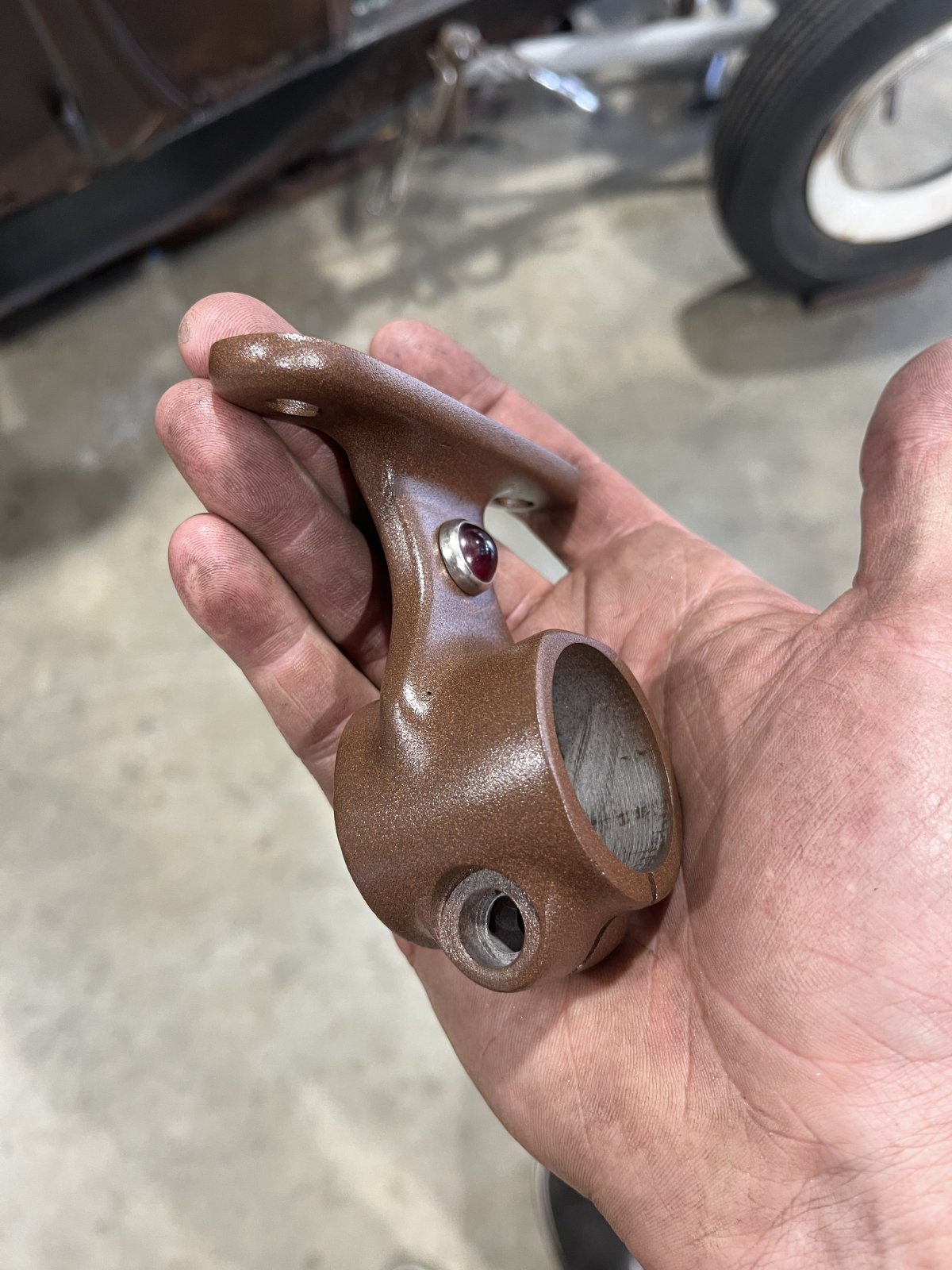

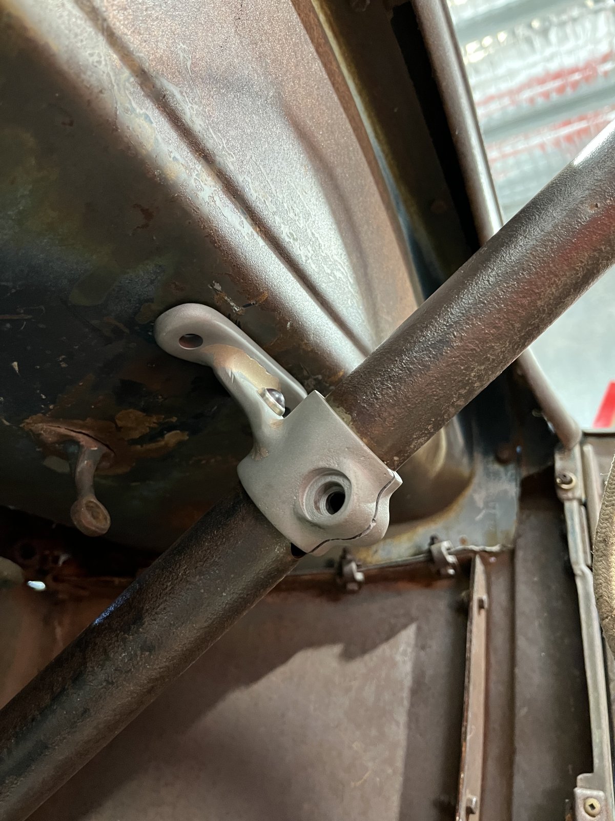

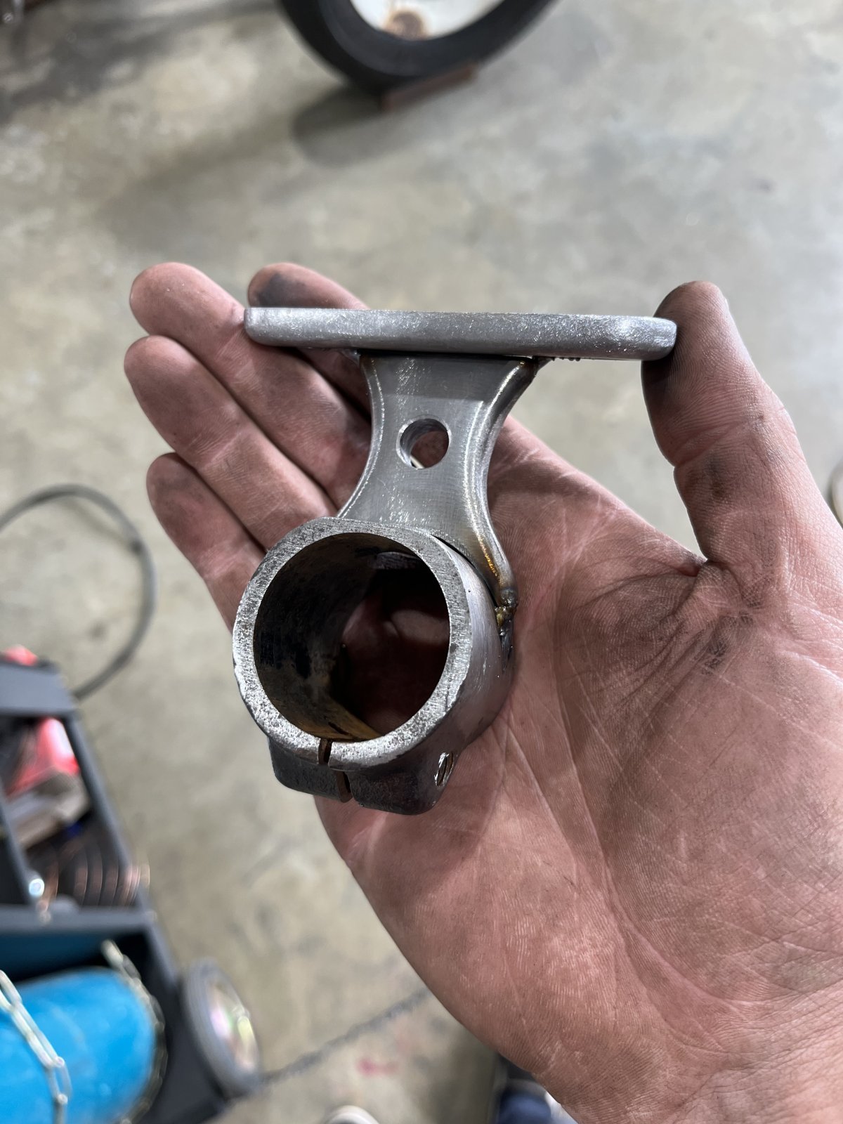

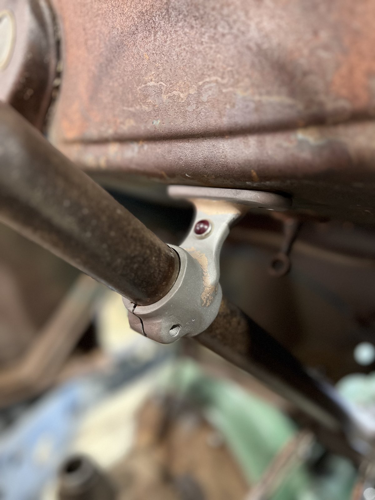

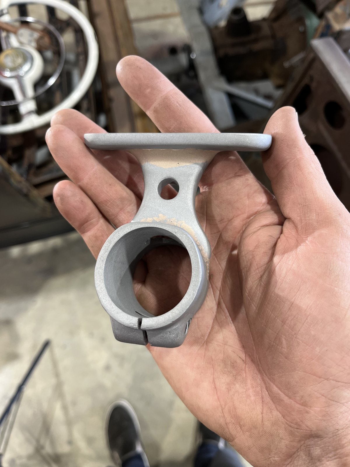

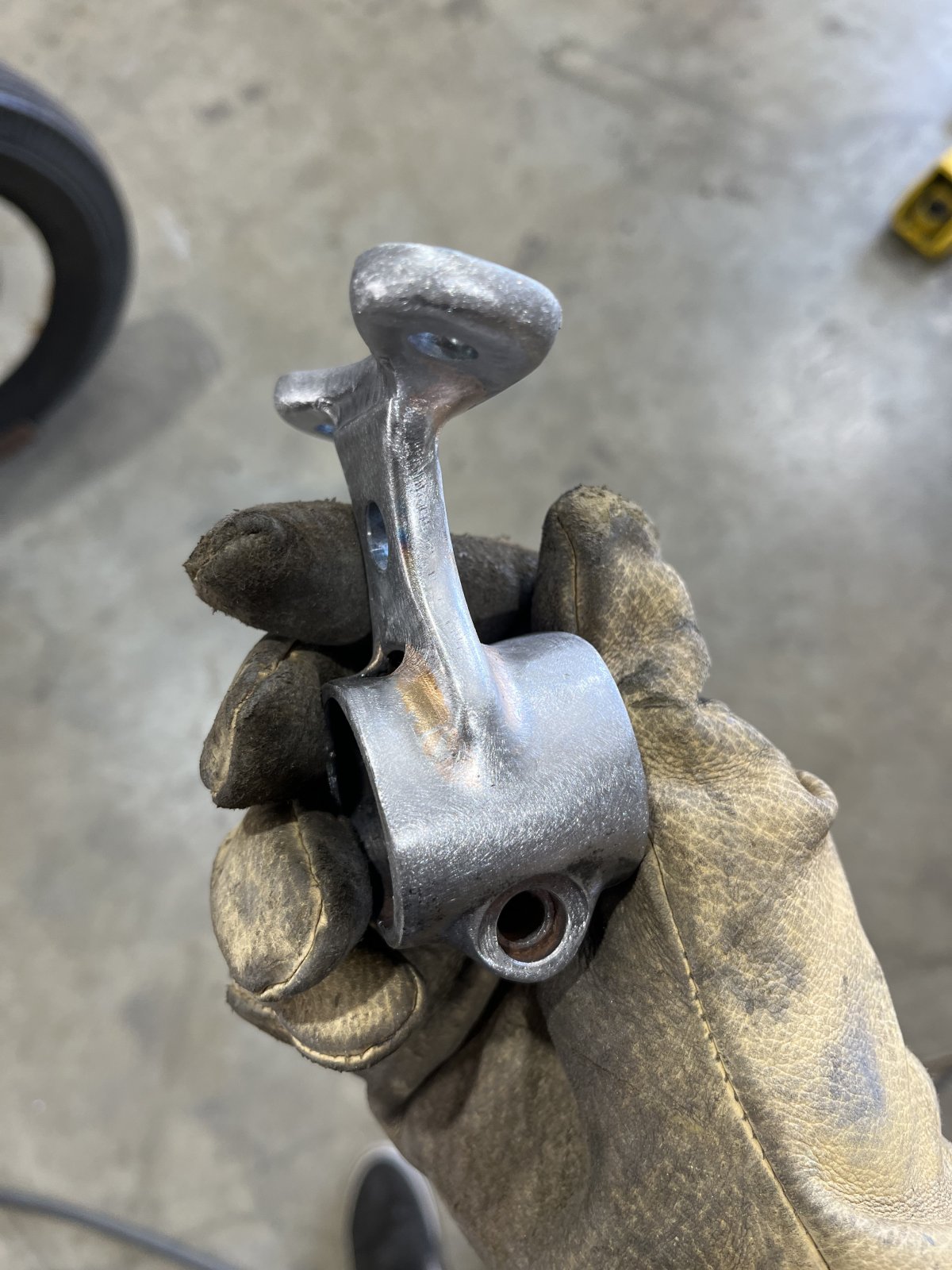

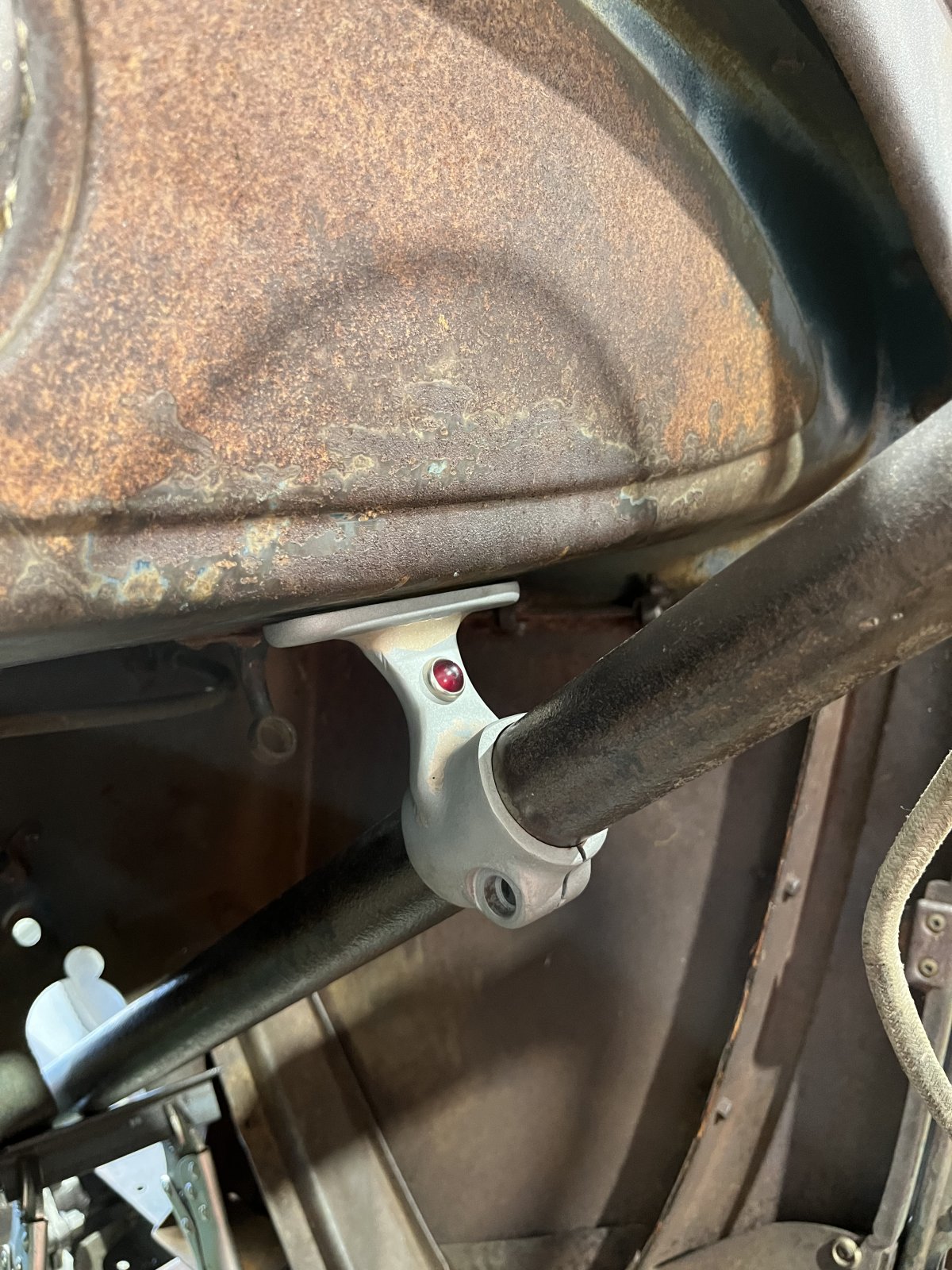

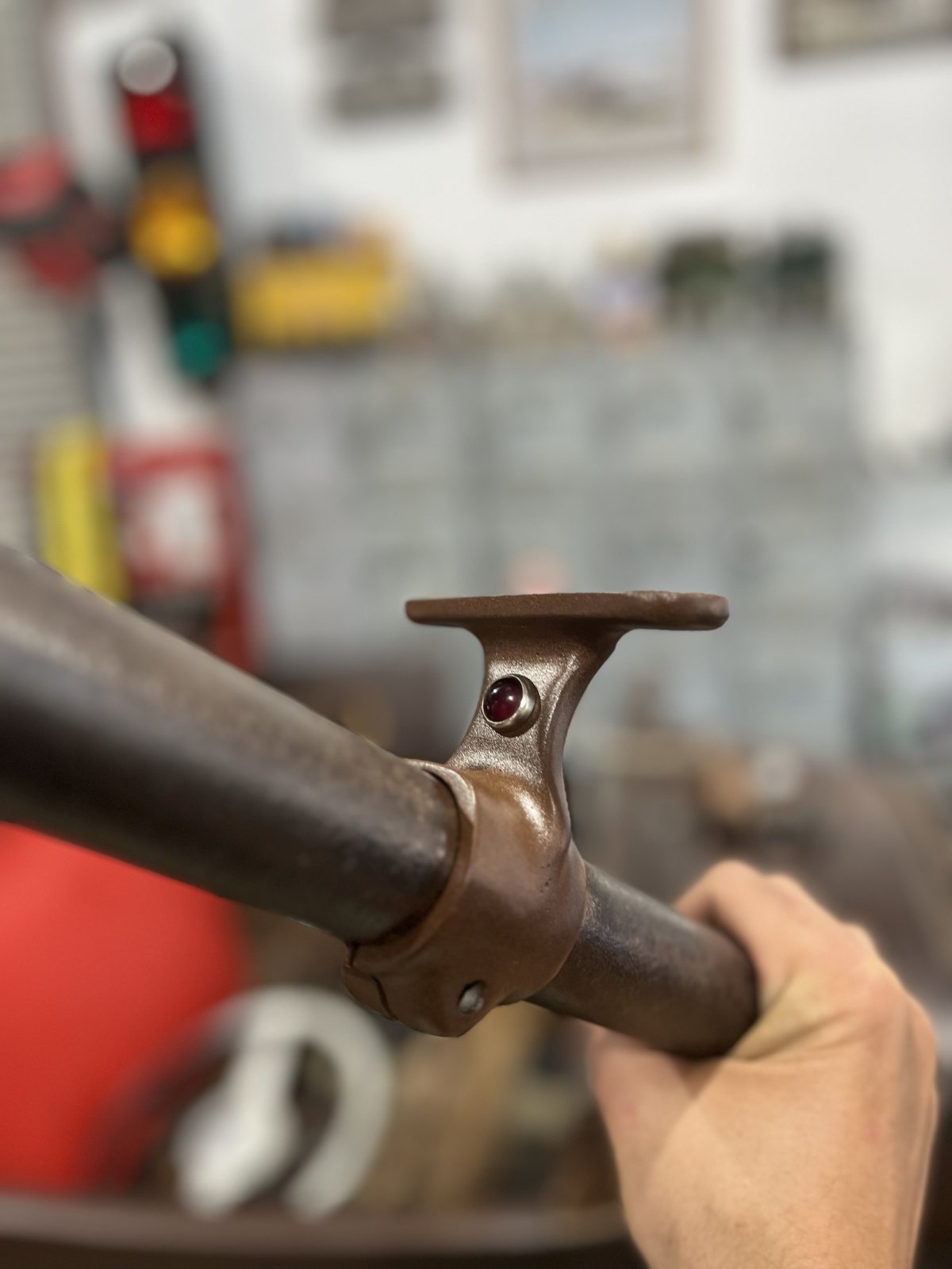

  15. Made a simple little coloum drop/mount with a nice gl*** red lense for something? Maybe hi beam or generator light, possible oil light.

    Looks great! I’ve never once considered right hand drive cars having the blinker on the right haha.

  17. Nice column drop! It appears that you brazed it together after the tack welds? Wondering why not weld it?

  21. It’s fully tug welded. This is silicone bronze over top- has a much lower melting temperature and is really nice to blend and finish.

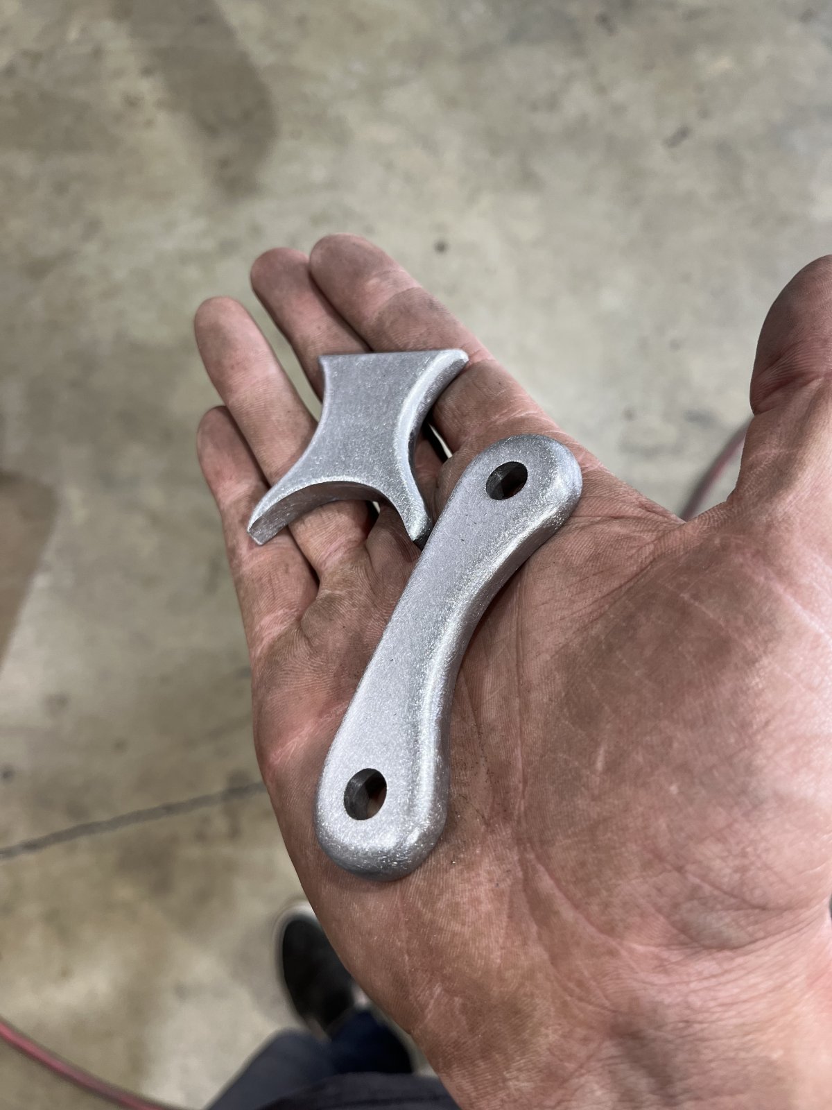

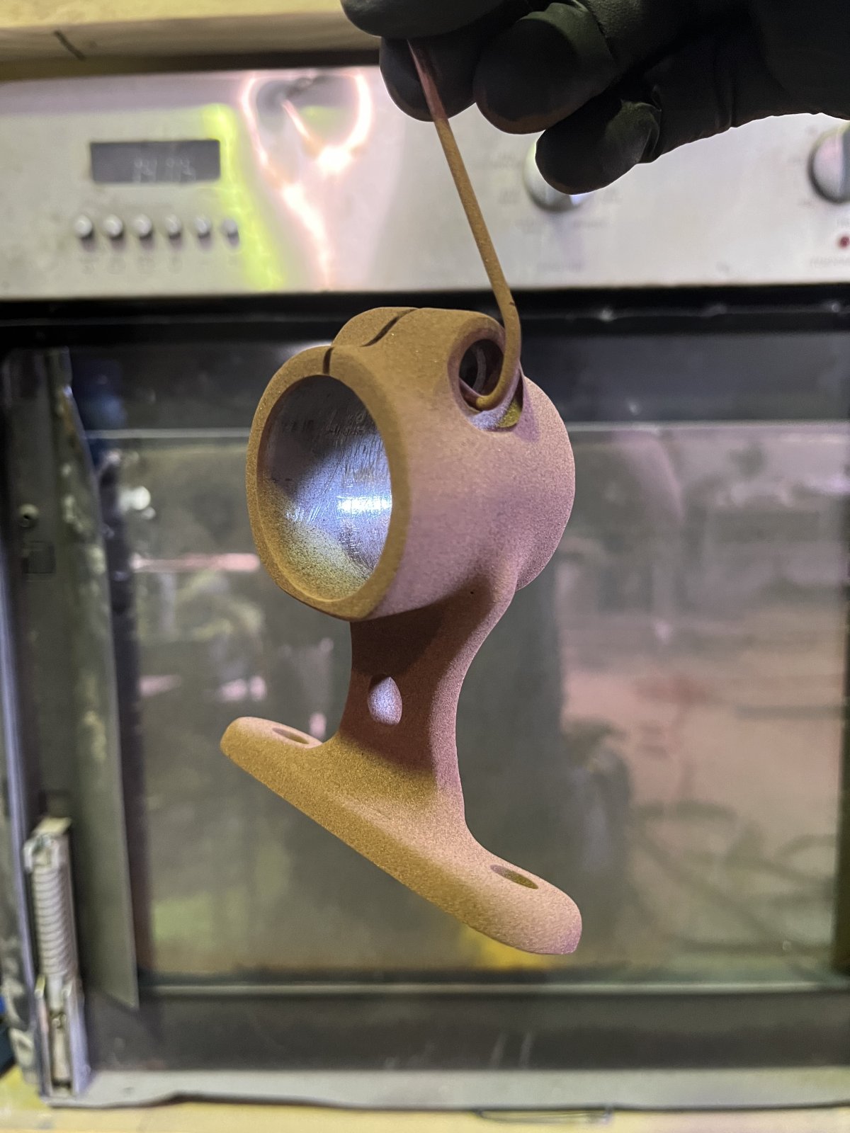

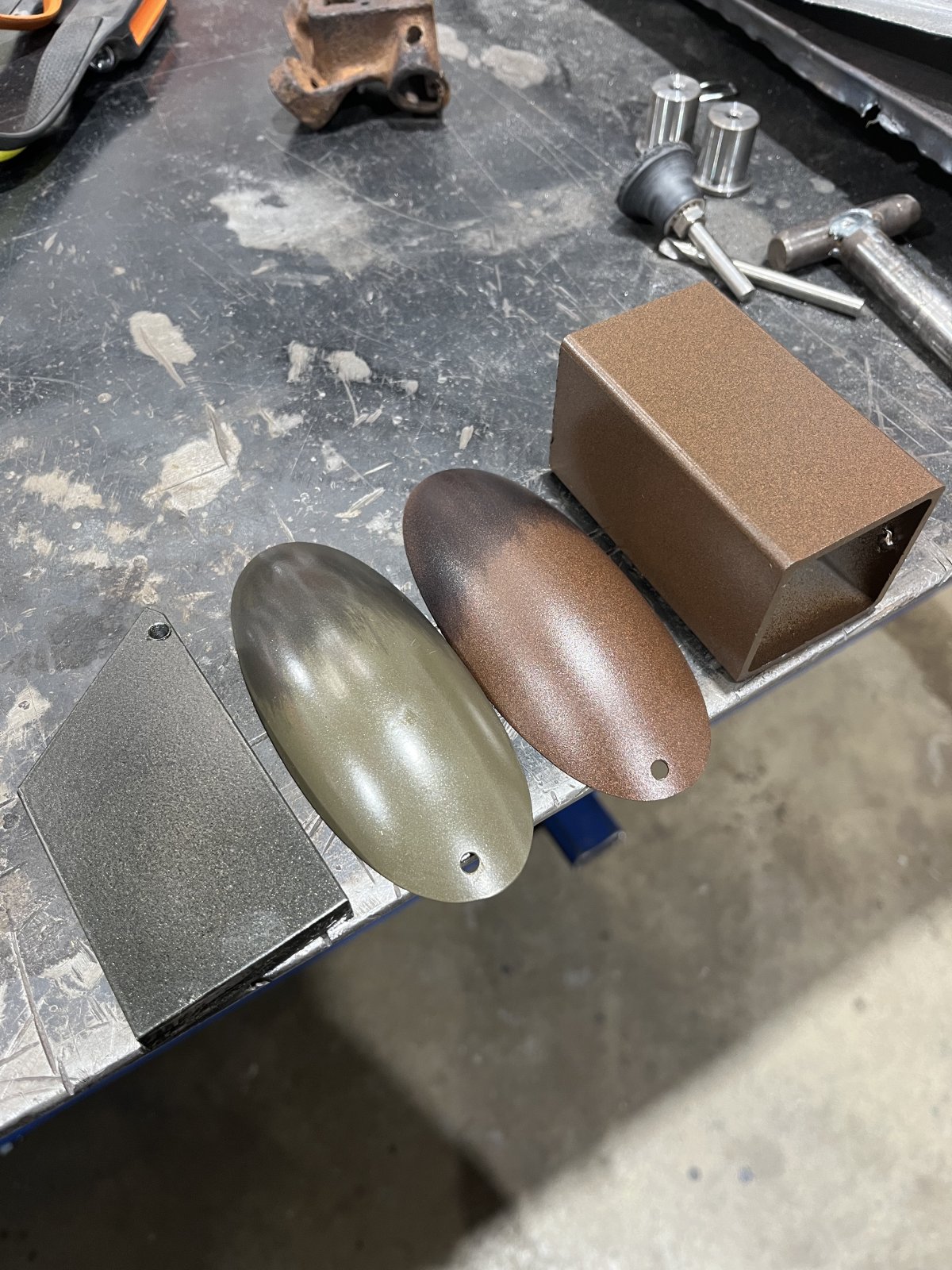

  23. Played around with some powder coating today. Lots of different samples, the finish is cool. I’m not one for fake patina but I like the way it turned out! 8830EBBD-4BCC-403F-AB20-CC629A51C8BC.jpeg 27A919AF-B11B-43DD-8348-4FD331F899E3.jpeg 74E1C2F4-3E2E-4530-85D3-FC5606BF9F0E.jpeg 2904197D-DD43-41FA-8994-81E45E20225F.jpeg 7069440D-0874-401A-A02D-F262B3A6BCCF.jpeg 0490D8BB-D0D7-4736-B8A2-D85BF32A78F5.jpeg 9073ECD7-E3F7-47FB-AB62-04ED665AF2B6.jpeg 18E67809-5605-46CD-AECF-C1B0FB869313.jpeg

    That column mount is awesome. Nice job.

    Fake patina only ****s when you can tell it’s fake! If you can’t tell, it’s art.

    That column drop is beautiful. Some food for thought when I get to that point.

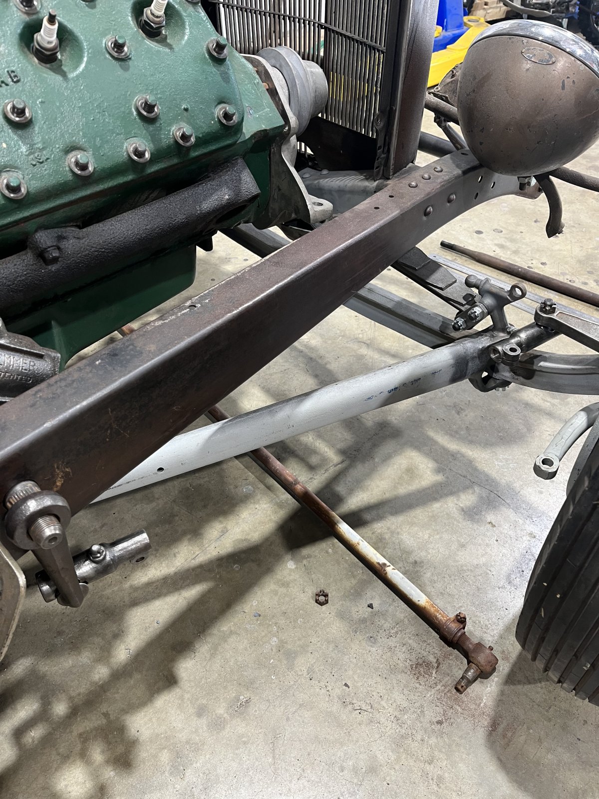

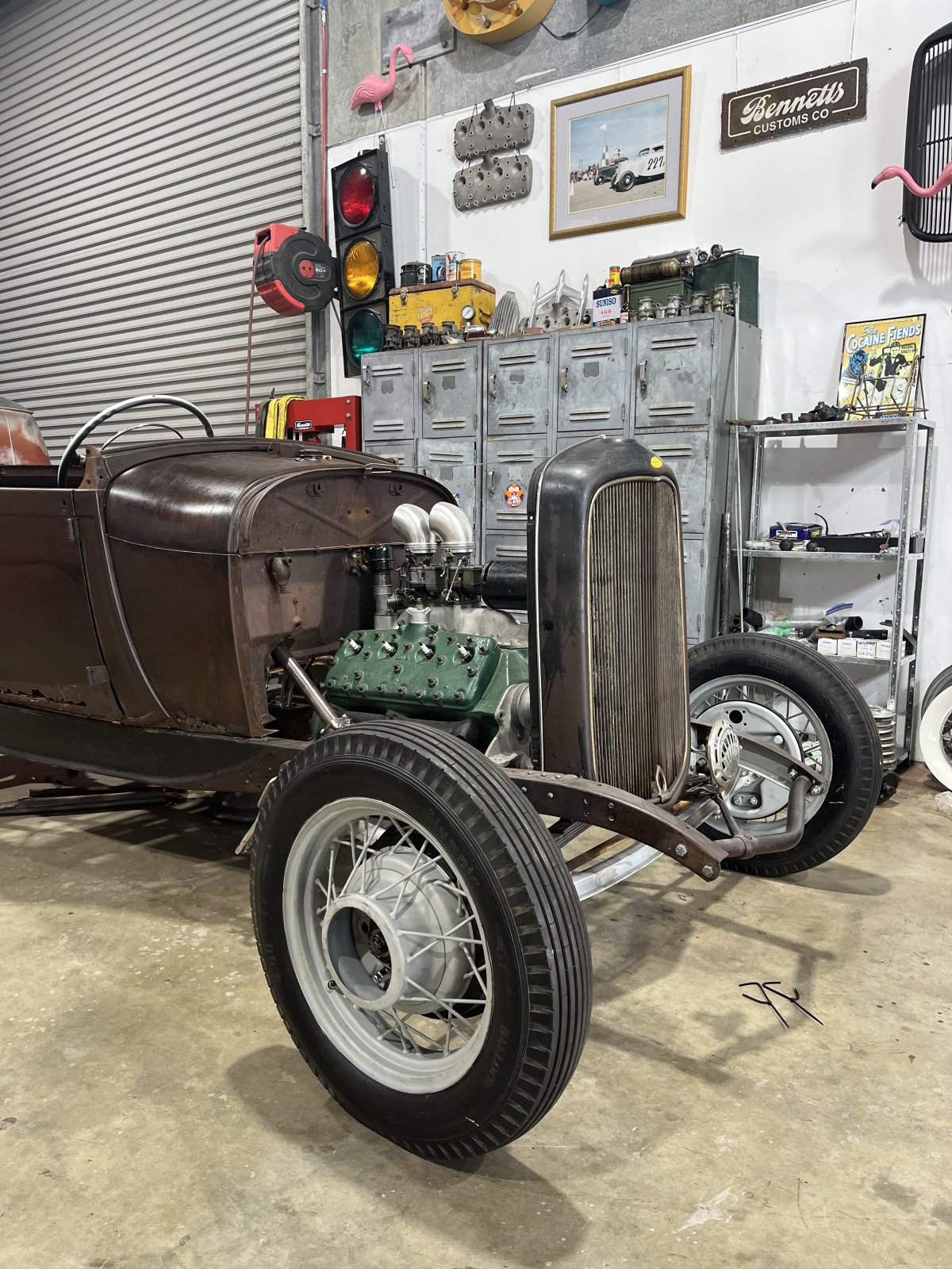

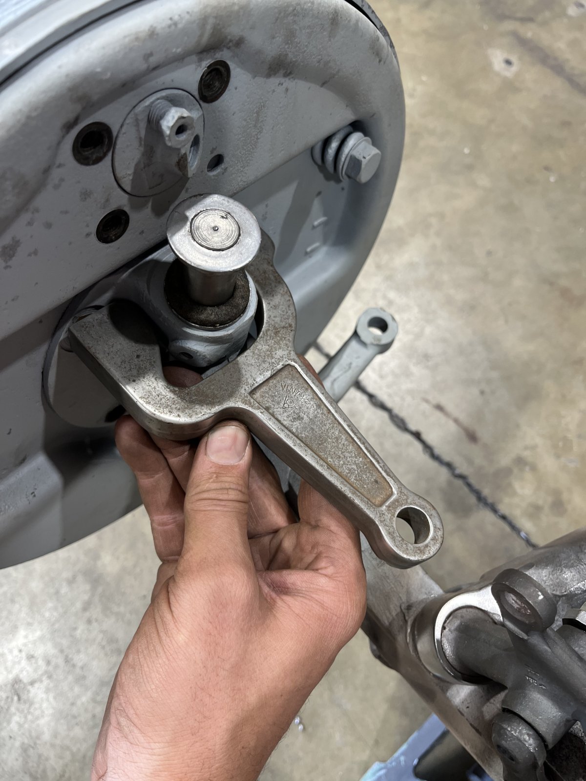

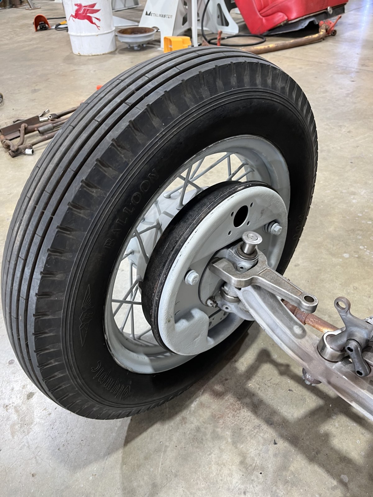

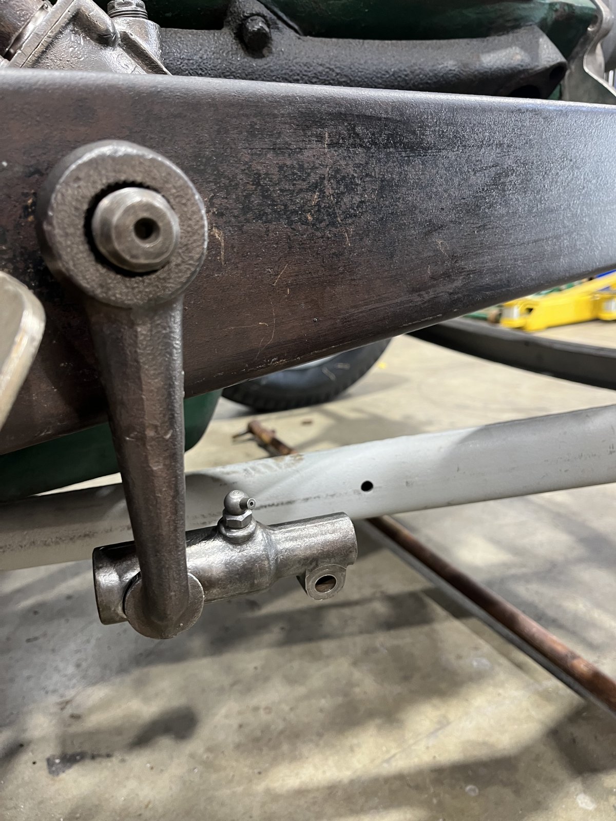

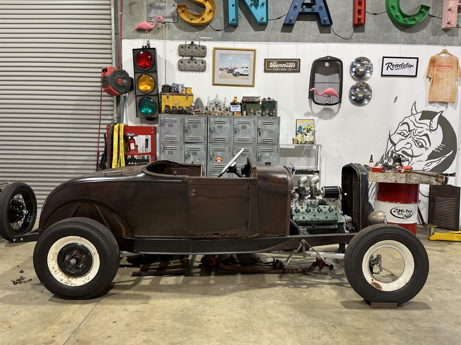

  30. Front spindles and hubs mocked up, with running the round back spindles it might look goofy running the steering arm but I can live with it for now. I found a pitman that fits the box and plan to running early ford drag links I will thread a bar and also for the cross steer I will run the ball ends and use the early ends. I just like the way they look.
    I’m digging the way those 17” wheels look though- these Olympic ‘balloons’ are awesome but the side walls and pretty old and cracked.
    I have 18s for the rear and looking for a nice set of 700s or 750s maybe Dunlop?
    Pedals next week.

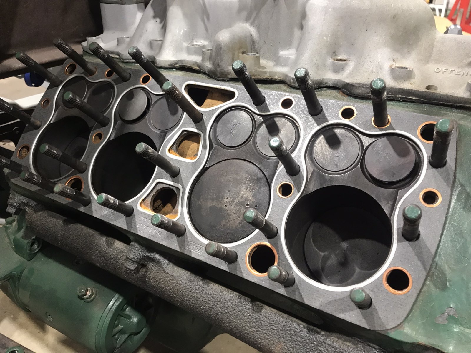

    Then motor dis***embly to hopefully run the 284F cam .425/.425 I’ve had from Shneider
