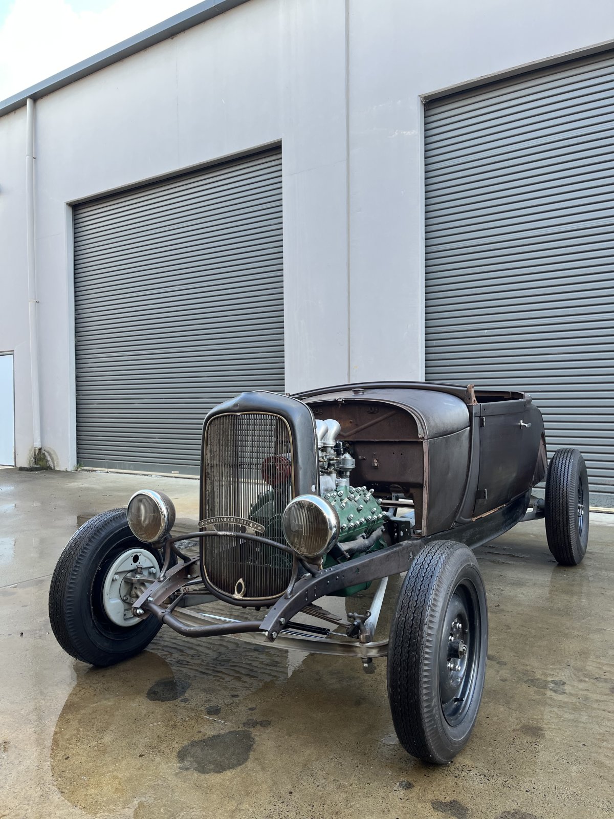

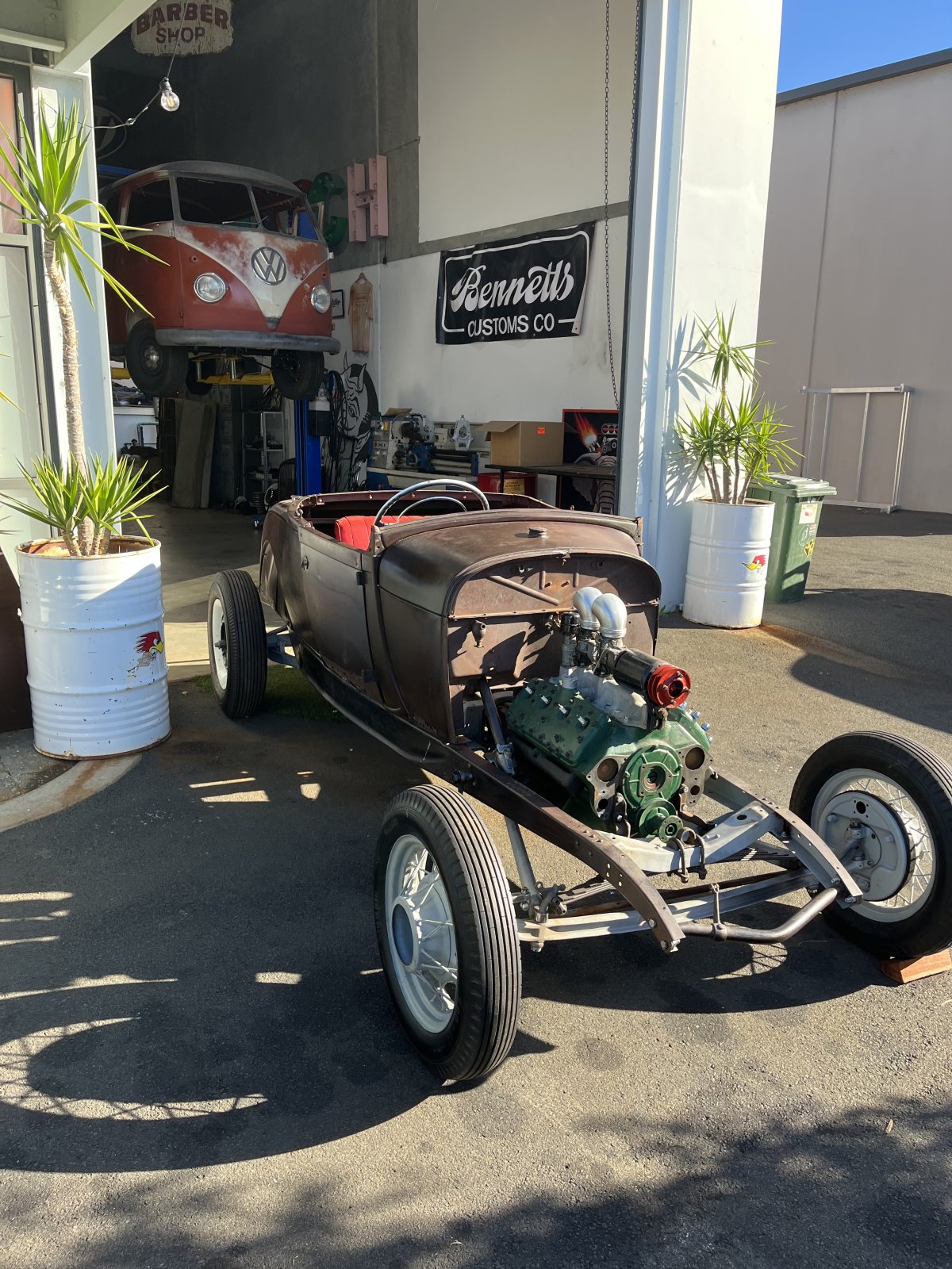

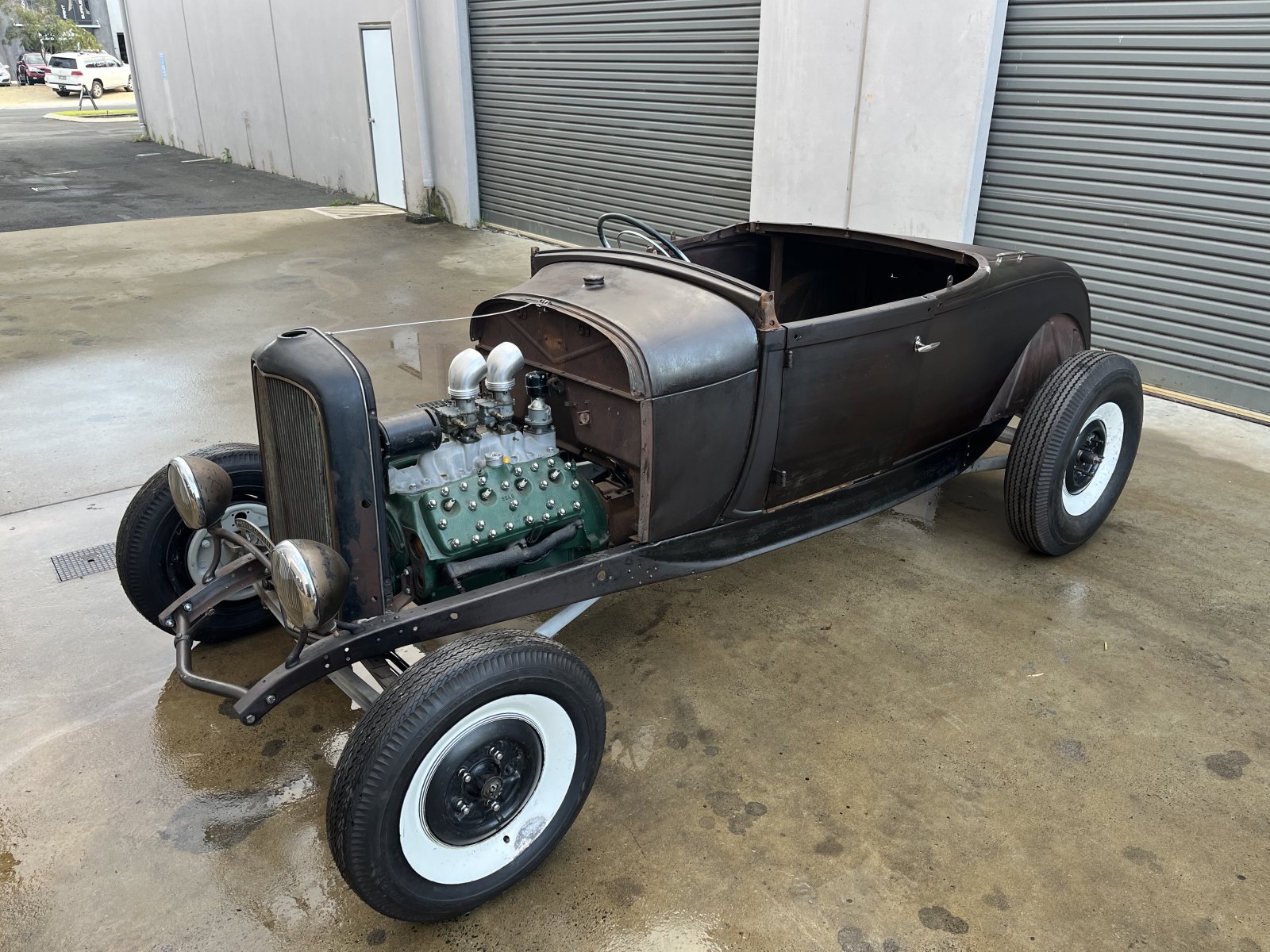

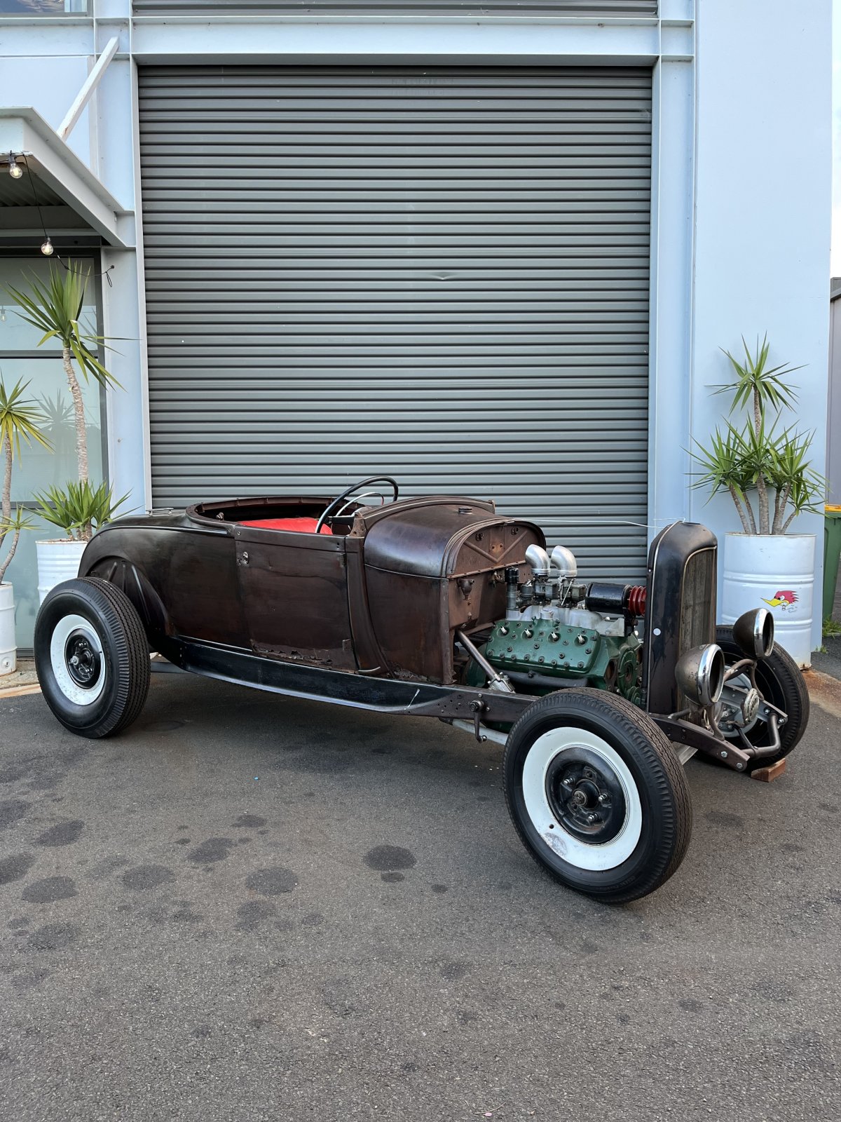

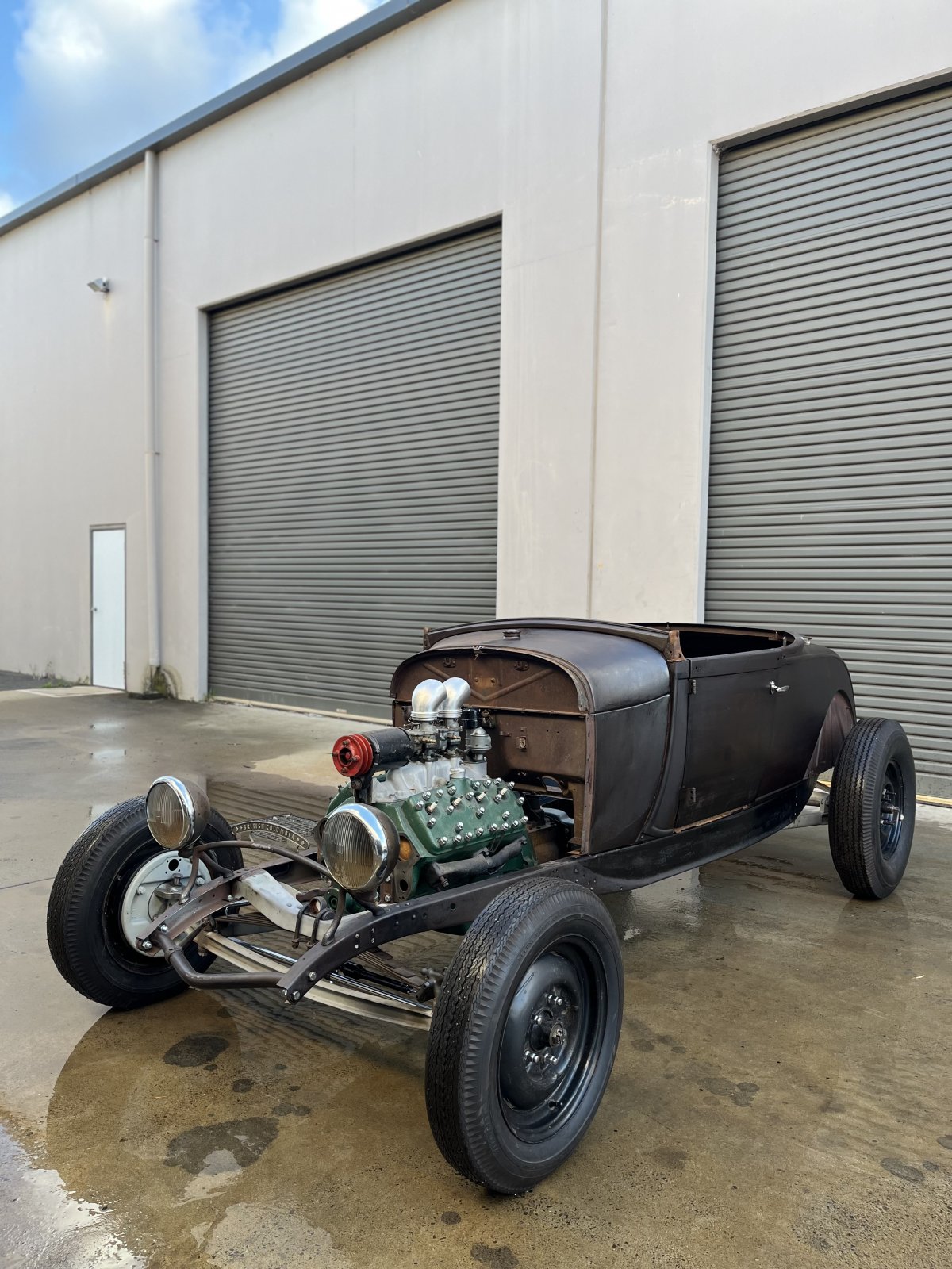

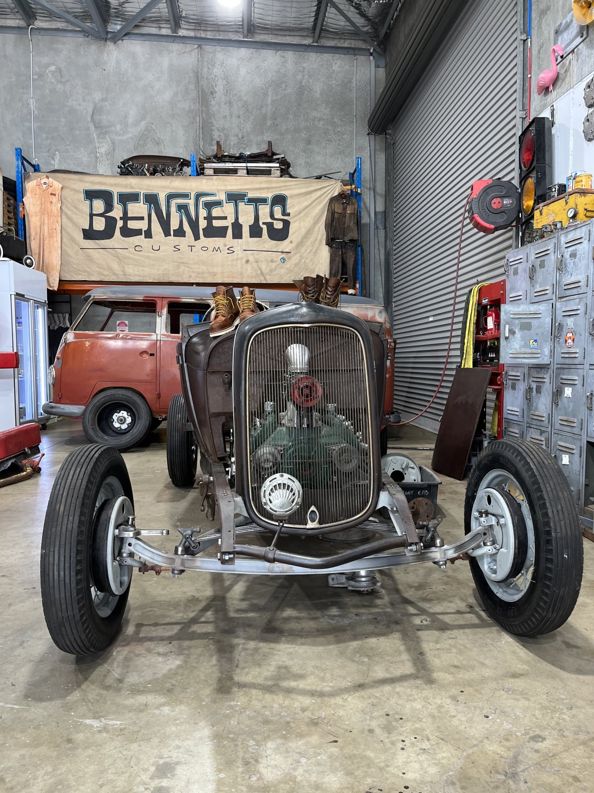

  1. Rolled it outside today, still lots of bits I need to get but it’s nice to see it outside in the sun!

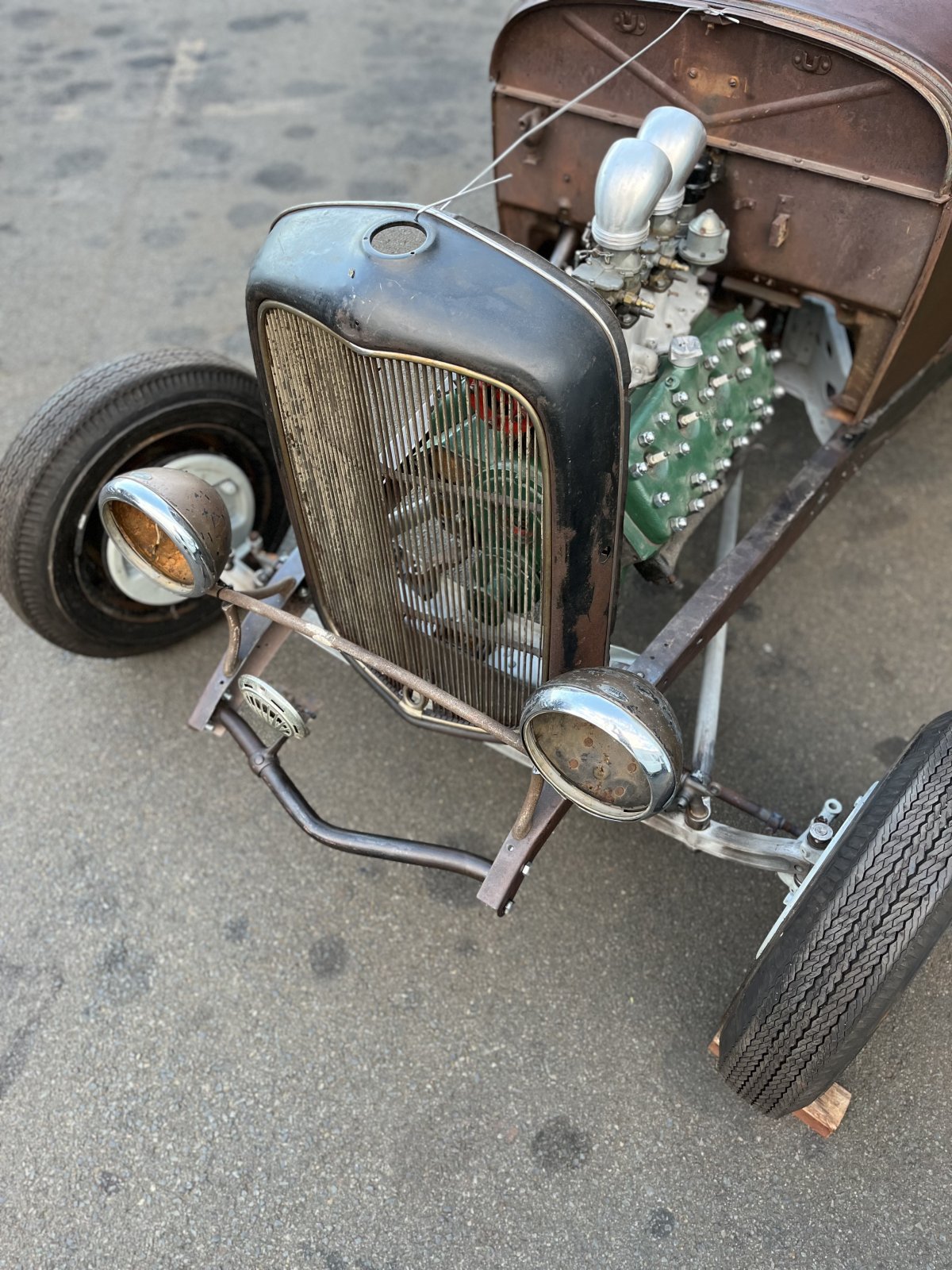

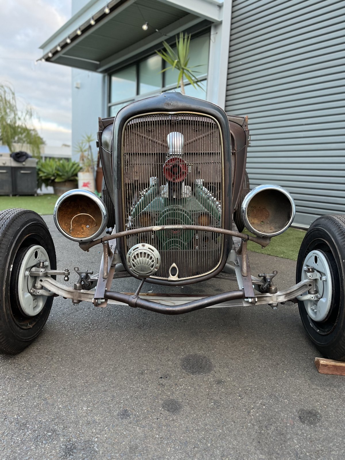

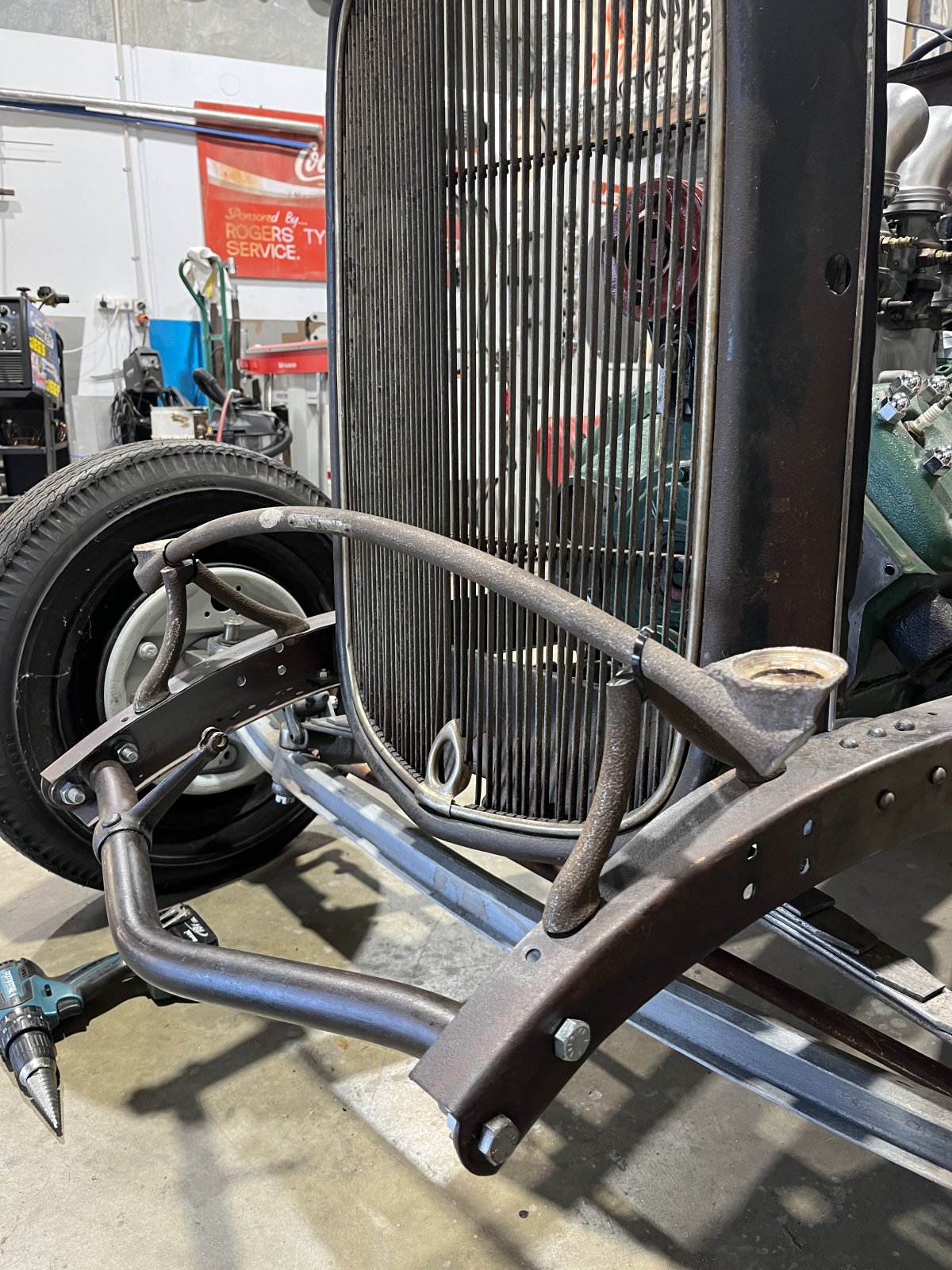

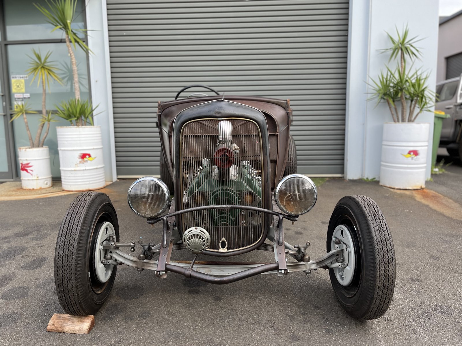

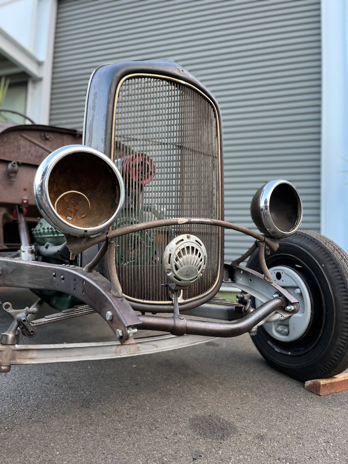

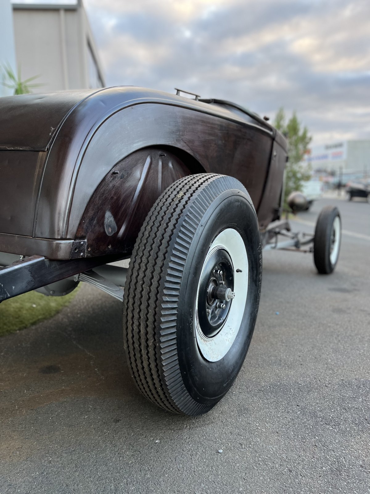

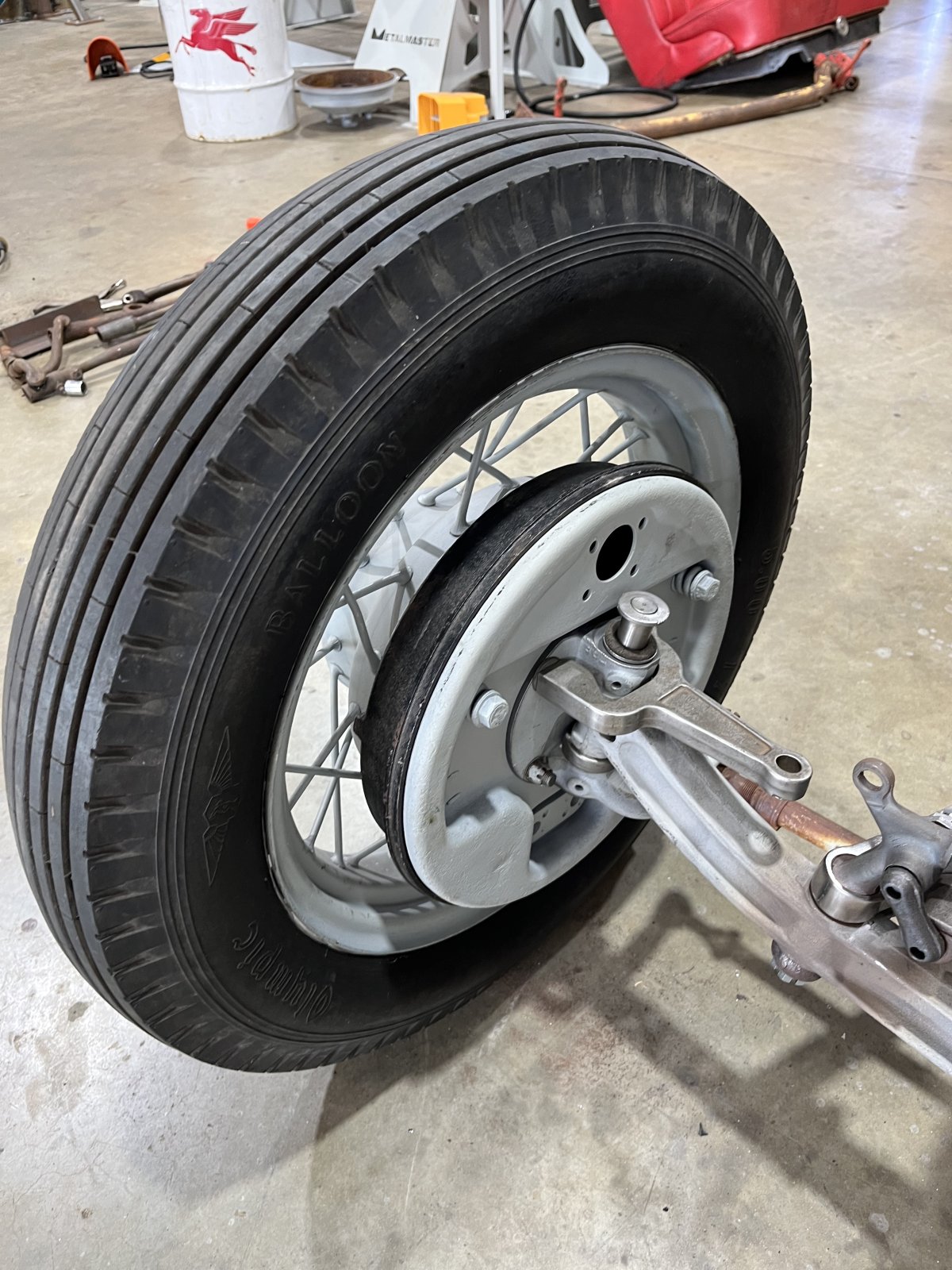

  5. Borrow some wheels and tires from my mate Travis to mock up and see what 750s and 500/525s look.. still undecided. Maybe a slightly larger size for front.

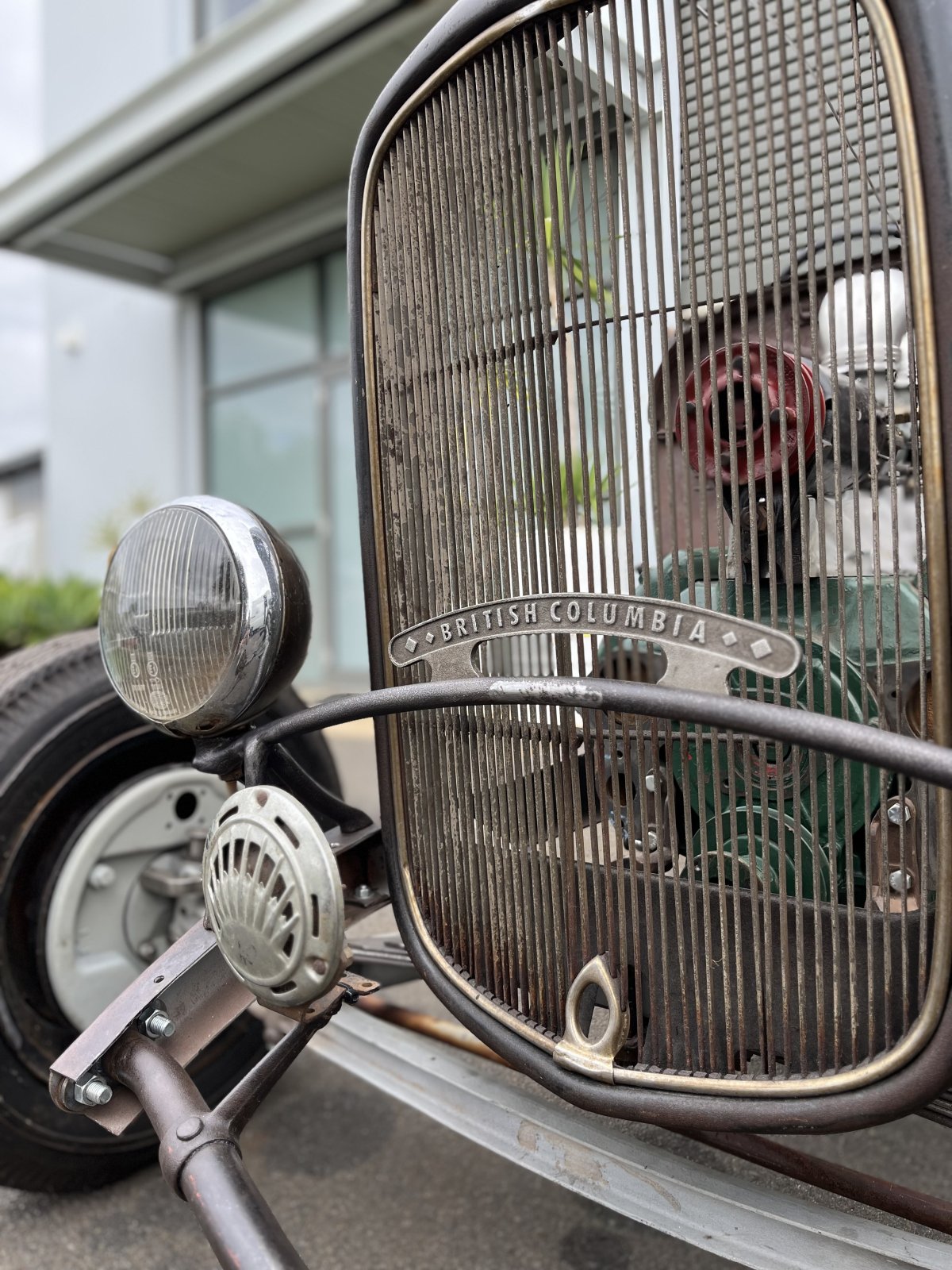

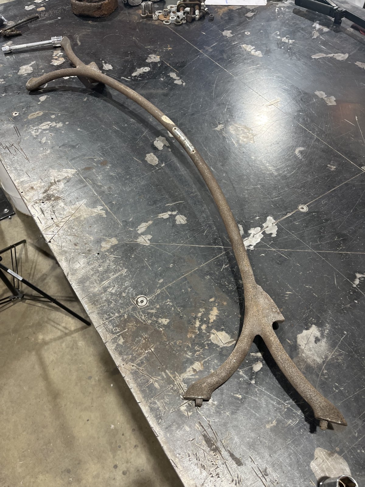

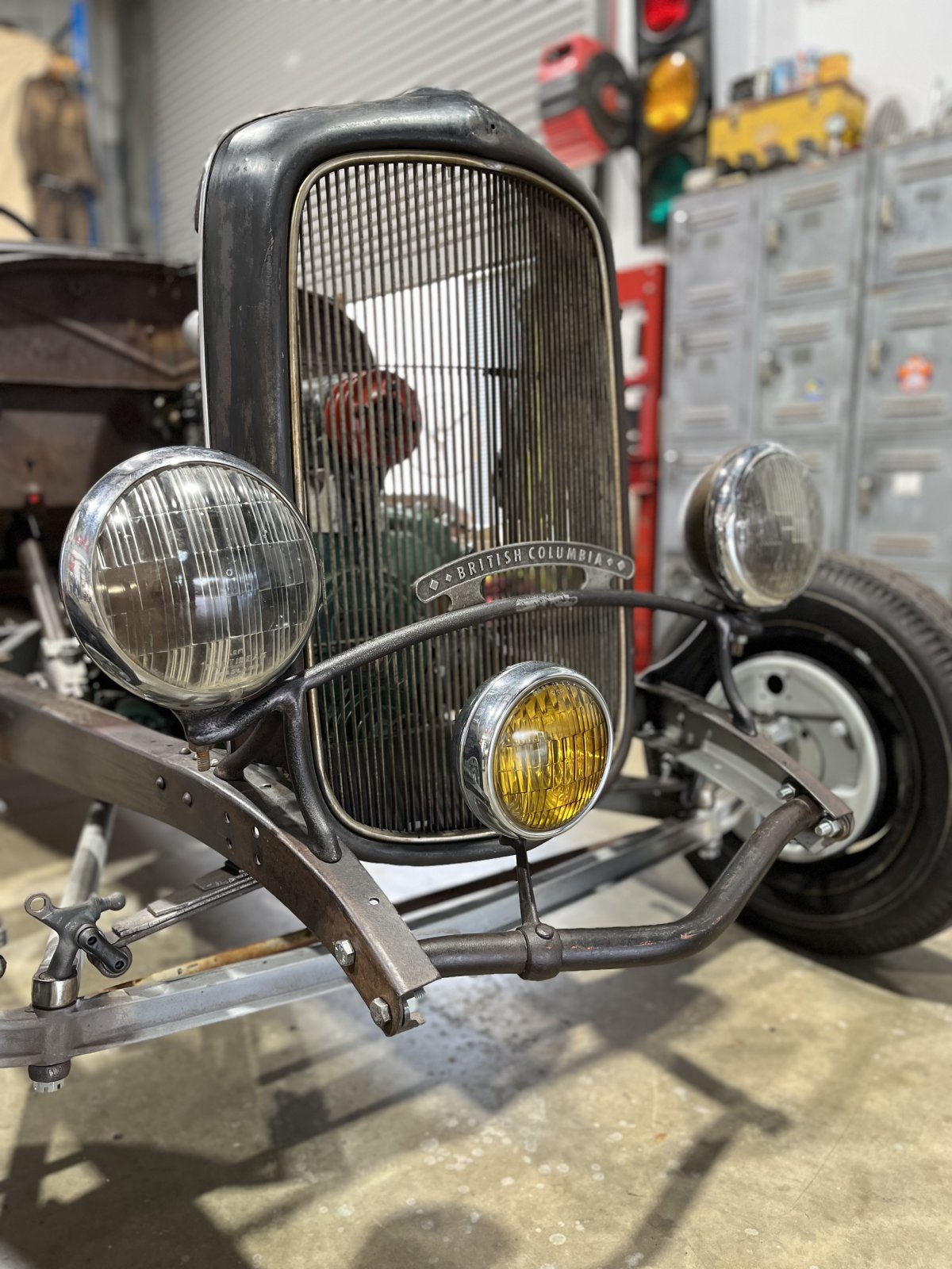

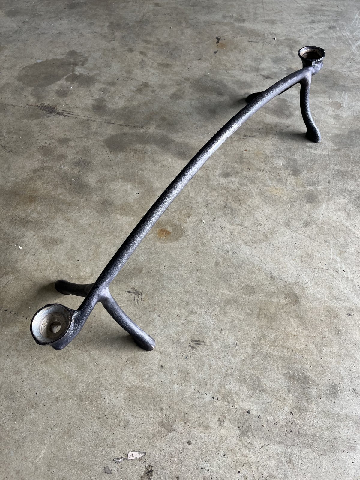

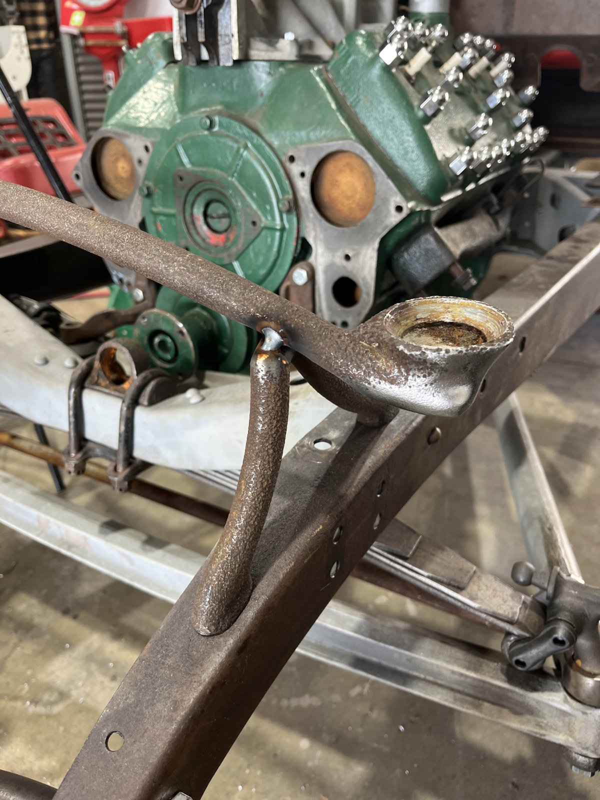

    Also playing with some ideas of the head lights and headlight bar.. it’s definitely different. Anyone know what the stock bar might be from? 2973A185-82AC-4752-8EEA-32653E72788C.jpeg 431D1C7F-B370-45E0-9A09-315A9E62369A.jpeg 777FC6FA-5C69-48EA-B5E7-DA3729A53867.jpeg 24D412D0-304A-4DA5-AE5E-F4C8F9DD5F26.jpeg D48B7924-1010-402B-8671-A0FE91C71C94.jpeg 5D6A1CA5-D318-473B-9ED5-86BDB9518D1F.jpeg 7C59FB30-5424-45C4-90ED-0CFF5E053009.jpeg 8D0D74C8-8551-428B-A330-9C66FFBE253B.jpeg 46F095C0-991F-4787-B4C9-27FC829A948B.jpeg FF2B8A76-4C12-4211-B19B-94CD5C6DAAB0.jpeg 2F8E6D81-B8A4-4B08-8933-F21EE6999242.jpeg 0FB4F3F1-3DAB-458E-85BE-2C4905DB5790.jpeg

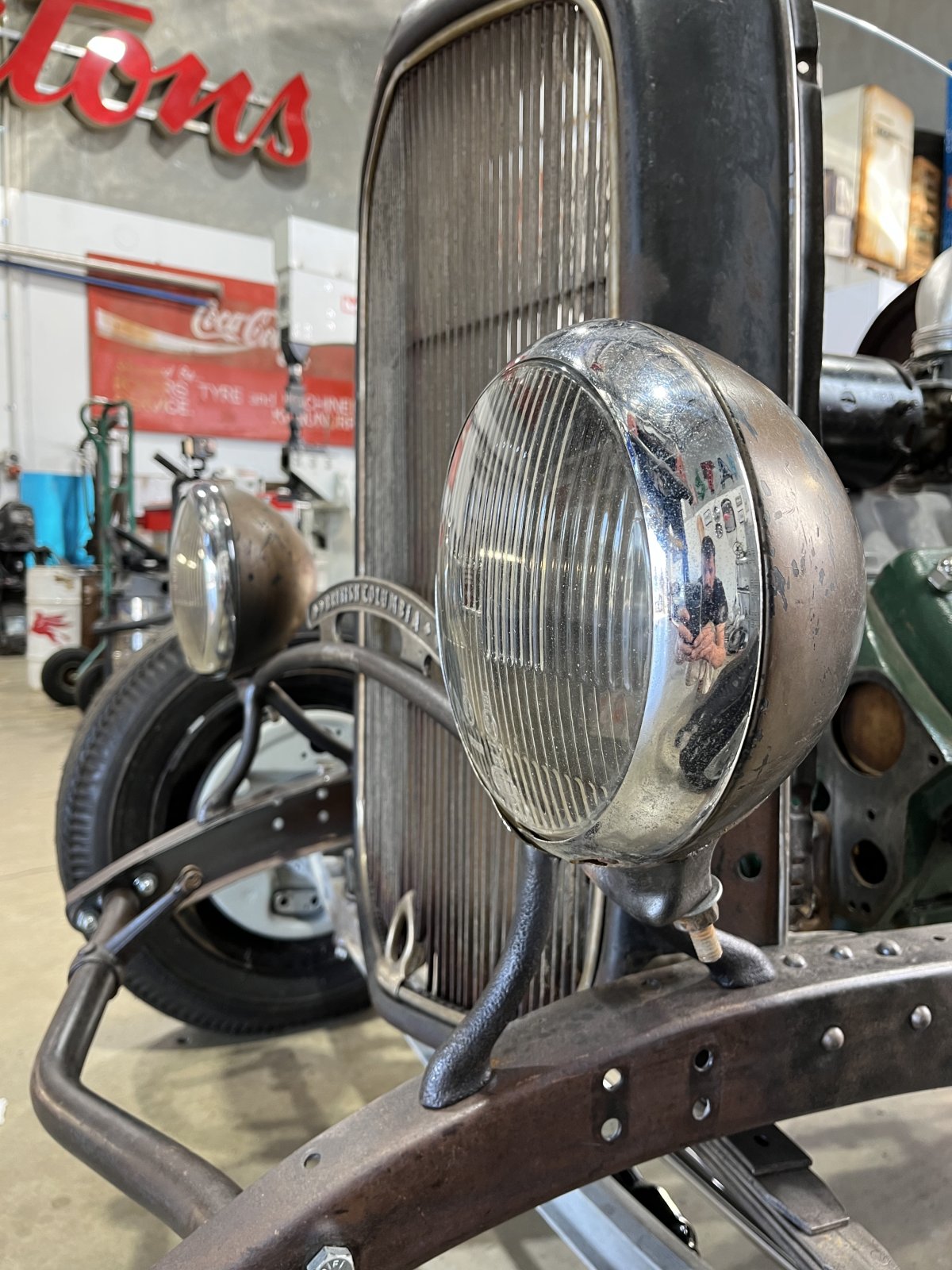

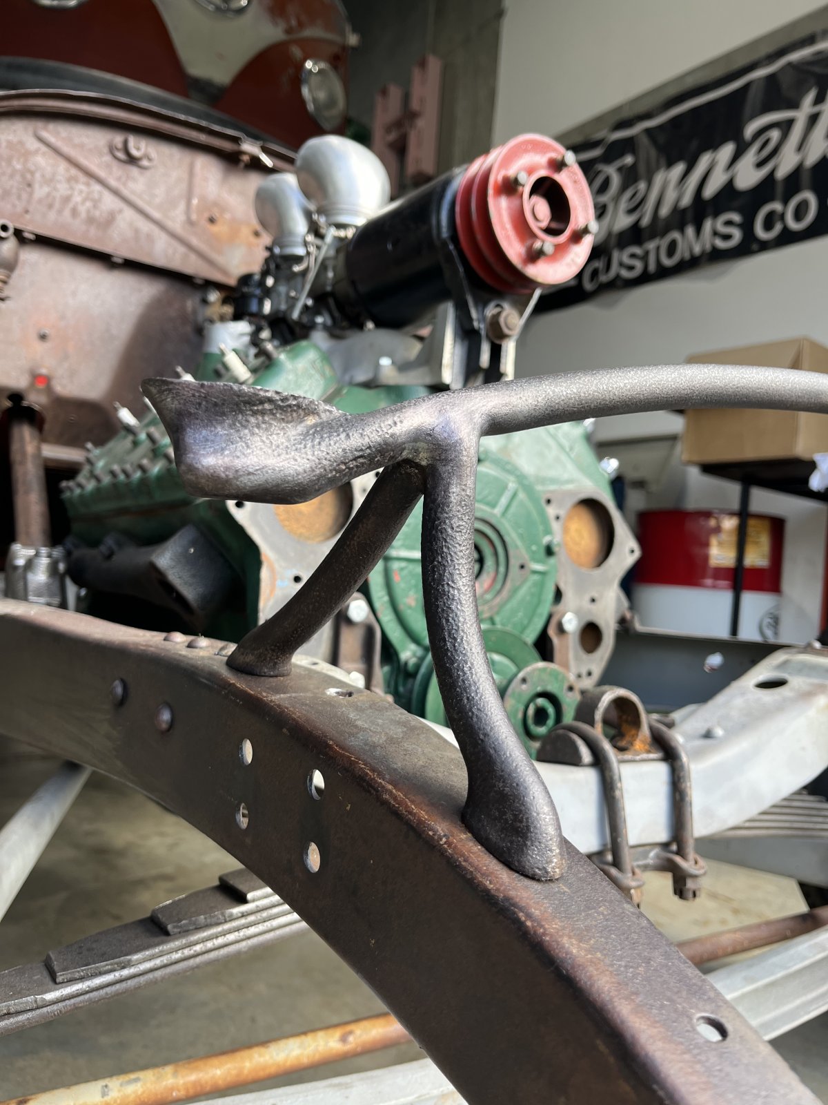

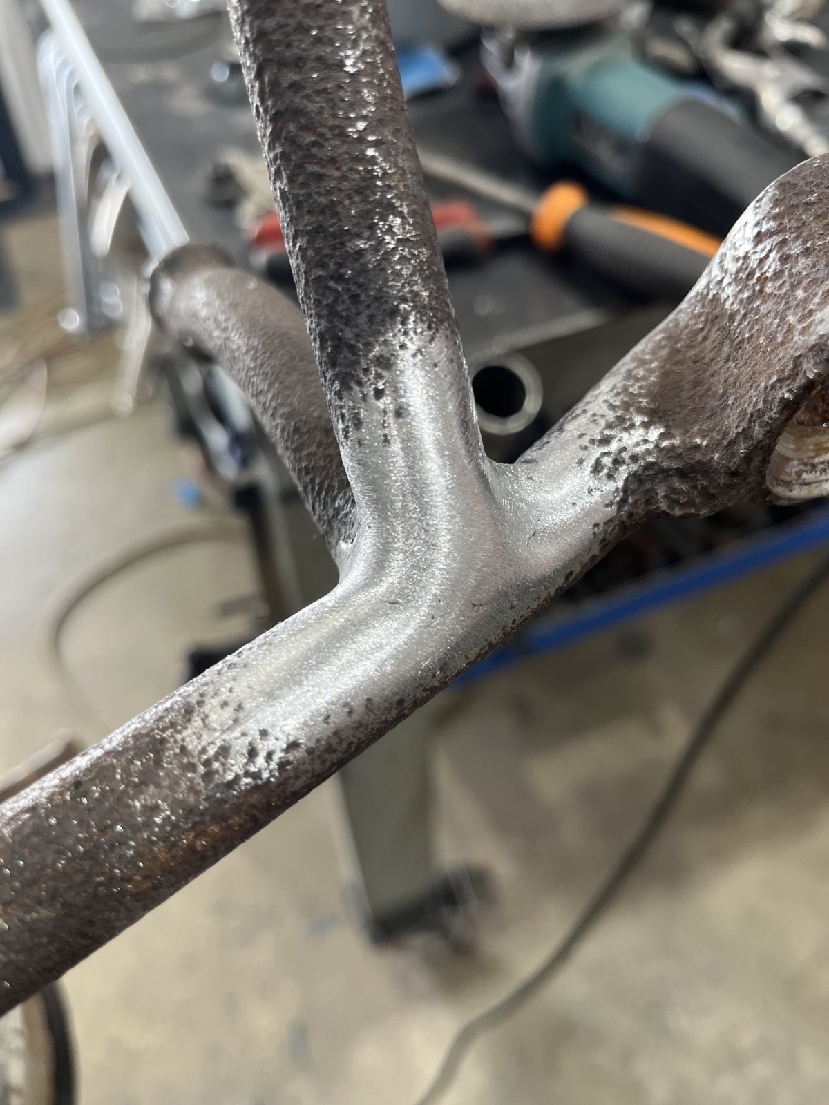

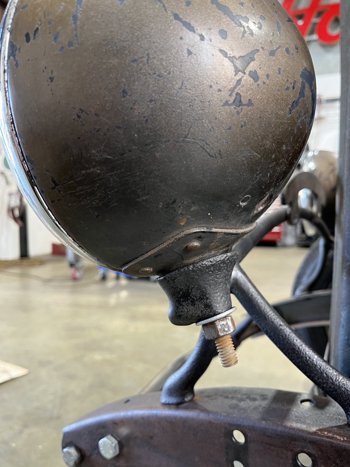

    That is a very neat headlight bar. Two cuts and two welds, and it looks like it took a week to fabricate.

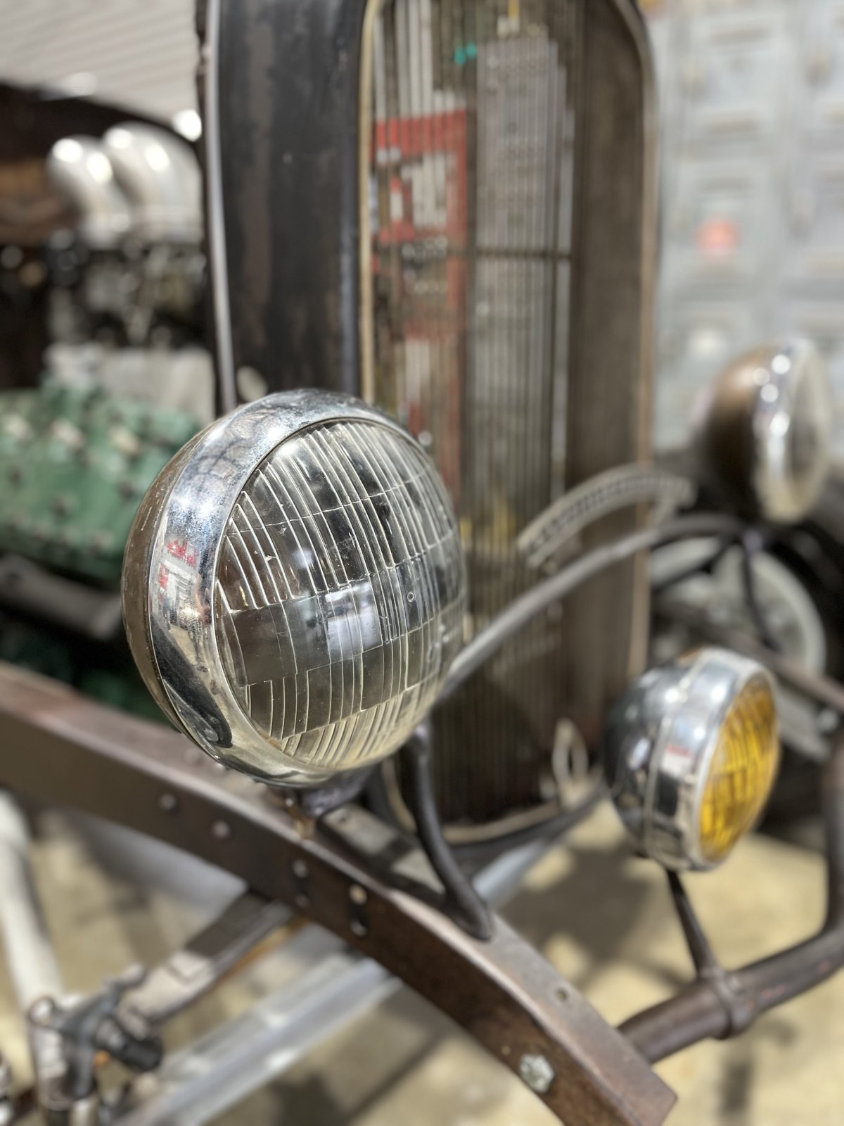

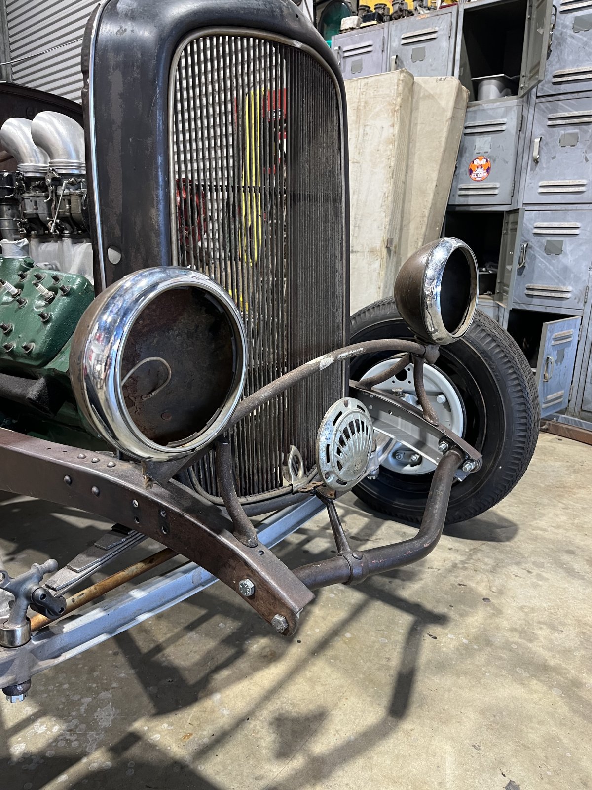

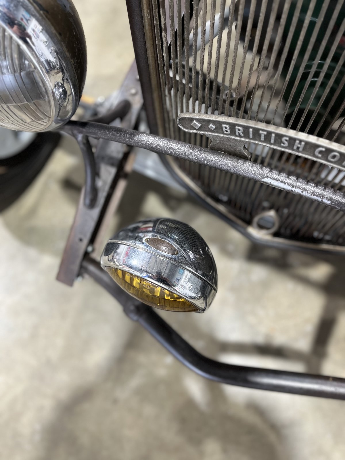

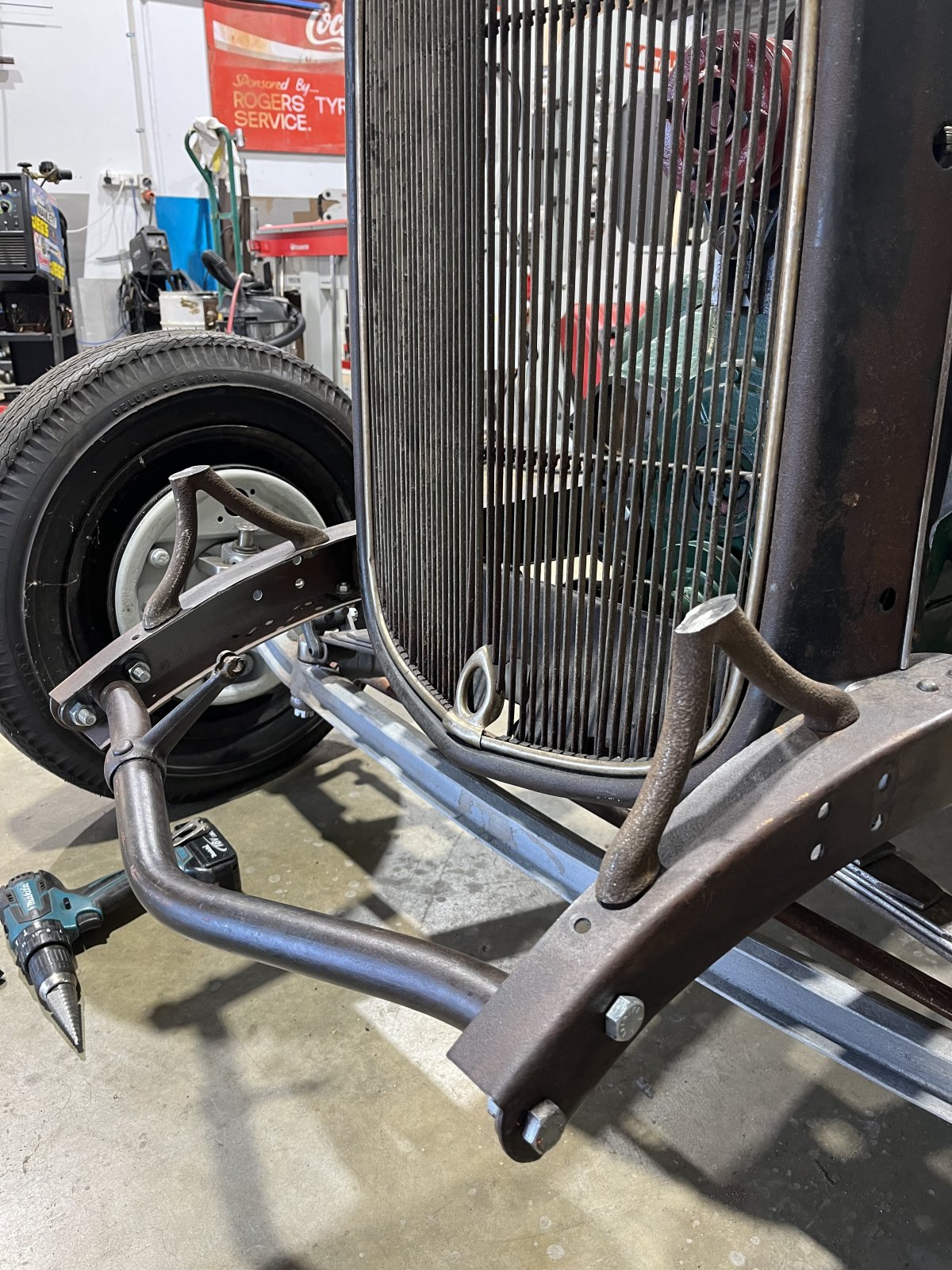

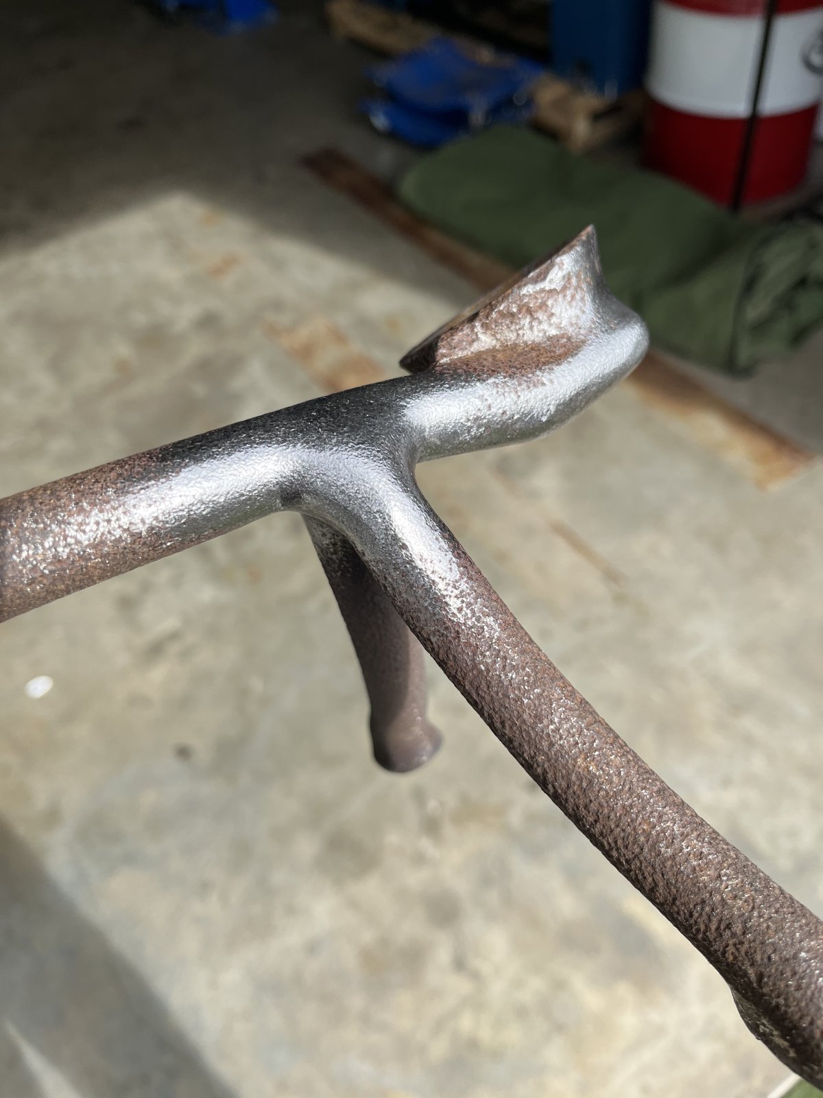

  7. I mounted the headlight bar today. Welded blended and textured it to match the pitting and cast look. It was fun to create. It’s different and I think I like it. Testing out fog light and horn positions. Have a special licence plate topper I used the scaler on aswell and used wood stain to age it. Looks cool. Unfortunately a front number plate will ruin it all. Haha
    Also where are guys getting there sealed beams for their head light buckets I randomly found this lens upstairs thought it looked cool F1D723F7-2F2E-4514-A3AD-F99AECABD4AE.jpeg 8ADED460-5186-4C95-B7C5-4F62CCF38619.jpeg C2A4AF72-86C0-431B-BCA4-34446FE0B331.jpeg BEE81334-C610-46F1-8702-54F44B14D075.jpeg 4987A47A-D674-4441-94F0-94B68BEABD85.jpeg 96316968-2C34-4371-A80D-6CEF741CD132.jpeg 8CCD4B18-27A8-4610-BFE8-A965FCBAA1A7.jpeg 9AEF929D-01D4-4975-899A-E285E01F4298.jpeg 1D06249B-35DD-44E8-9EA4-4DFAED71A042.jpeg CF1C4D35-3C7D-4A0D-BBEB-2F72DADB382B.jpeg 85511832-383B-4A93-A439-366954D38496.jpeg 4FD1684D-DE66-49E3-BFE2-11B1DB1A02E9.jpeg A300453C-82CE-44DA-ADC7-26E5C1BE4920.jpeg 9E7E6418-DEE8-42F2-98A0-27146CB07EF4.jpeg 2A4428BB-204E-4012-8CC6-B7F189789FDF.jpeg E7A1AD7F-7387-4A78-B071-D656DFB1EE55.jpeg 885E6D7E-93FB-40CD-9DA0-FADEC186E4BF.jpeg

    Acquired a headlight bar at the March Lincoln Ne. swap meet I presume from a larger grander make/model unknown as it is much heavier yet equal in width to a 32 with slightly larger headlight mounts, it appealed to me as it has flared & streamlined fender mounting pads & rides a bit lower for dropped look yet appears to align with the 32 fender mounts.

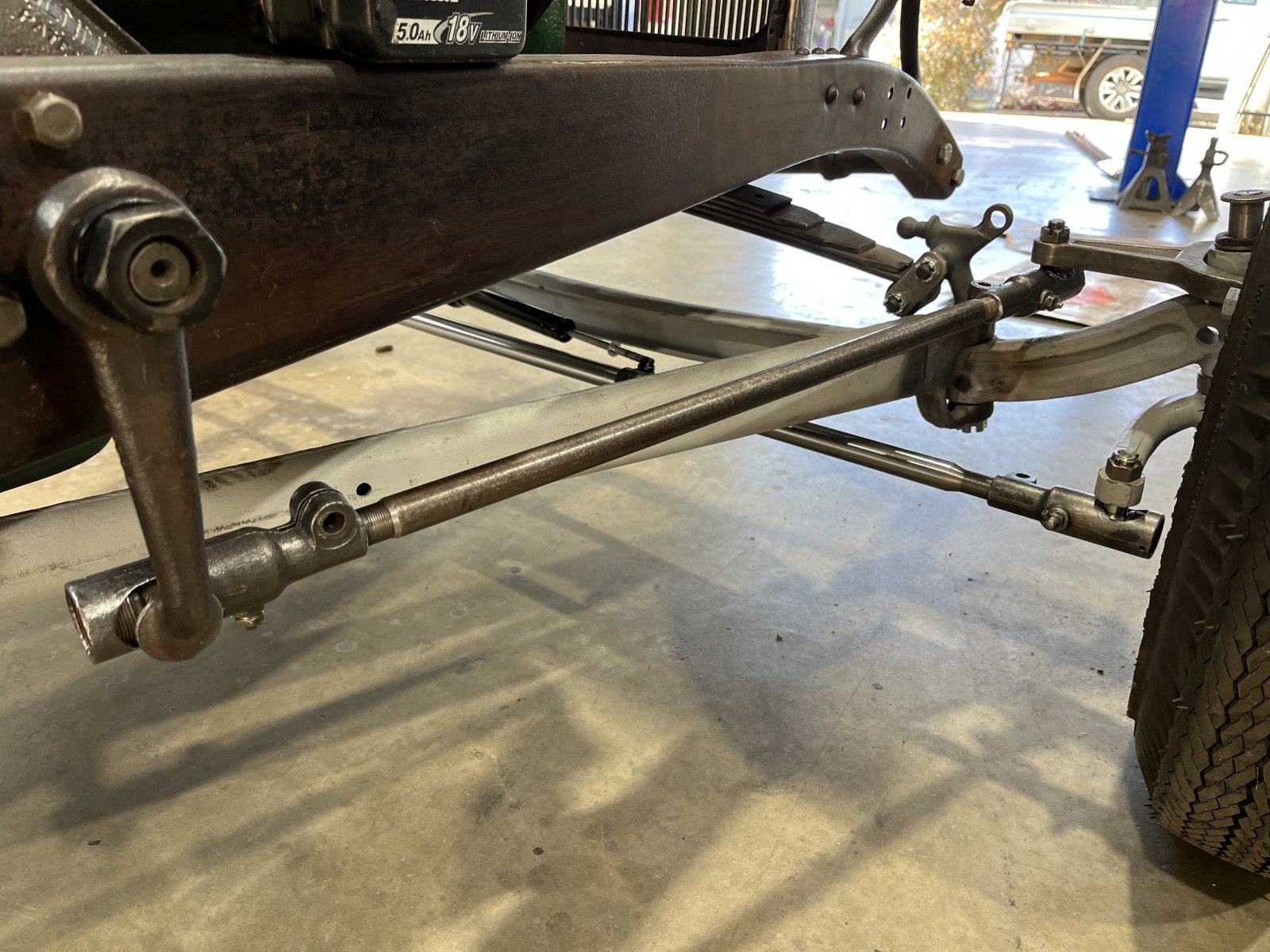

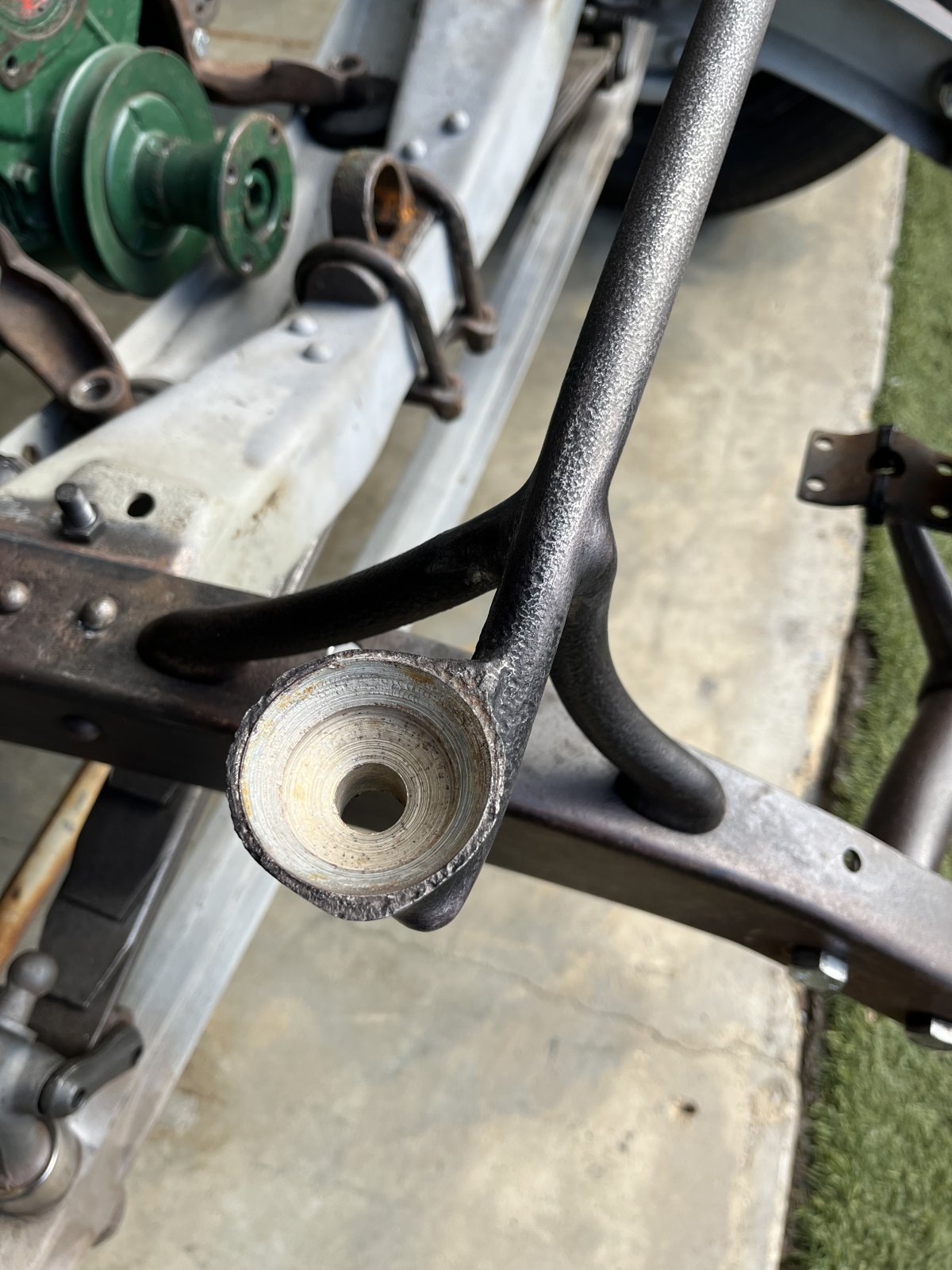

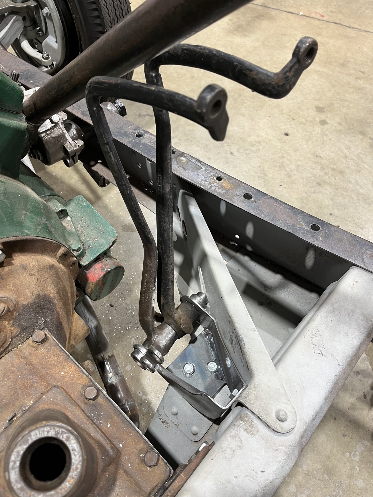

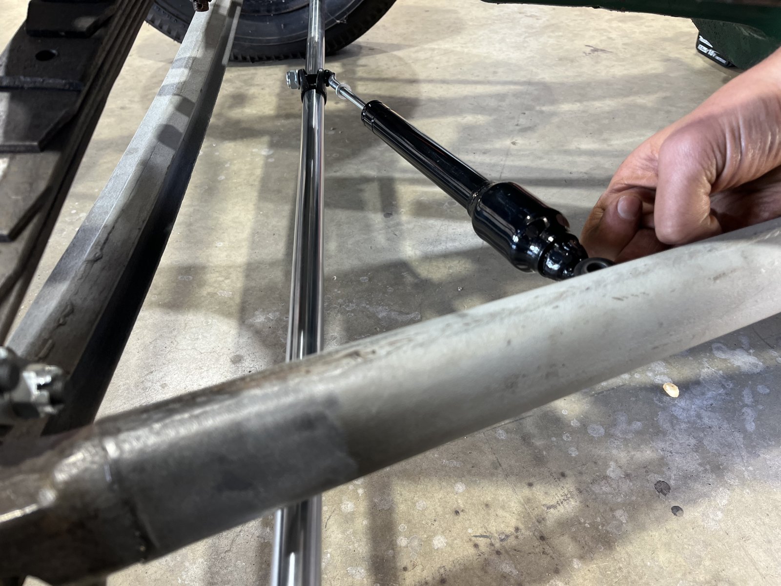

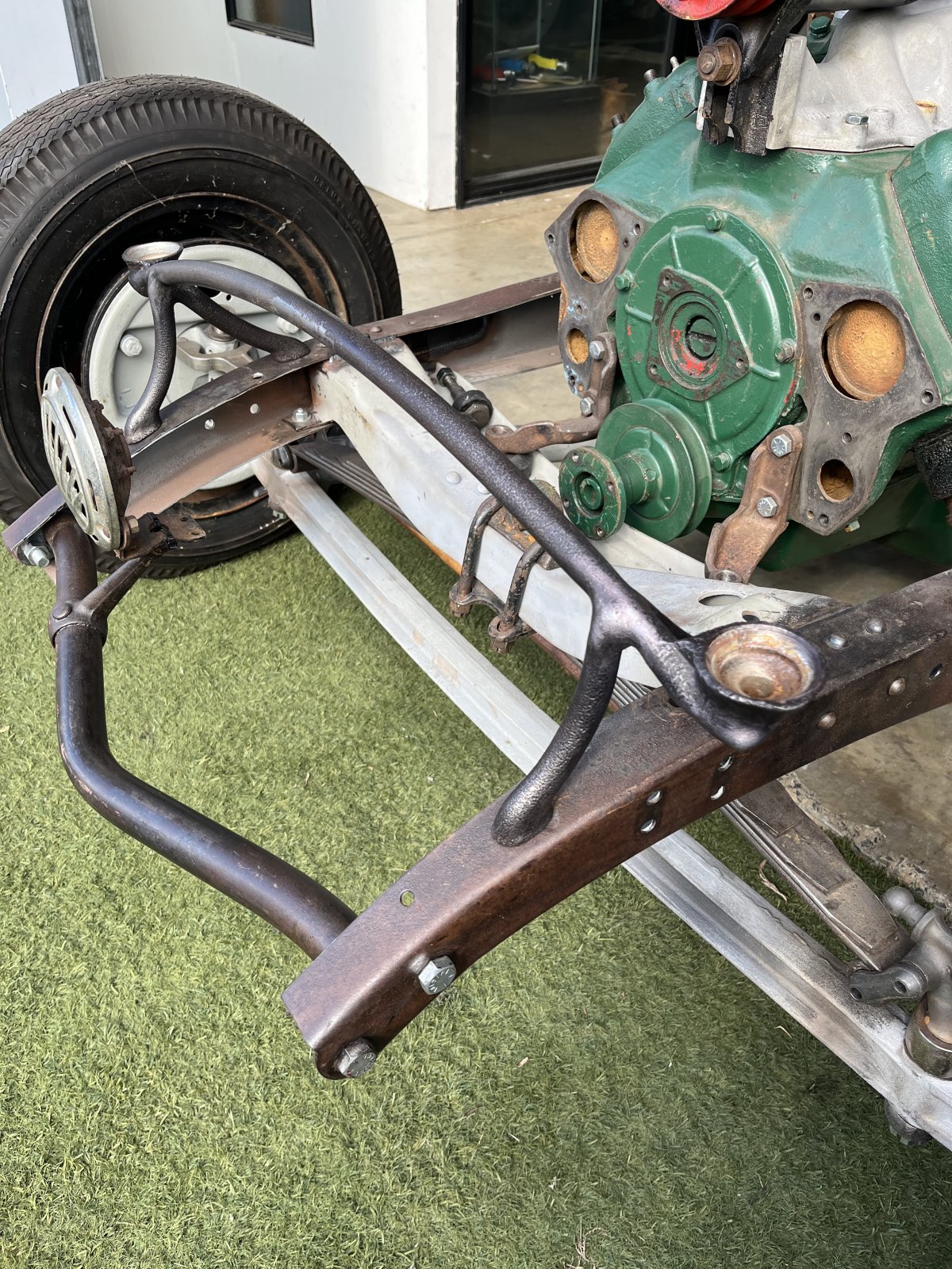

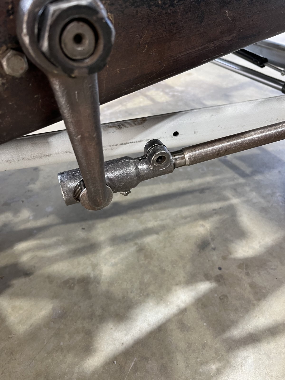

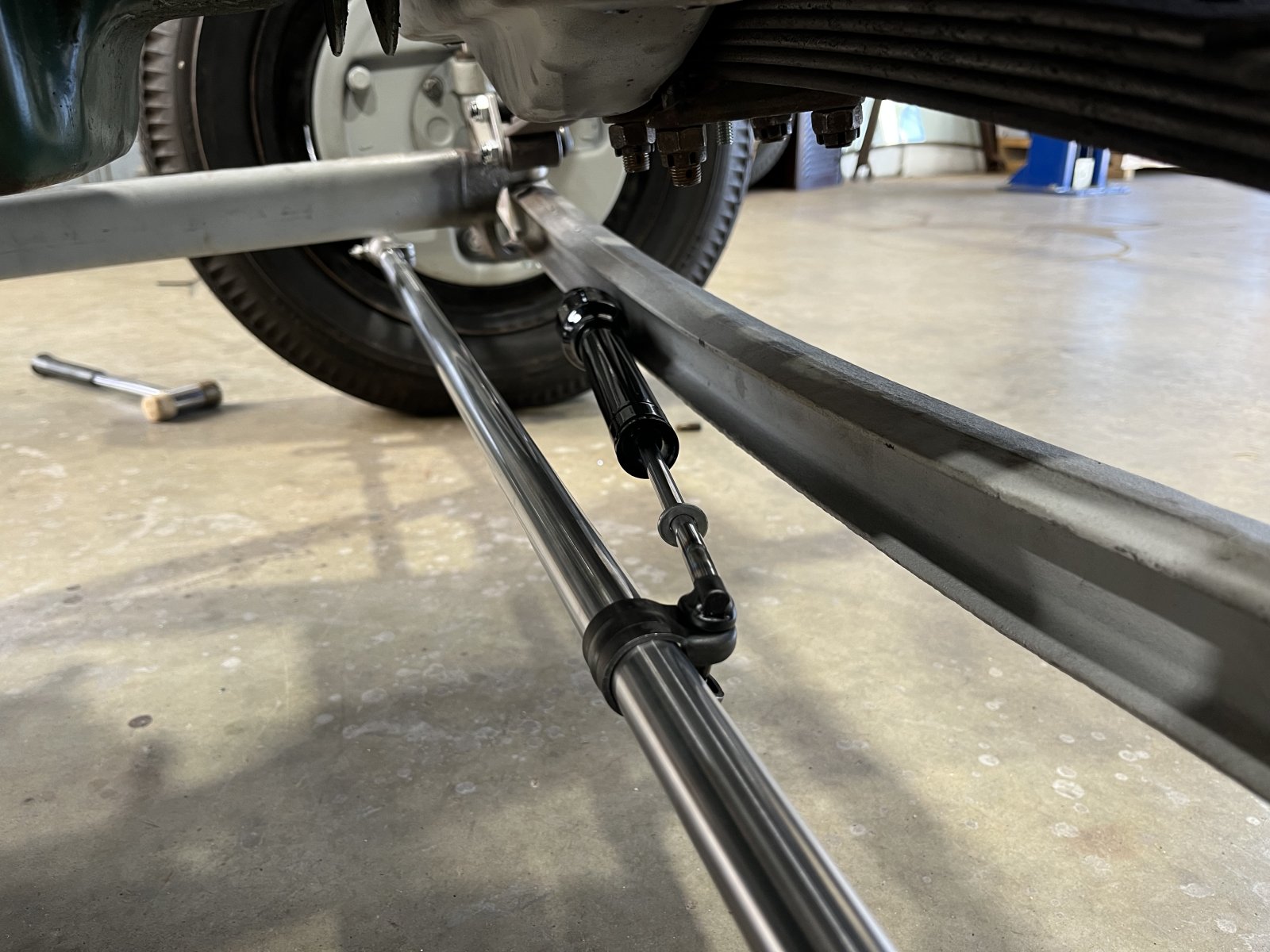

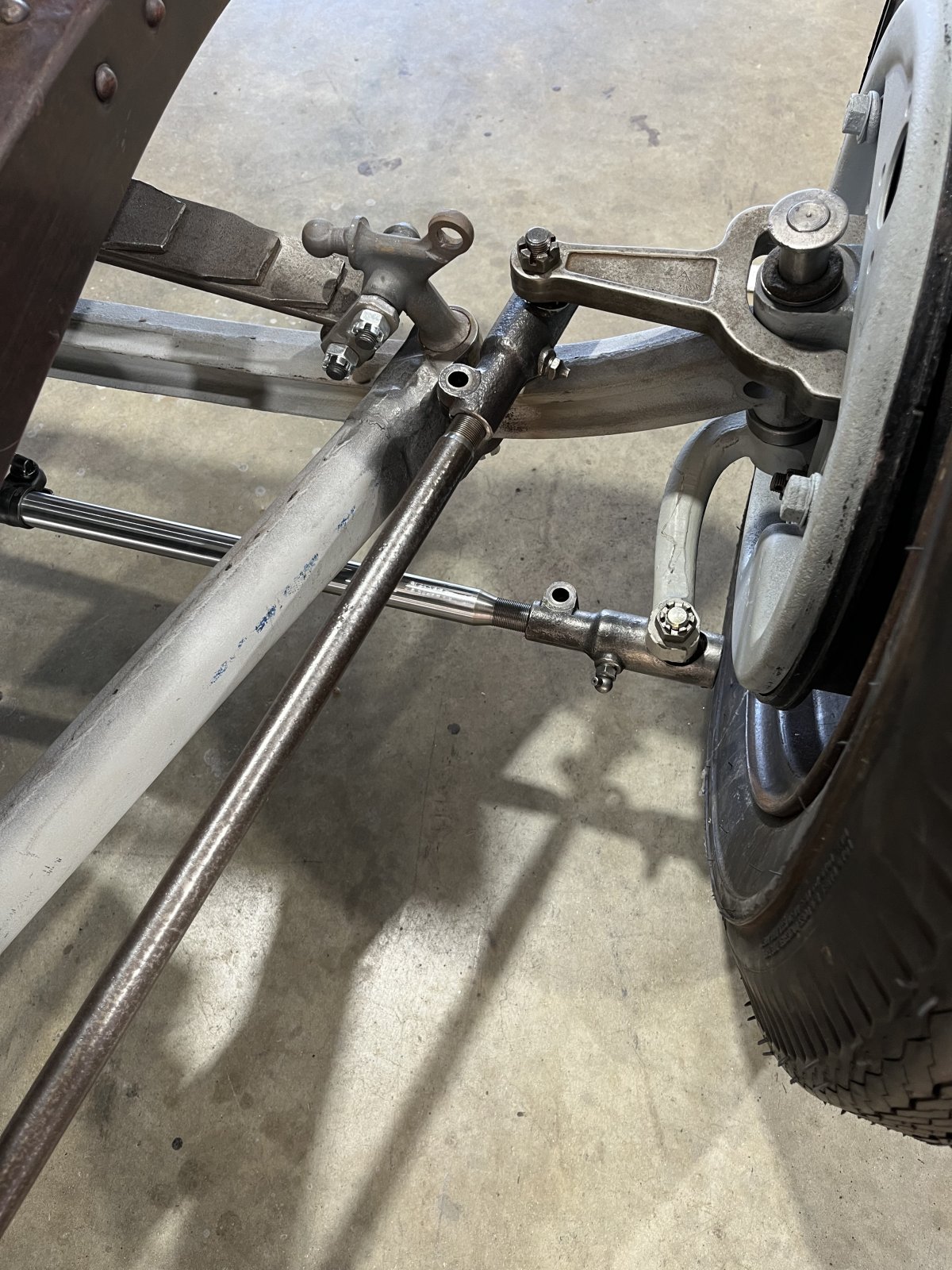

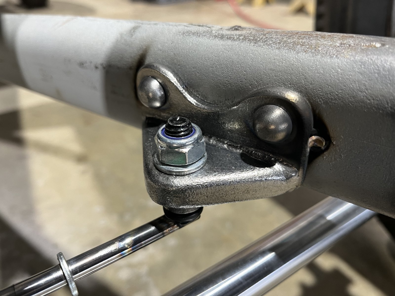

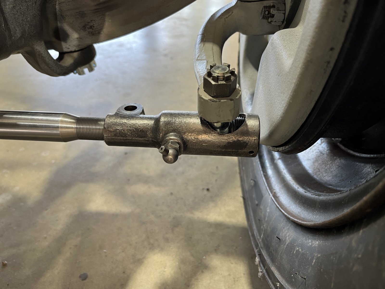

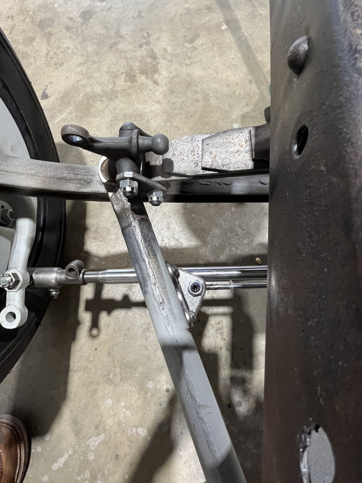

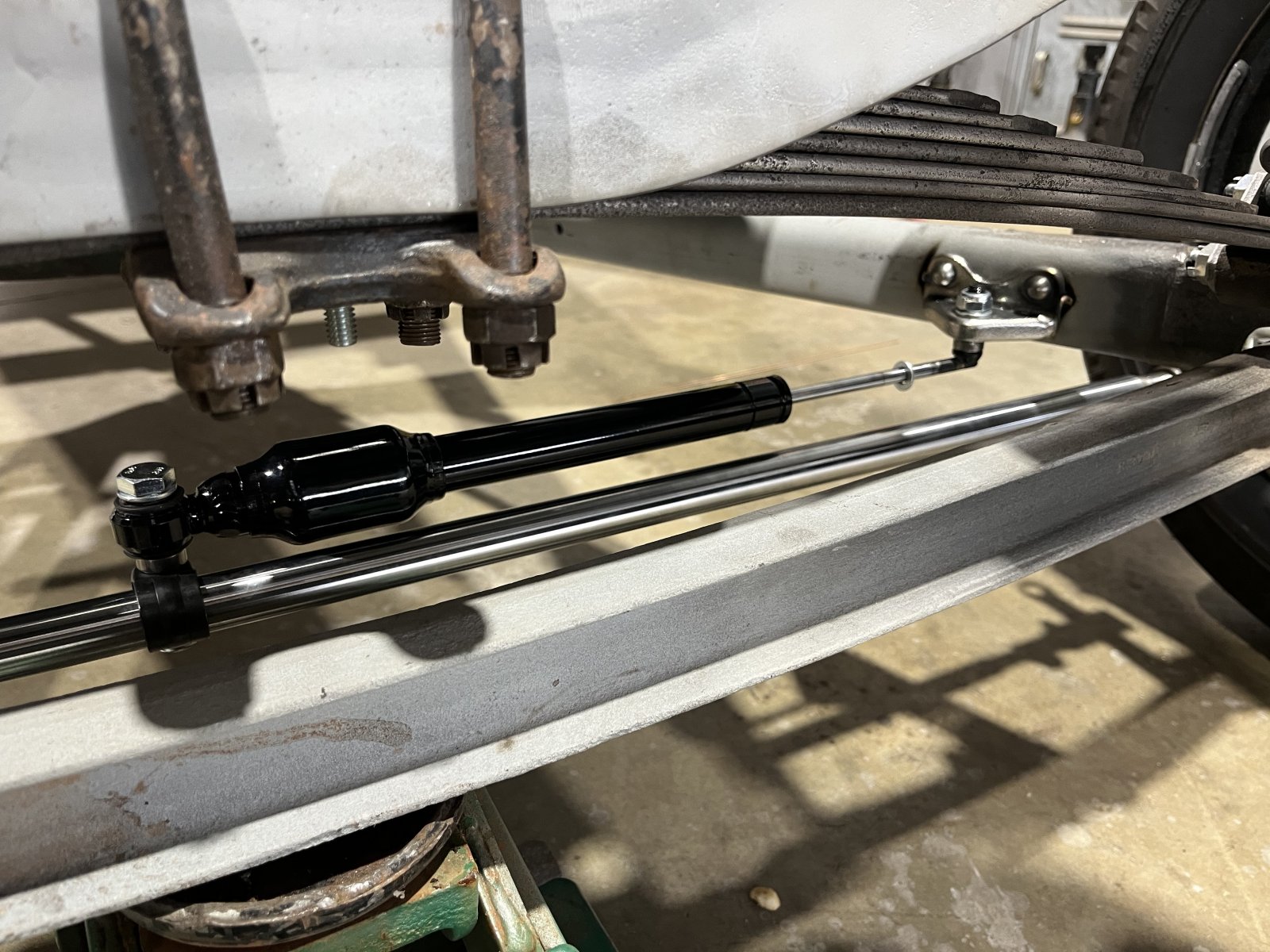

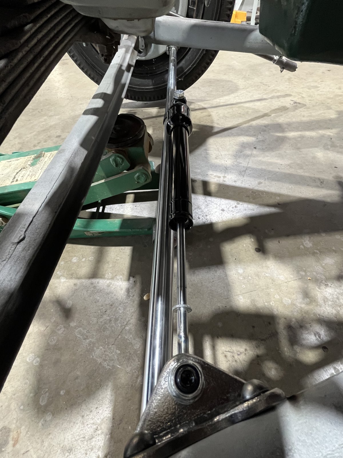

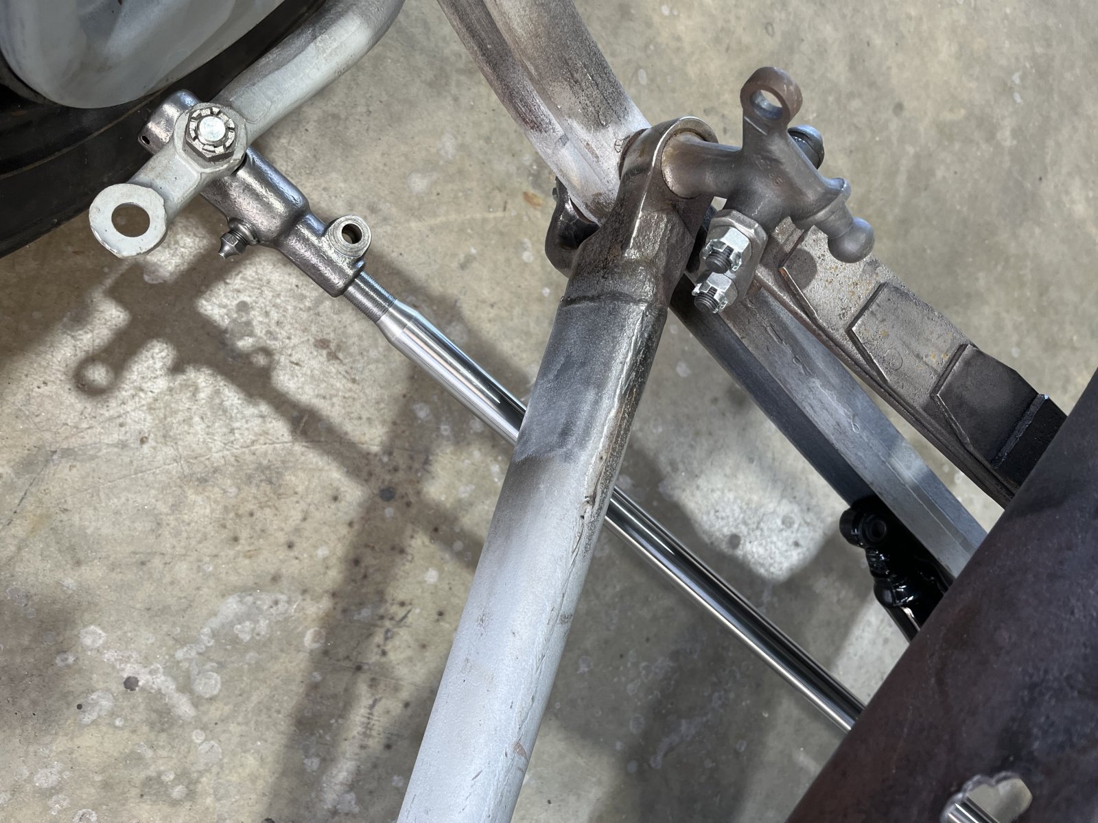

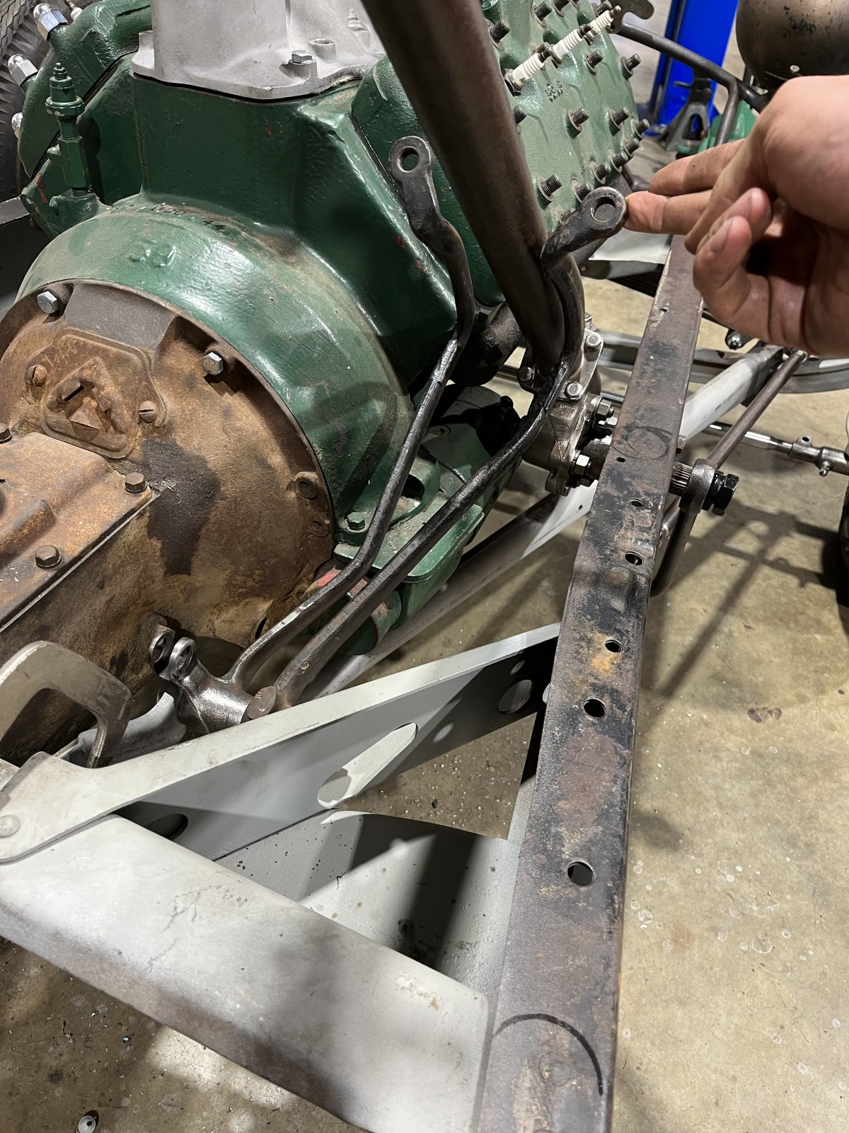

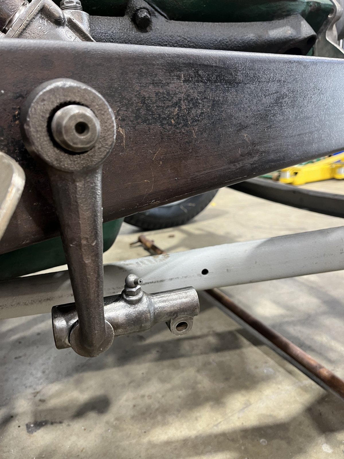

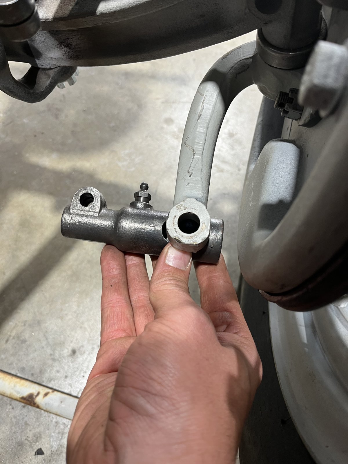

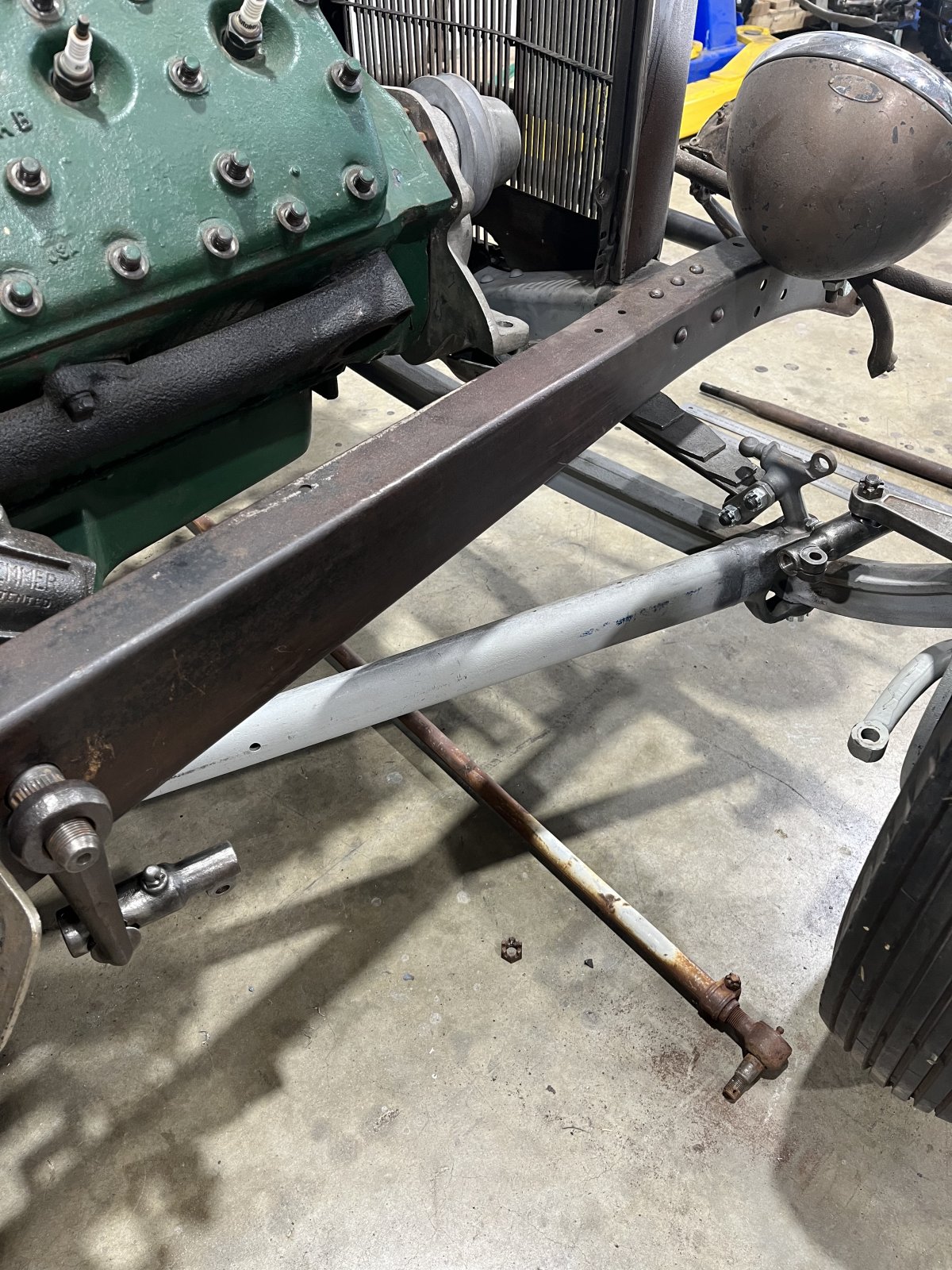

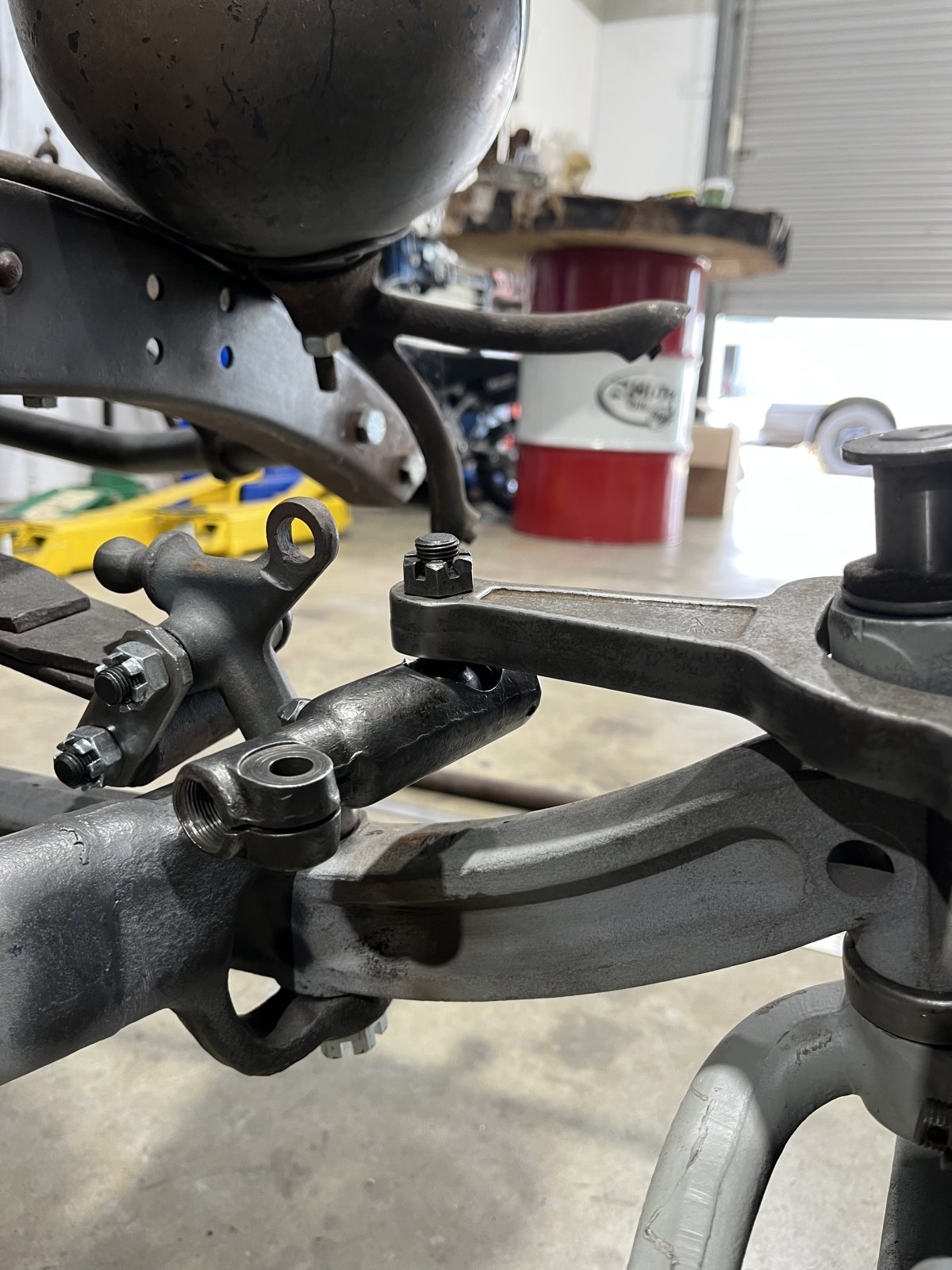

  10. I heated and bent the headlight cups and started working on the steering. Running early ends and got the cross steer and drag link loosely mocked up, playing around with ideas for a steering stabilizer. I’ve never run one on my early stuff but thought it would help! Maybe not traditional but functional?

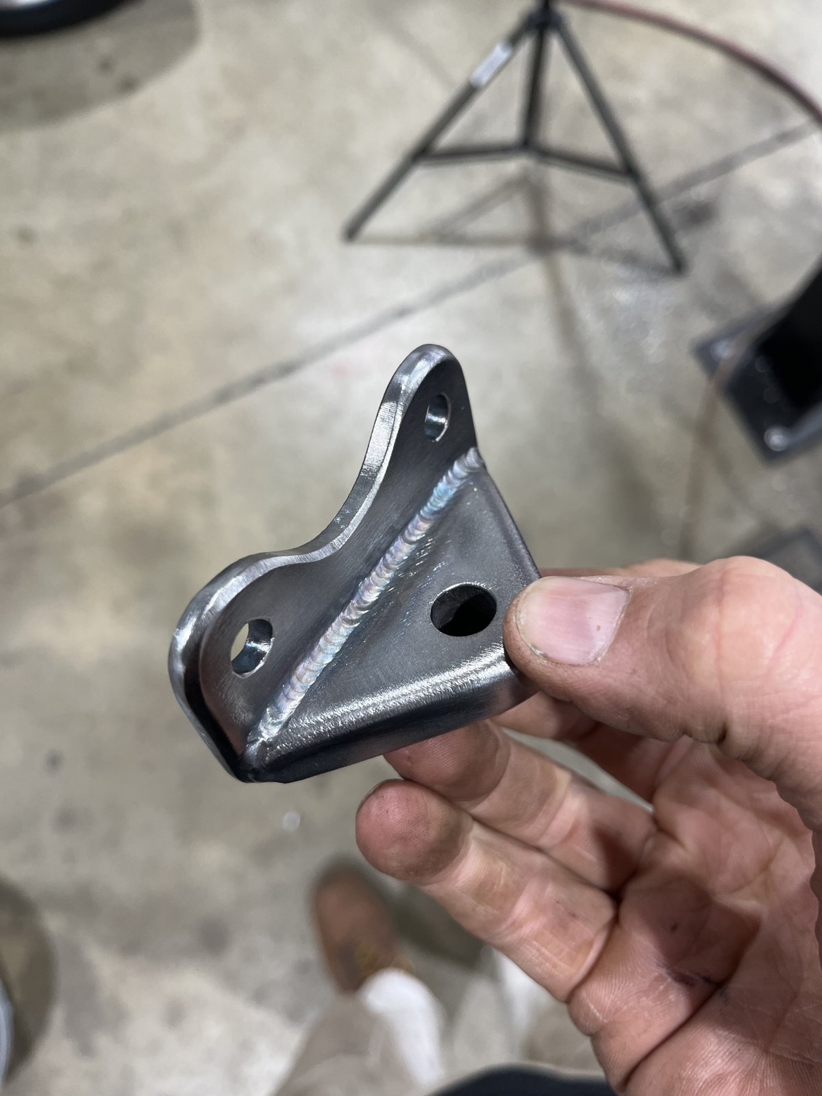

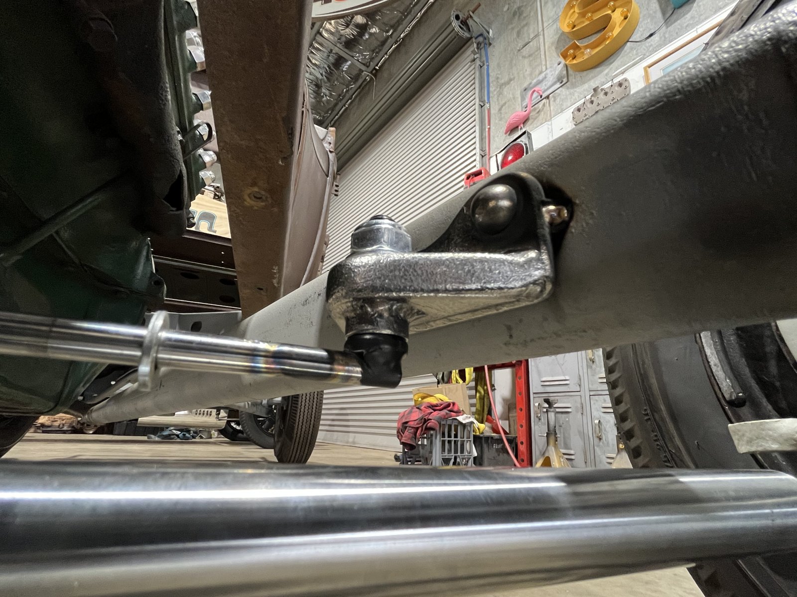

    My stabilizer bolts to a pivot on the wishbone, but it is parallel to the tie rod. I don’t think it makes a difference which side it connects to.
    Jeff34 likes this.
  12. Yeah I think that’s what I will do too and try and make one sort of cool mount!

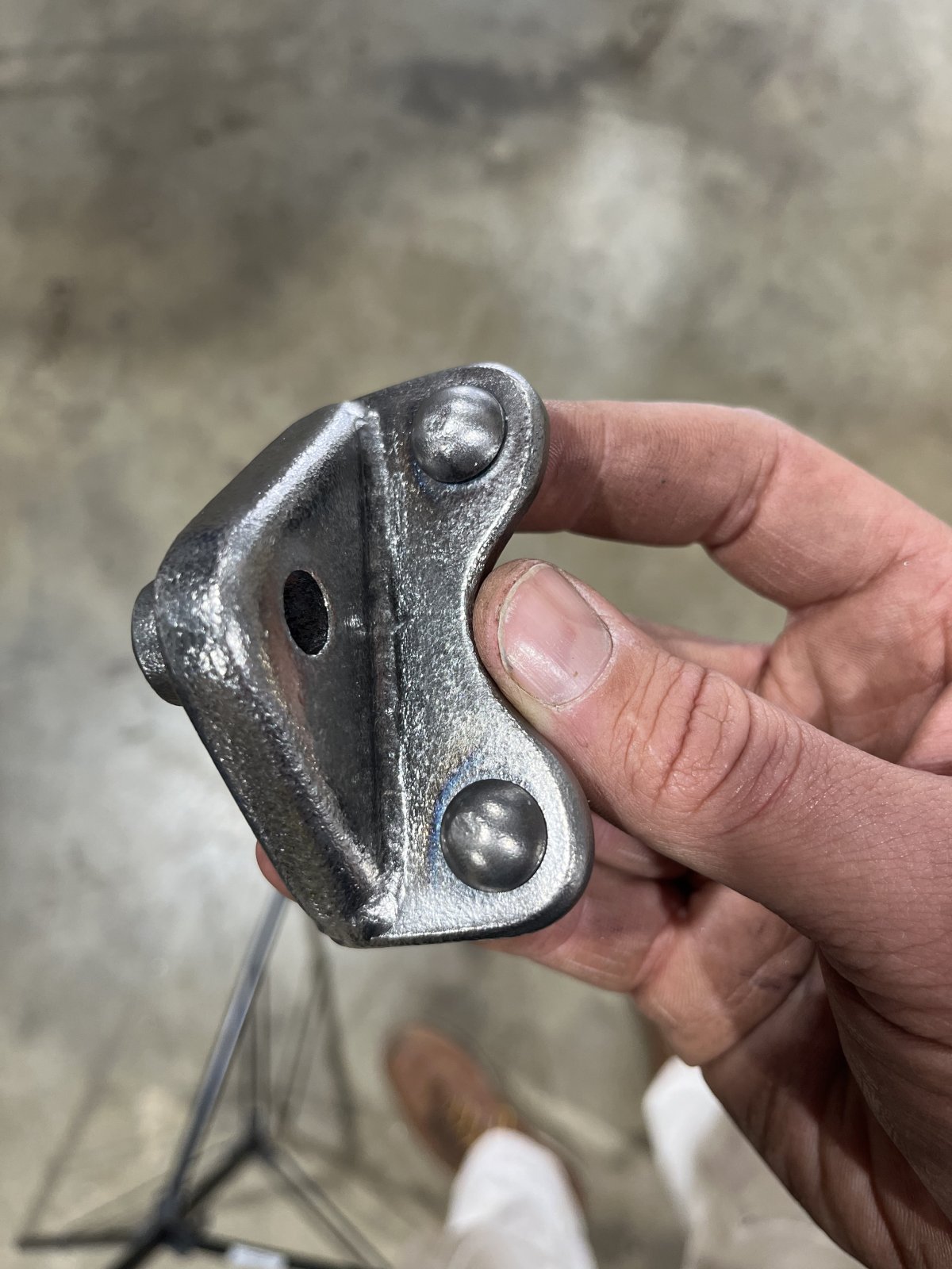

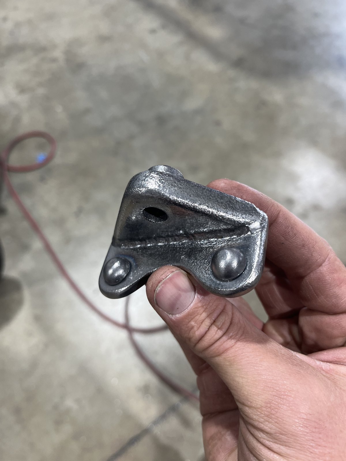

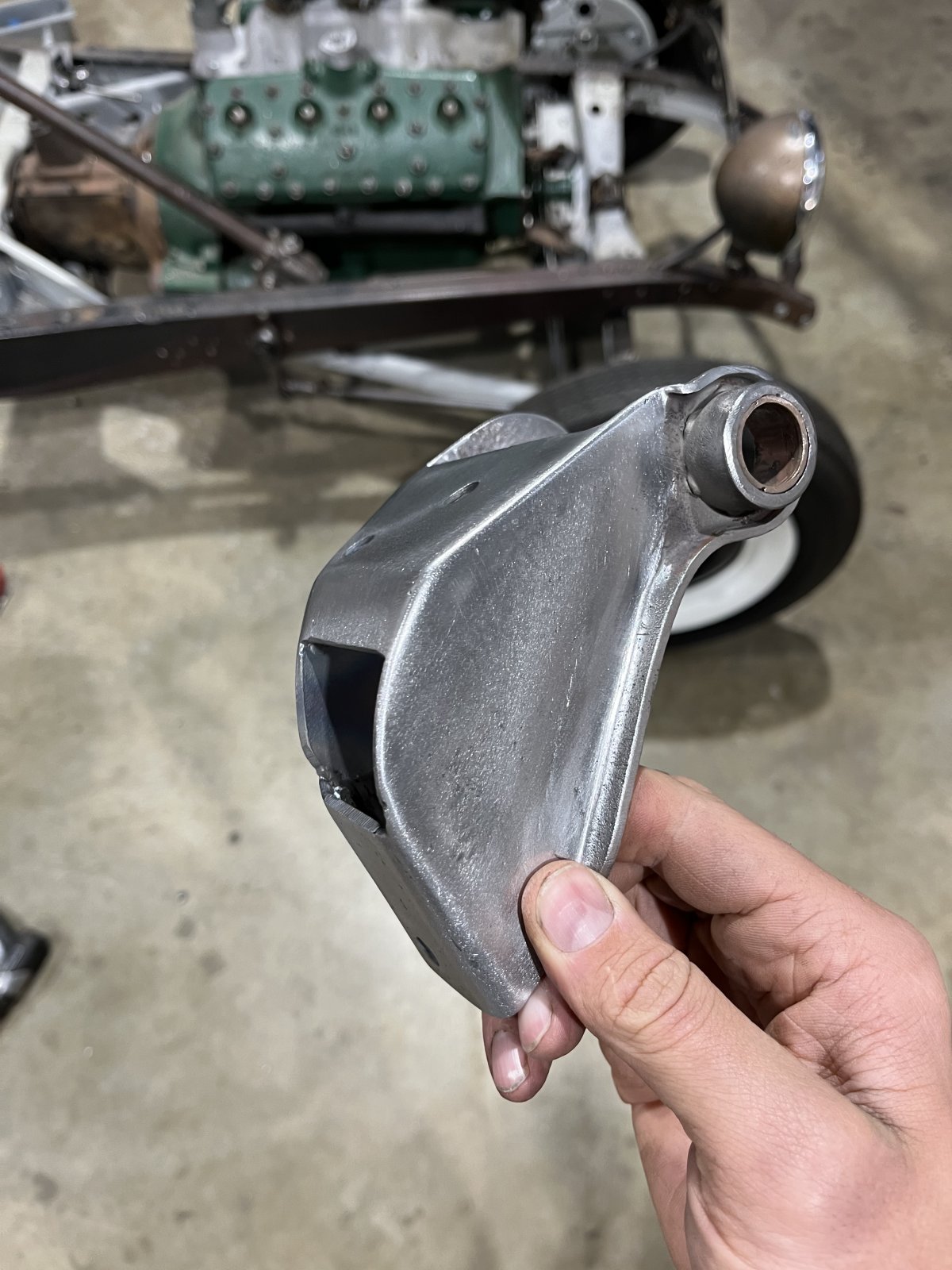

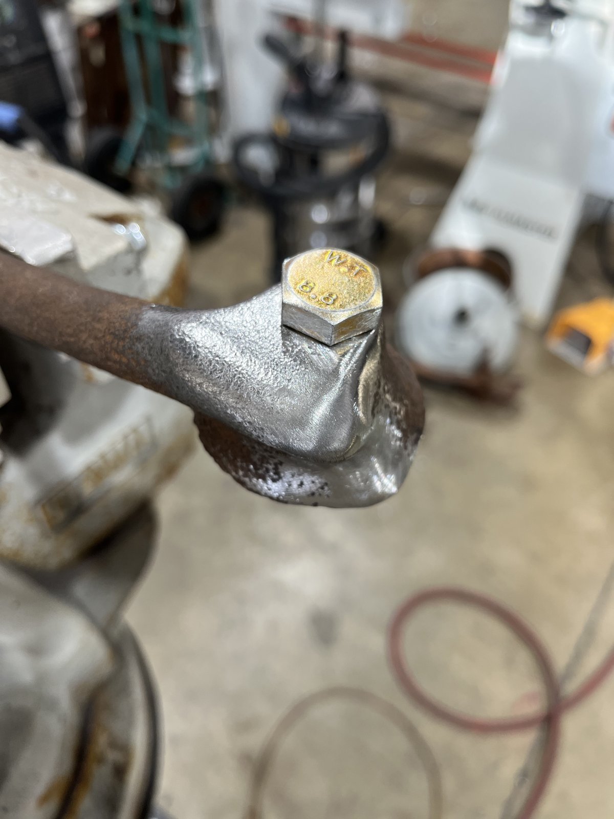

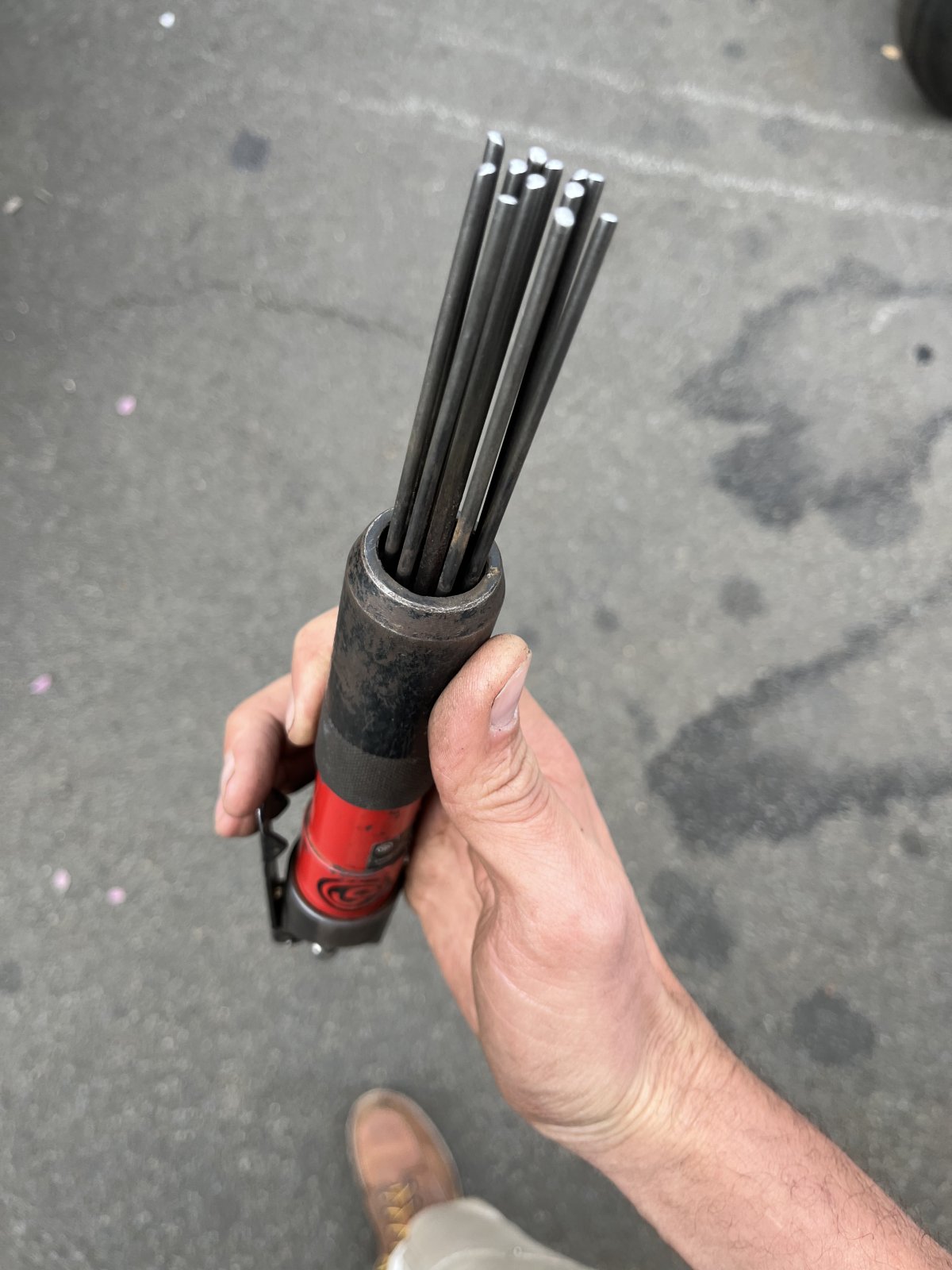

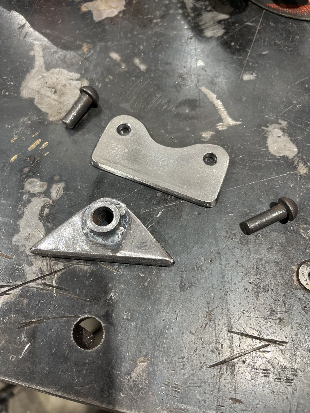

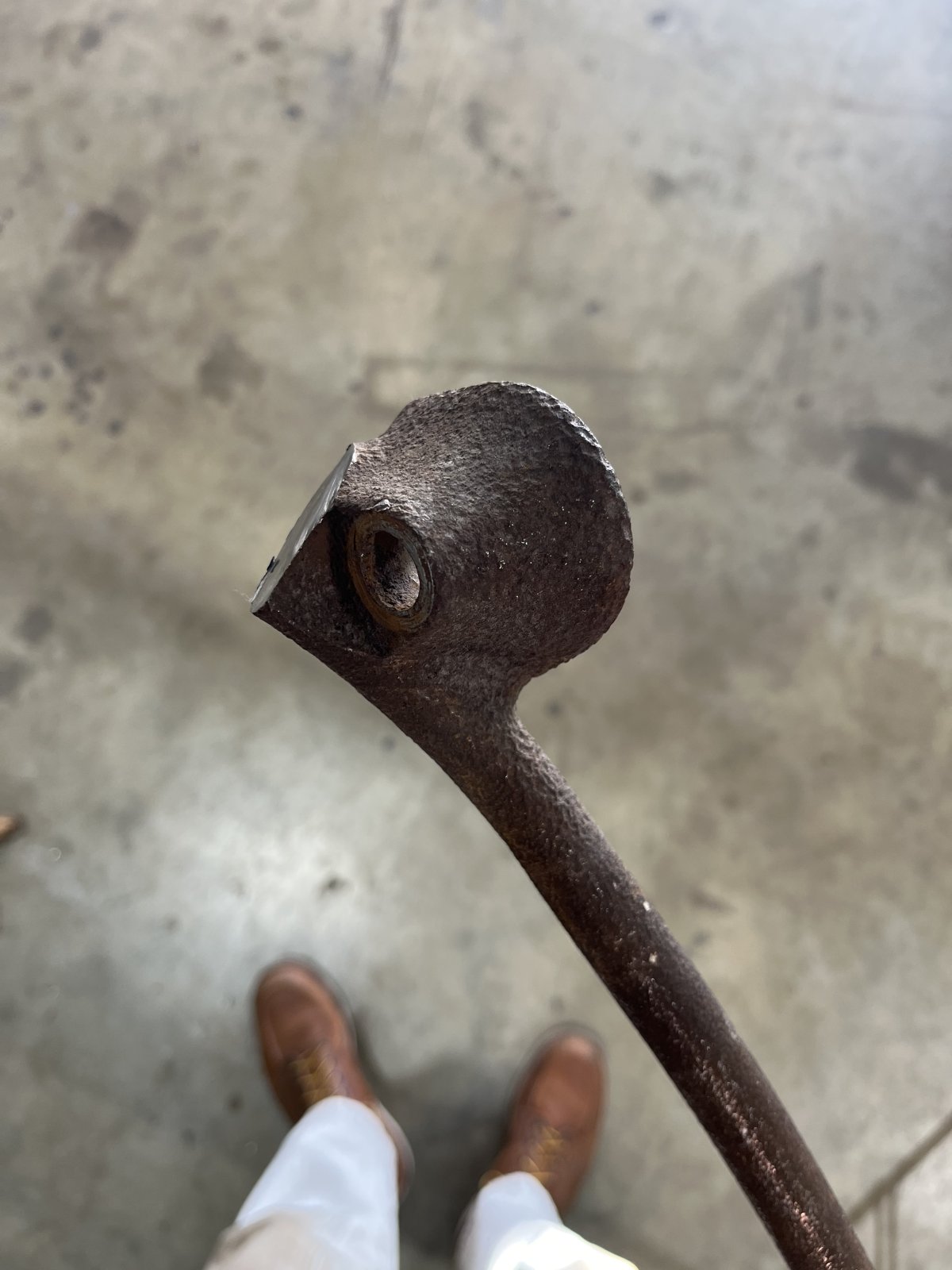

  13. Made a simple brakes to hold the steering stabilizer. I used the needle scaler to texture it to resemble cast, still learning about this one. But overall happy with the steering setup so far

    Looking good. Those headlight
    Lenses are fantastic!

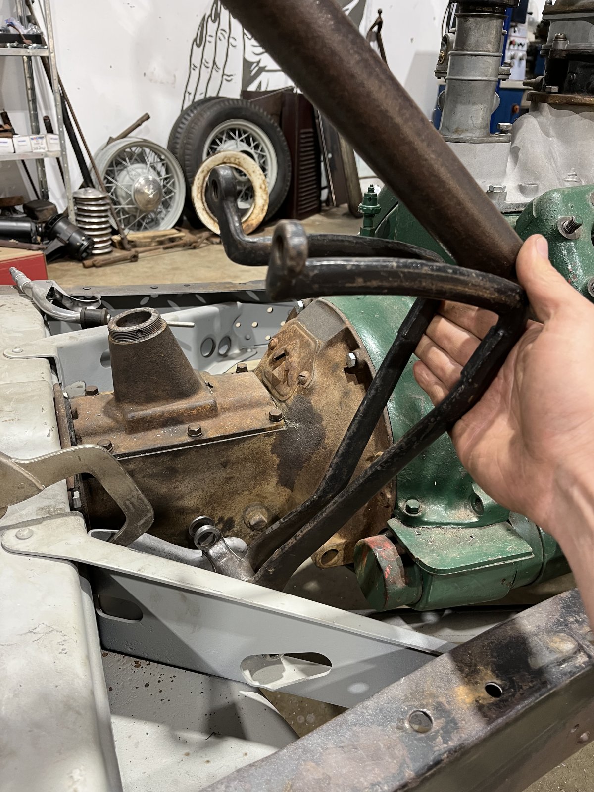

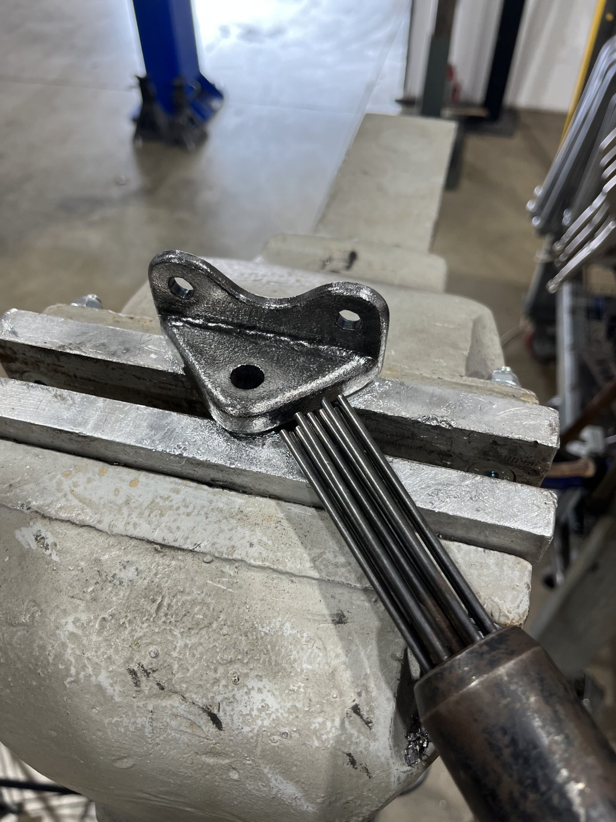

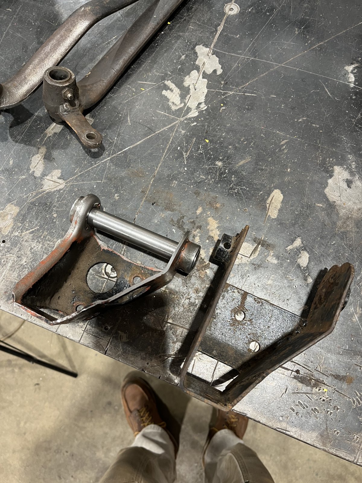

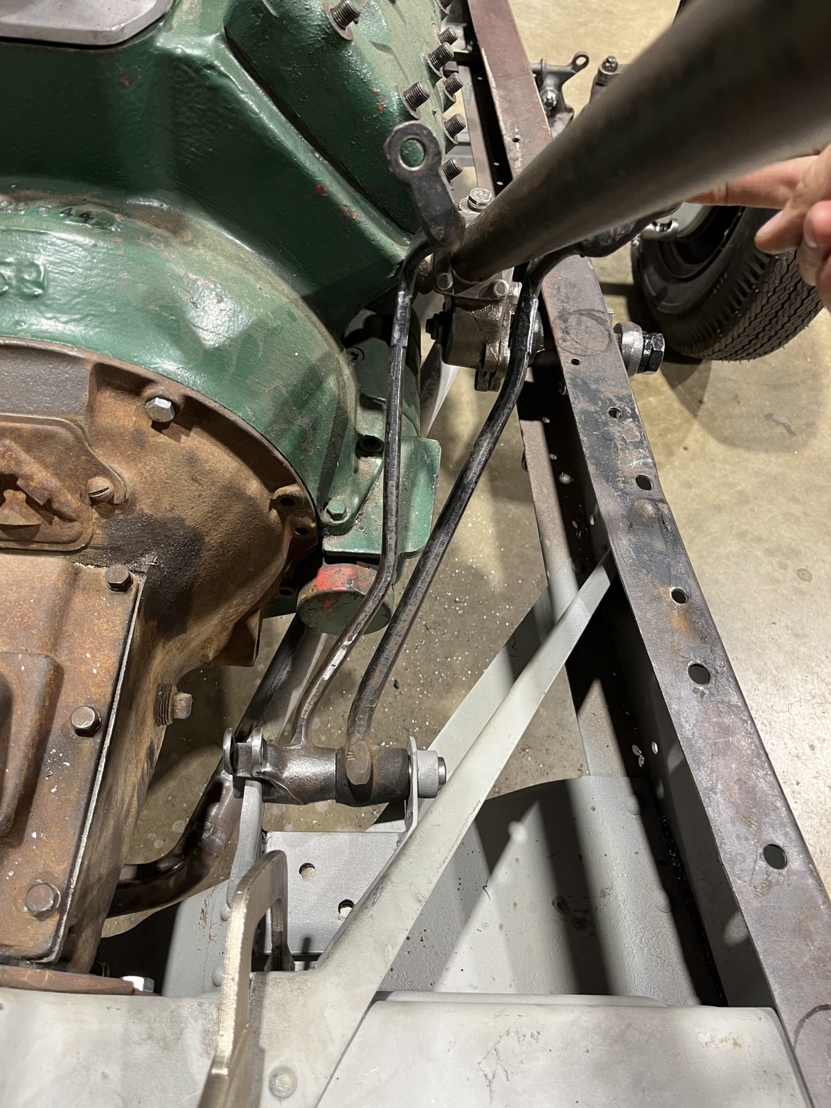

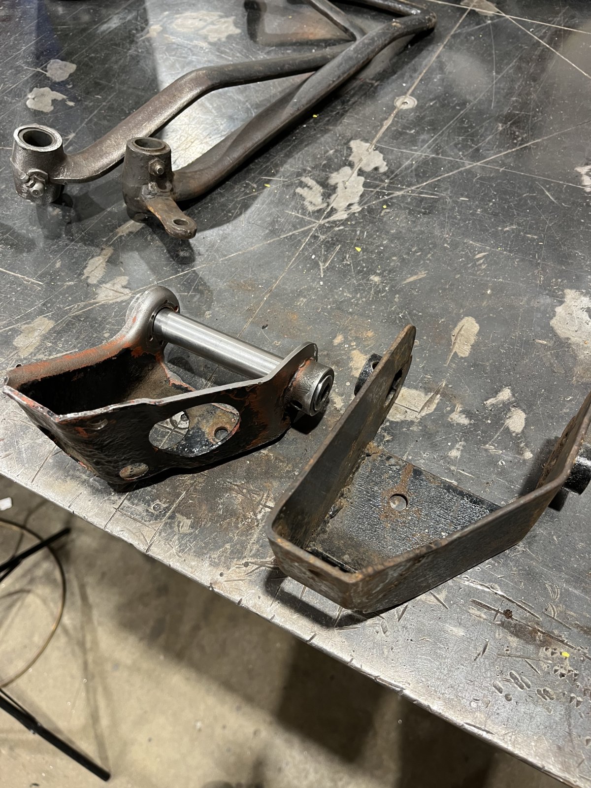

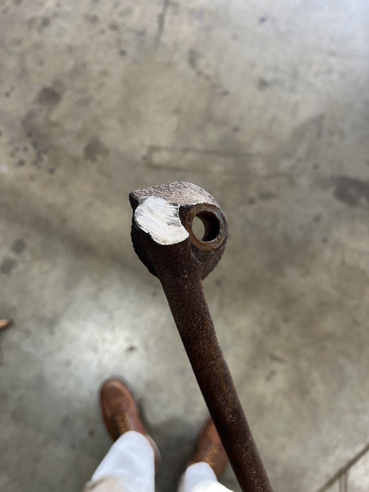

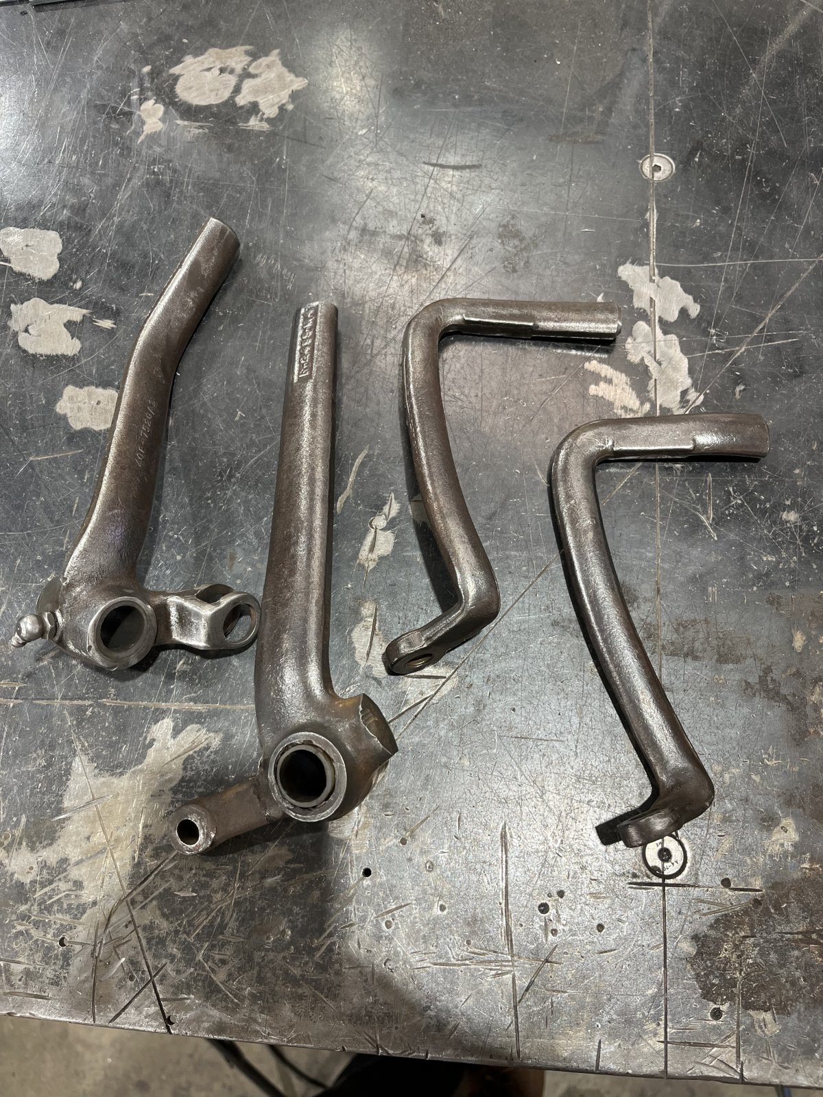

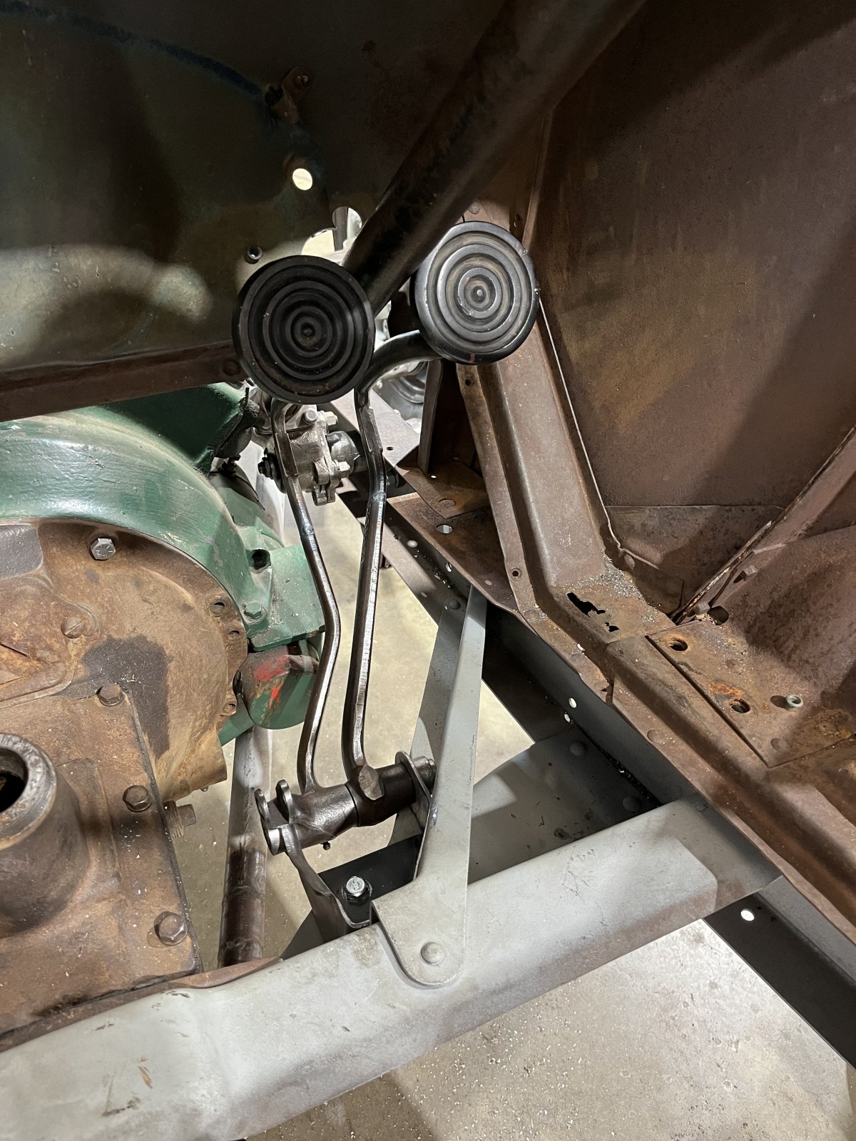

  15. Hard to find a factory right hand drive 32 pedal****embly over here. And if you can they want a small mortgage.
    I’ve opted for 33/34 pedals. And an old bracket an old guy made for the hotrod a long time ago. I took both and made one. It still needs attention but rather than making a complete new one I like that it has a bit of the old one that he created too!

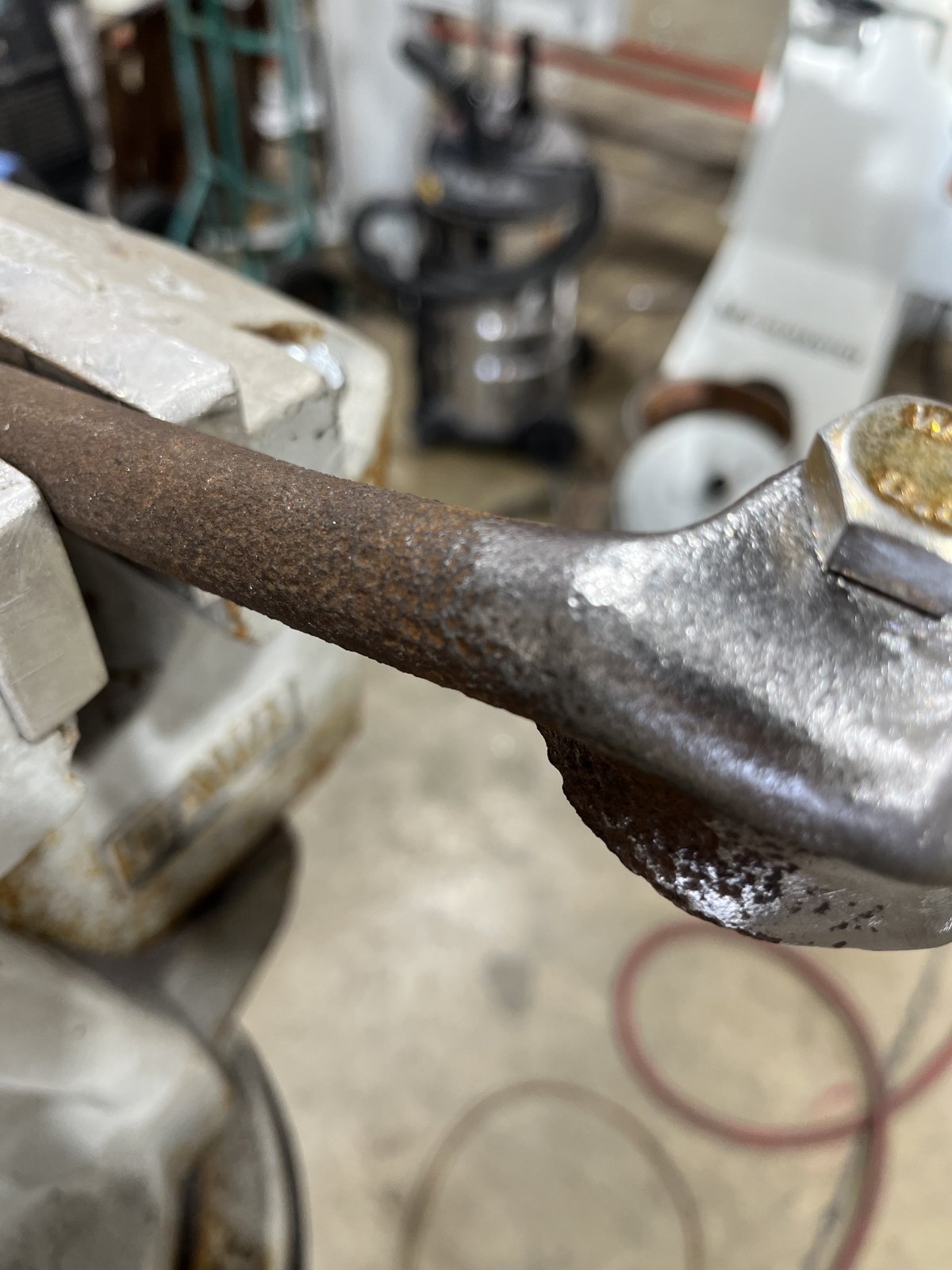

    Knowing your still under construction & certain your aware that Ford utilized a rubber with a metal retainer for the tie rod ends available from several sources, not sure but should work on your draglink as well to seal things up a bit, like the direction your project is going for sure.
    Outback likes this.
  17. Thanks mate! You’re right they do have them. They are sitting on the shelf ready for final****embly
  18. Finished smoothing out our bracket and started shortening and bending the 33/34 pedals to fit. 87B1763F-2461-4D08-B76A-538E5C79547B.jpeg E84AD972-288E-440D-B832-30B21D44EC96.jpeg 9A3D3323-0E44-467A-AA34-FC066AC5BE00.jpeg D7D61B37-D255-4489-8C9D-59926A8D286A.jpeg 23A10486-EDA5-4E2B-BAF5-2837CCC7D7AA.jpeg 9C7E2A54-68EB-4C42-977A-F29FA1FD4A6C.jpeg

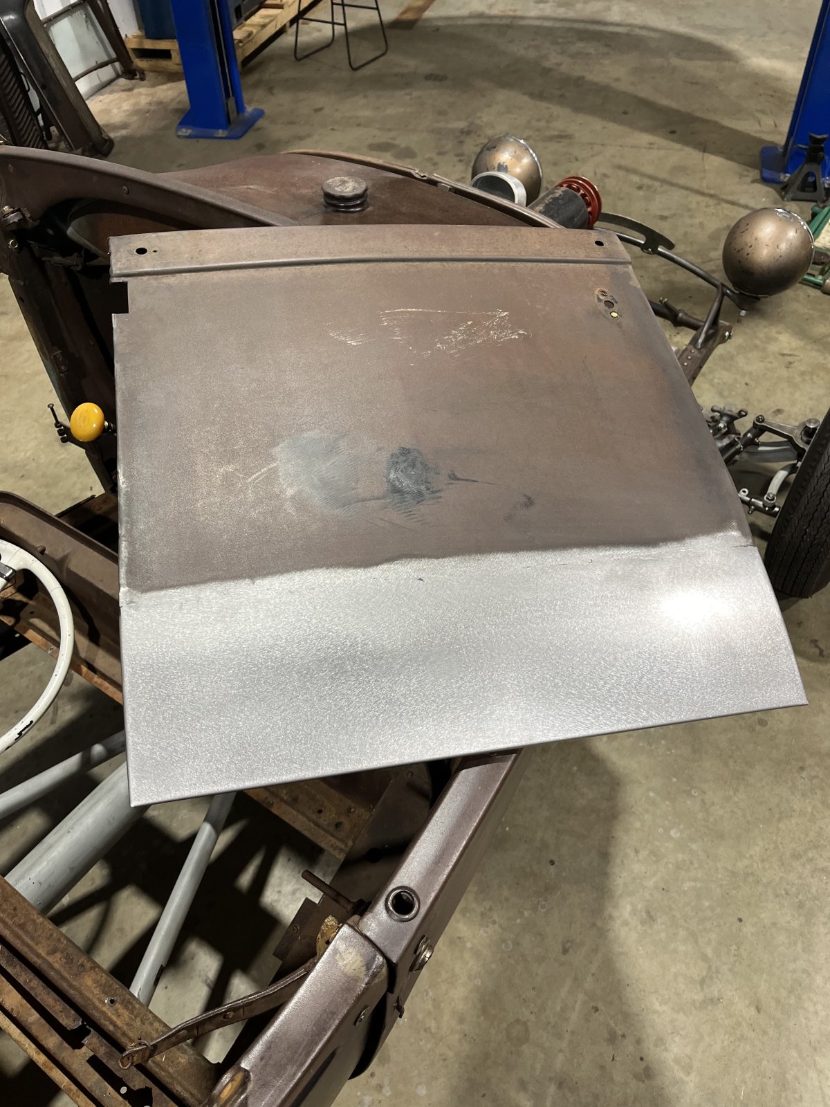

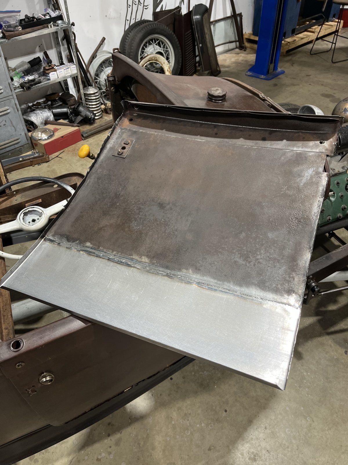

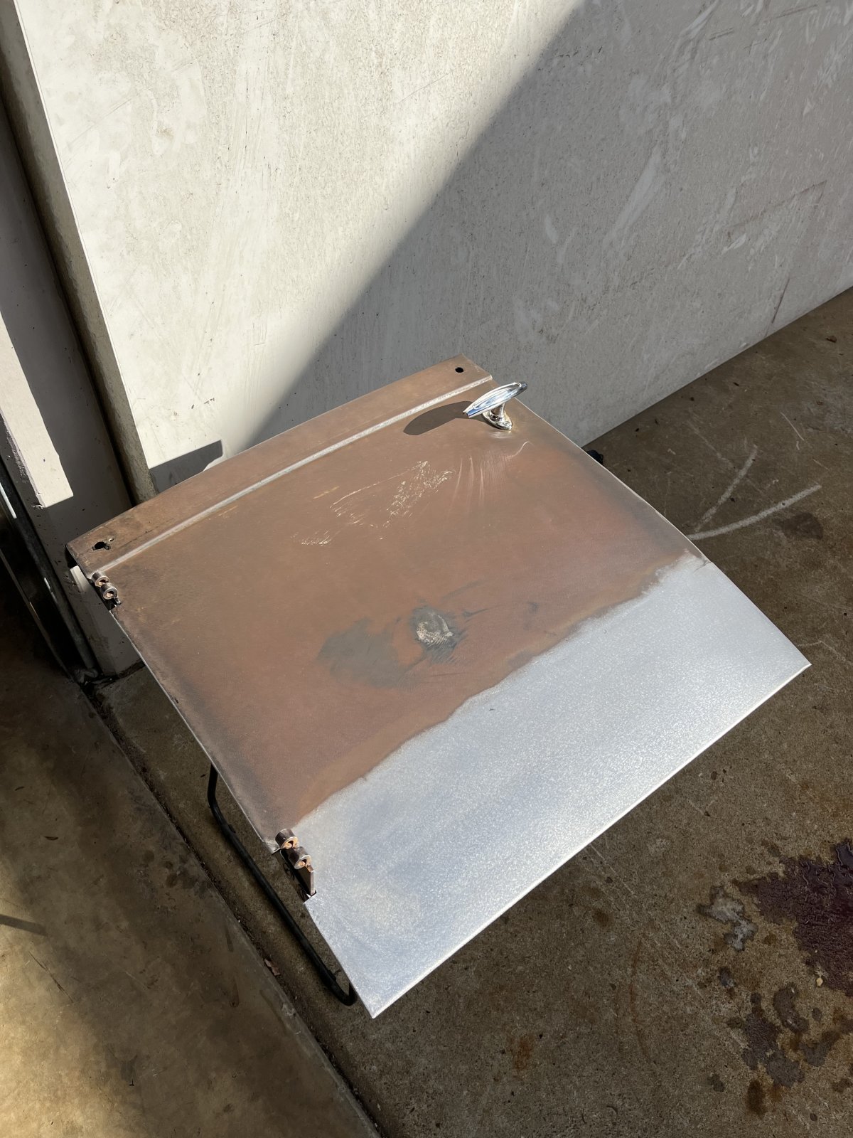

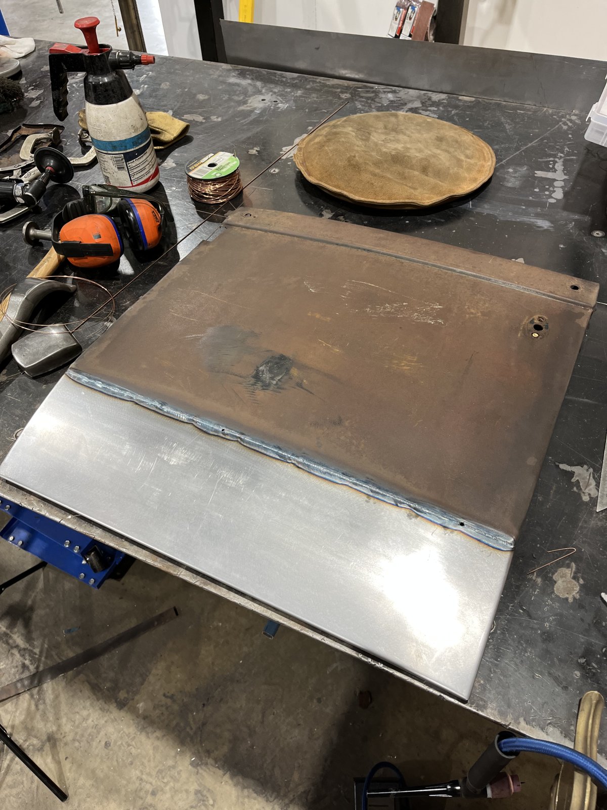

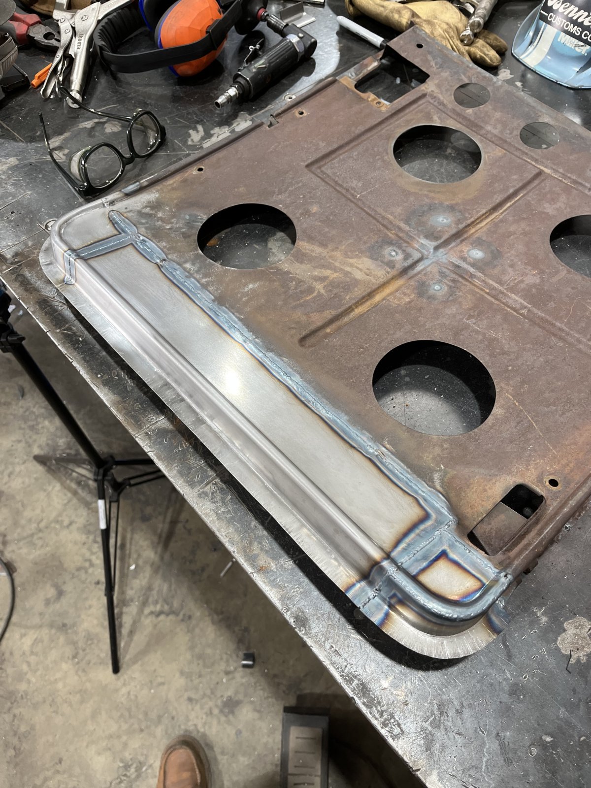

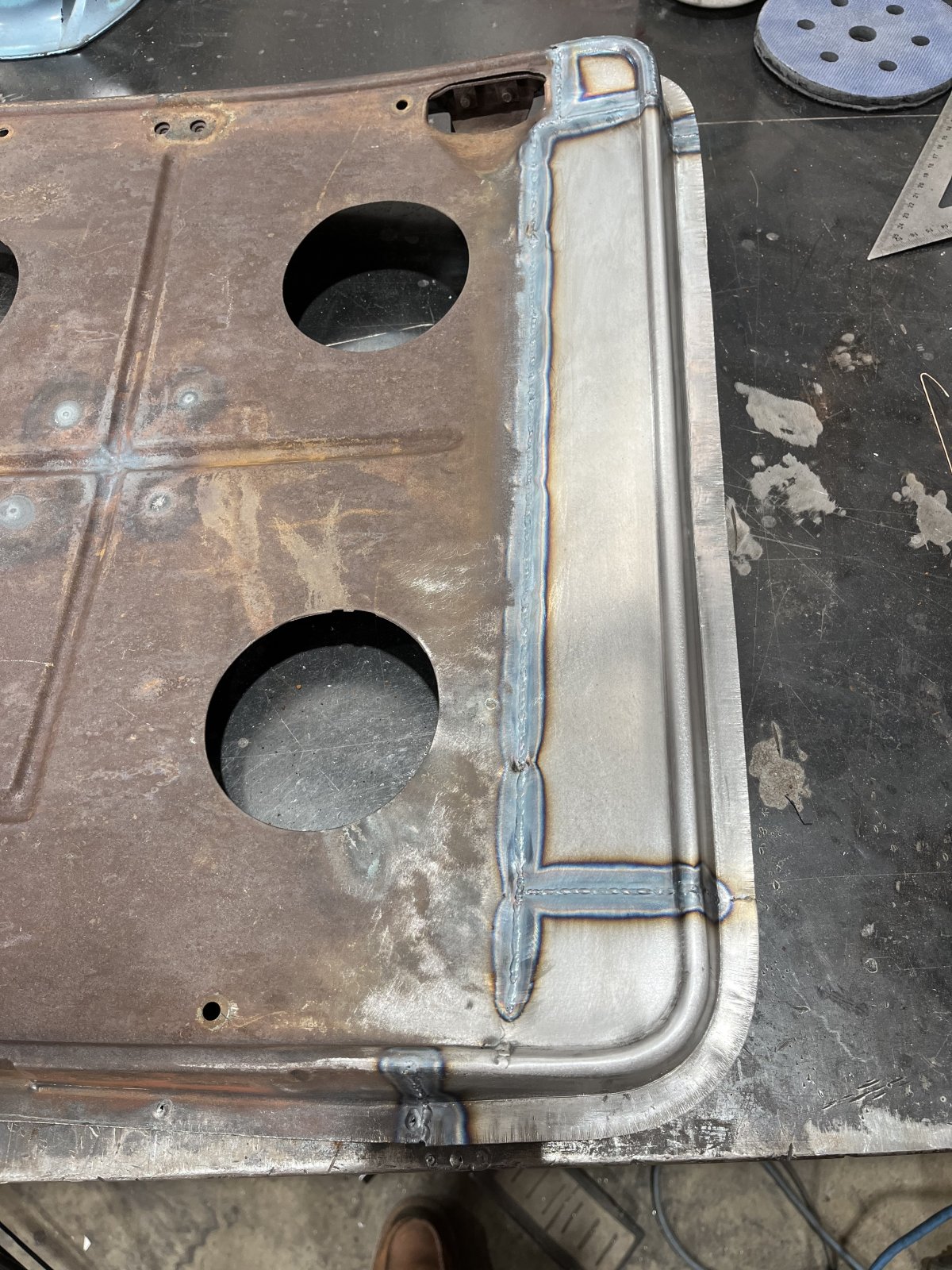

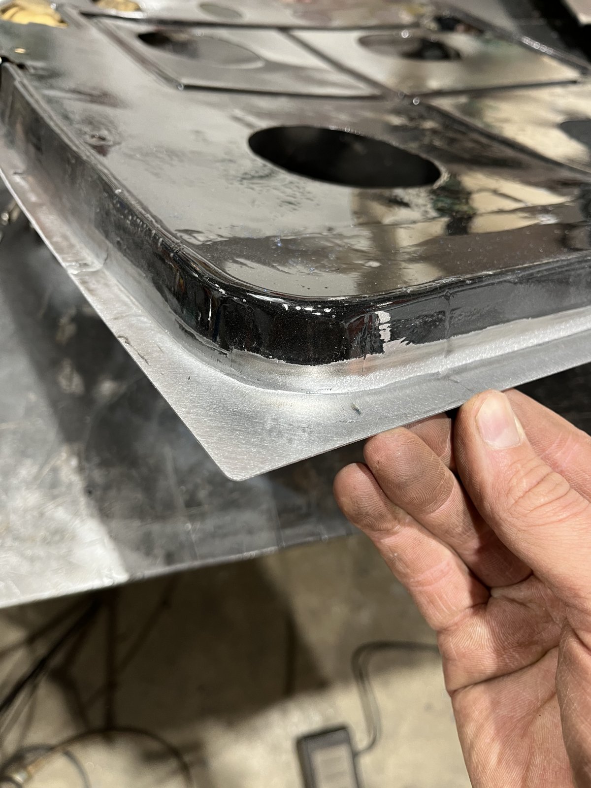

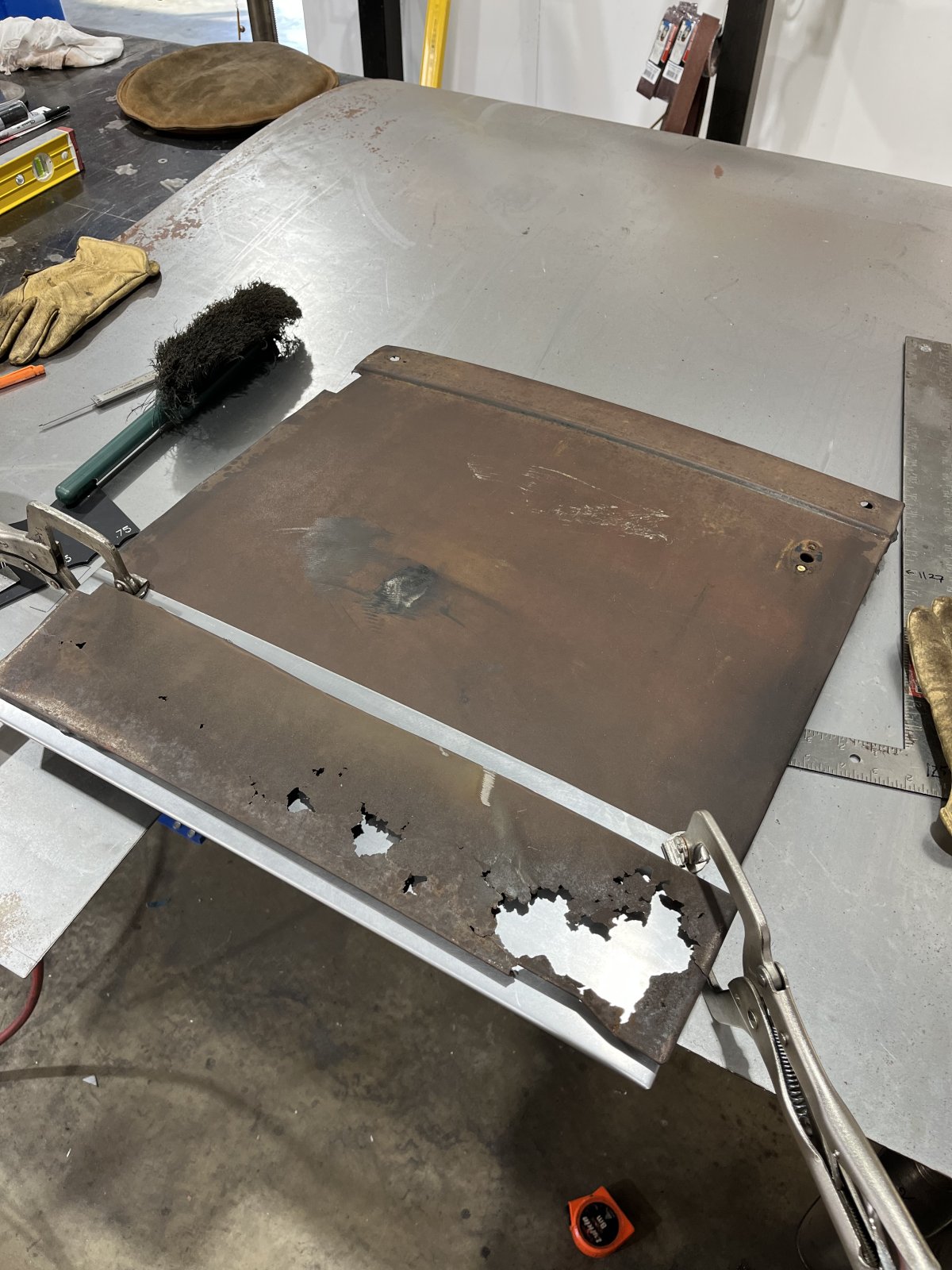

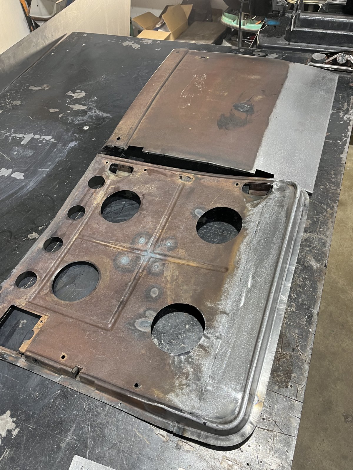

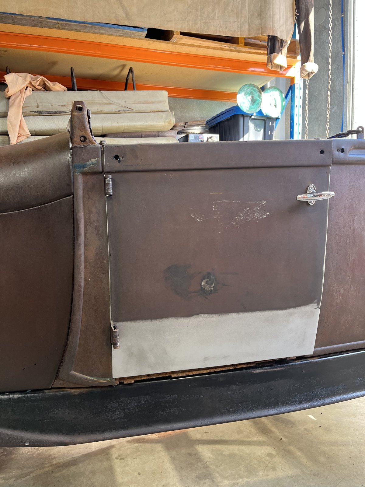

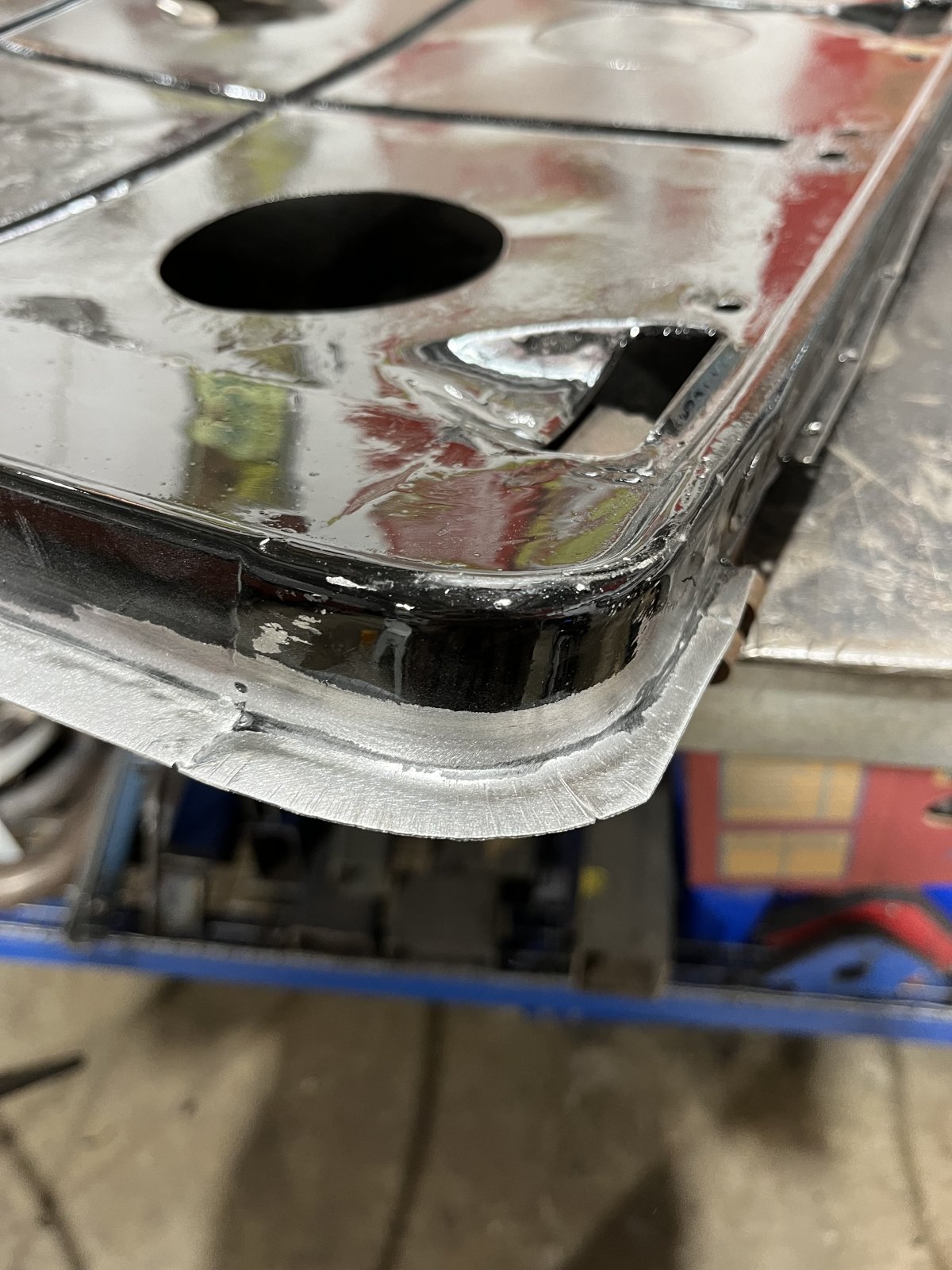

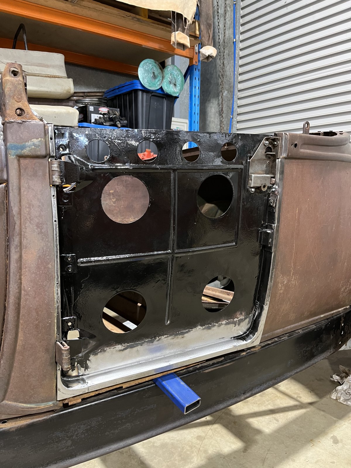

  19. Waiting for a few parts, decided to get the door straightened out and new lower skin, trying to retain as much original steel as possible. Next to finish the inner. And get these back on the car.
    7238AC62-51F9-419A-AD86-7E9D504C2081.jpeg FB82F51D-C5F4-4B93-87E1-C3DC9097DD82.jpeg BCD918CC-F83C-4F32-AFA7-9A64316C0C78.jpeg 93E8185F-2DFA-4F2F-8C86-01B714A7DDAB.jpeg 4CC8FEC6-0316-4995-B2A9-91365B1A5455.jpeg 94A21FC3-753C-4938-876D-2849FA7D5AD2.jpeg
    Joe Blow, 62pan, lurker mick and 2 others like this.

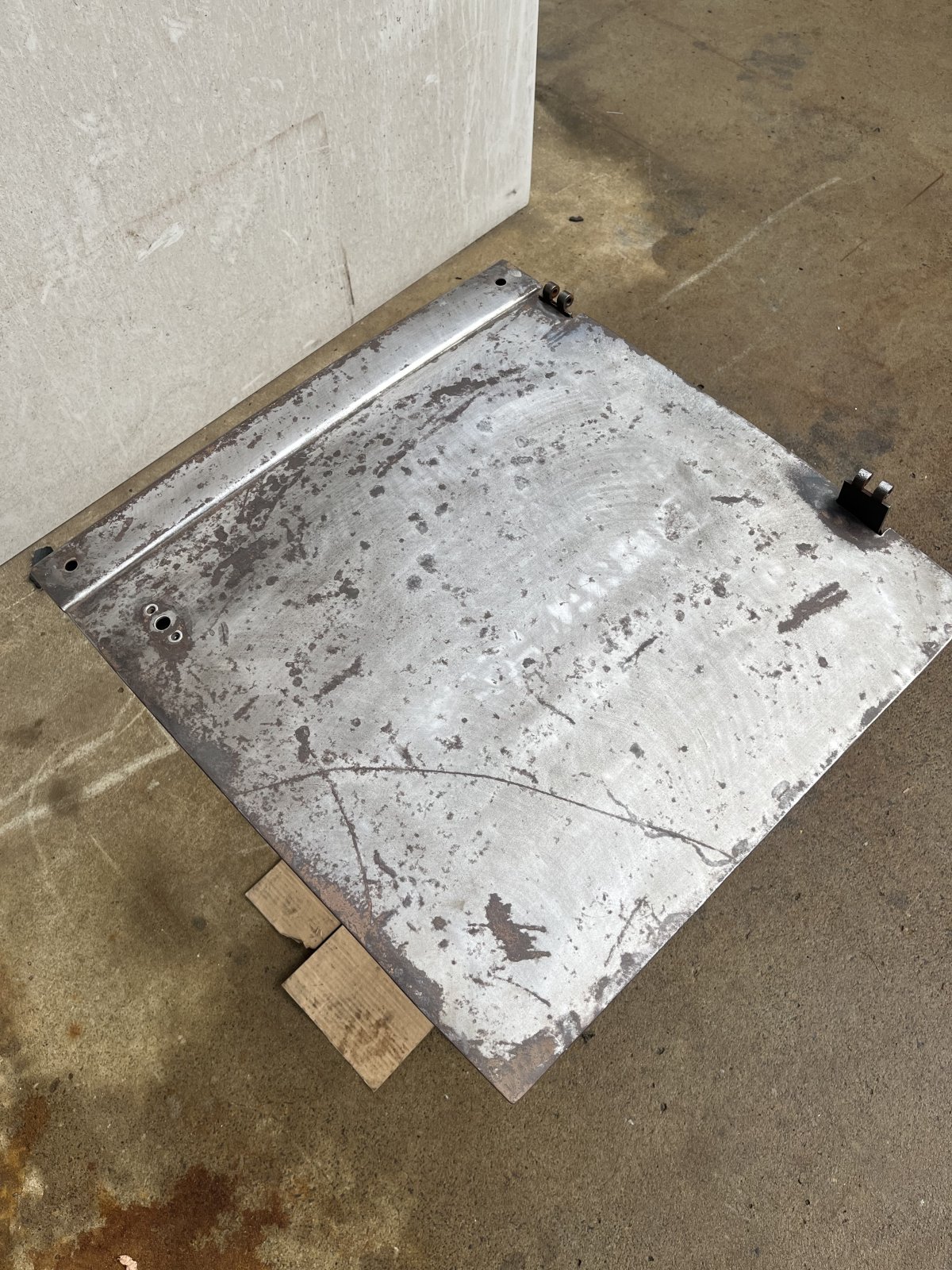

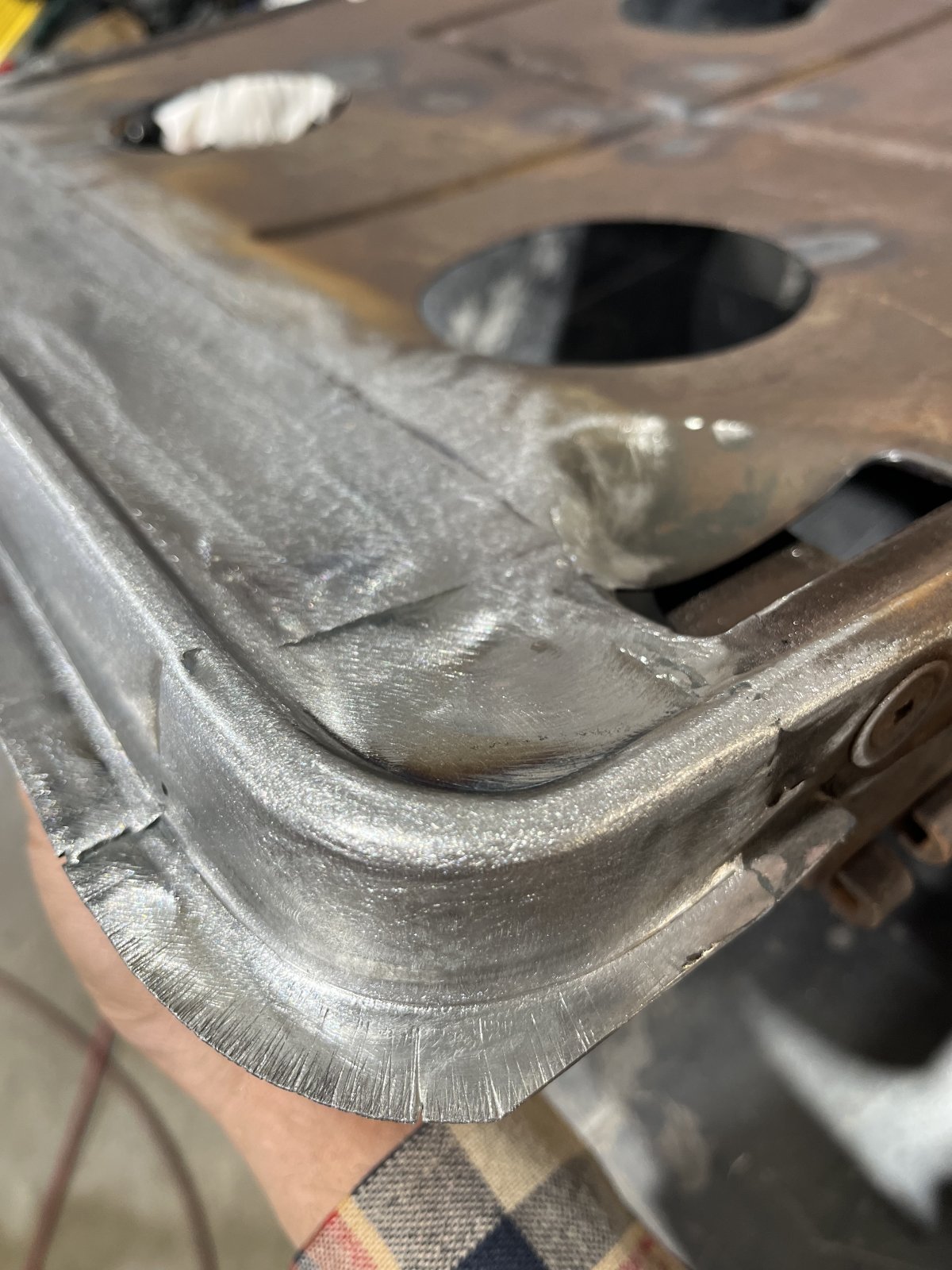

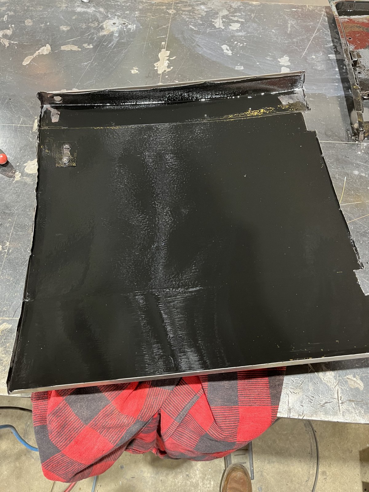

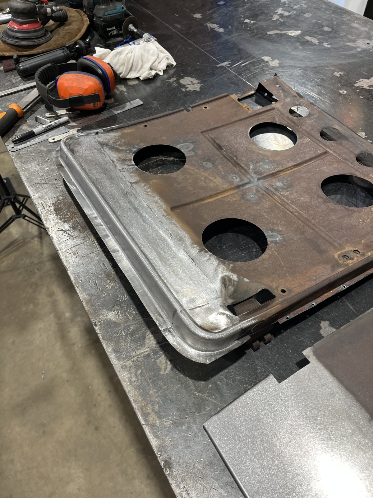

  20. Inner was a bit of a pain but luckily Karl had made some profile dies and knocked a fair bit of it out. I just had to finish a corner and weld it will up. I want to seal both inners with sealers and get them mated! She was pretty bad in the beginning FDD2A3CB-6E93-4734-8FD2-135B073B58AF.jpeg 158A5186-9D3C-4684-9887-5F373B11151B.jpeg 661D20E3-C40F-4DA1-9E54-0F19BF885EAF.jpeg 9BC49FB5-C2AC-45DF-81F6-92138CAEAB60.jpeg C17171AD-103F-4027-B81E-8DBD7FC3C575.jpeg 2DC71FDA-14CB-45A2-8D41-9C6D6A045261.jpeg 3CC0A1B4-DC28-4159-A0DA-DEF6BBDA684E.jpeg 1836A2C9-2E15-4B22-B6A2-78B5577BE758.png 13144C0B-4DCB-4F49-9075-00B589847168.png

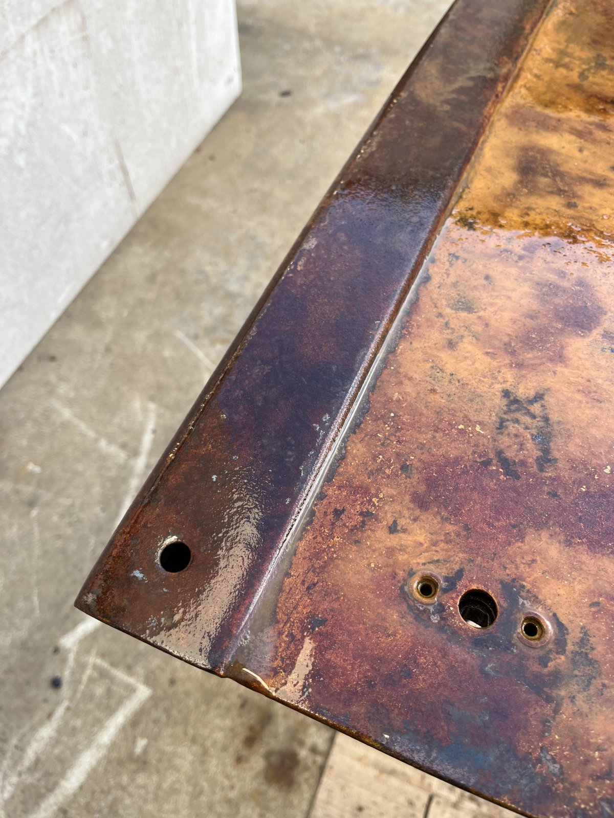

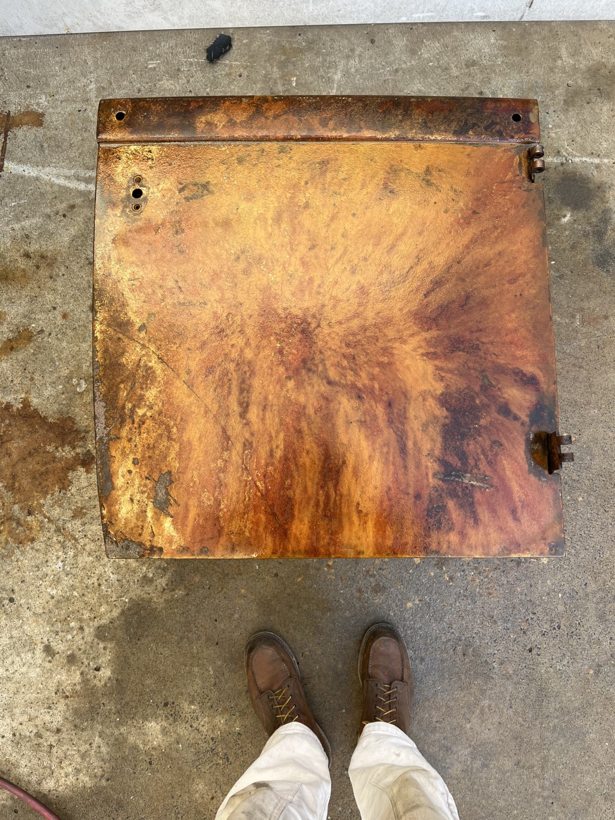

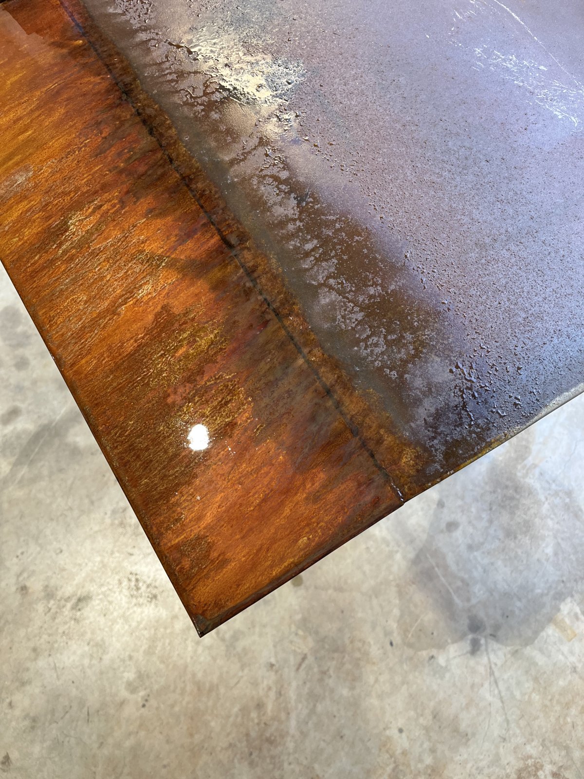

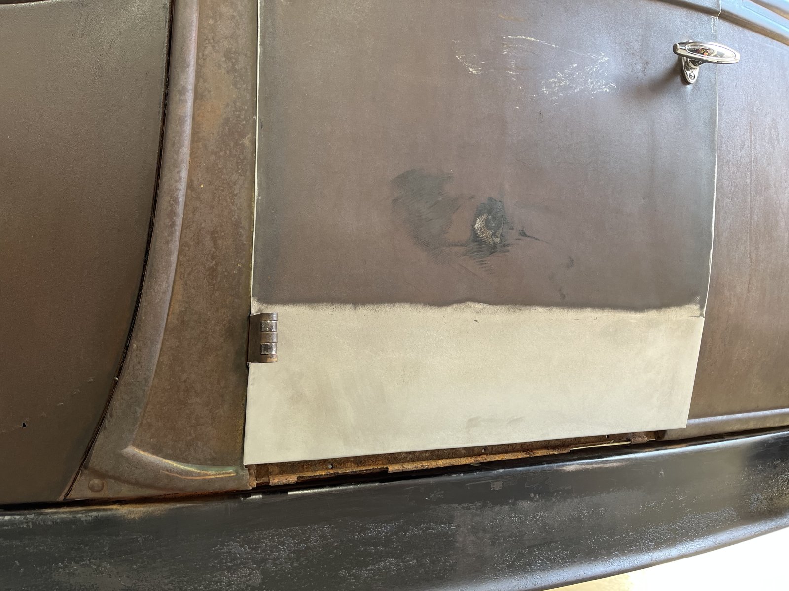

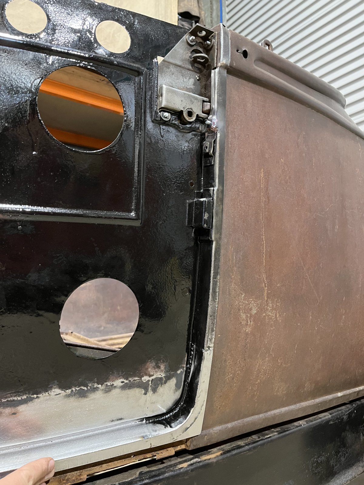

  22. Finally got around to finishing off the inner door skin and repaired the damaged areas. I got it fitted to the outside skin and loosely mocked up. Also playing around with Muriatic Acid and hydrogen peroxide do create a patina that would match. As you can see after a 5 minute try I’m no where near yet.. maybe paint was a better idea.. nice to see the door on and straight finally. Probably beer 40 years with a crumpled door. C43B6C0B-2263-4A2B-B714-FD5F77D83DFC.jpeg B87C6470-3AA6-44EB-893B-246C5370458E.jpeg 40623841-7FED-4551-A05D-27D754B4AF78.jpeg 2C191588-A630-4814-9D9C-99912166351A.jpeg 877F4FA4-3BD2-4BDC-A819-FFE92250C22A.jpeg AED40680-9339-41C4-94AC-F735BC91A0BD.jpeg 3F17865E-3130-4A6A-95F3-B11AD08E3DF3.jpeg 29D07CC4-7559-4DE6-A64A-110D3B4C7E27.jpeg 1A1857C8-5287-4F68-A70B-9AA04C8AB1FF.jpeg 38EAB0E3-2EAD-40A3-A422-546A05315289.jpeg D61A04FB-43DB-47C4-8E33-EC3F37AD89A9.jpeg

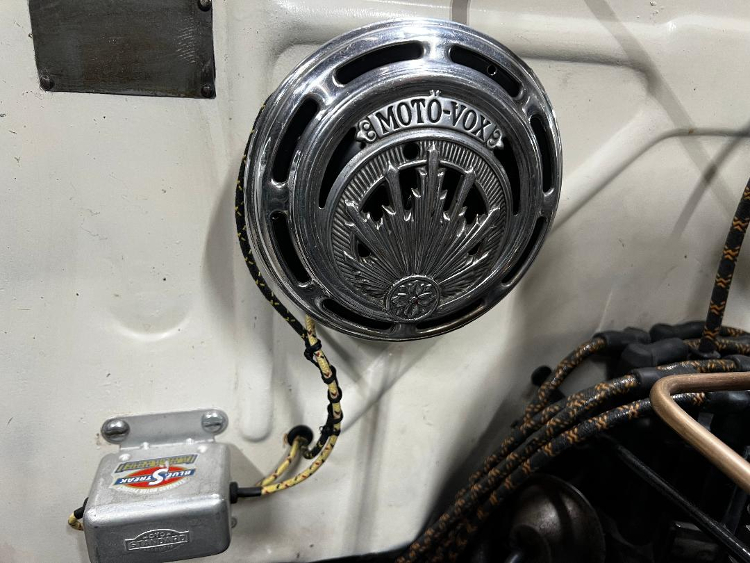

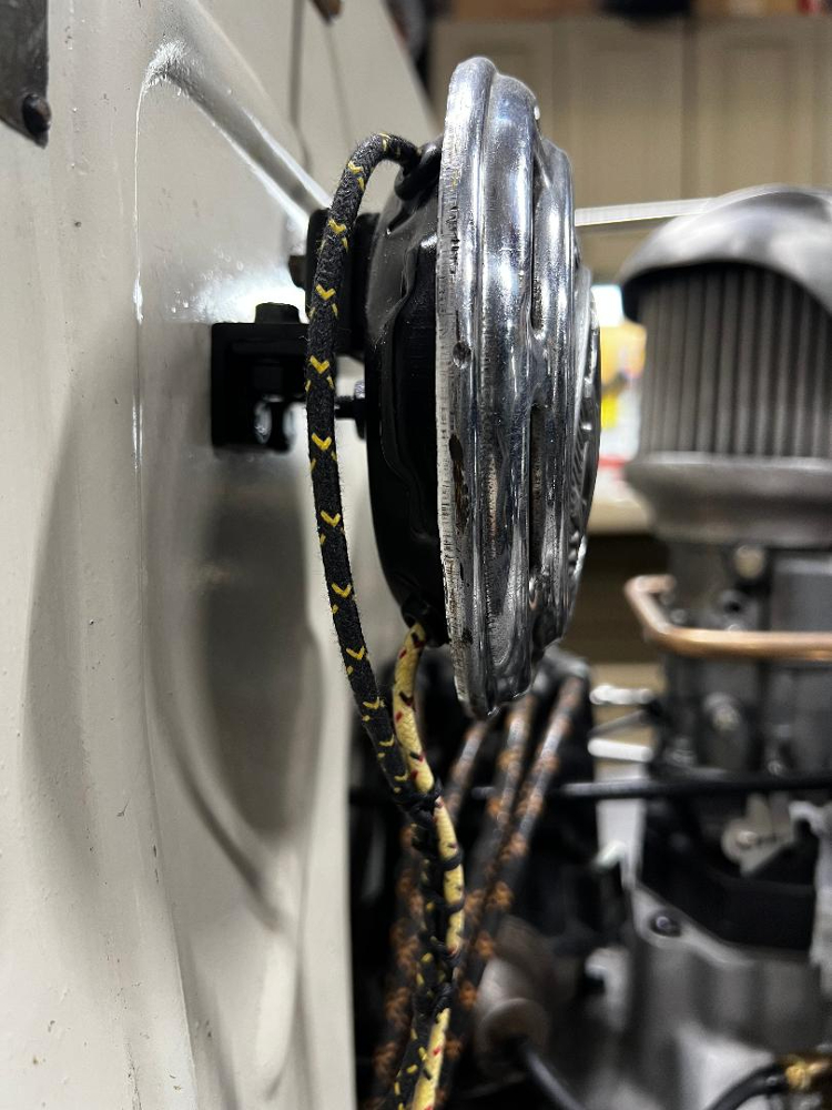

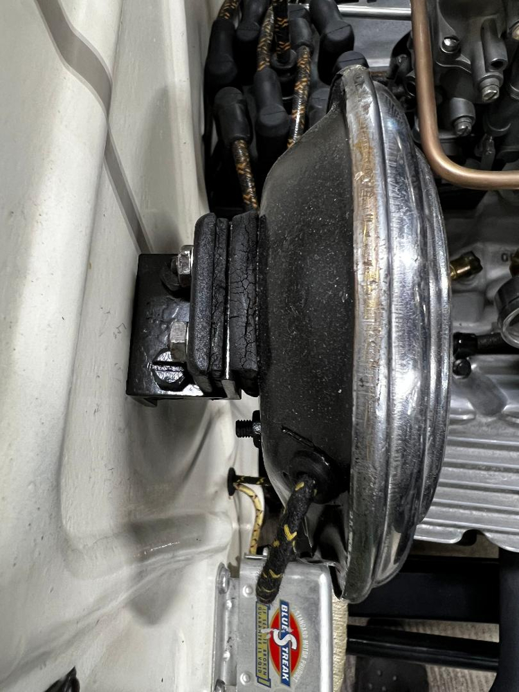

    Just a FYI (if you would need it) a Harley Springer 12 volt horn fits perfectly inside the body/case of that type horn. I had my 6 volt Moto-Vox hooked to 12 volts for years but it finally took a dump. Couldn't revive it, so took some measurements and found the Springer horn to be an exact fit. You can't see any trace of the new horn. Un-crimping and re-crimping the grill from the case is kind of a delicate procedure as the grill is pretty light weight.

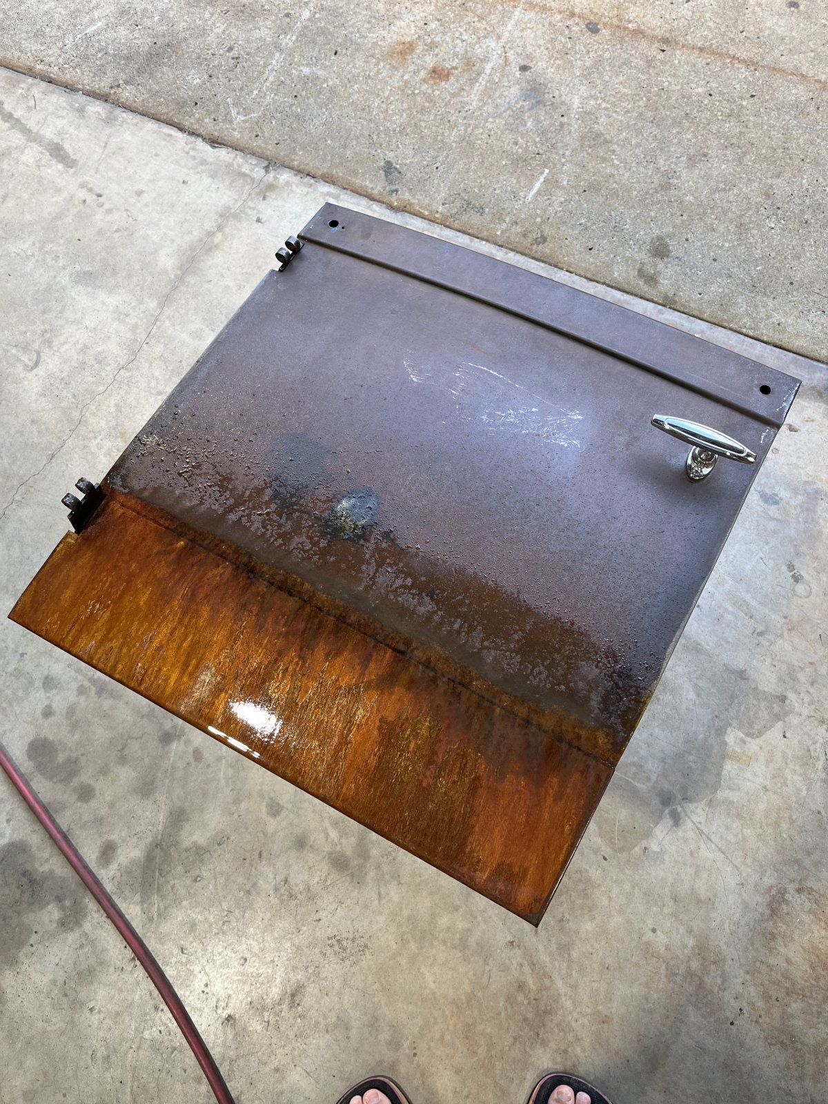

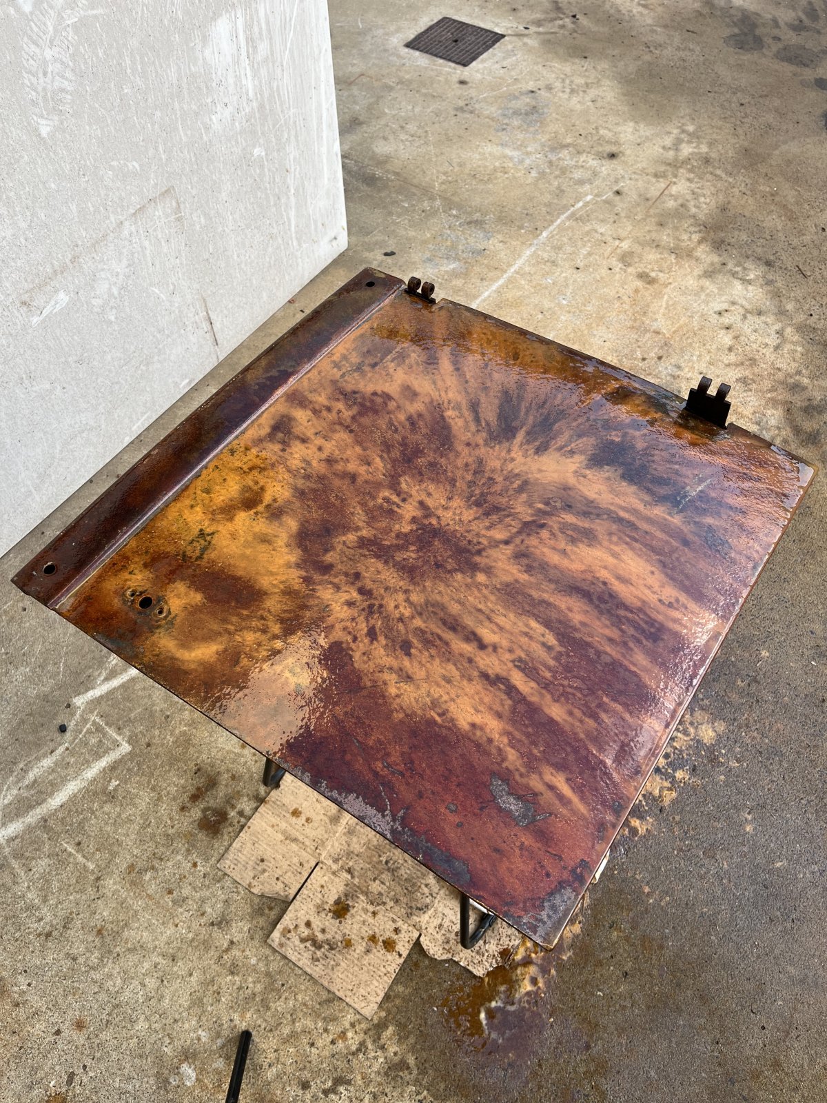

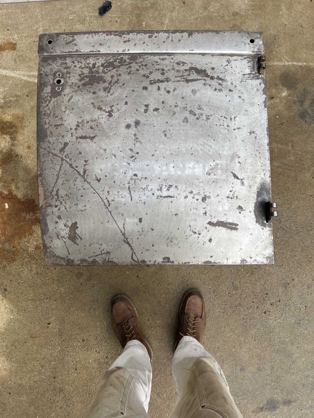

  29. Managed to finish the door. Real patina is not easy, but fun to do! I had it very close and used a ‘black Japan’ wood stain, yes a wood stain, I’ve used it before to darken steel and works well. I kind of screwed it up after applied the Galmet but I’ll live with it for now.. I scored another door for the other side that doesn’t need to be skinned. But matching the whole door will be a challenge. Paint probably would have been easier but let’s give it a try and see the outcome, I’ll keep you all posted.

    1942 to 1957 Panhead/Knucklehead. OE #69001-42......a ton of repros out there in 6 and 12 volt.
