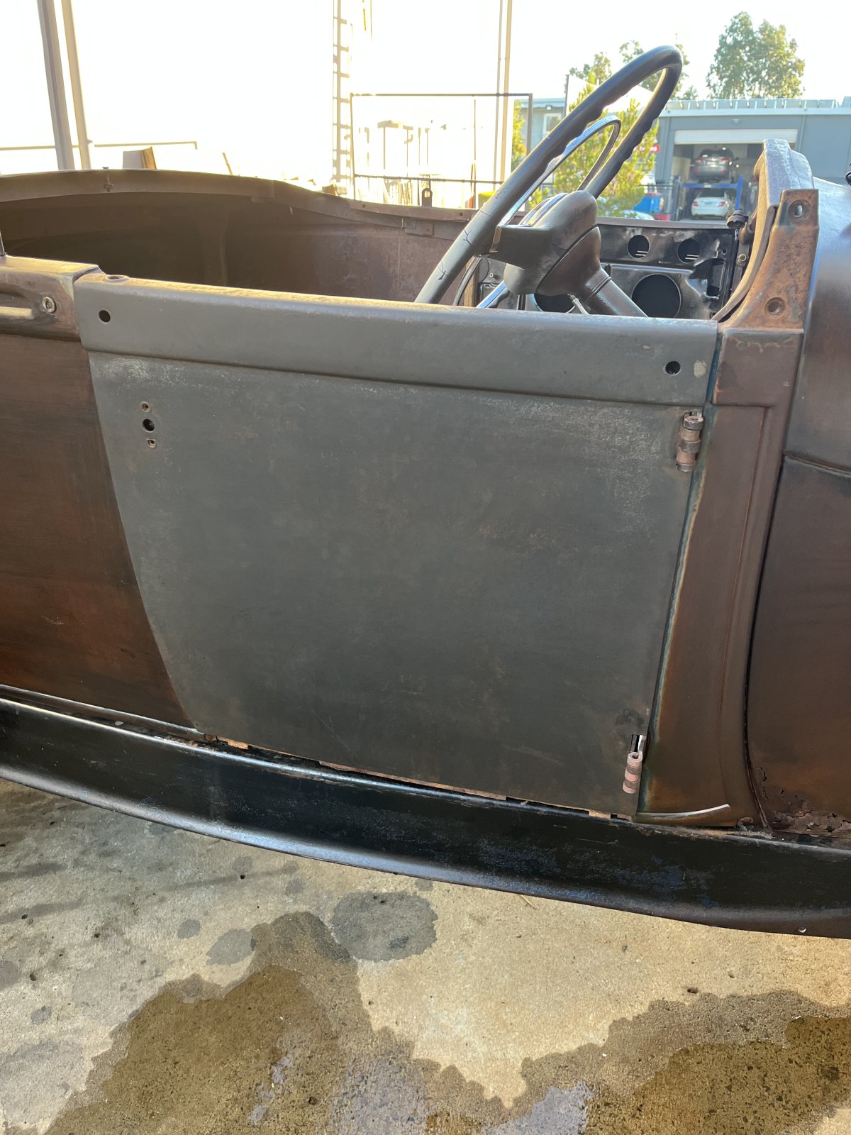

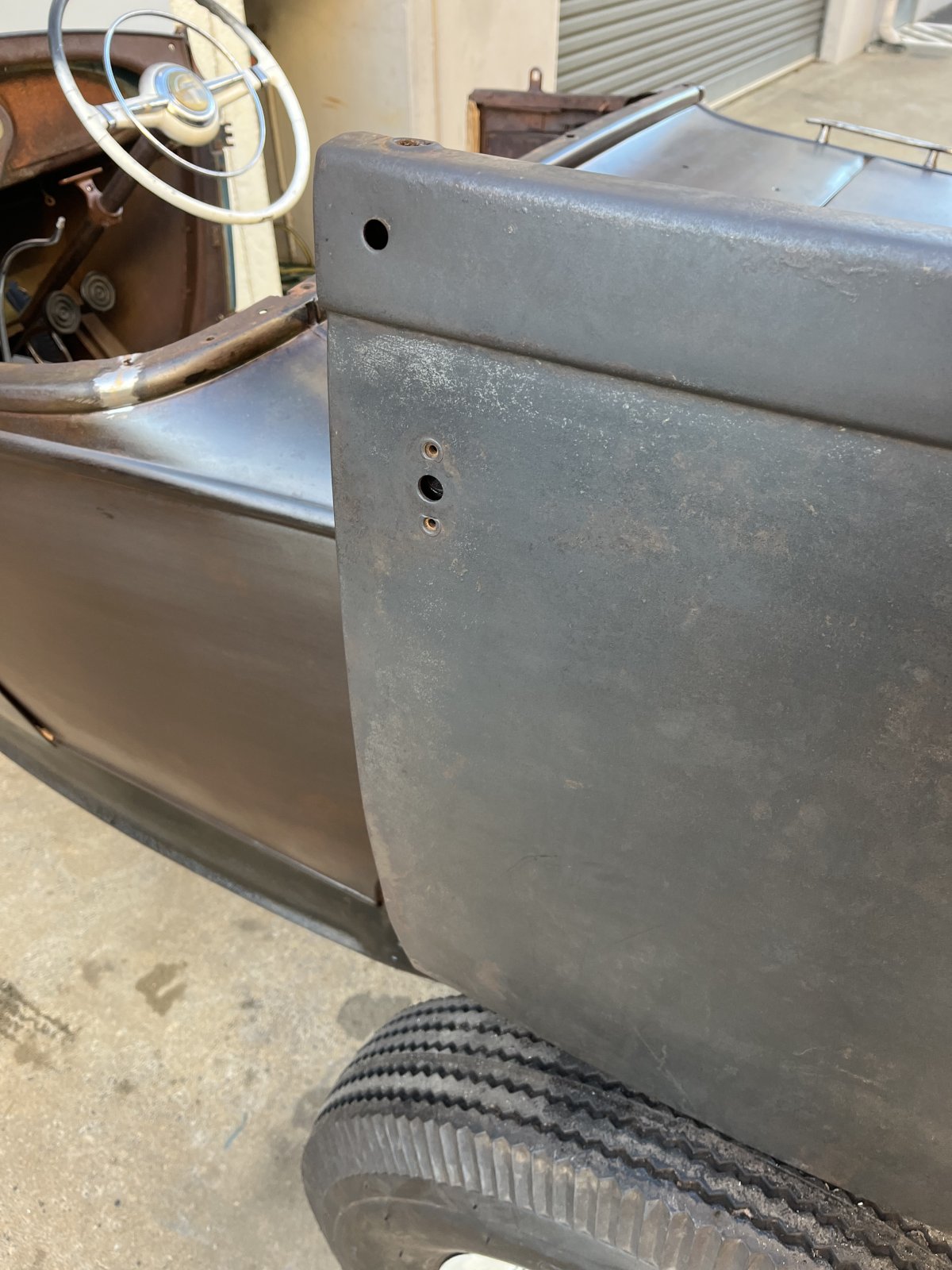

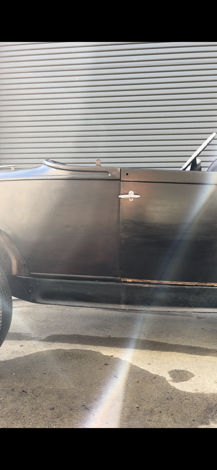

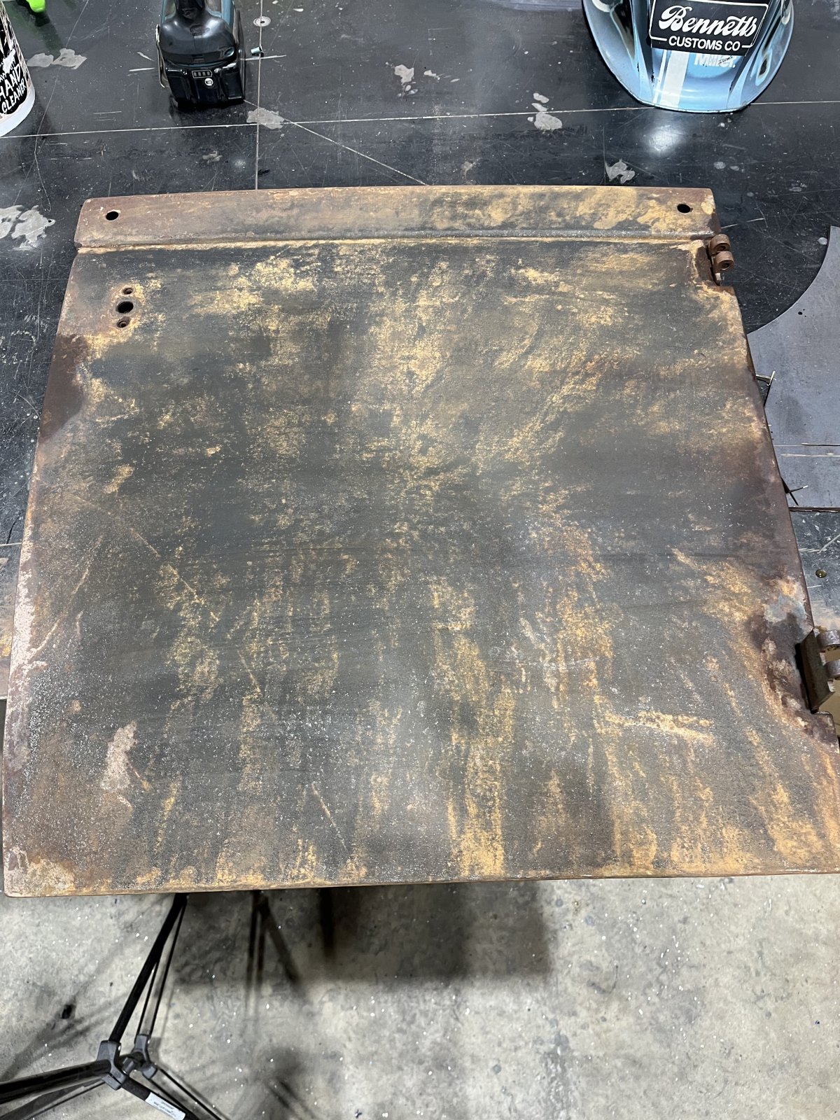

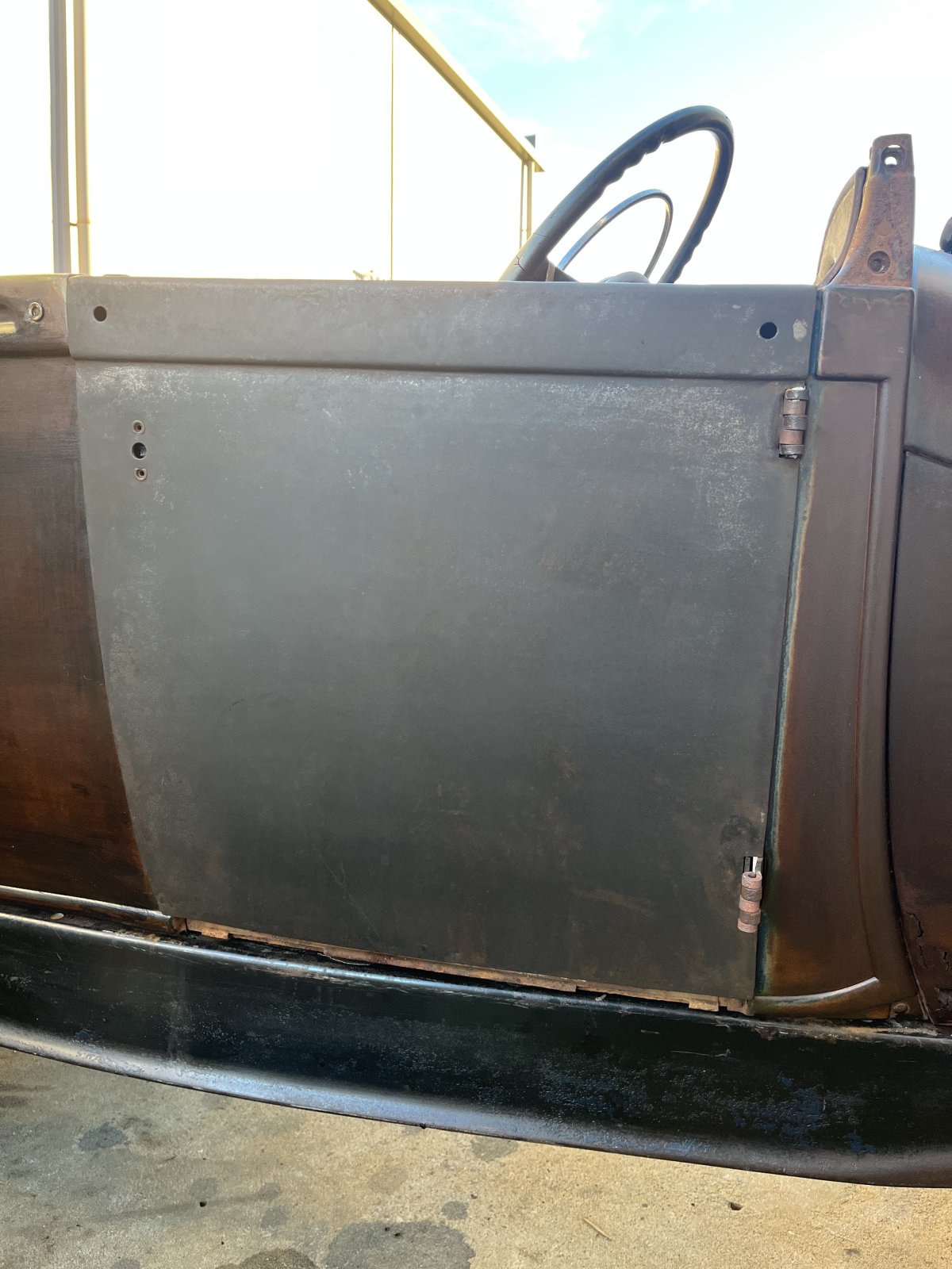

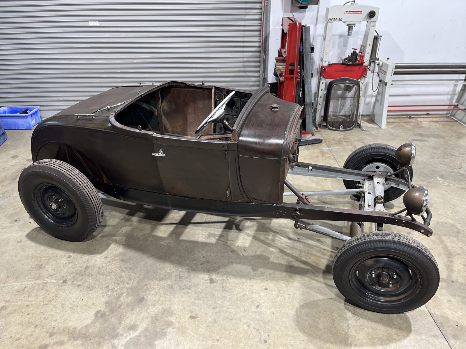

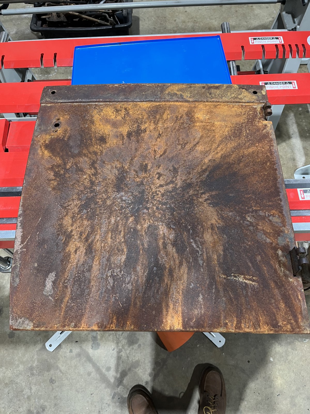

  2. Well left it over night. Washed it off, cleaned it, tinted it with wood stain and glamet and got it pretty close! Both doors basically done, mount master cylinder and that’s about all I can do until we start to disassemble everything. Body needs some floors made and a bit more rust repair to get through. 88EED554-3984-47DC-8297-1FF91D7EF641.jpeg 1E54BAC5-AE84-4855-9981-806AC20ACA01.jpeg 86AD6B48-D8CF-47A9-B3A8-D865CCEF5CB7.jpeg 171E3E56-53AC-4904-9EFB-2F28DD1CE745.jpeg C253E309-DC7F-4007-8E75-156C6BB93935.jpeg 22C6E9CF-7028-46C8-8940-9084F4AC5991.jpeg 8901EC5D-12D2-4DC7-B898-E2227C3410A4.png

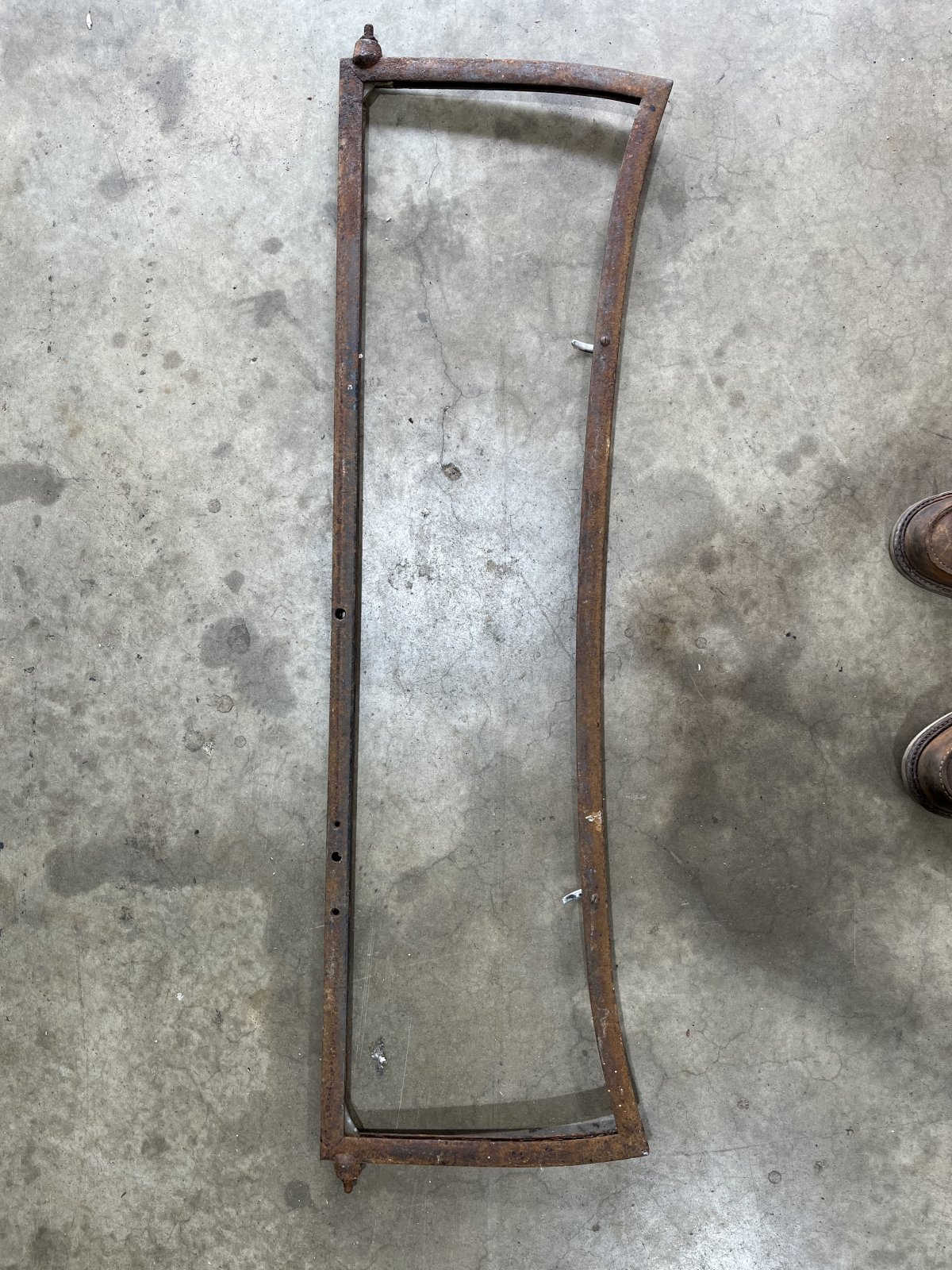

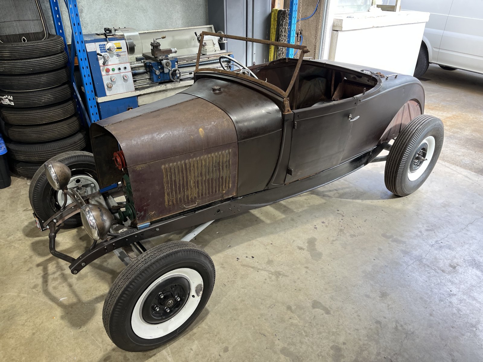

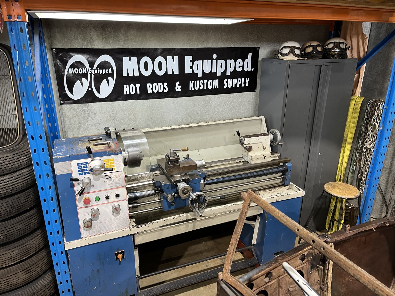

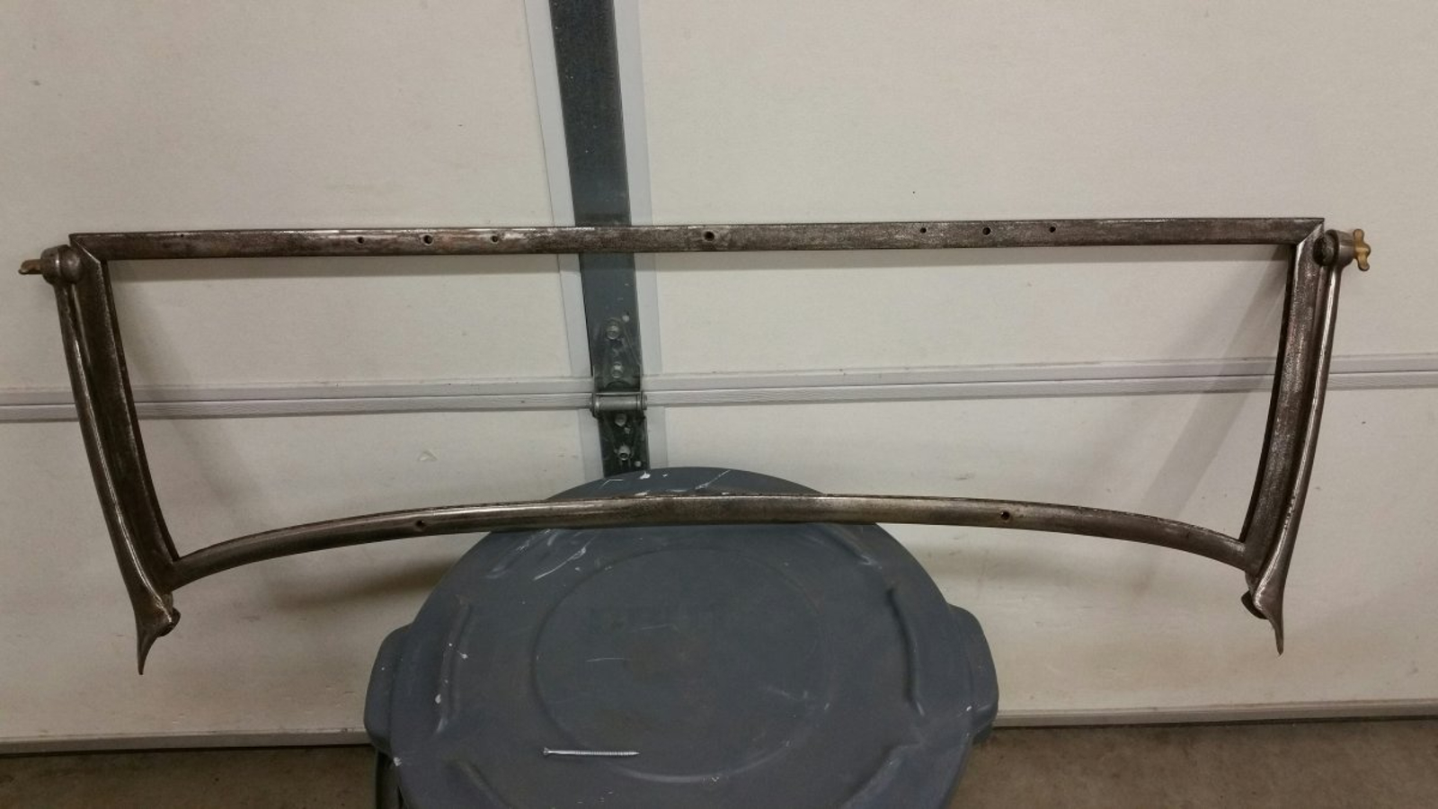

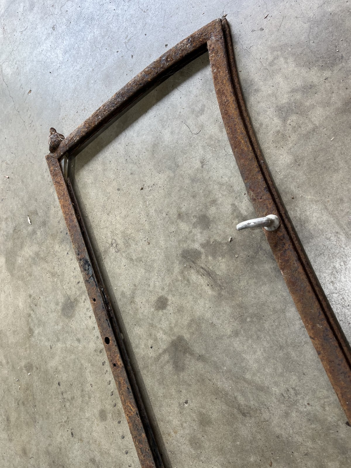

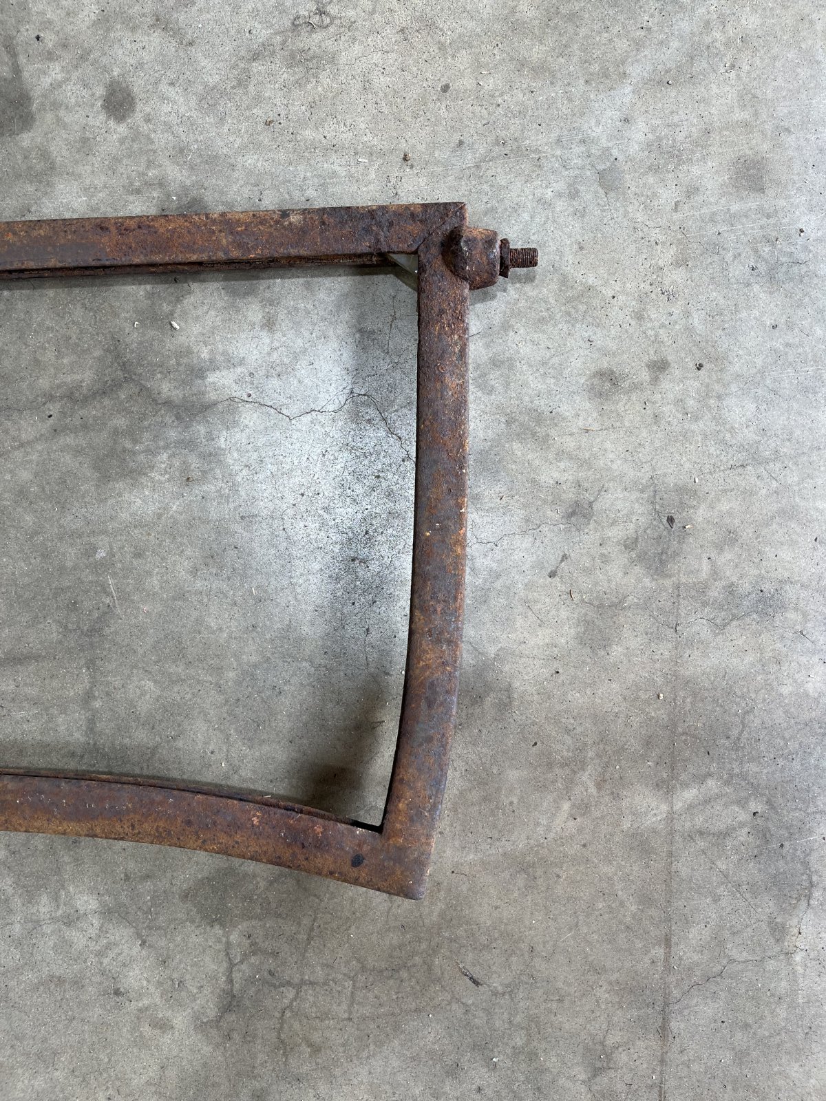

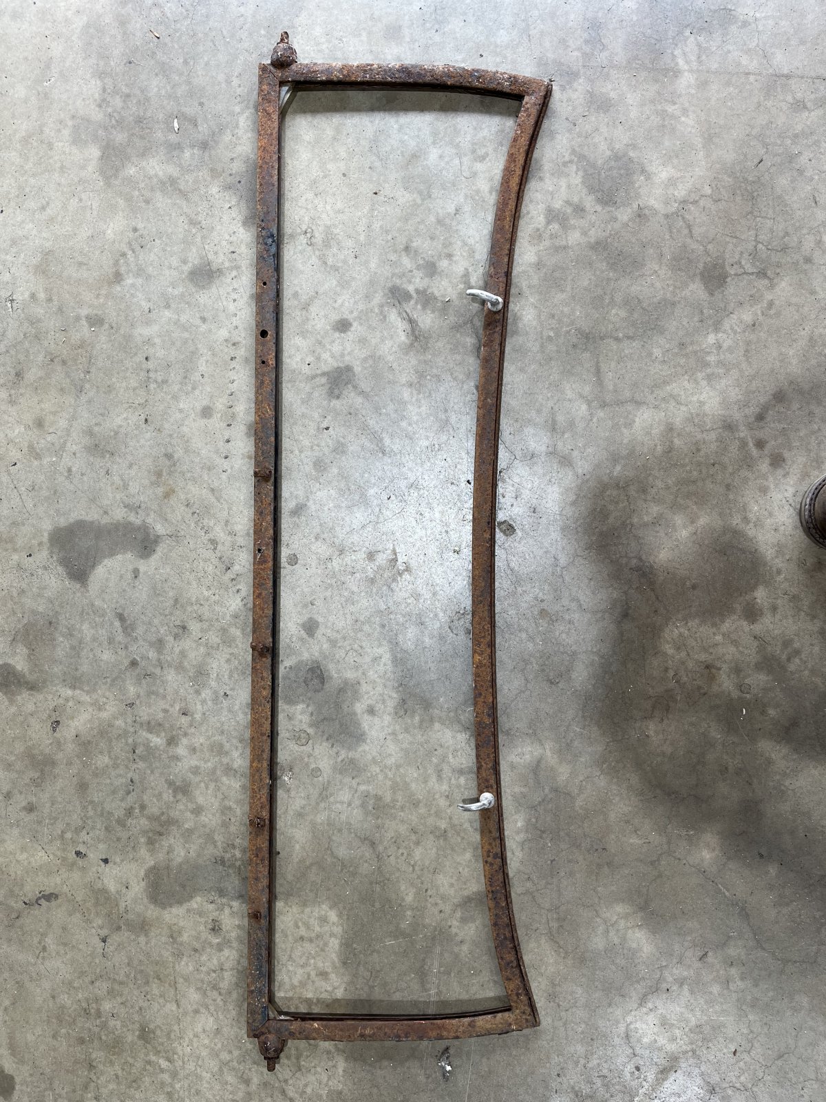

  7. Haven’t done much last few days on the roadster, however I did get the lathe setup and will get it wired in this week, few things I need to make on it! I also found this windshield frame in my pile. Almost looks like 32 but not. Any ideas? Stuck it on the roadster for a snap! Close fit

  8. Joe Blow
    Joined: Oct 29, 2016
    Posts: 1,795
    Joe Blow
    Looks awfully close to a 33/34.
    osage orange and oliver westlund like this.
  9. Looks like a match nearly ! The sides might be different?
    Stogy and Joe Blow like this.
  10. Joe Blow
    Posts: 1,795
    Joe Blow
    Yeah agreed.....sides just don't look exactly right.

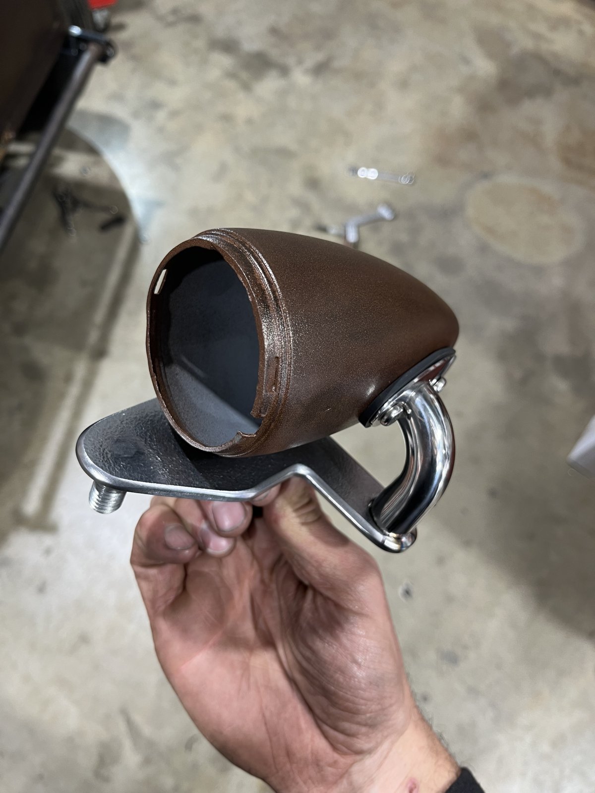

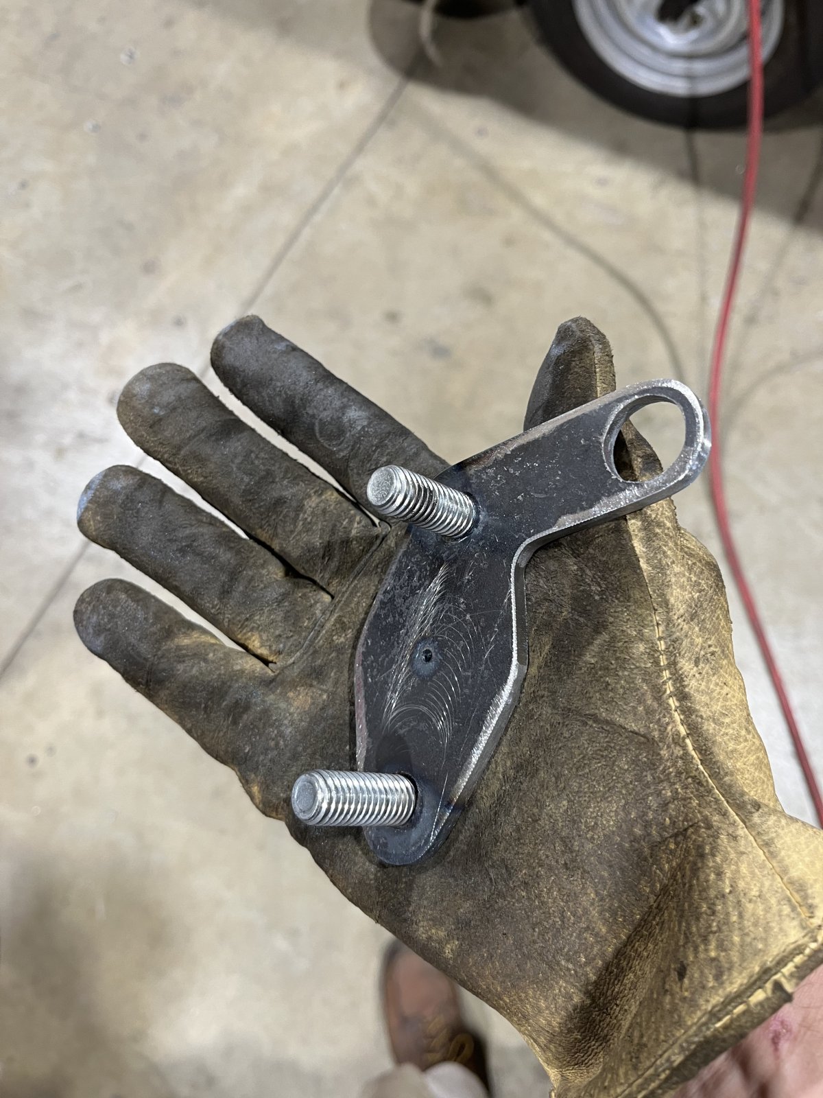

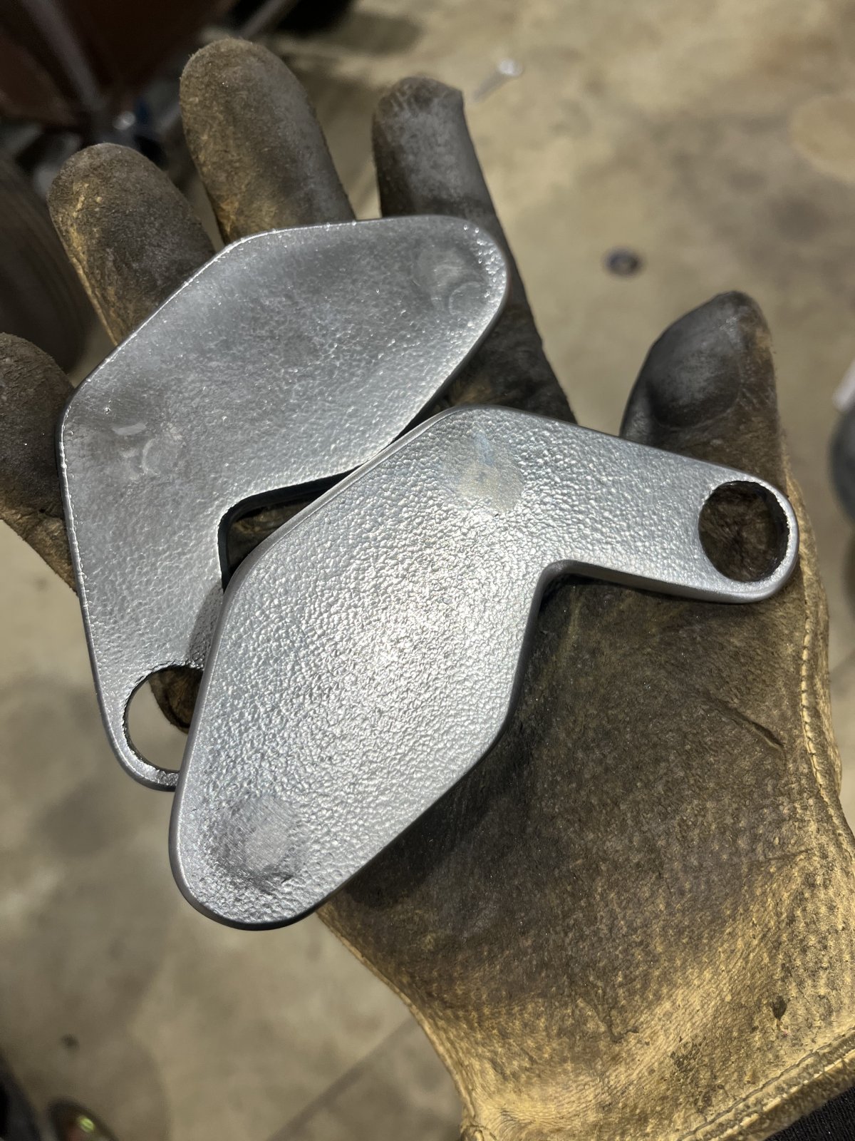

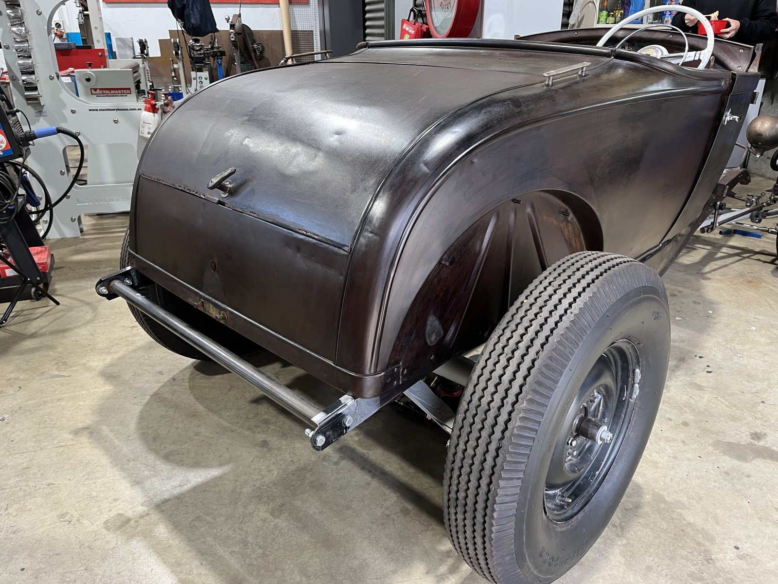

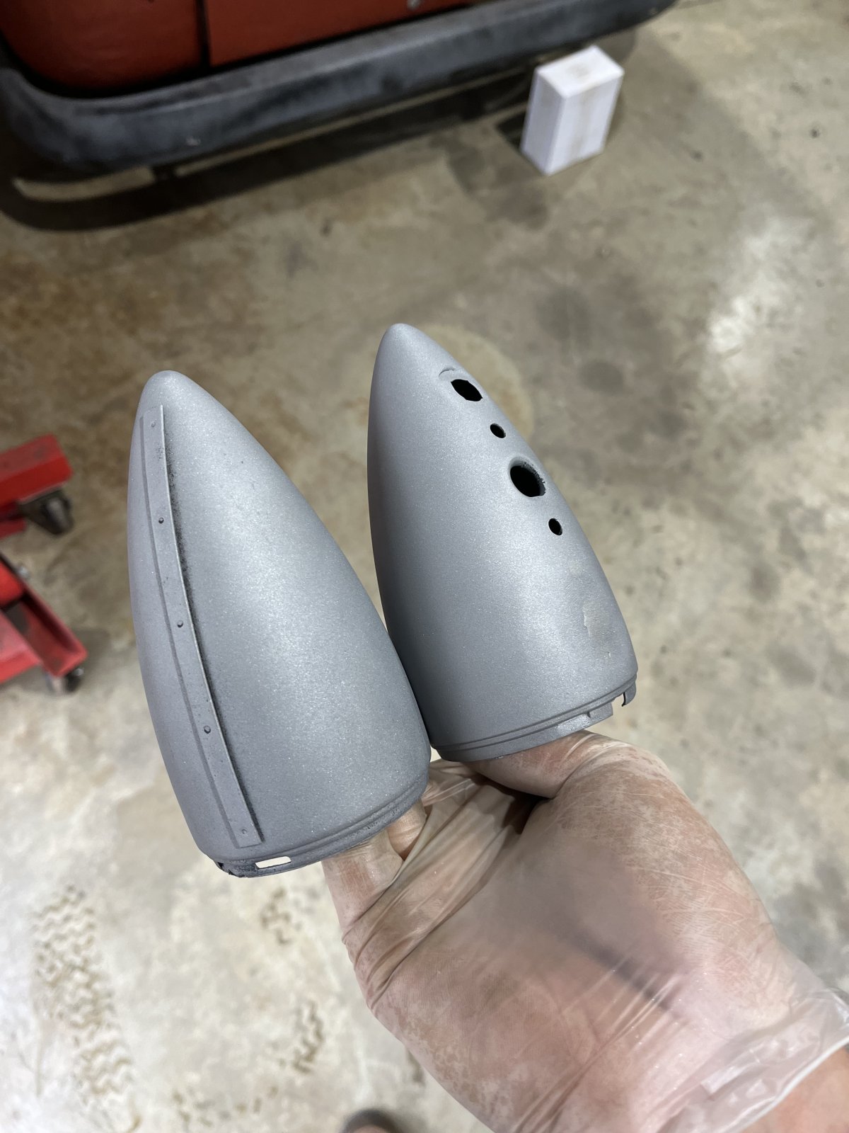

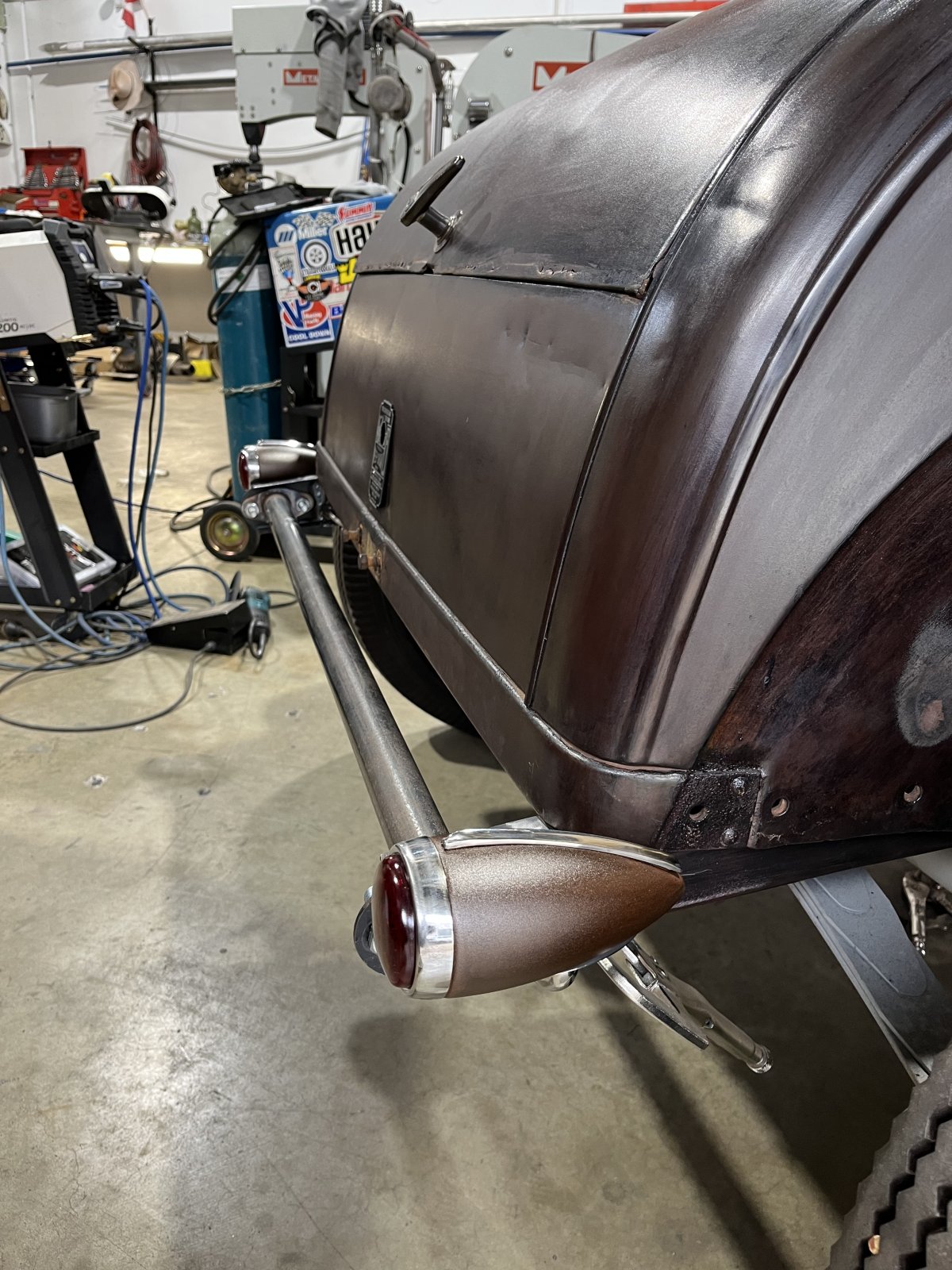

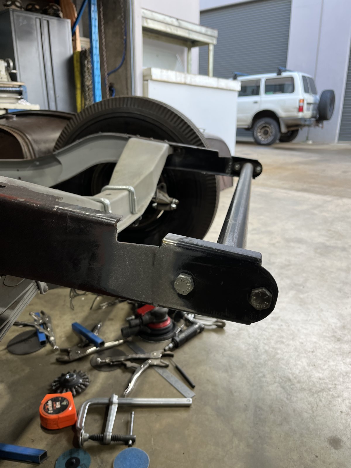

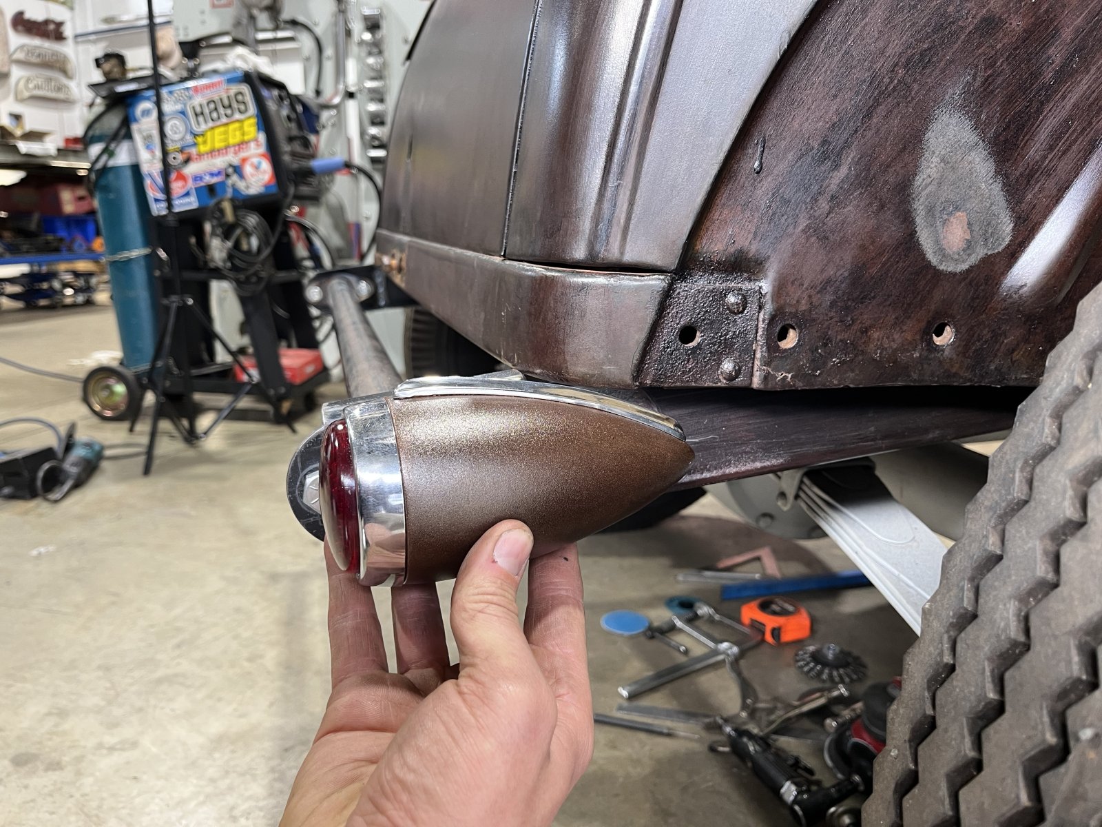

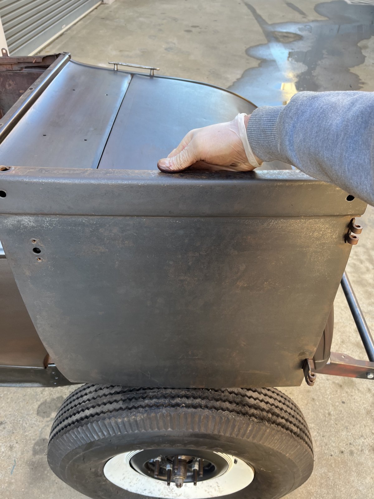

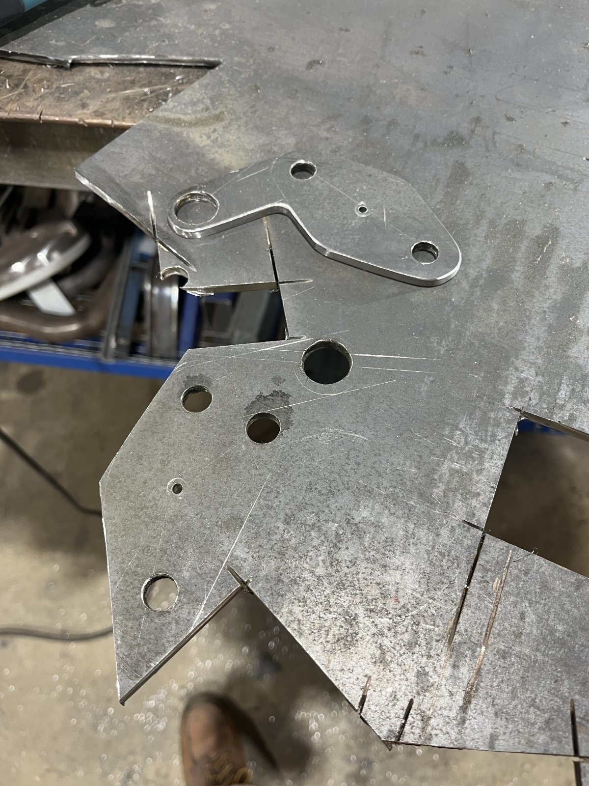

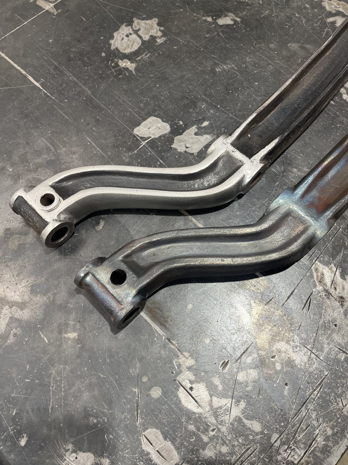

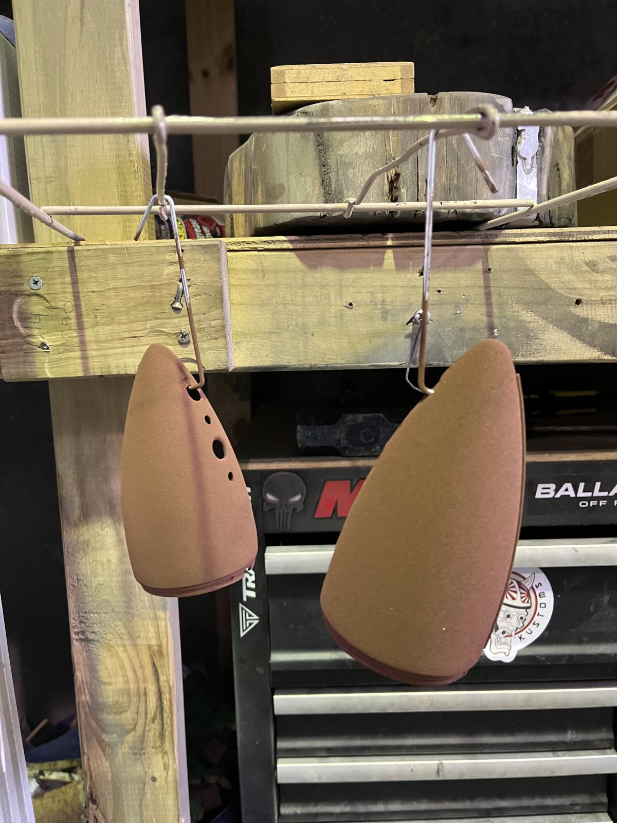

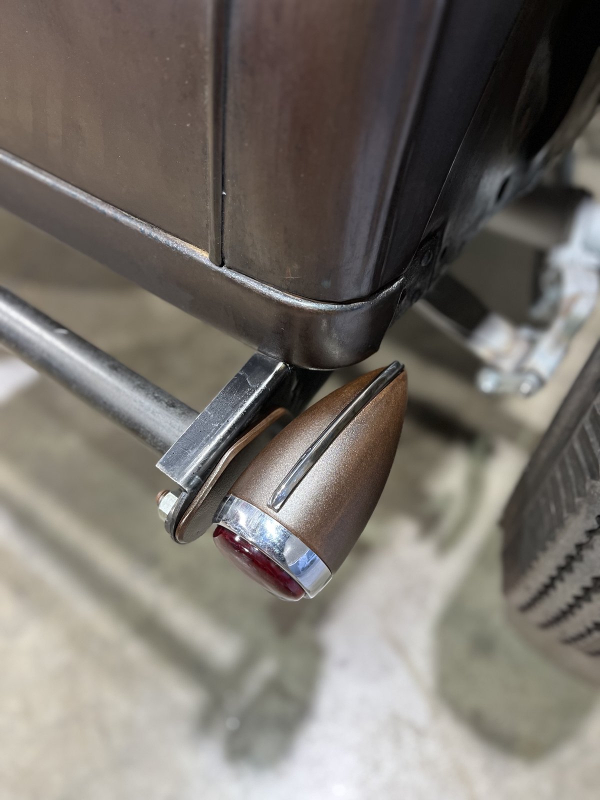

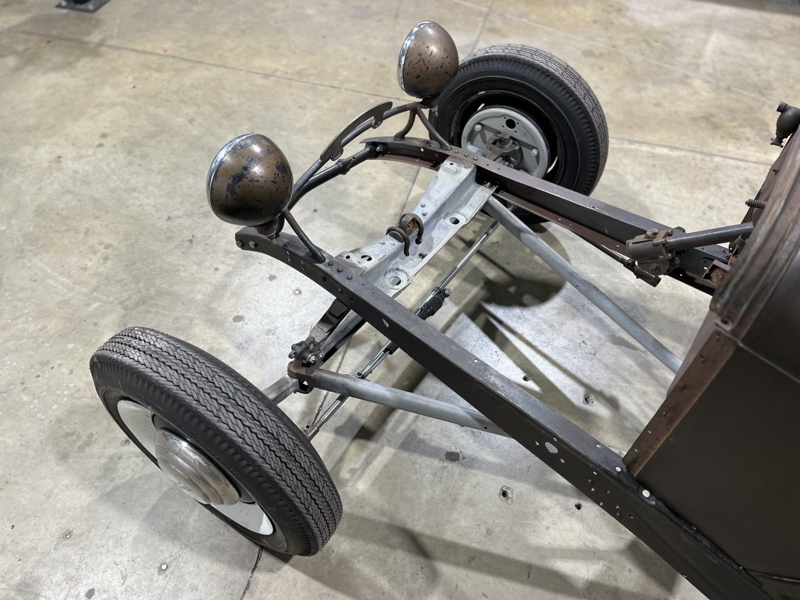

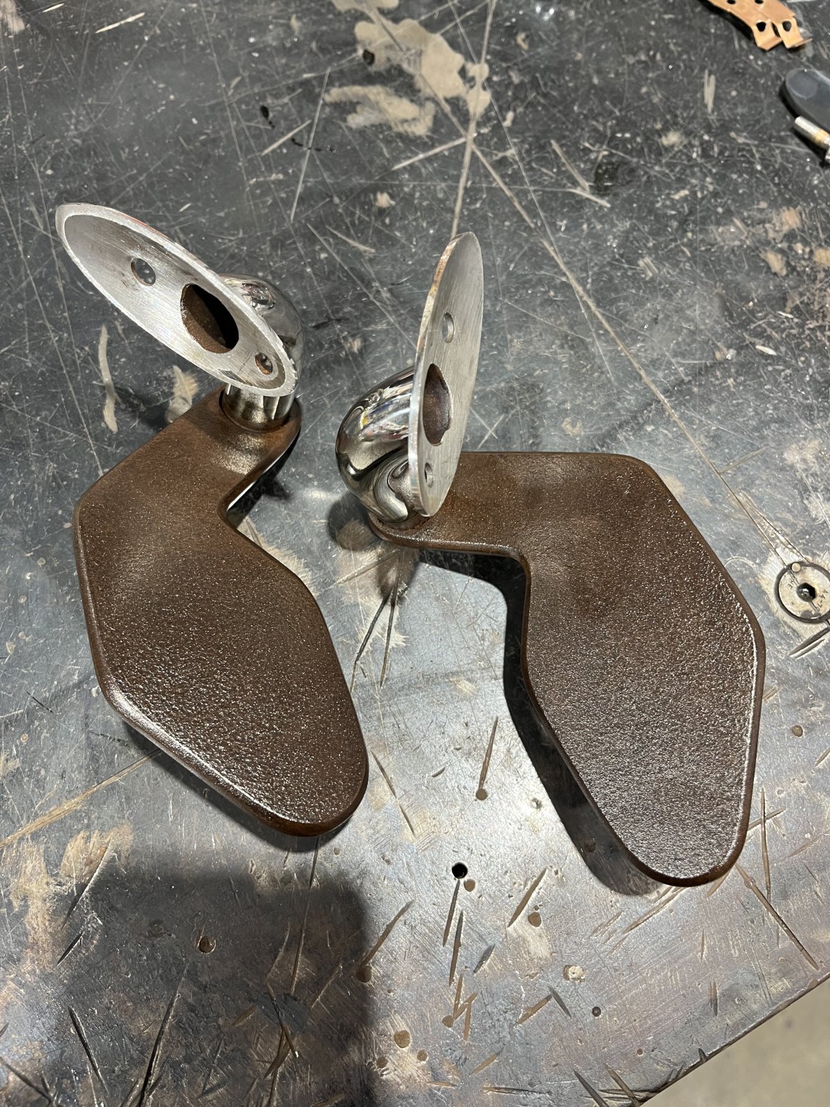

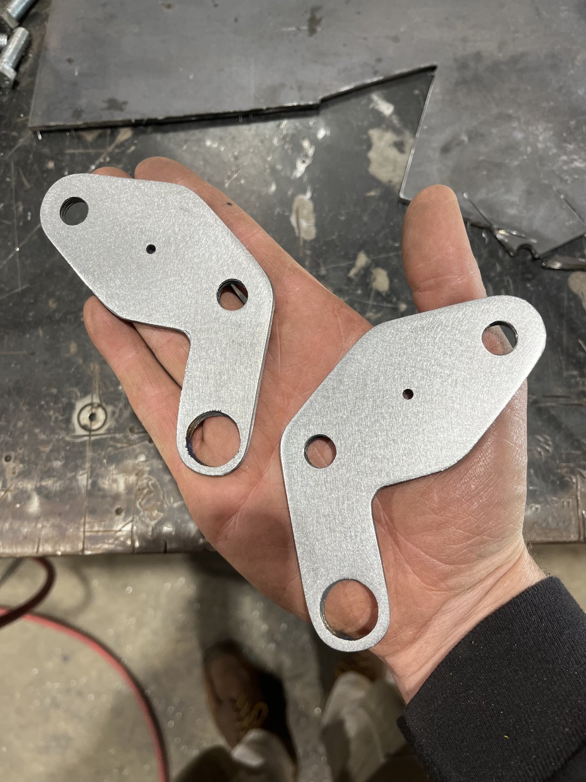

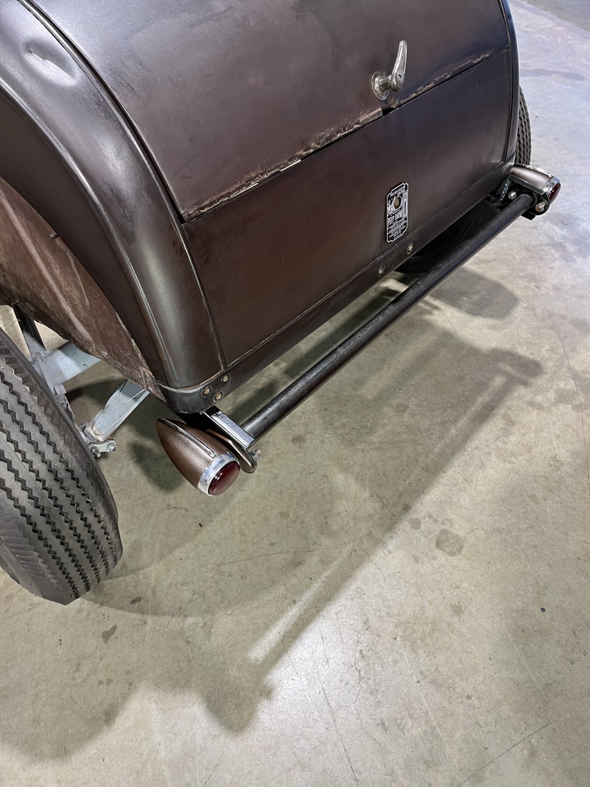

  11. Decided to shorten the rear frame horns and keep the spreader bar, traditionally these are cut off but I like them sticking out slightly. I will create a new style bracket that will fit to the tail light abs have the studs welded flush to it to simplify it, but after powder coating and staining the housings they look better, more tomorrow!
    322F473C-C117-490F-8BC0-C8FEEA9A8E77.jpeg 4A9779AE-BE36-4FDB-9221-D0E8B6590EE8.jpeg 607E6307-A4E0-4FB5-ADE5-3AA7BD89DC99.jpeg B0269119-1ECC-449B-B28E-FF64E4AF980E.jpeg E52F9B45-6D38-423A-ADAC-3EC65AA1470A.jpeg 0DD709EB-EDA0-4F5E-B06F-9379A29F5556.jpeg 2DA6BD0B-EEDE-4B4F-8A4B-D55F7832D6DE.jpeg 57A061DC-563C-401C-BBE4-F20312AD0178.jpeg 692B7C01-435D-4DBA-9B36-EB3B3DB53B29.jpeg E12415F2-5C22-442D-B99F-AC63930A96F2.jpeg 2A2BFBF0-04BF-4A88-95A6-3C74333927C5.jpeg 32A0014A-A86C-4316-92C1-D6FBF9586AAE.jpeg
    treb11, Stogy, brEad and 6 others like this.

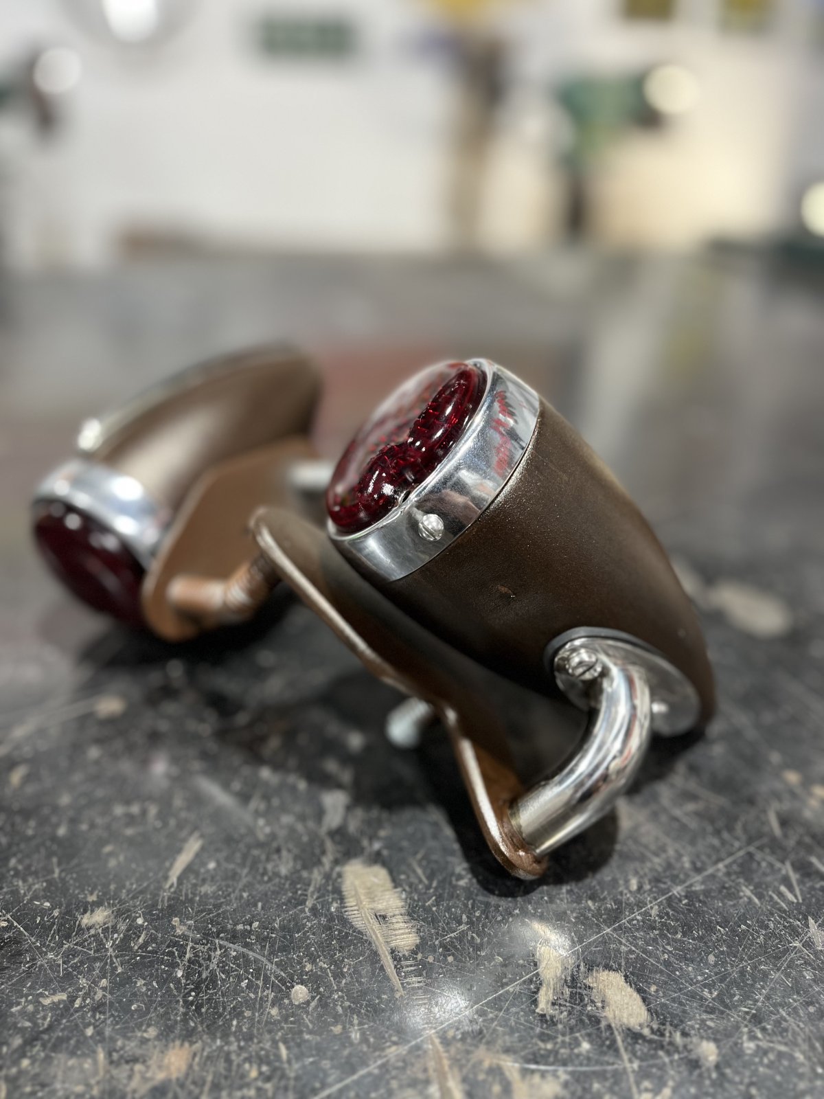

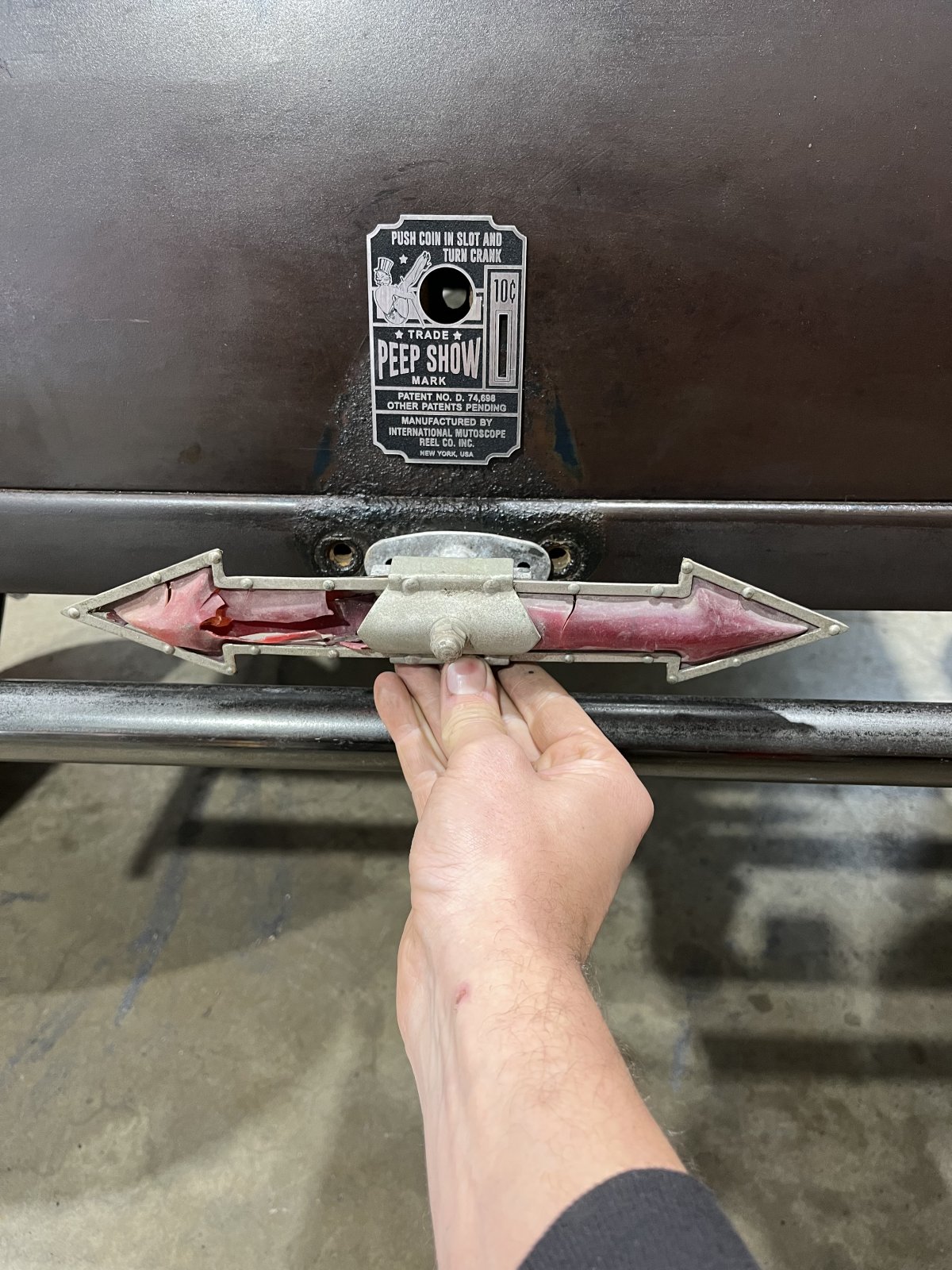

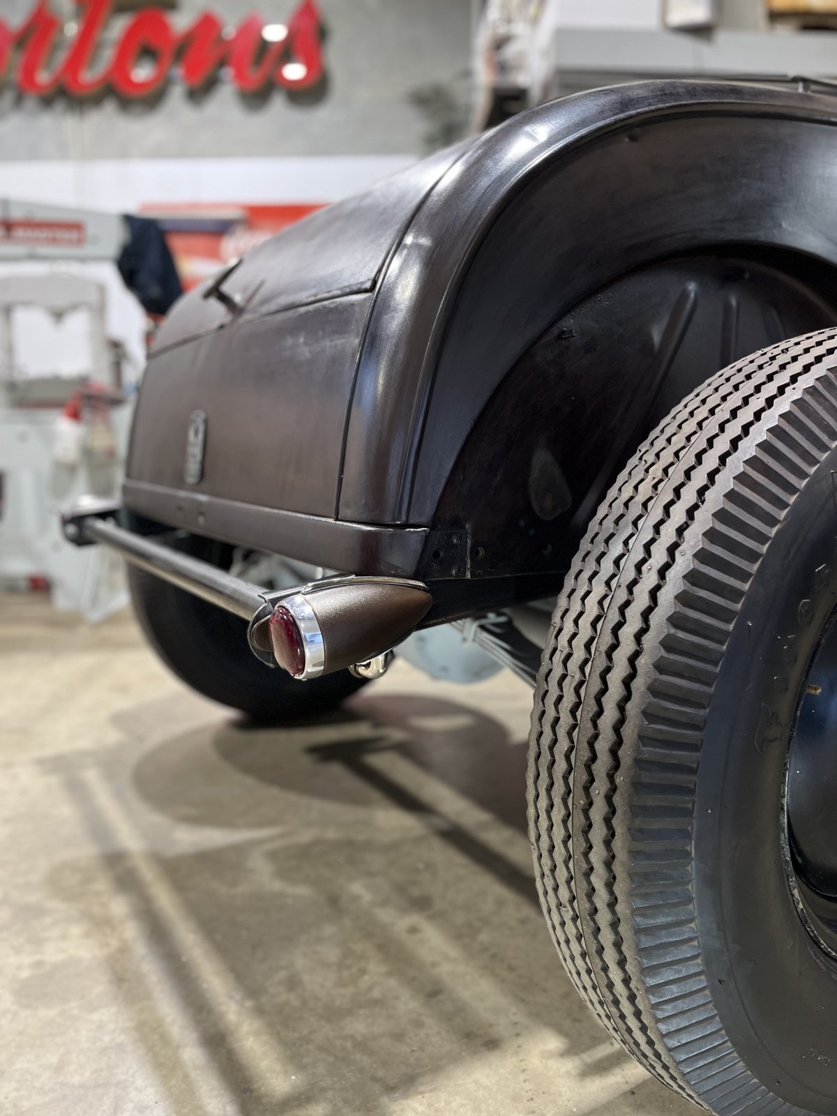

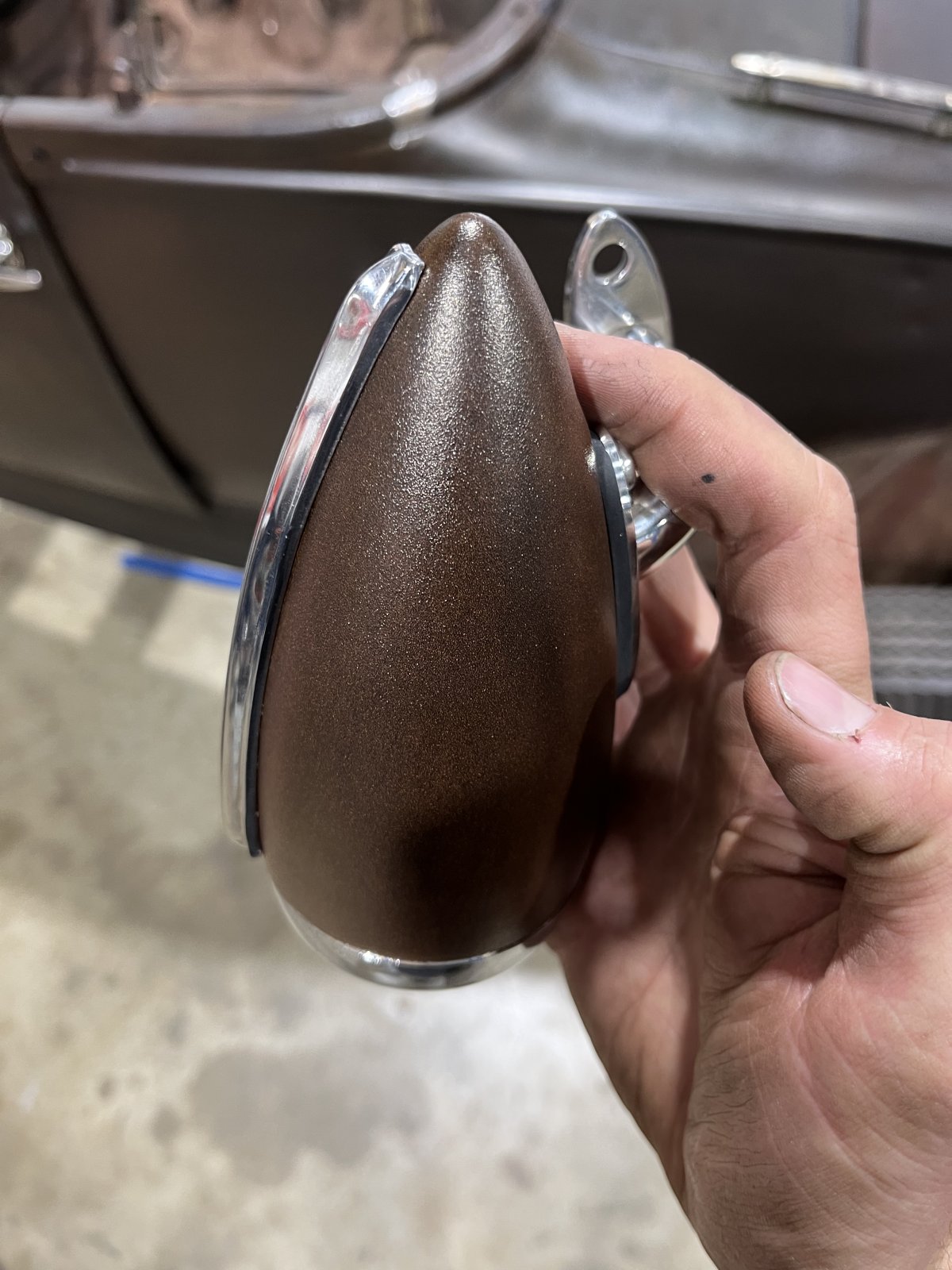

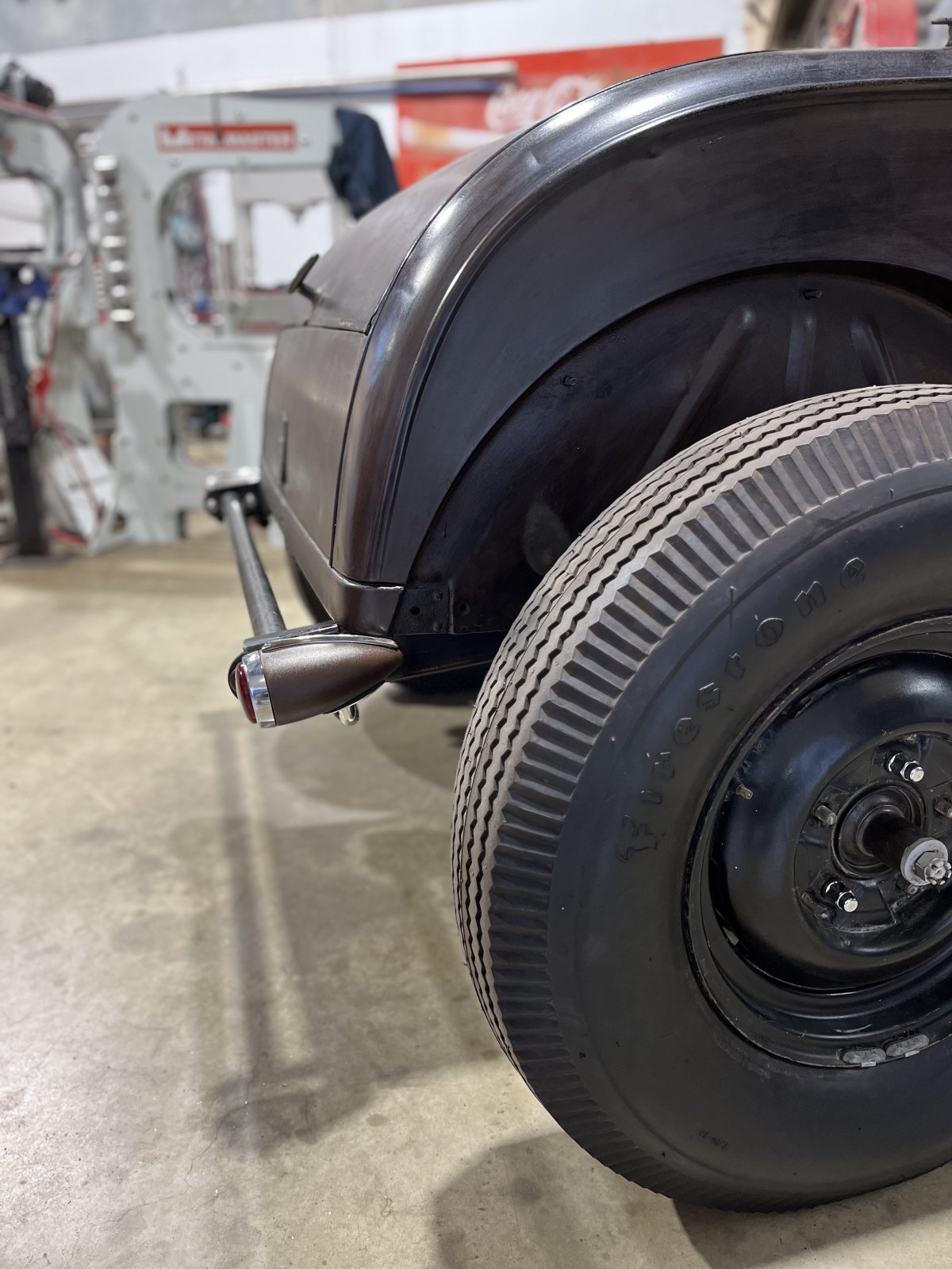

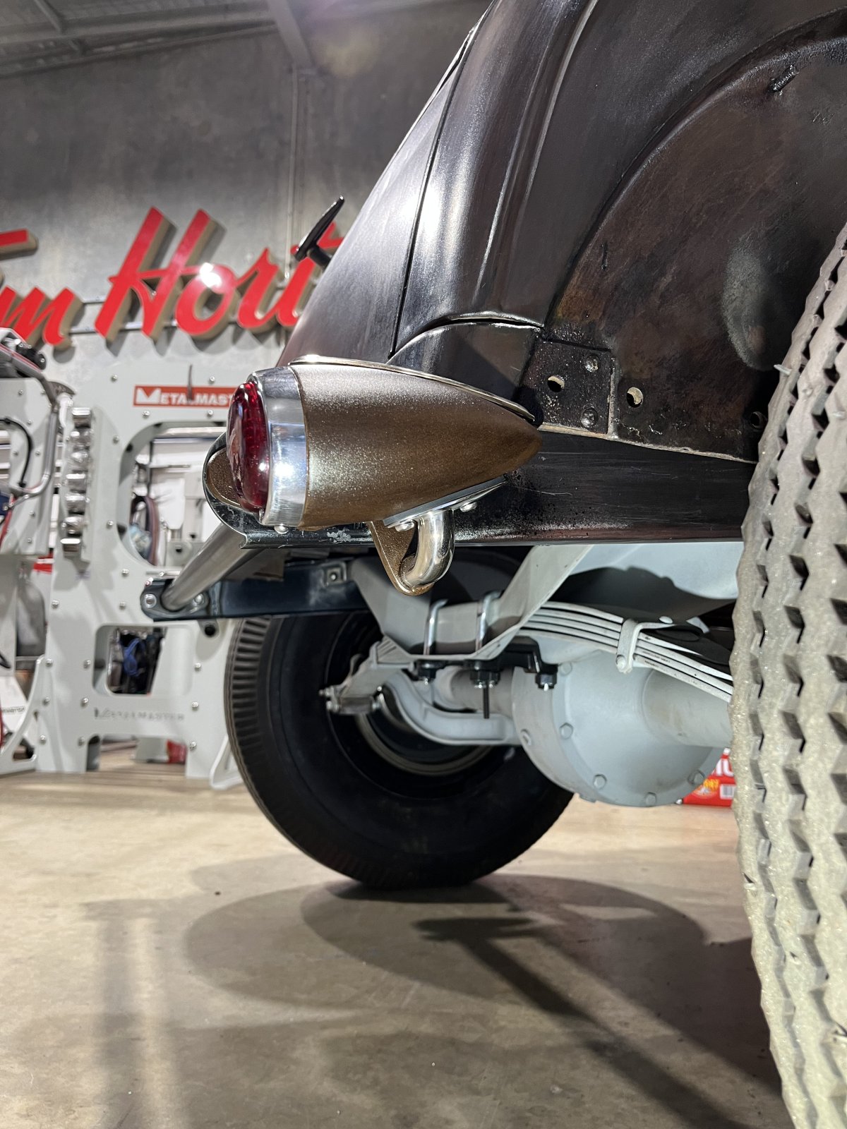

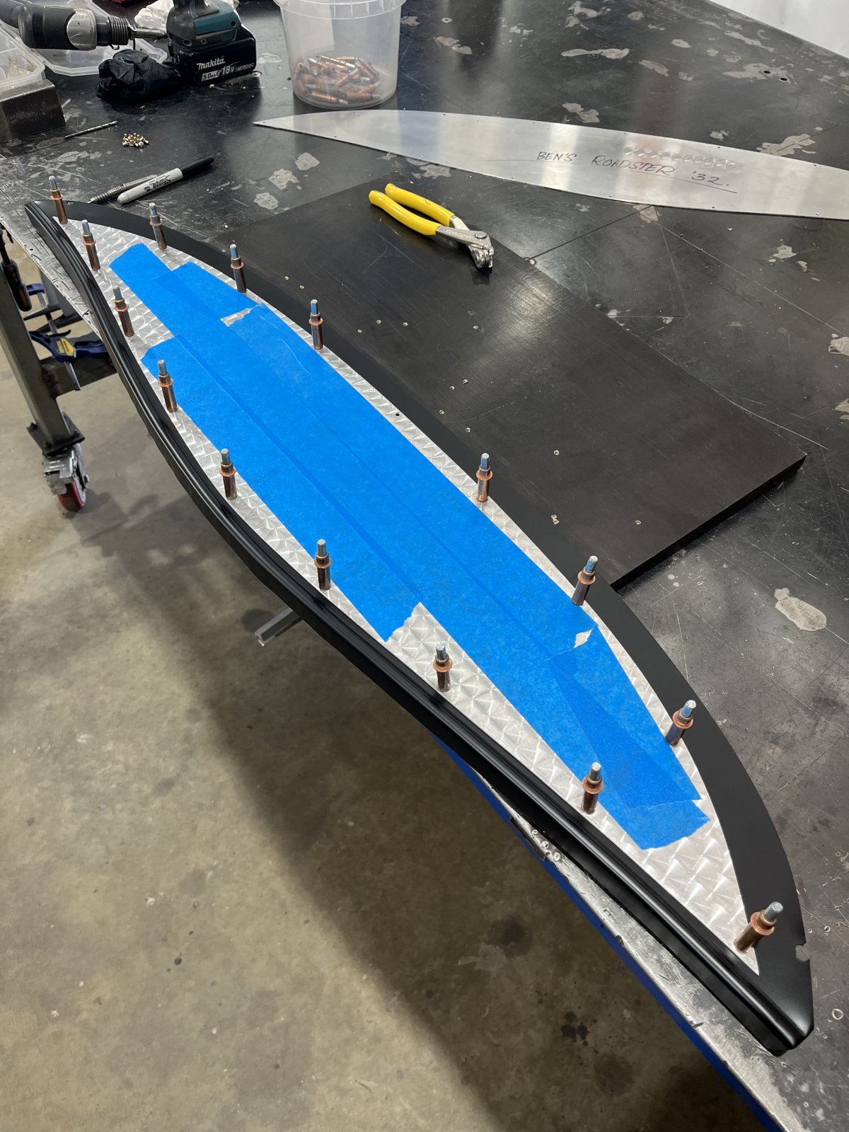

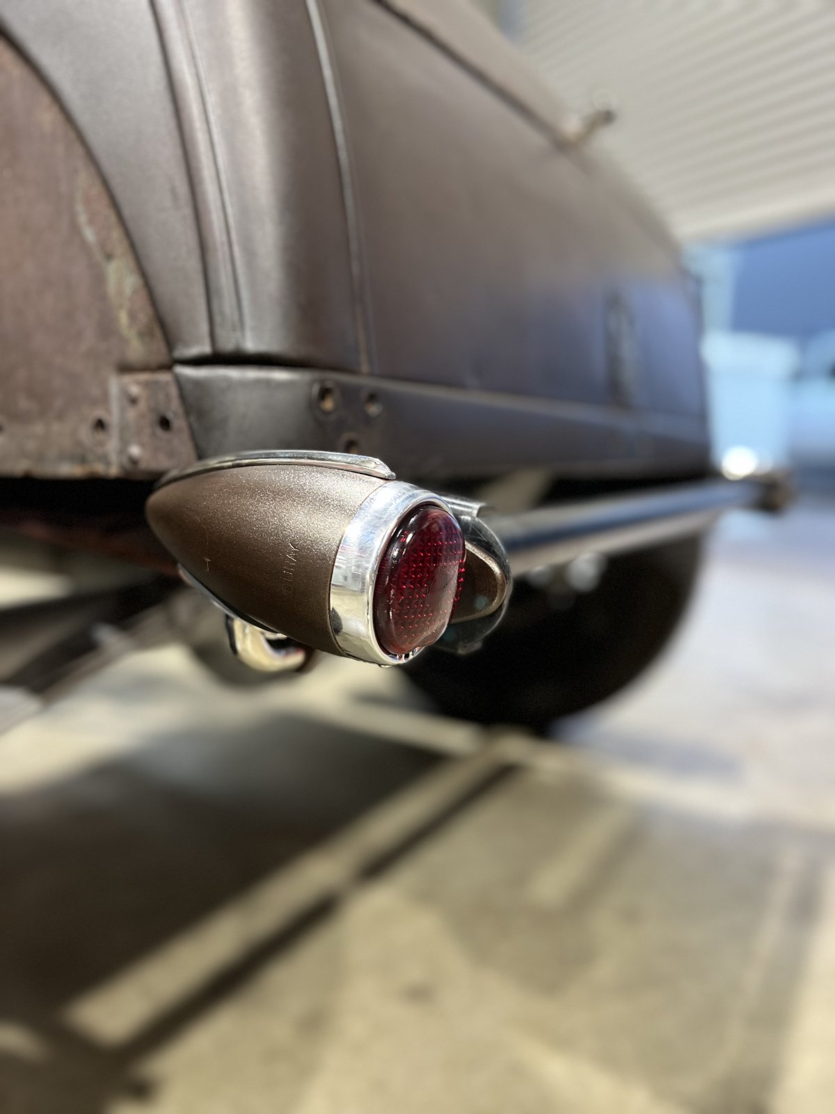

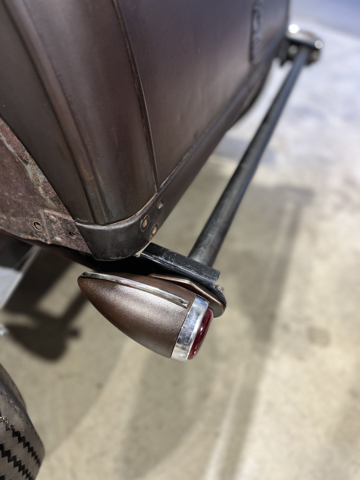

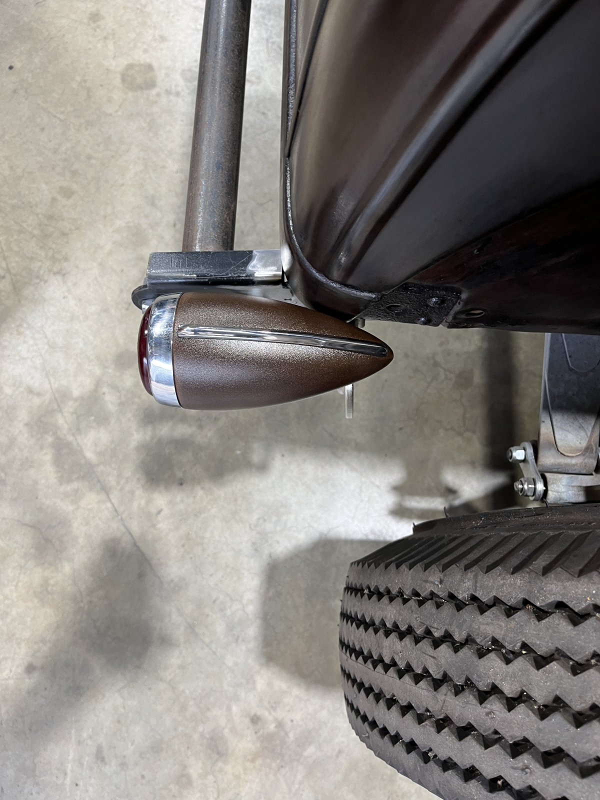

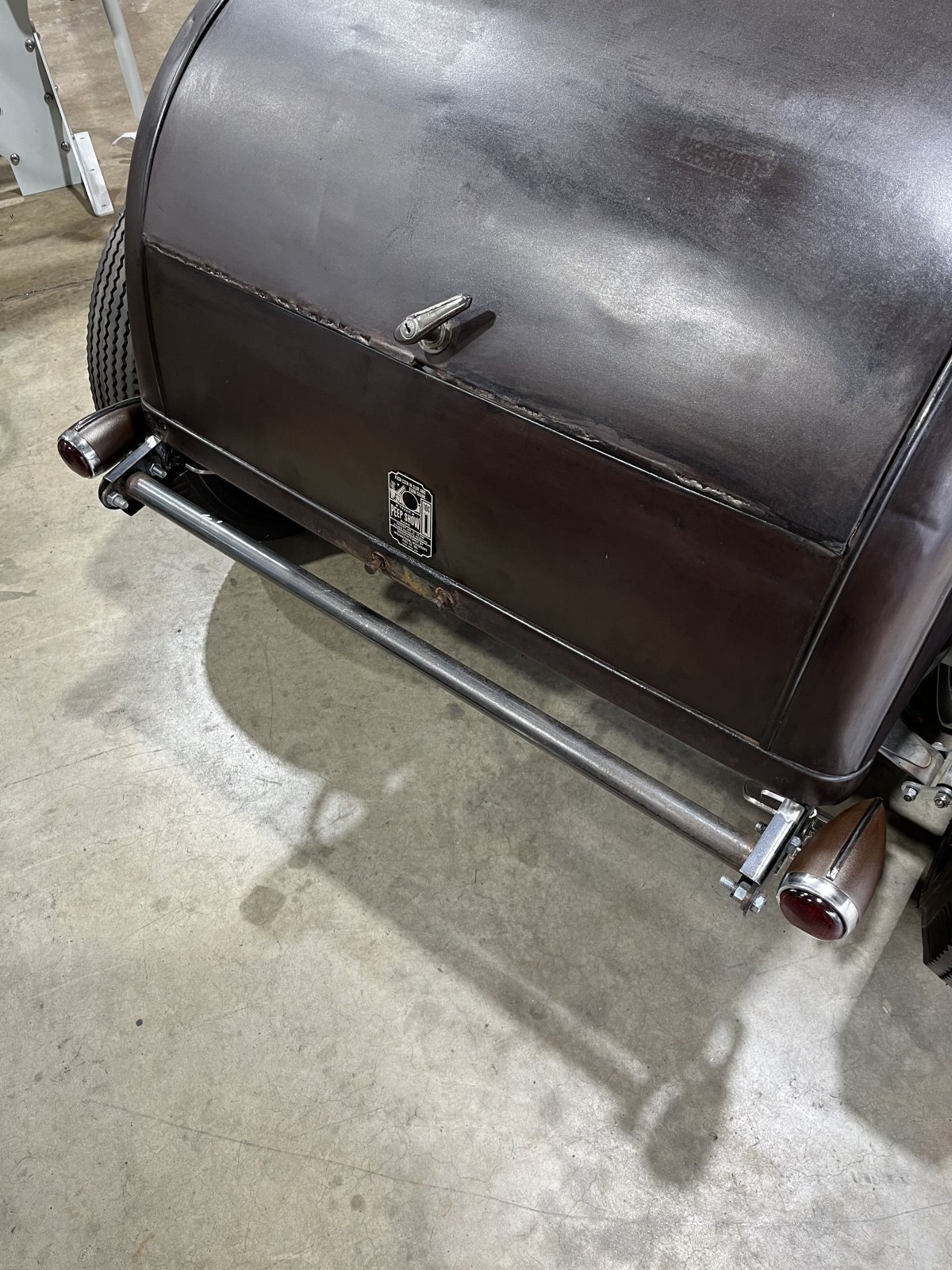

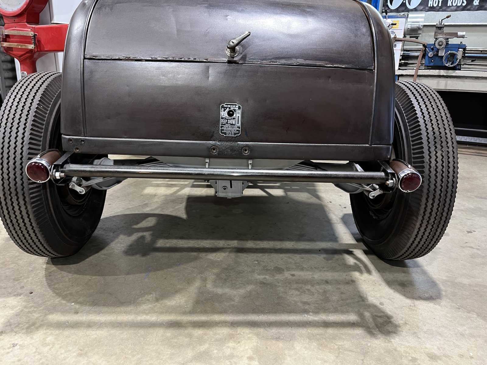

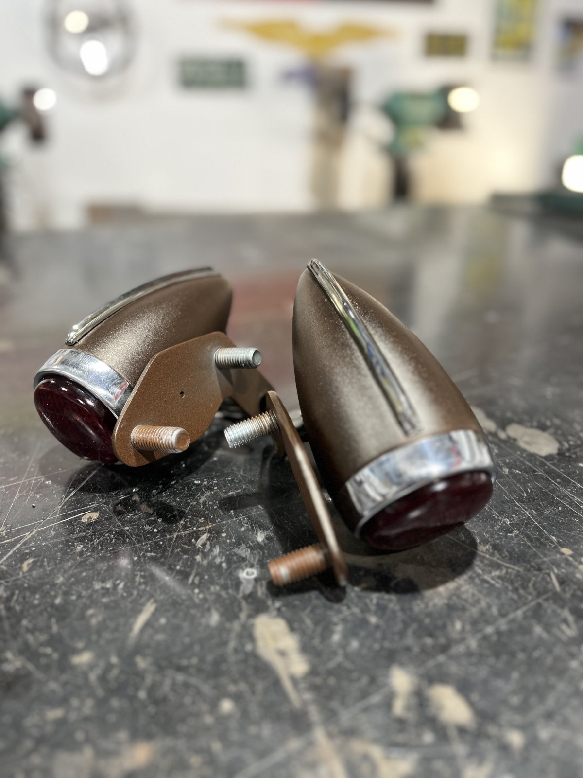

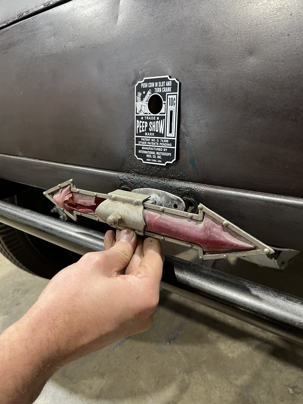

  12. Wrapped up the tail lights today, finished the mounts. Happy with the turn out, trying to simplify the brackets and where the spreader bar fixes. The 3/4 shots my favourite almost looks like they are floating. I used the needle scaler again to texture it before powered coat and stain.
    Simple but effective.
    NEXT on the list, more rust repair. Including the lower edge of the boot skin- modify it the a rumble seat. And much more!

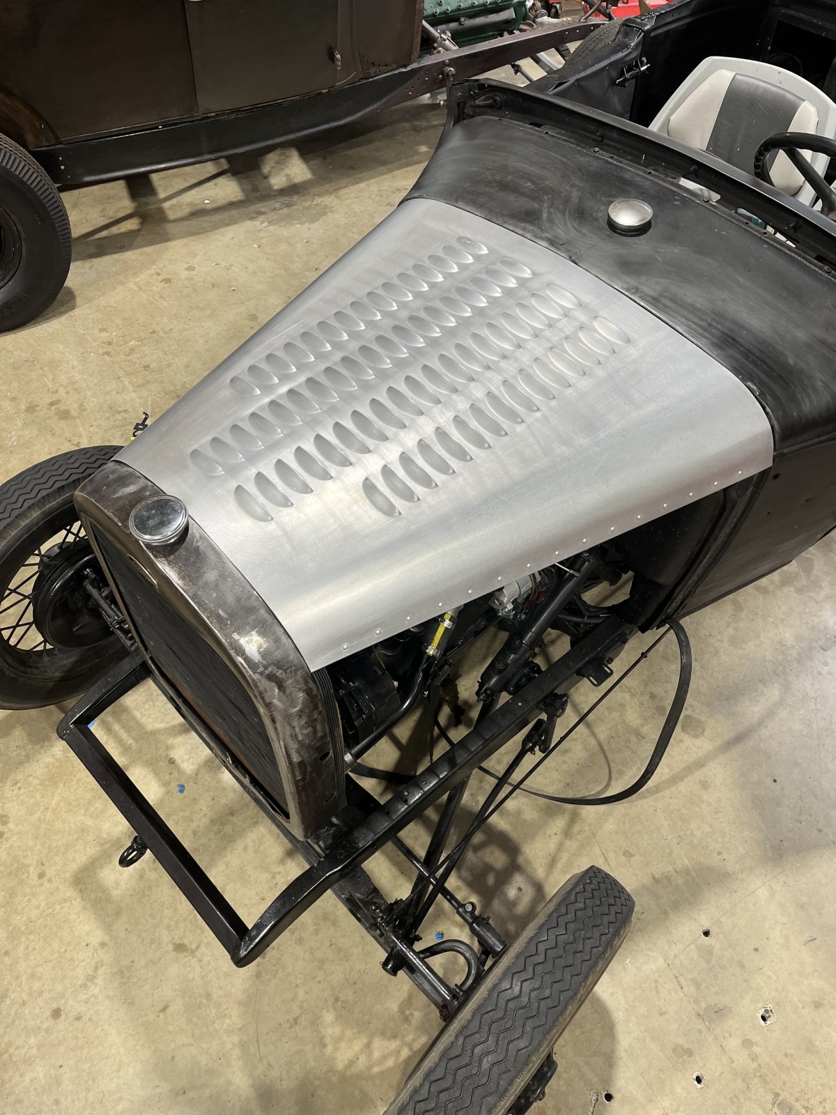

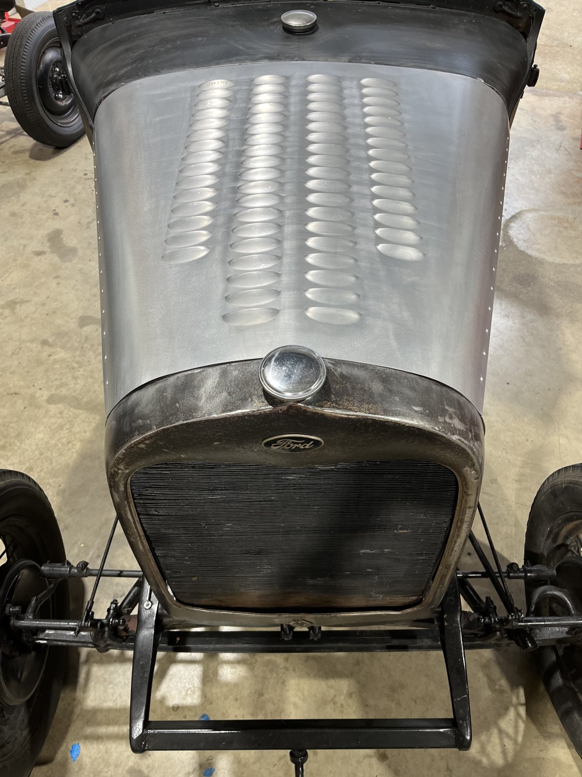

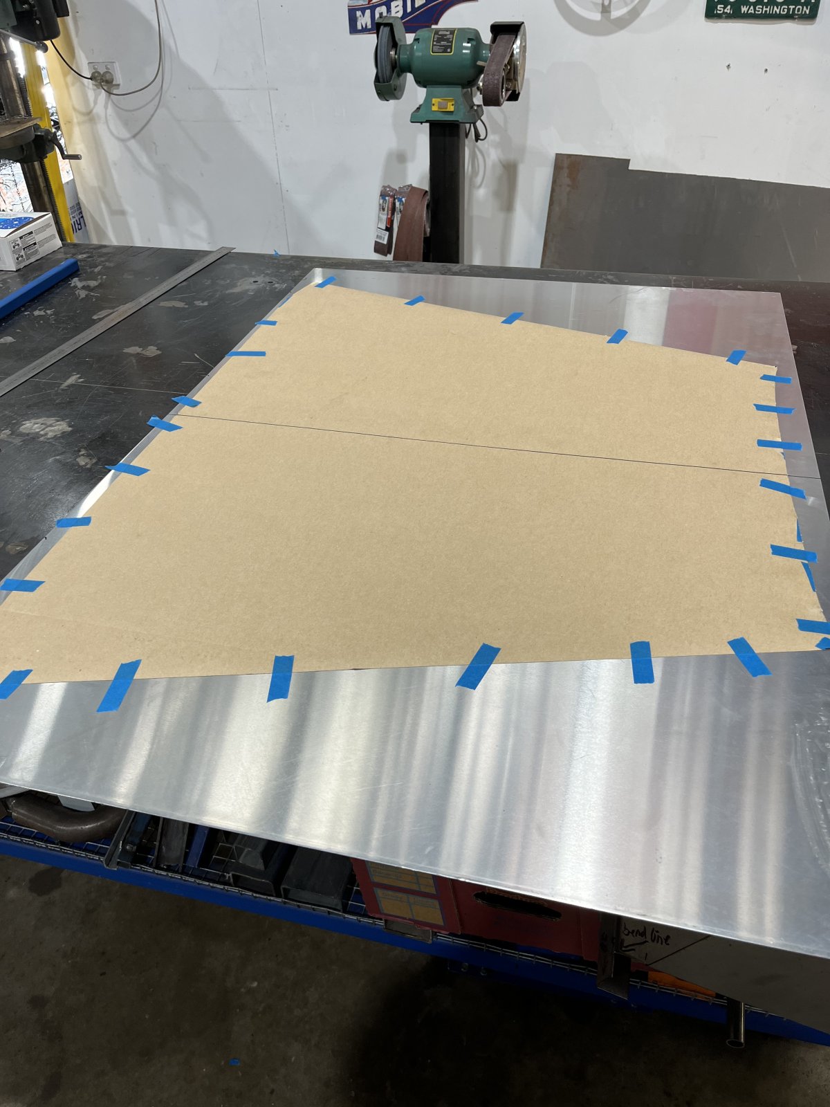

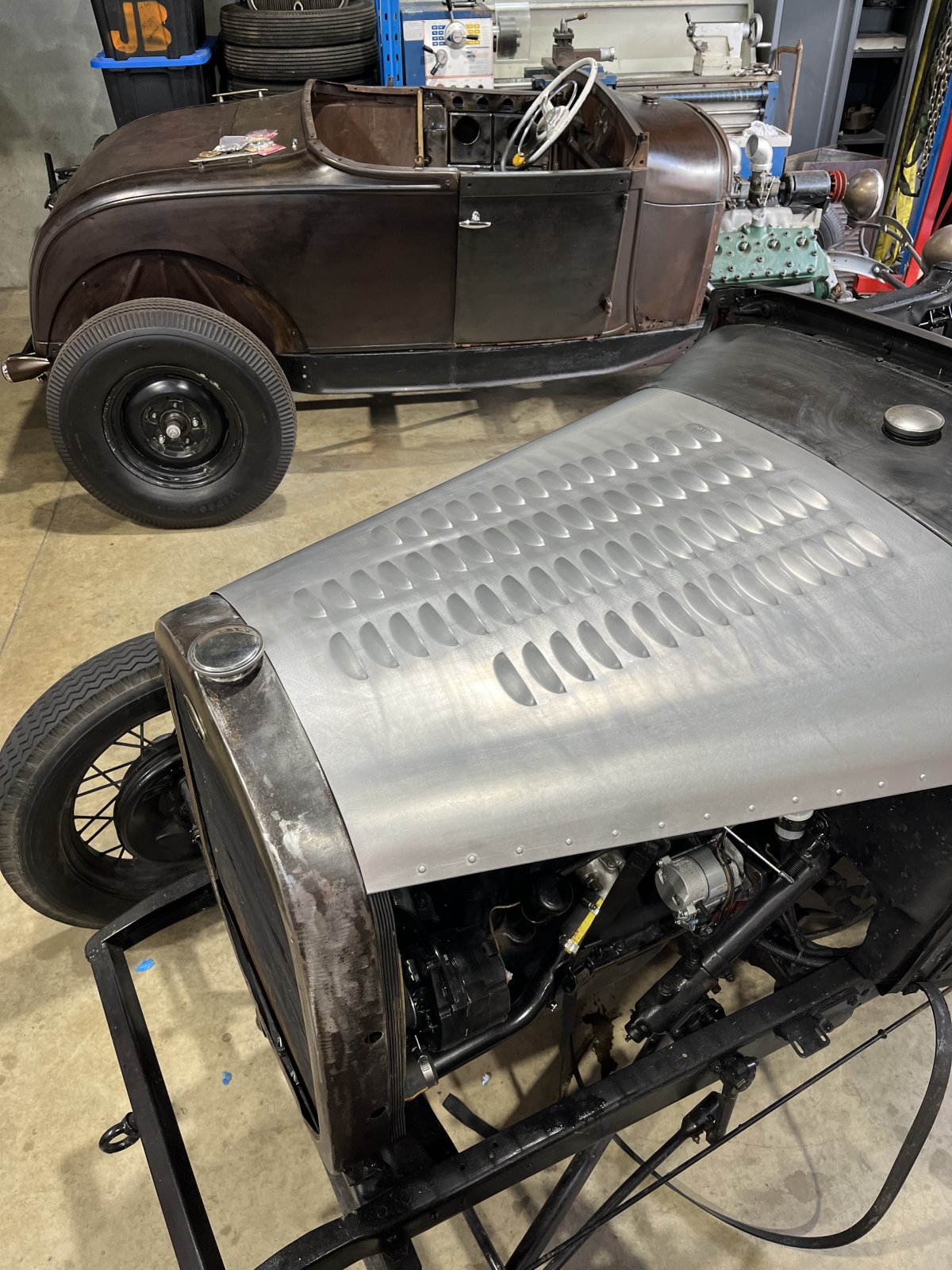

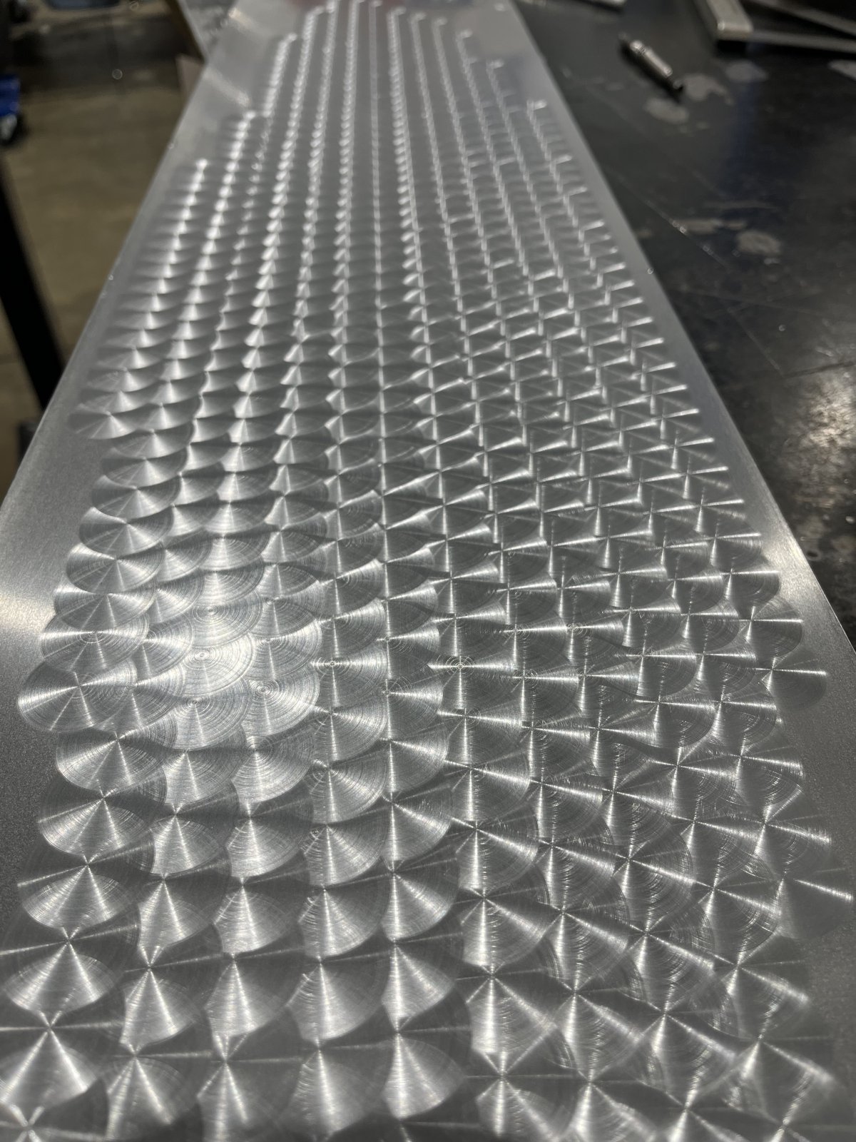

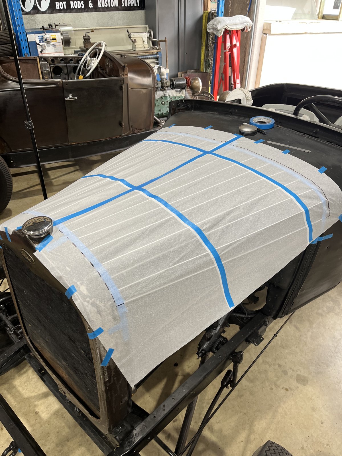

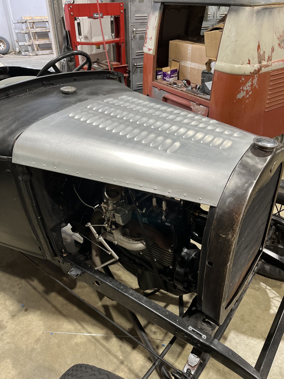

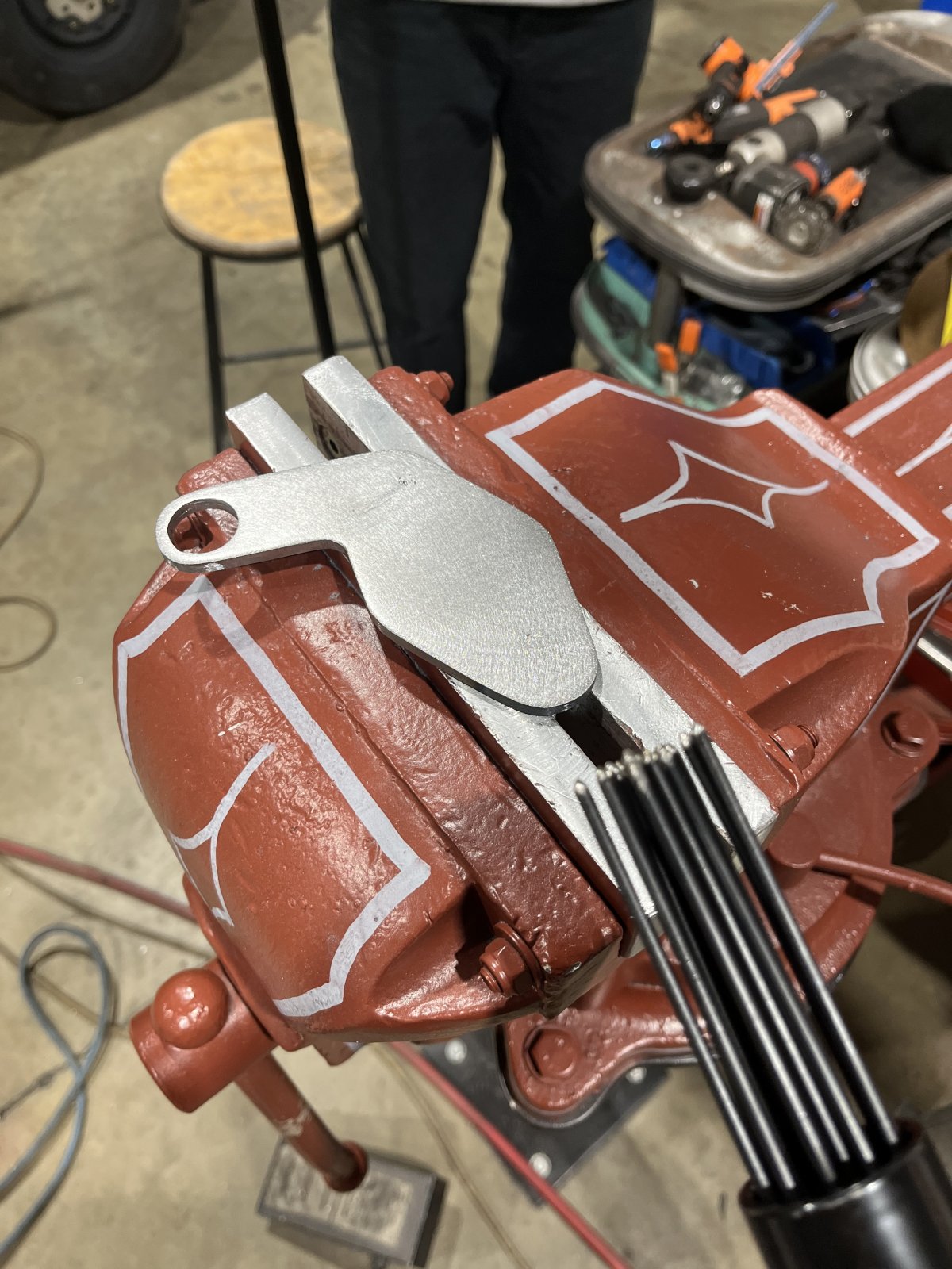

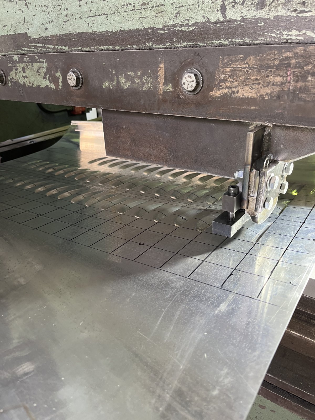

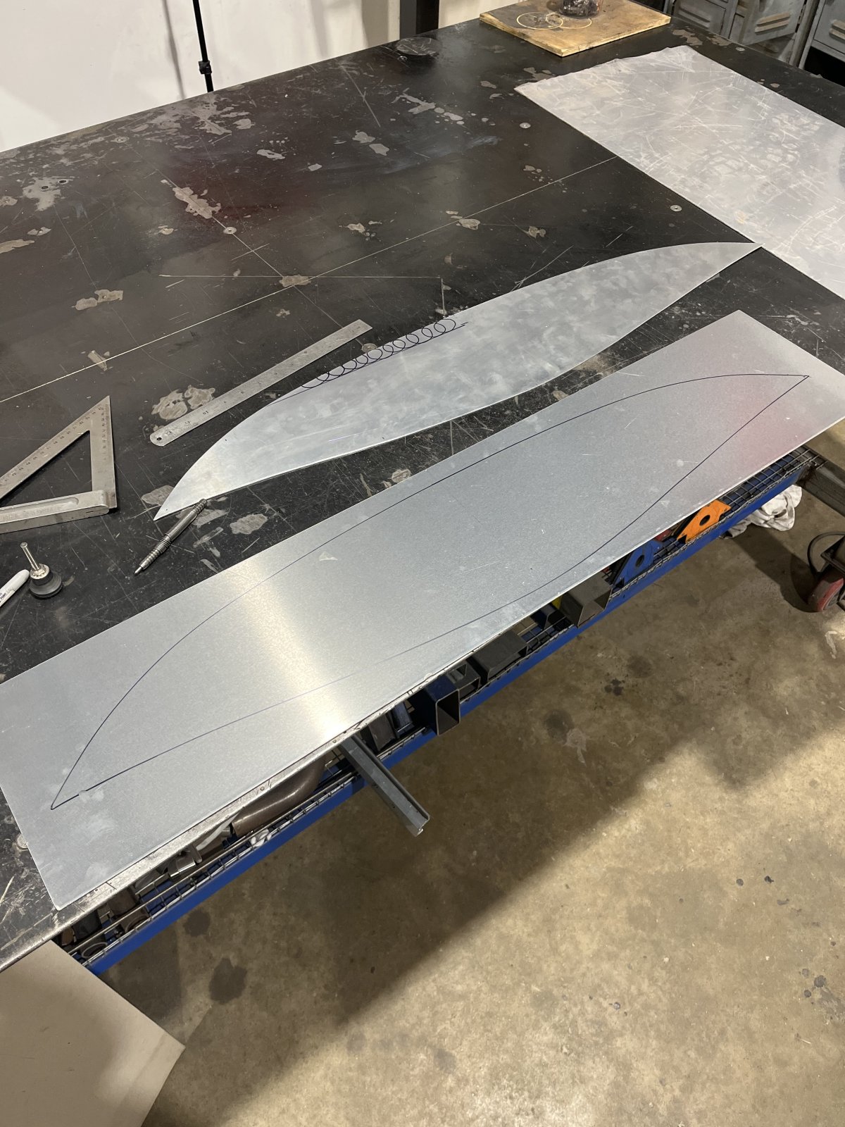

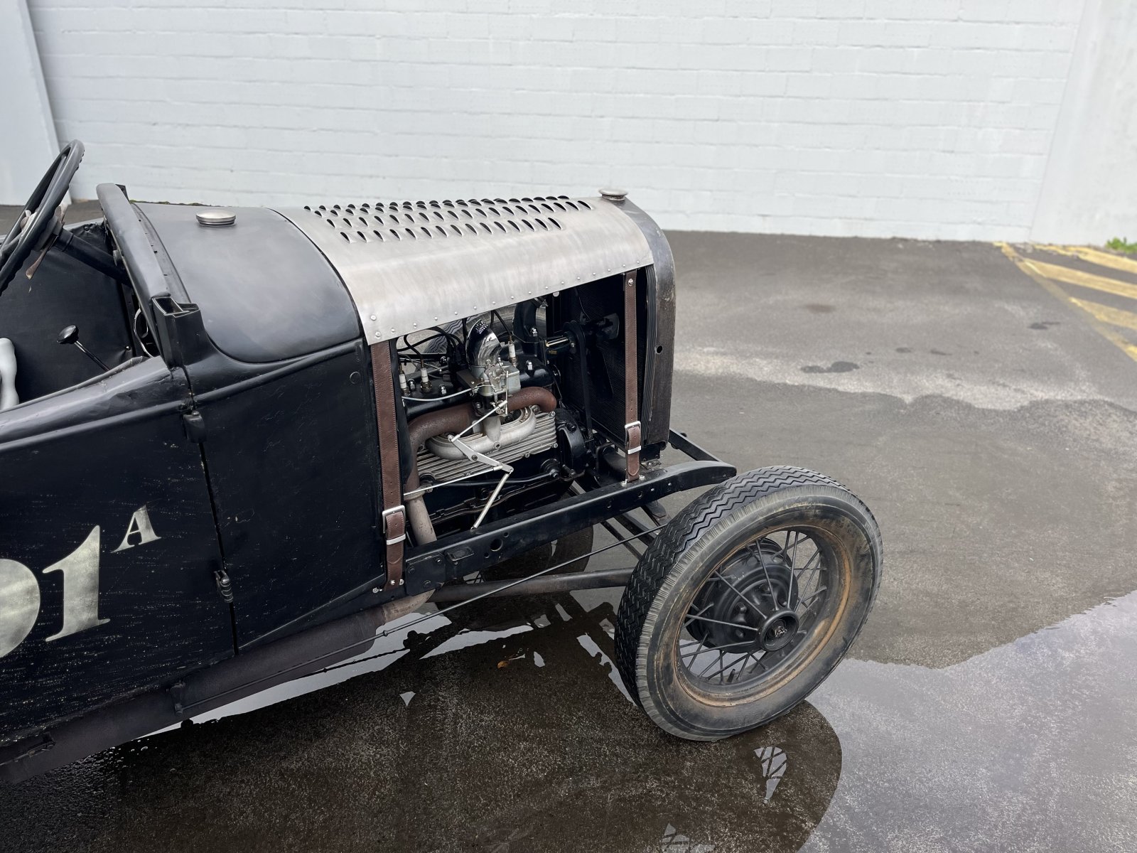

  14. Working on a friends sport coupe today- Aluminum hood louvered. More to come 1F40B2BA-5507-44EC-AB55-A3A377382332.jpeg
    osage orange, Stogy, brEad and 3 others like this.
  15. Dedsoto
    Joined: Jan 7, 2014
    Posts: 375
    Dedsoto
    from Australia
    G'day Rex!
    Stogy and jordabennett like this.
  16. Texts Rex to collie see you there!
    Stogy likes this.

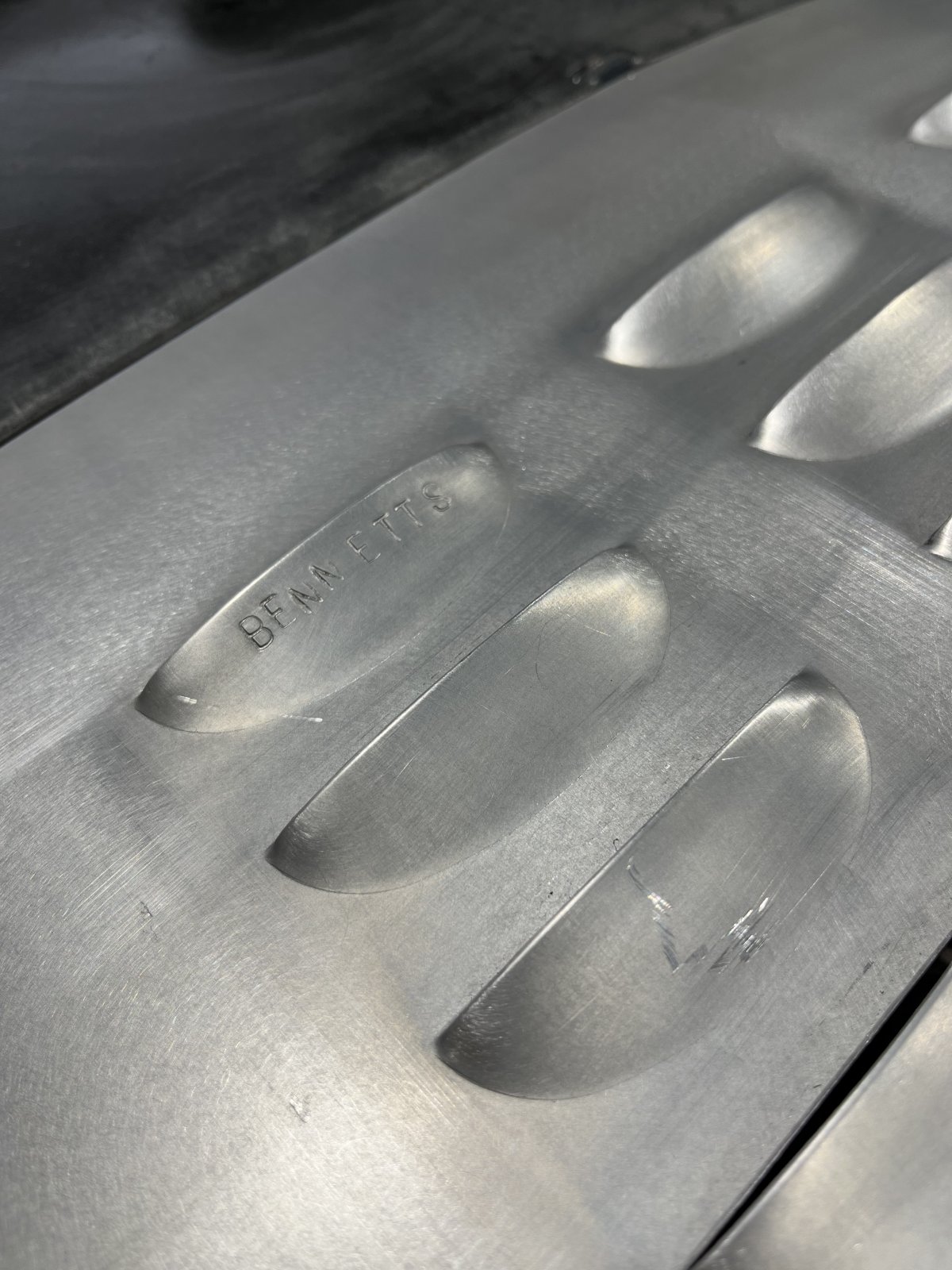

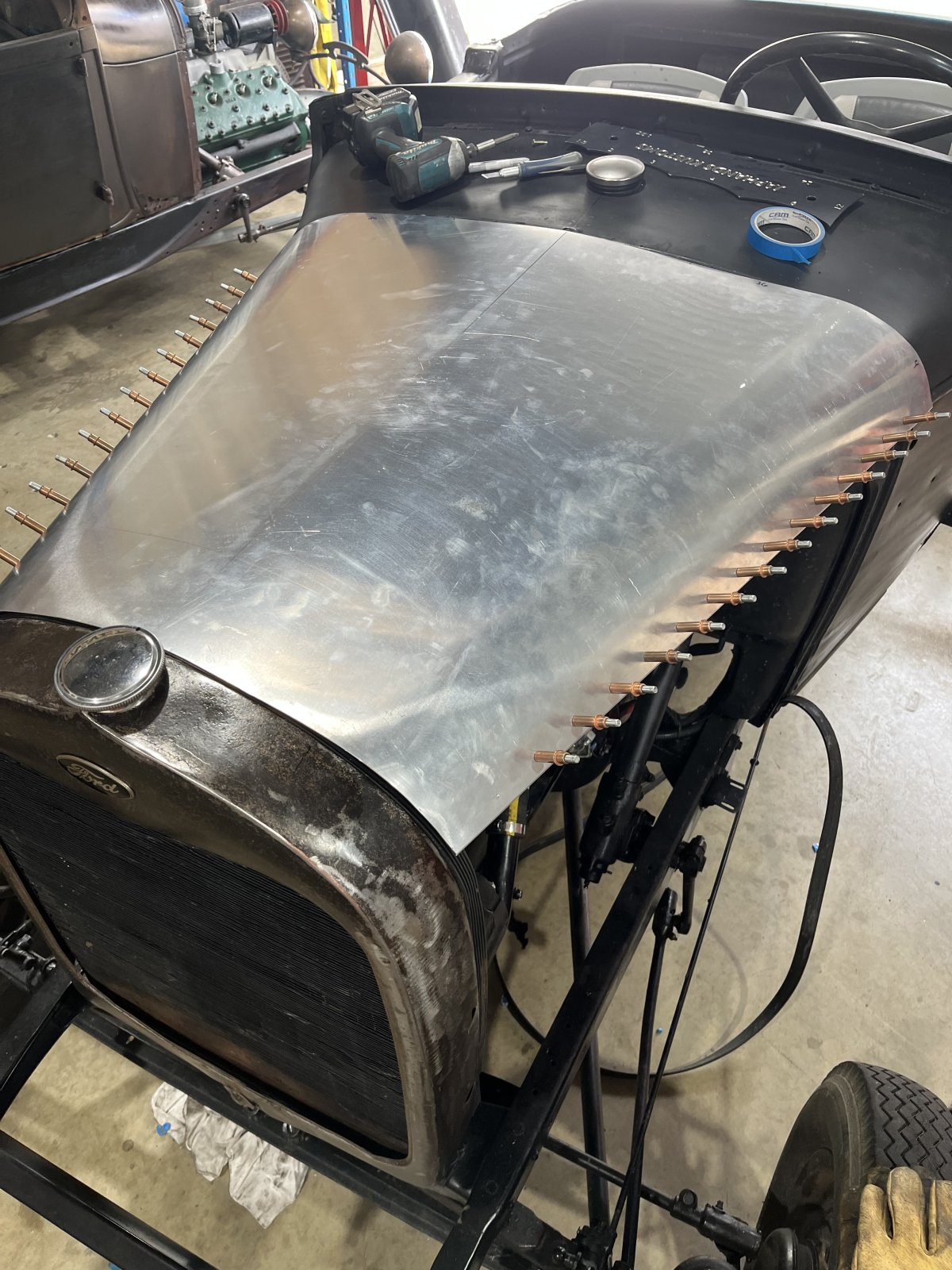

  17. Struggle using 1.2mm ally, usually use 1.6 for a his but learned a fair bit. It’s not perfect but suits the car. Few leather straps to hold it down and Texas Rex will be flying around the circuit 999BB007-4FF2-4E11-B3C5-7BBDD9D1D488.jpeg B62DE3BC-3CC1-4B67-A9EB-18B4AF5286A5.jpeg 04D22724-152C-4306-BFBD-F077605303B7.jpeg C0B9A28C-F17F-49B0-B262-FF31783E3A92.jpeg A404BF51-EB55-43B0-972C-A2A734C1AAA6.jpeg 7AAE3FB1-9EBB-44A7-8F8E-2D7E72DA91AE.jpeg B5D690C5-B263-4643-AFEC-78072D798246.jpeg B4341C7C-BAFA-4FA3-80CF-D0E3D5B83626.jpeg 3BB9F490-A041-4BF3-A900-1BD78D336FB9.jpeg
    Stogy, Joe Blow, lurker mick and 4 others like this.
  18. 29A215FC-F051-4CFC-AE6A-D4ADC0A9D16D.jpeg Turned out decent for the car and style he was after-

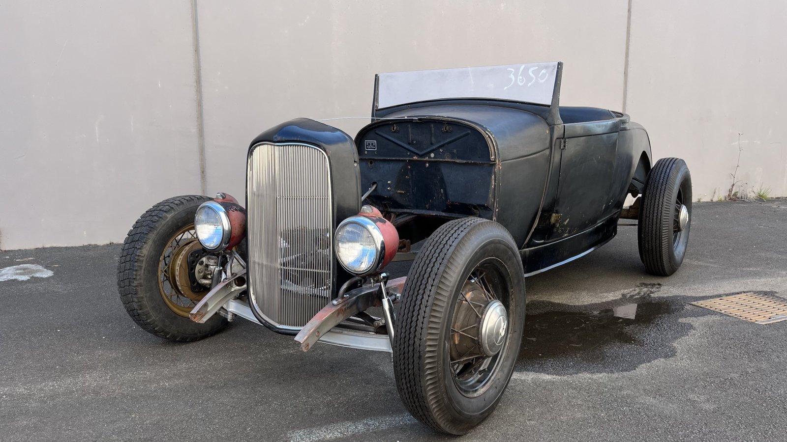

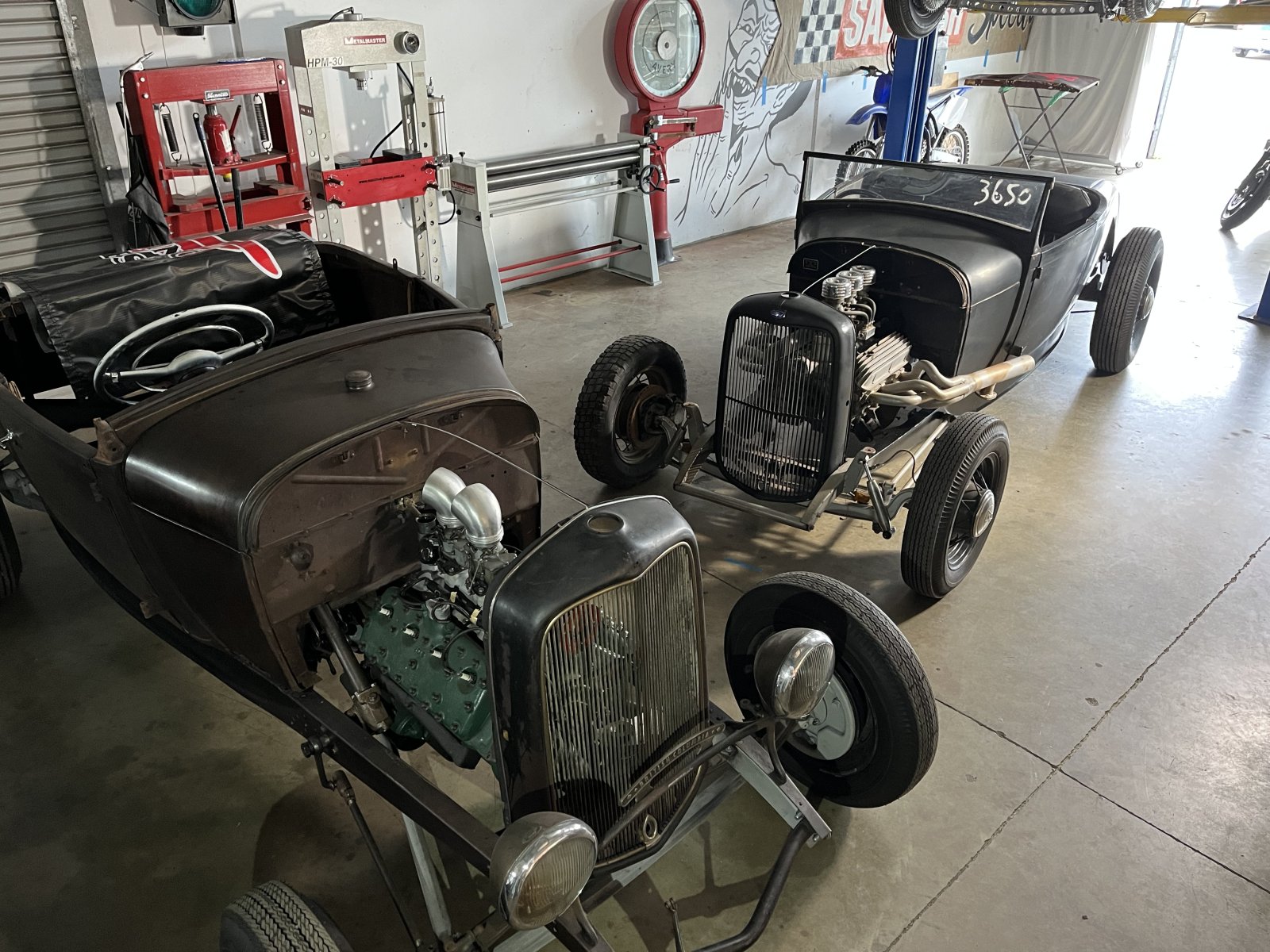

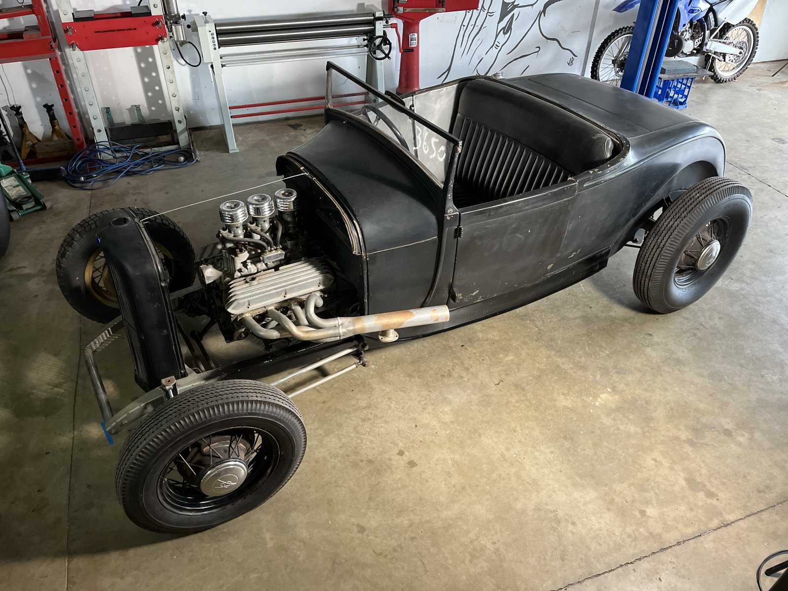

  22. A lot more to come- motor being pulled and start to rebuild! Changing up the whole hub and rim combo too! Also something followed us home. Another one- roadster fever.

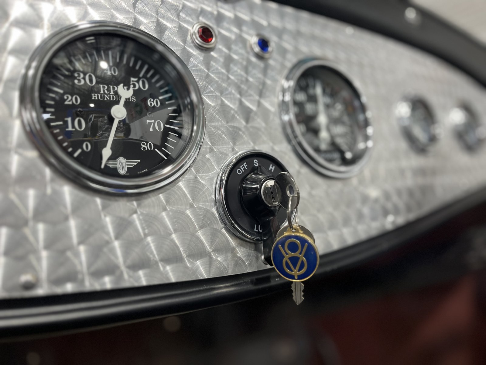

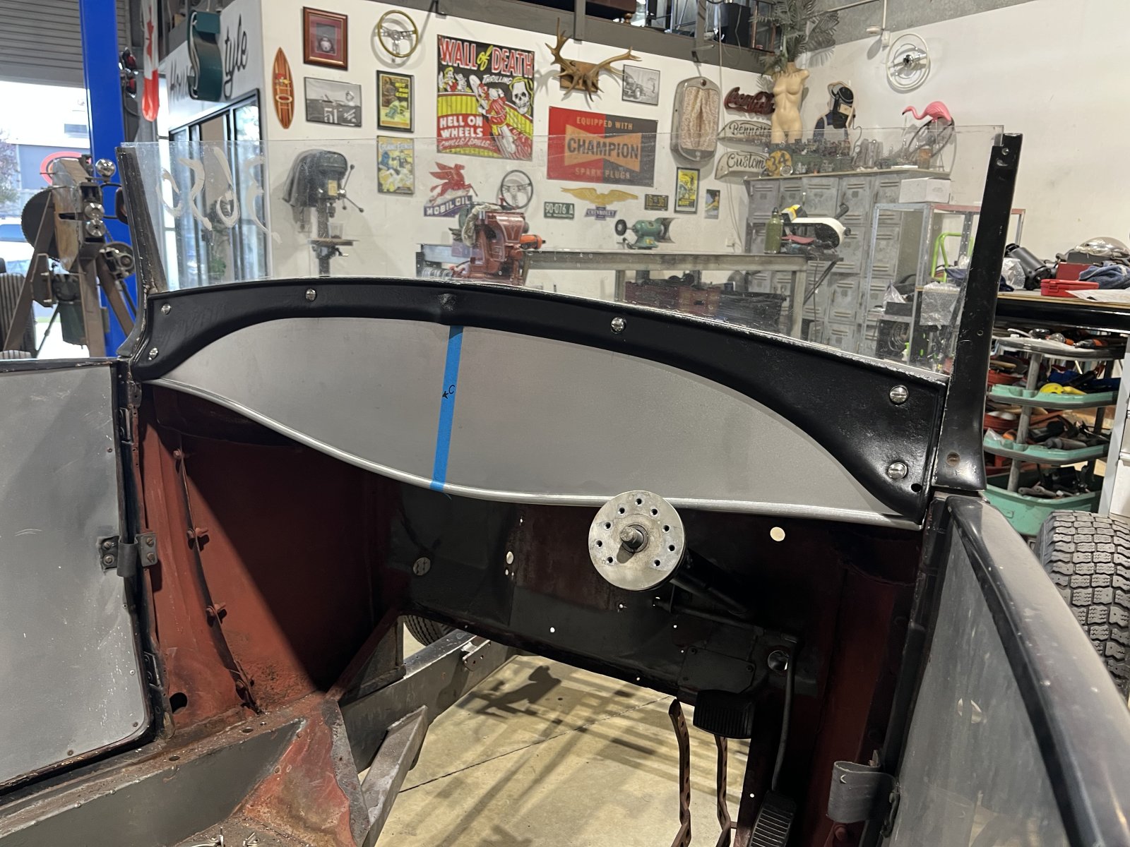

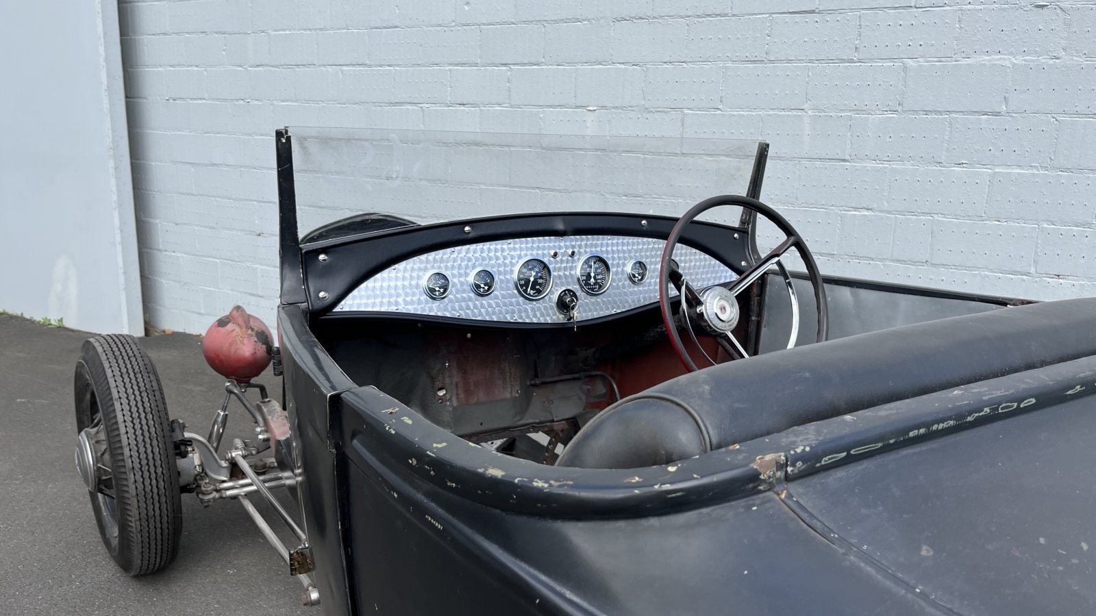

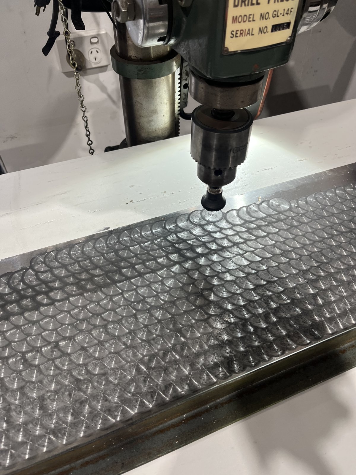

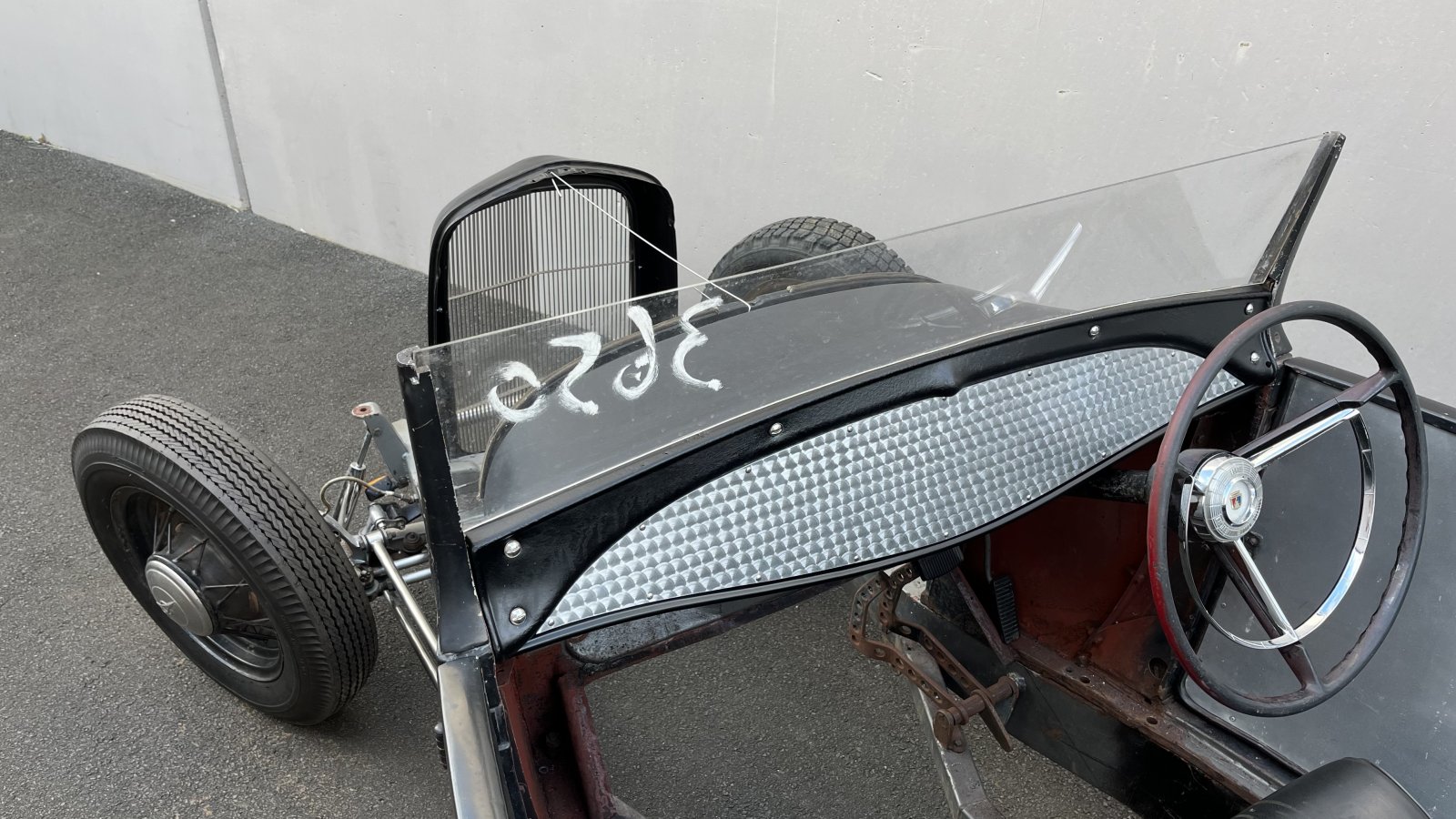

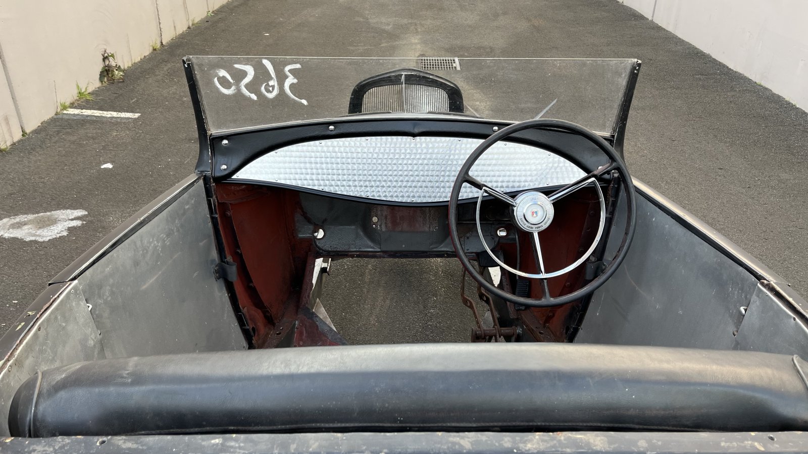

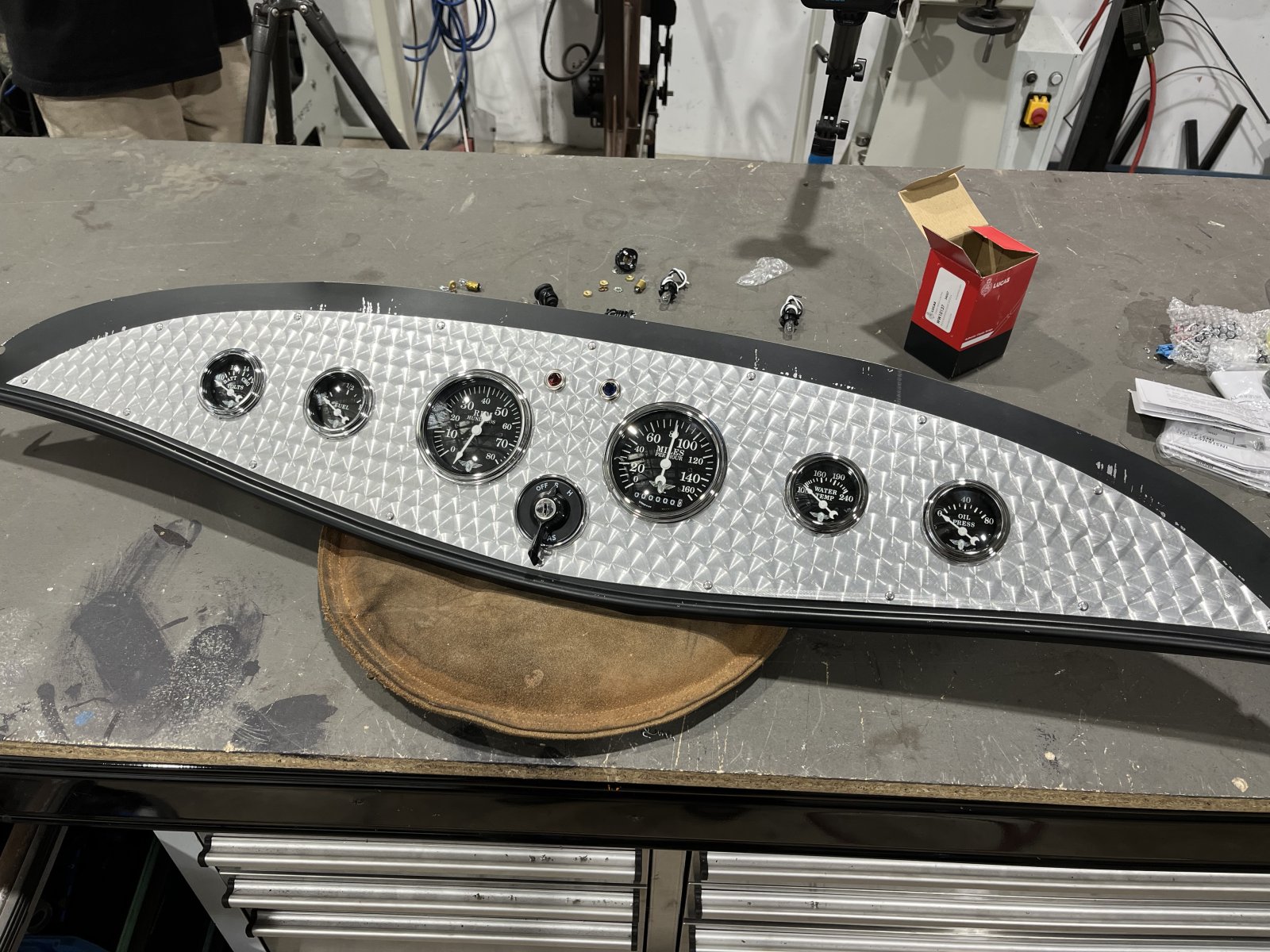

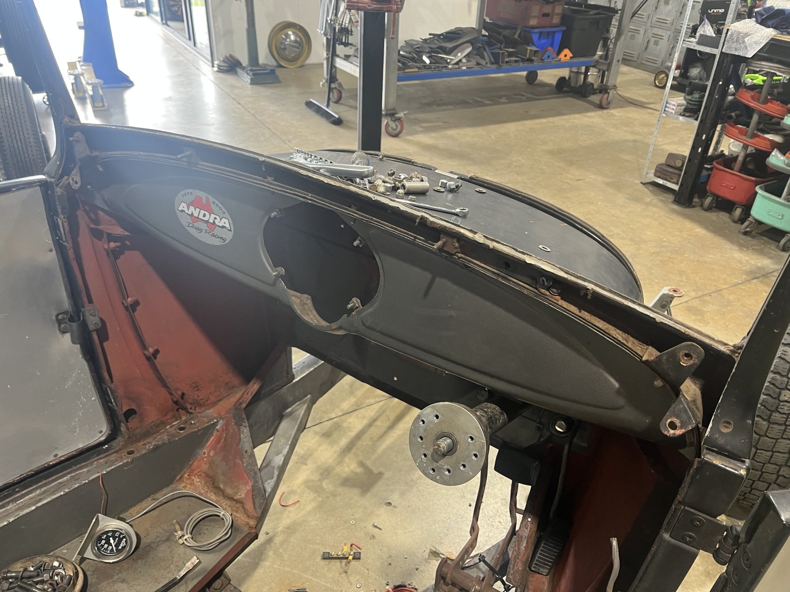

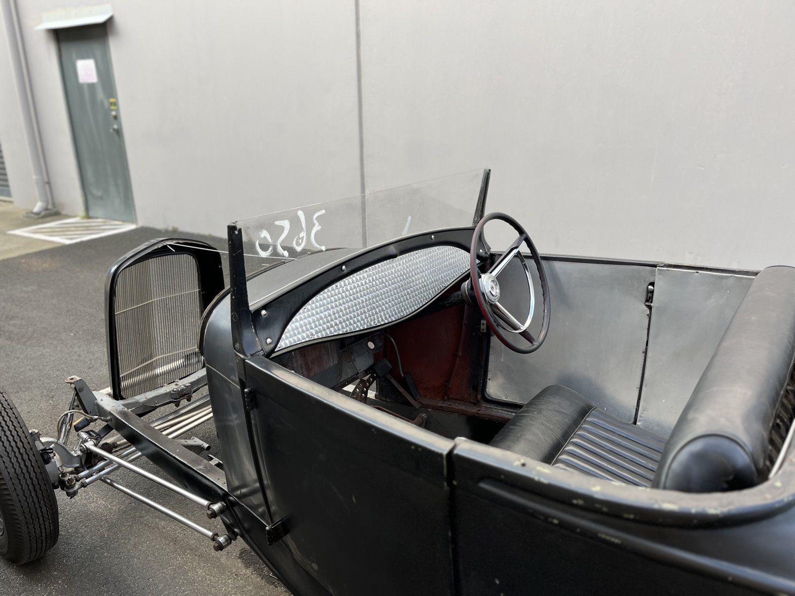

    I made a dash for Ben’s Roadster with an engine turned insert that is riveted in.
    Below,

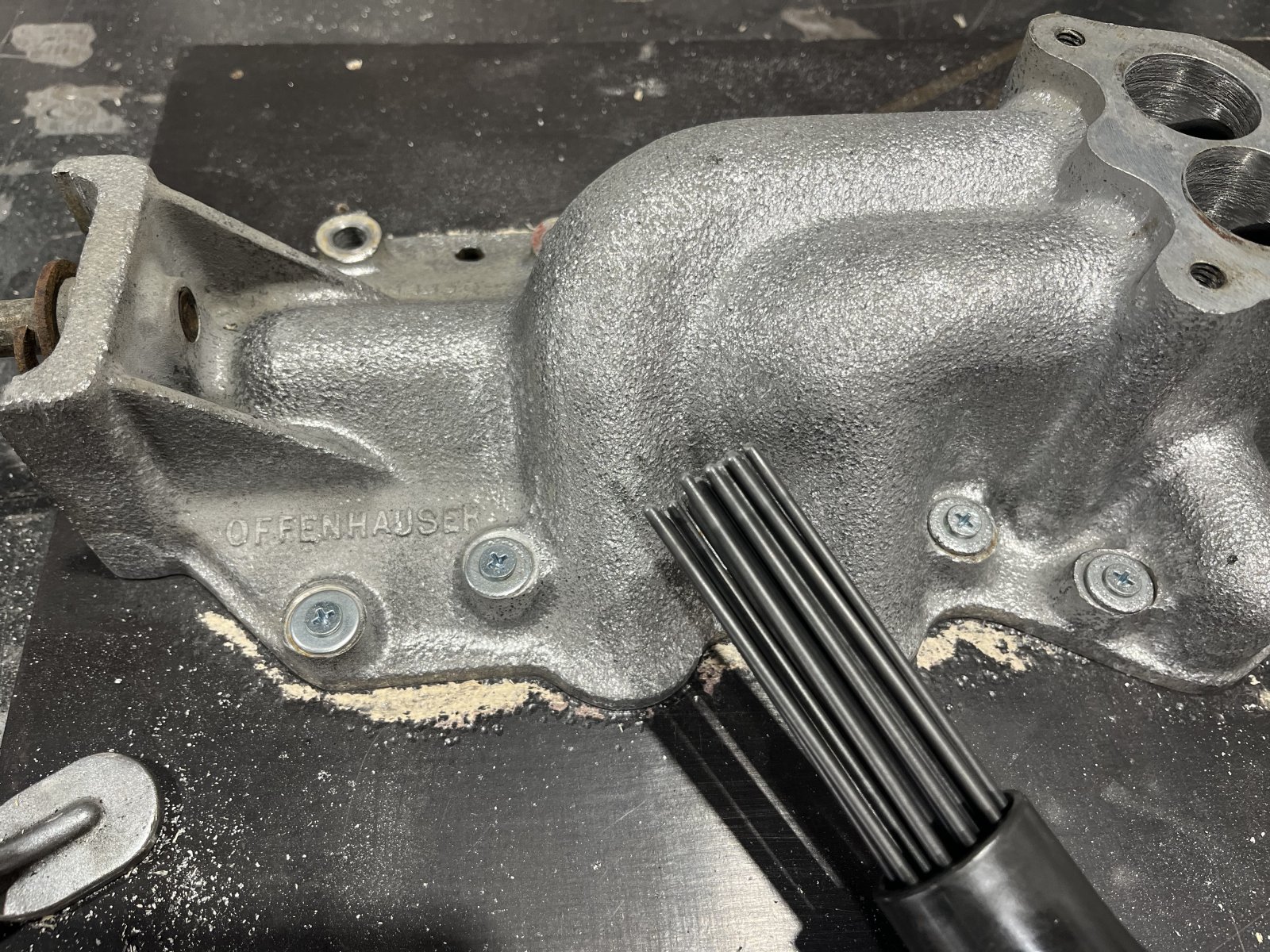

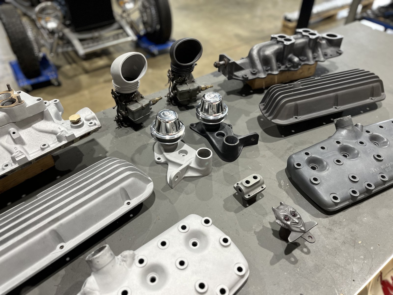

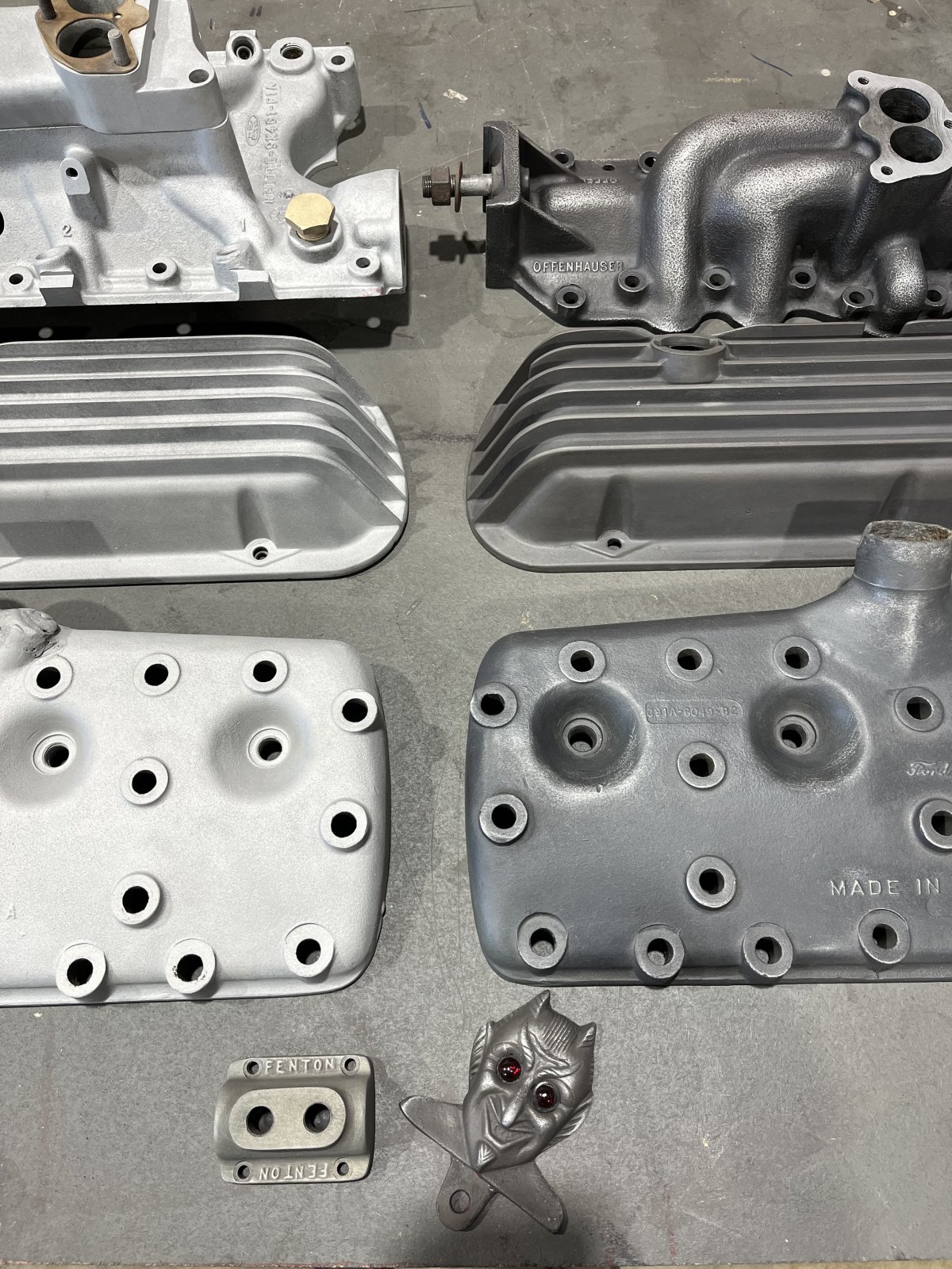

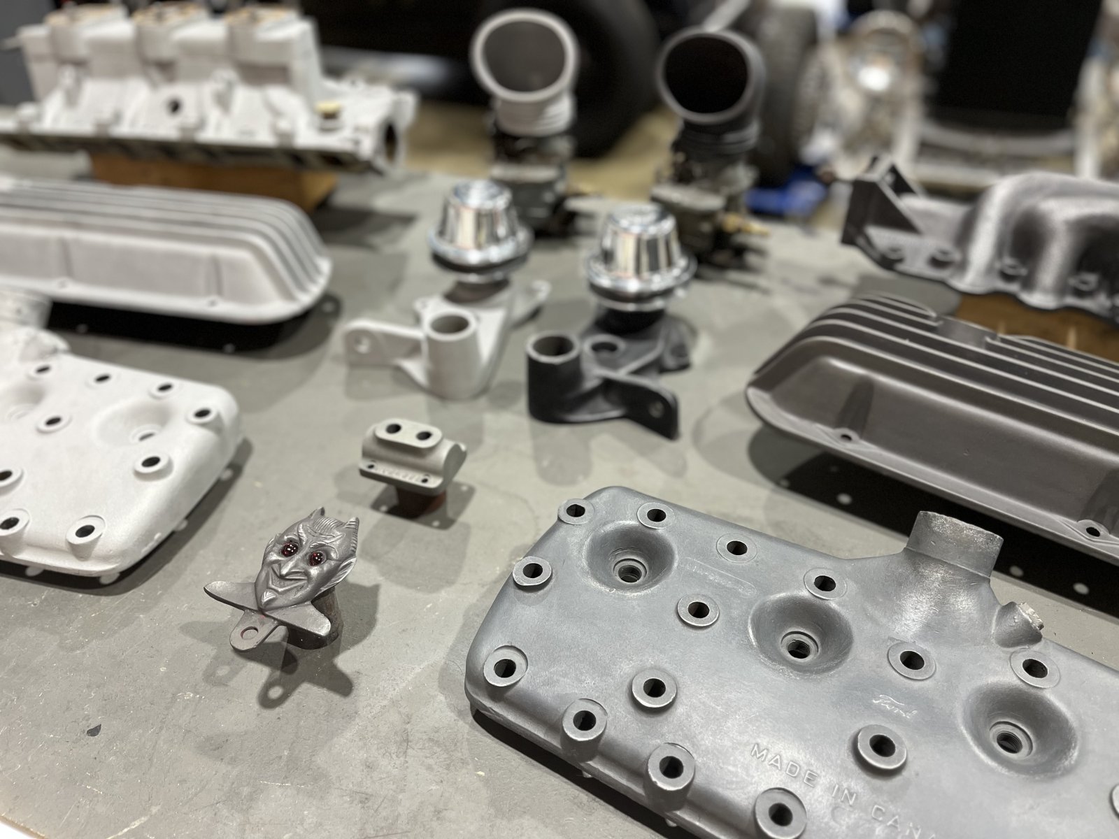

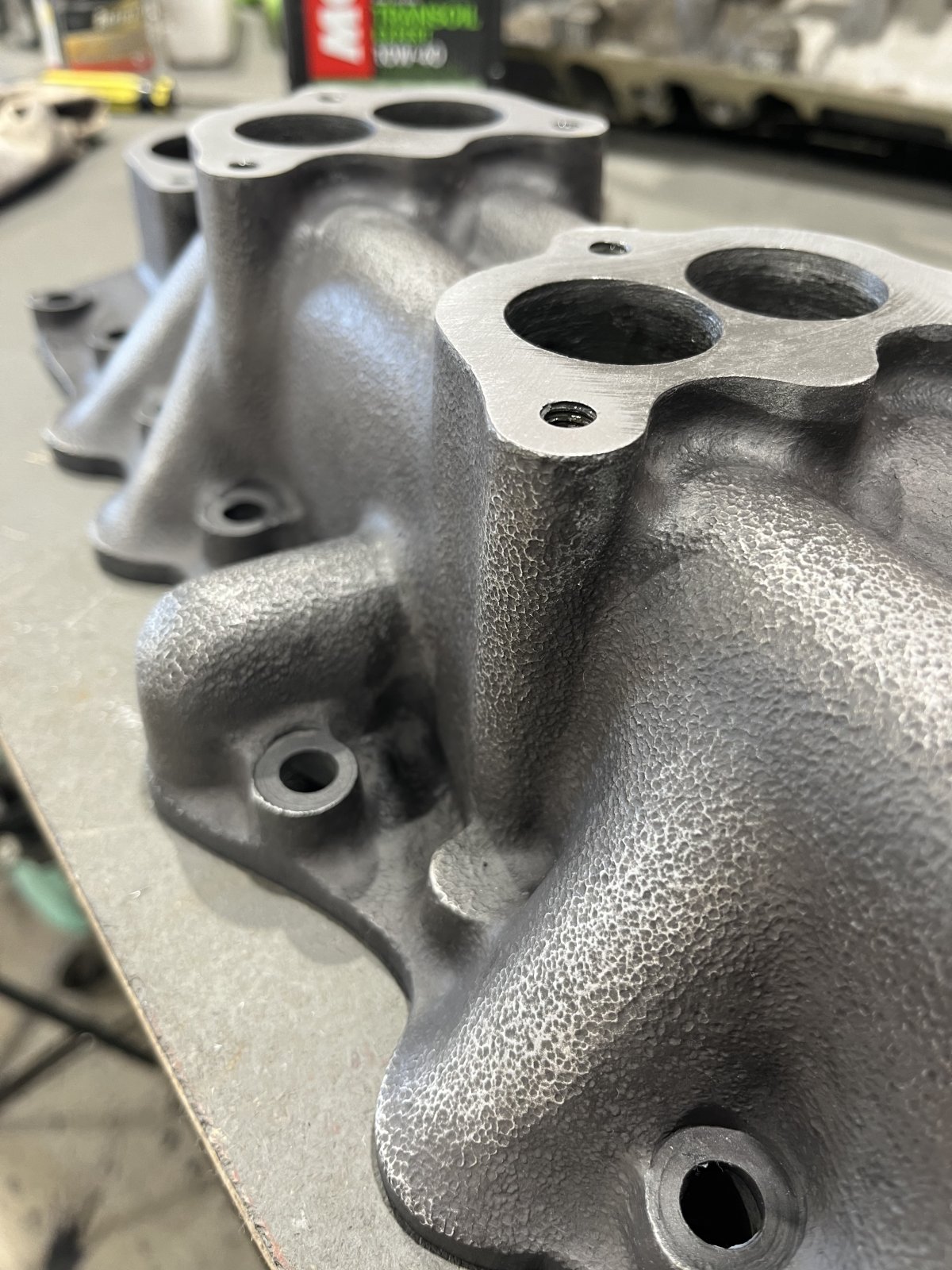

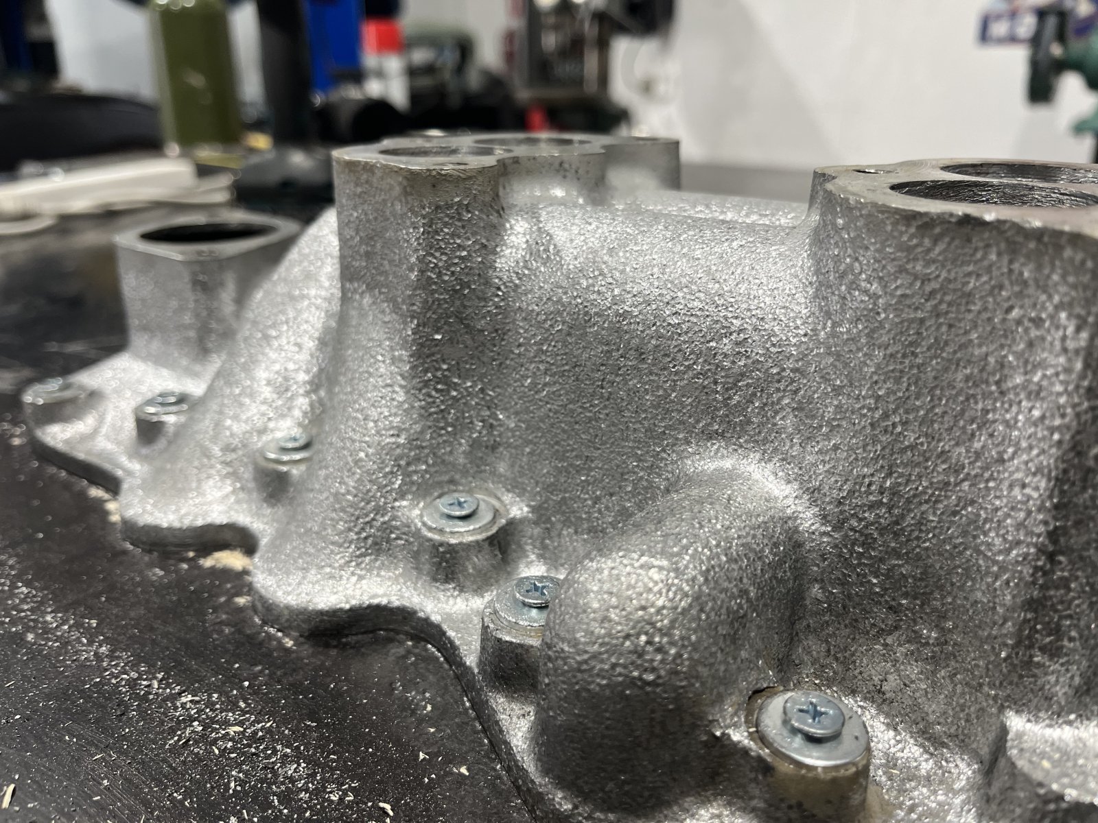

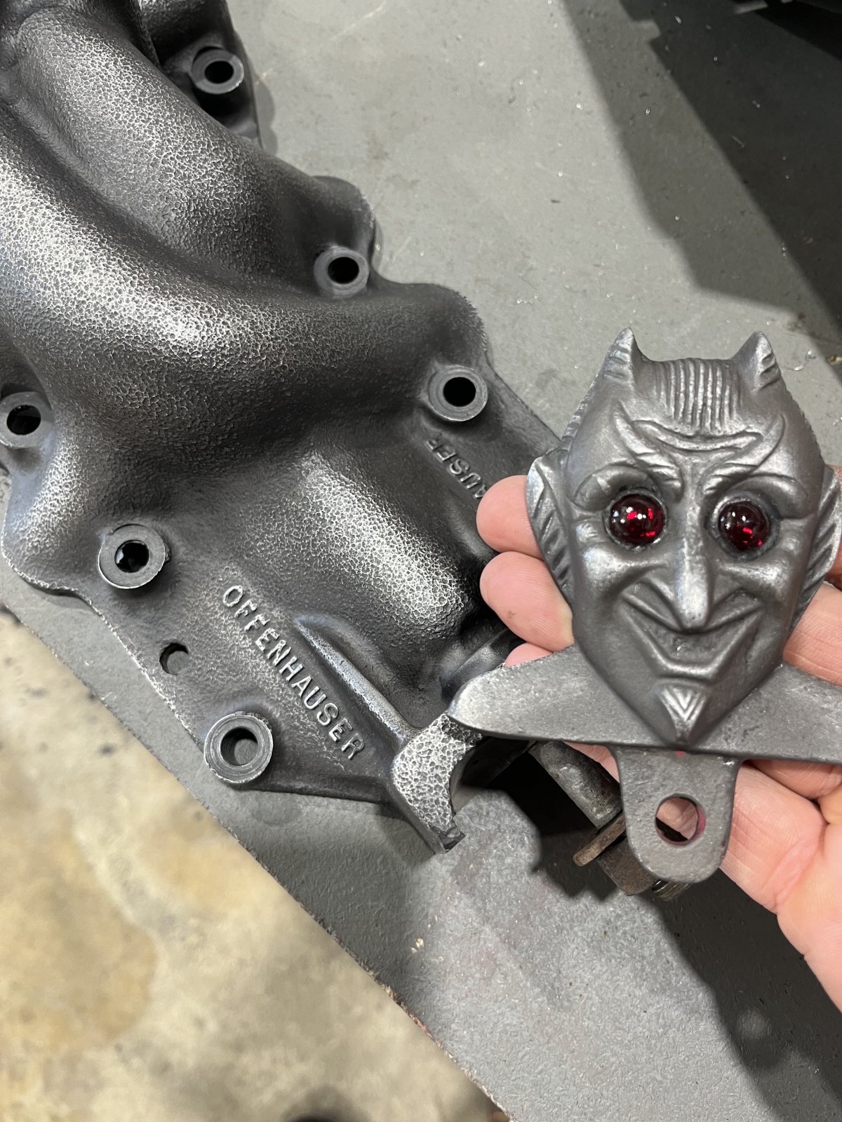

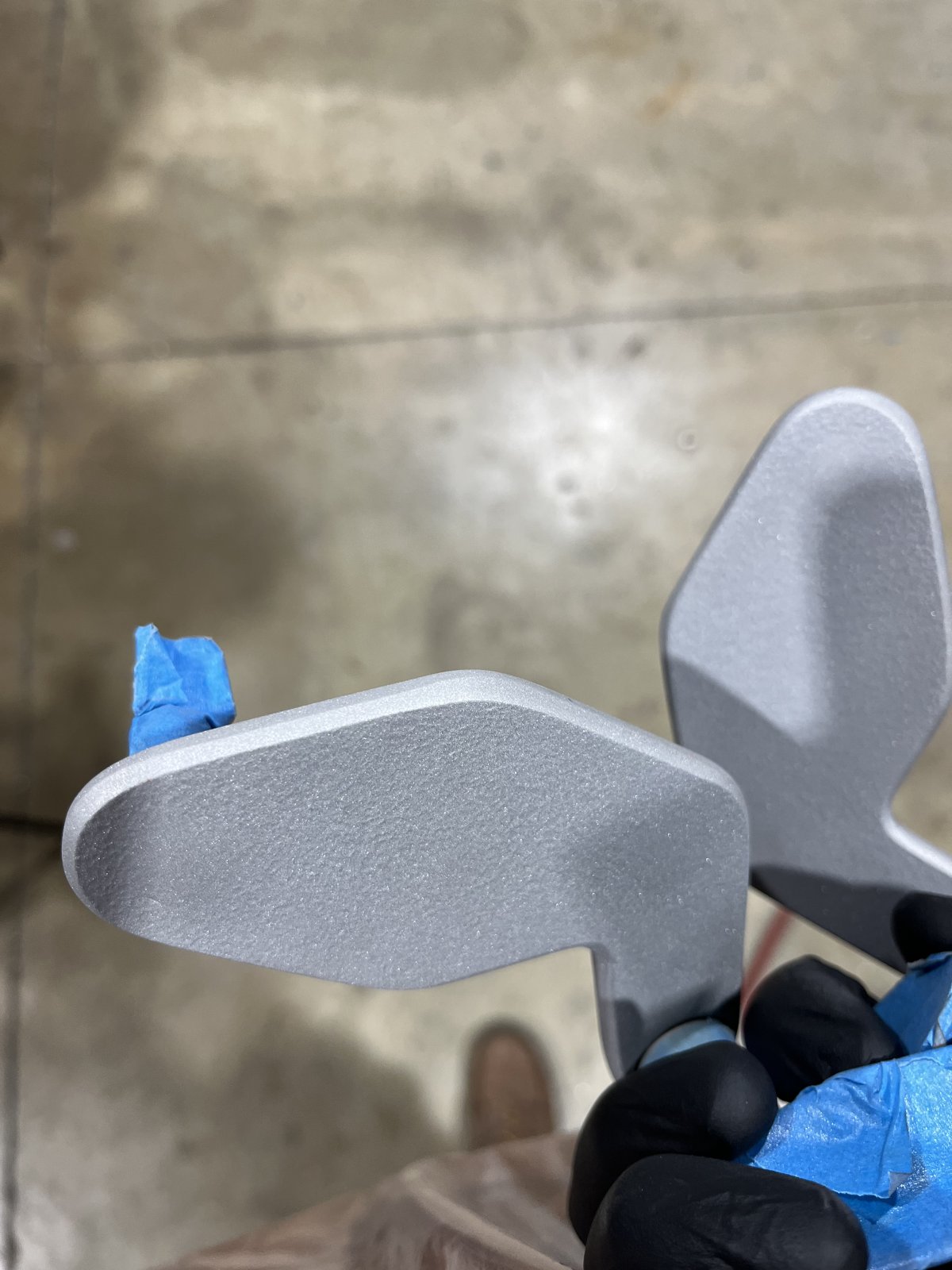

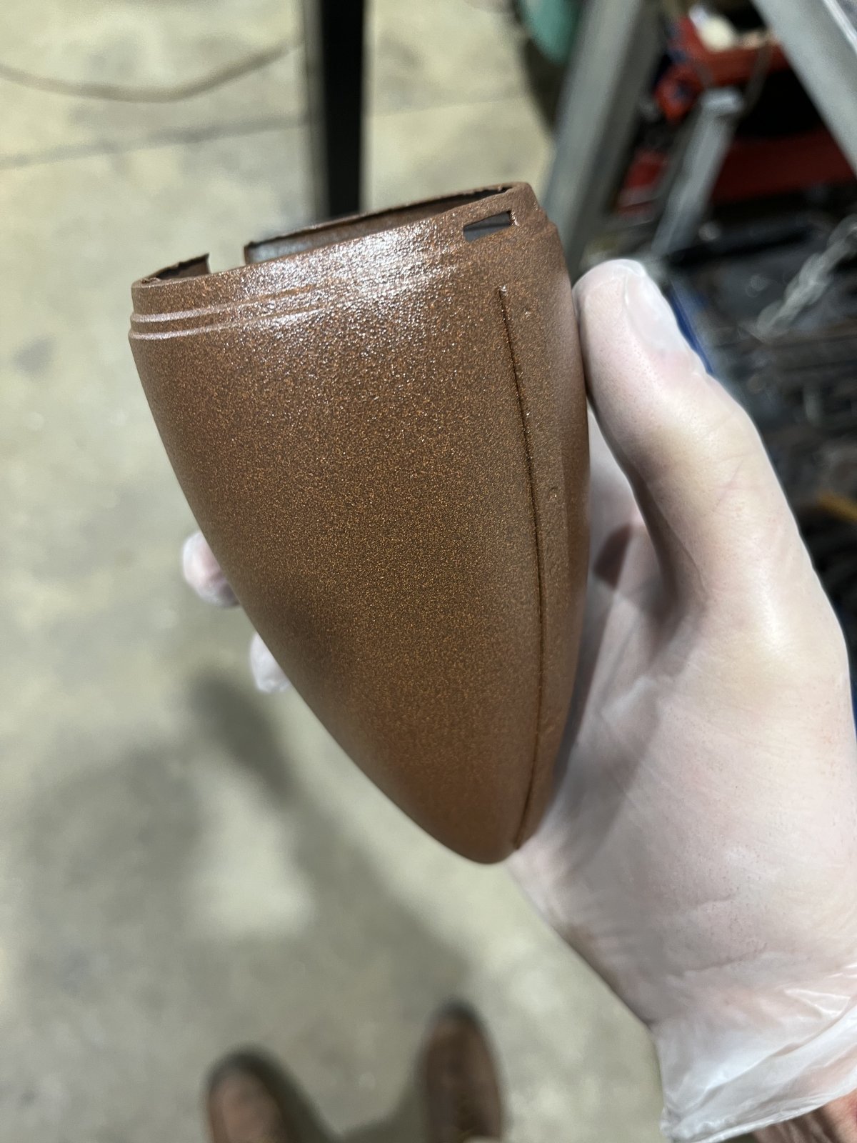

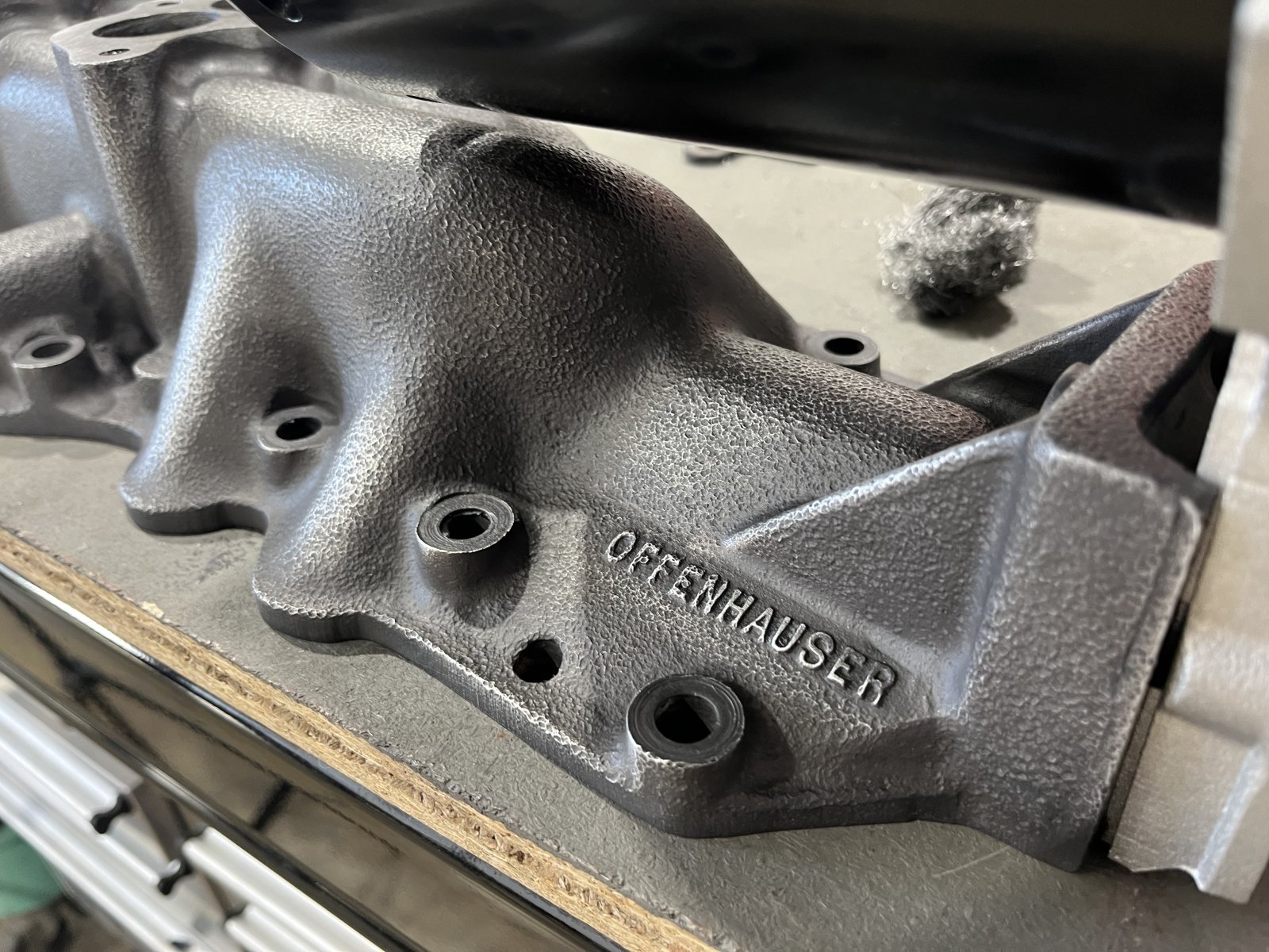

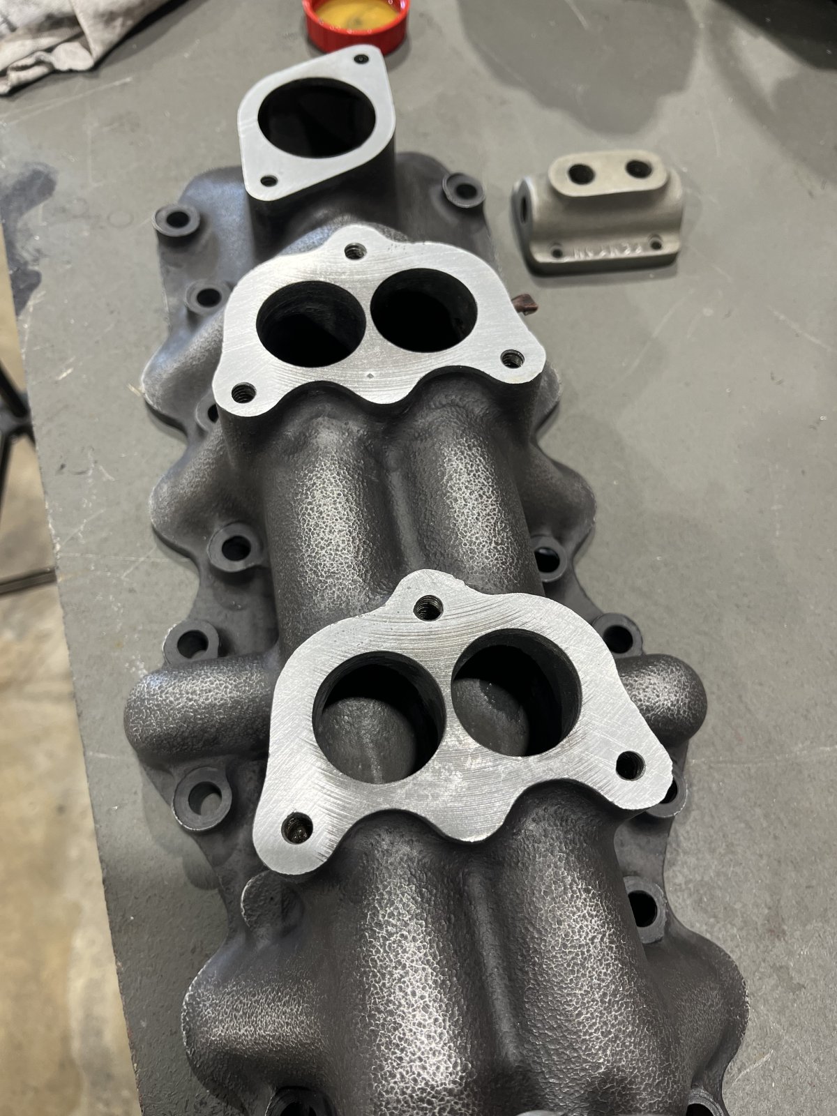

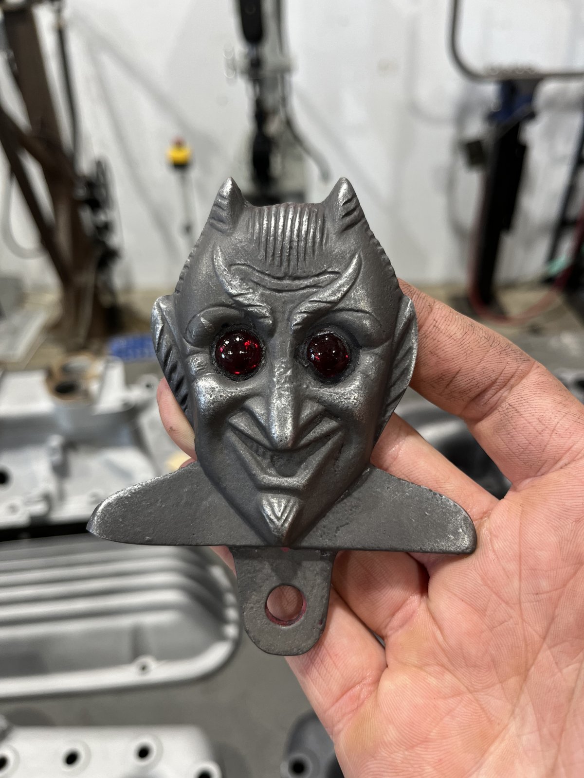

  24. Awaiting more parts to continue working on Mine and Ben’s roadsters- I started to experiment with ageing cast. I plan to run the motor block painted and have a nice contrast with some aged,
    almost magnesium looking heads and intake with lots of smaller chrome and nickel plated details.
    Below you can see I used a needle scaler to ‘texture’ the offy intake and then after a few treatments the result was really cool. I will explain more on this once all parts are completed and show you more before and after photos.

  27. Starting to really like this finish- got some cool ideas for the motor/ accessories

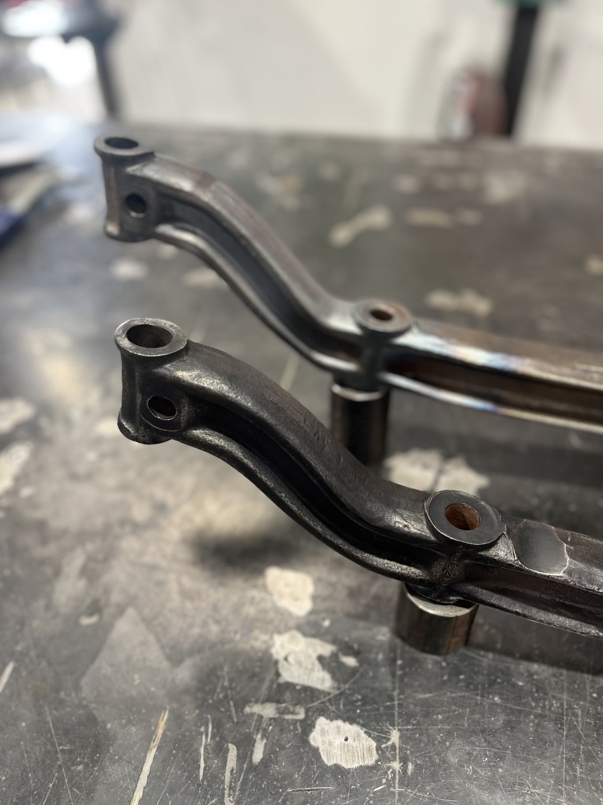

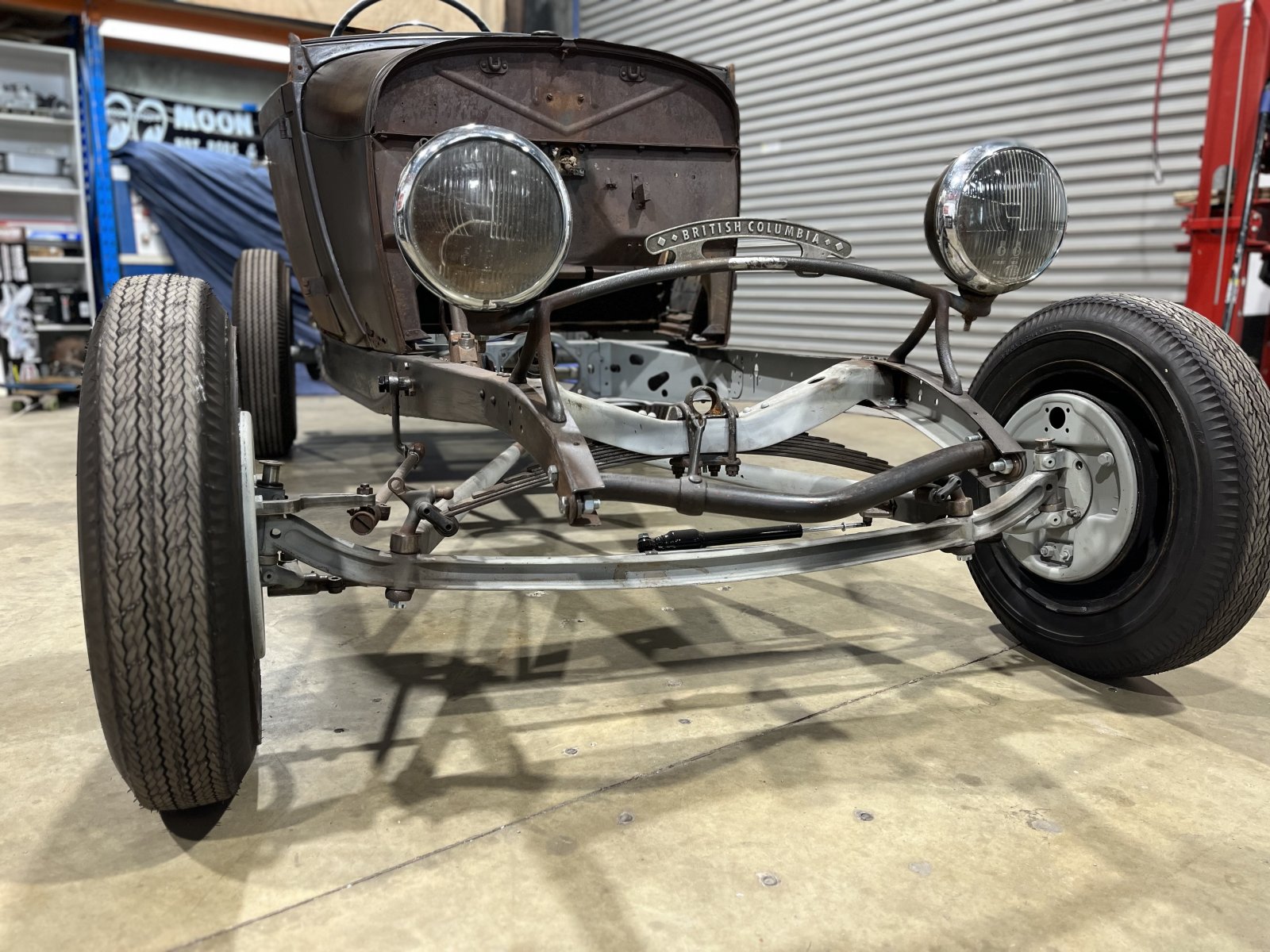

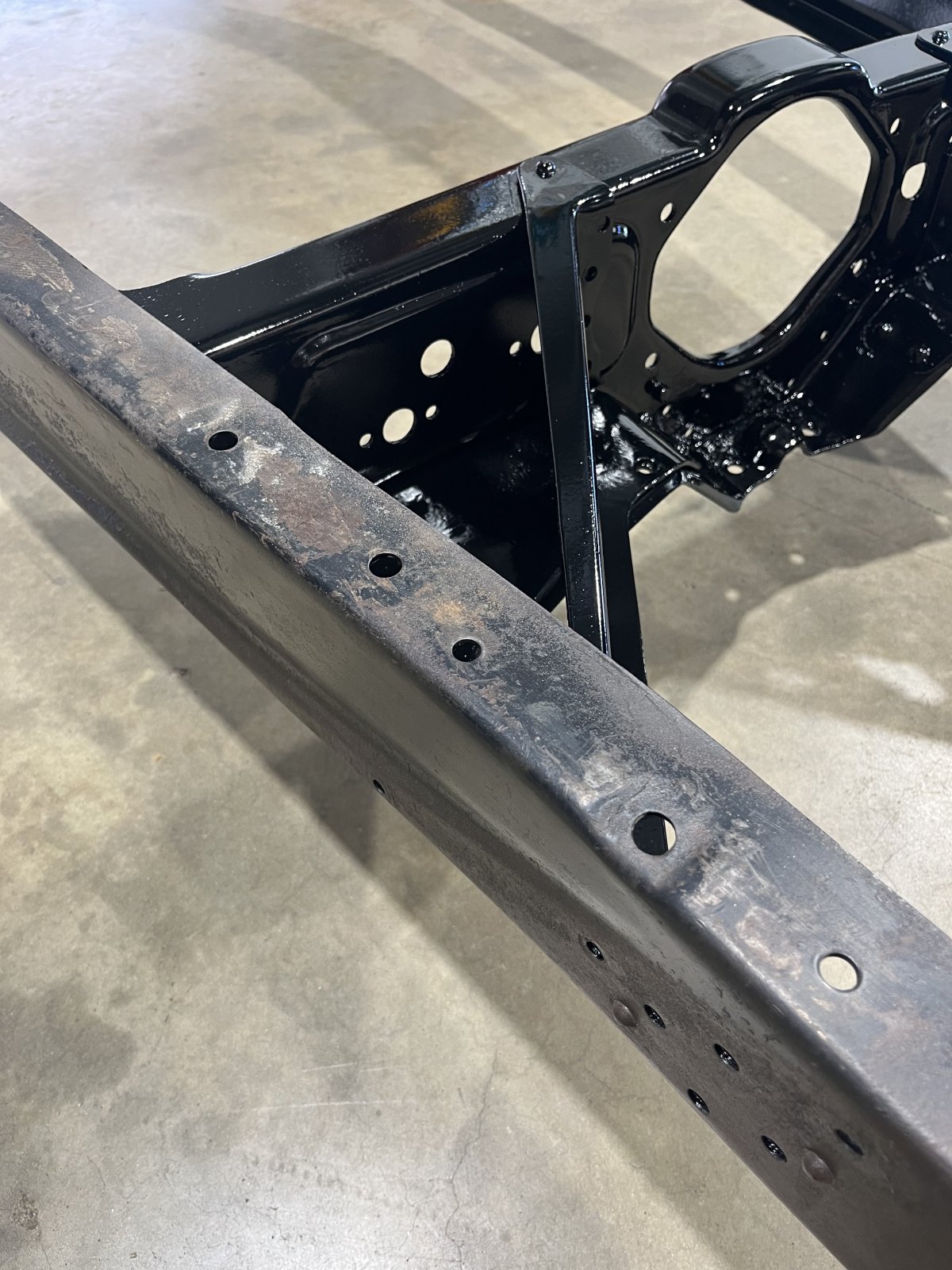

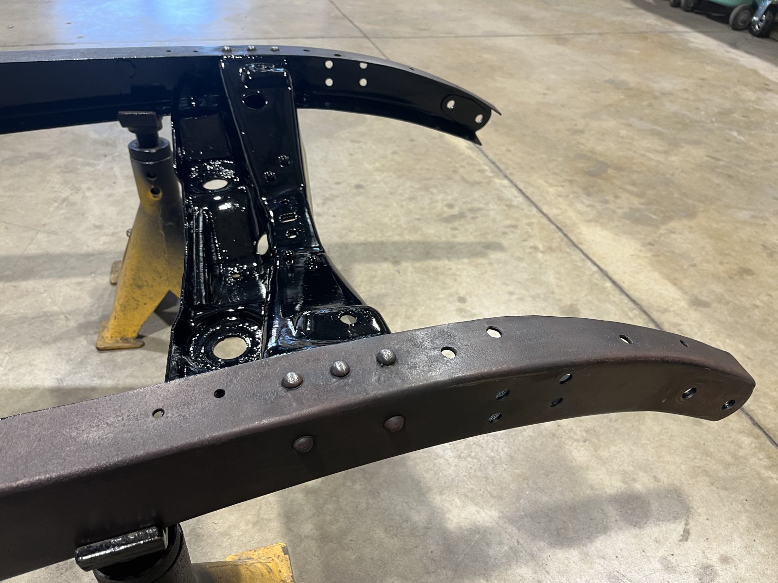

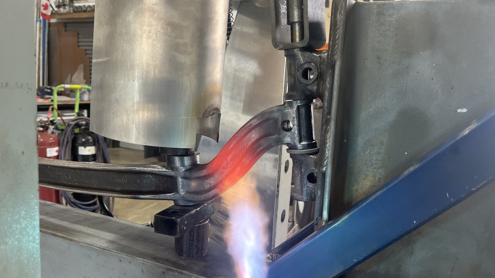

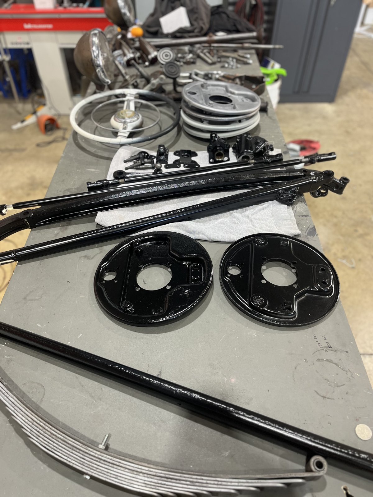

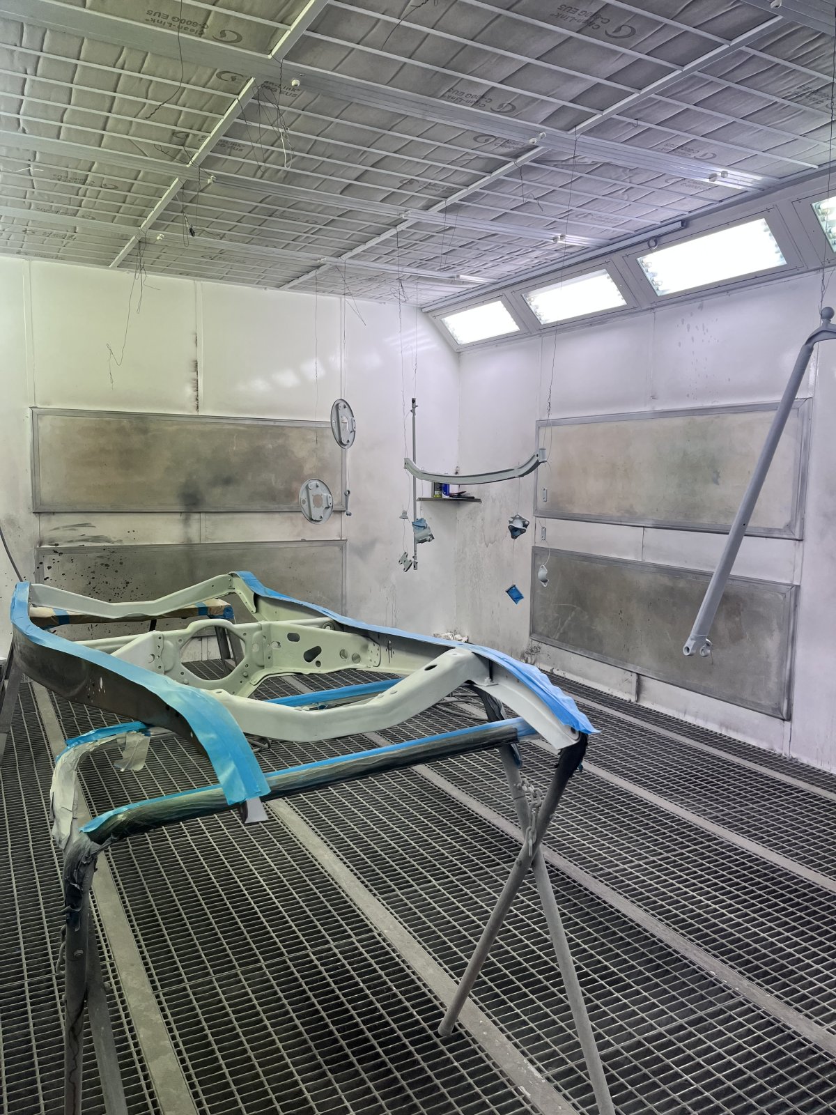

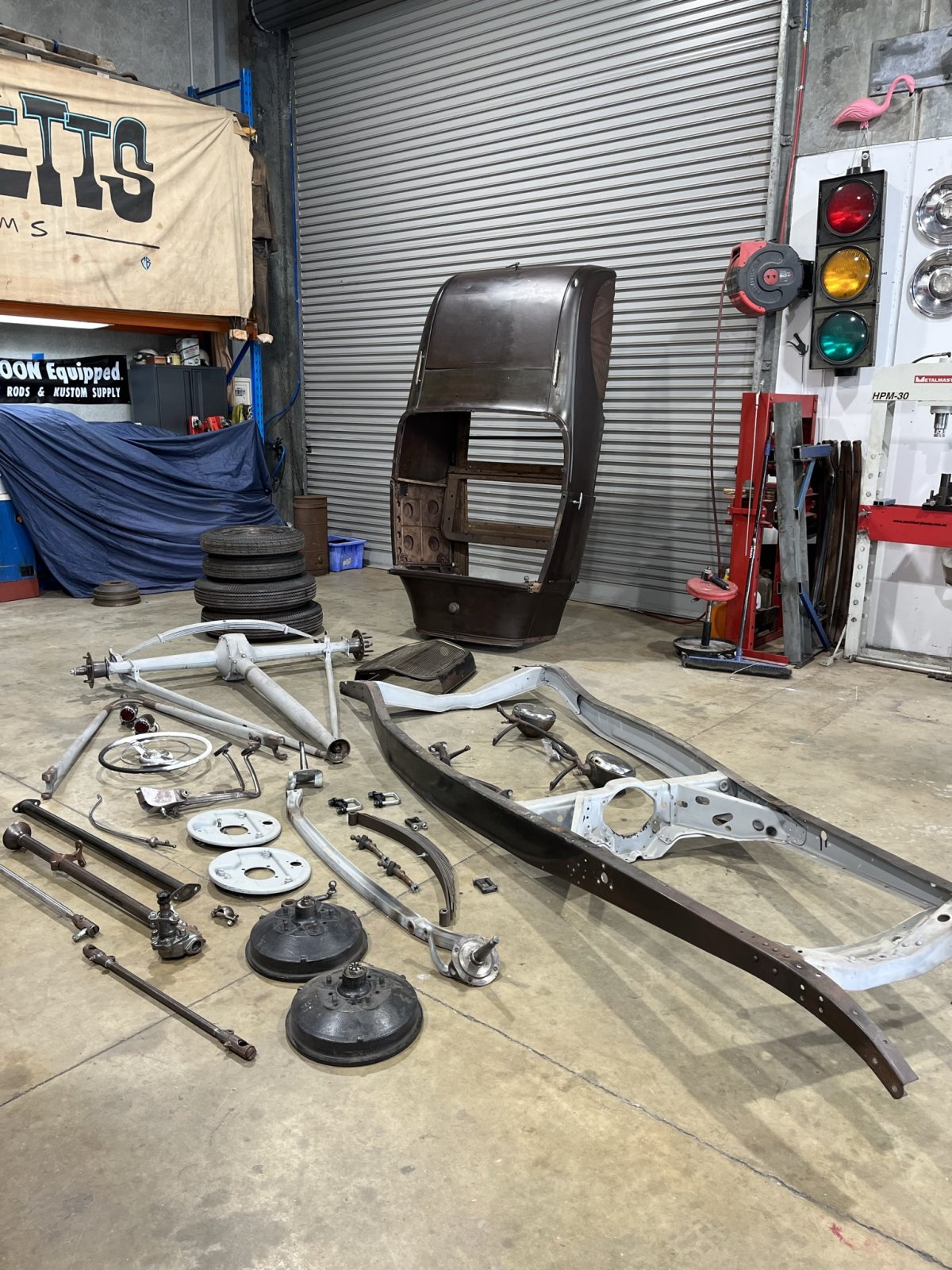

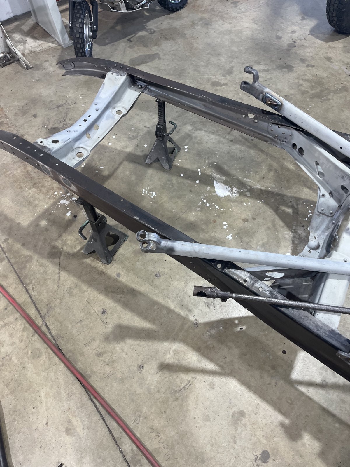

  30. Well the car has been side lined as usual to get other jobs done, it’s been a fun month of getting Ben’s roadster closer to driving.
    Made an axle drop jig and have been having a blast just dropping axles in my spare time- it’s a lot of fun and lots to learn.

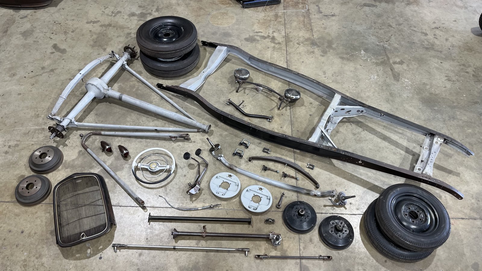

    As for the the roadster the motor it at the machine shop, getting some love. So I decided it was time to blow apart the chassis and start to prep and paint the majority of parts. I’m excited to start getting this back together. Lots more to come. B100AB0A-C9BD-4E62-923C-AEE5BFA44144.jpeg D353E1BB-8D83-49F2-9B5E-93A79279E091.jpeg 35B00843-5E8C-4313-B79A-CEE0FB9EC825.jpeg 68BF7F80-462A-4EDB-8F09-56401AF15B37.jpeg 9CAD7100-CAB4-4F93-AE64-BDAA9E4EAF22.jpeg BC02F55B-1436-4D74-9AA9-CF49D0E9B116.jpeg BBA8E74A-3CC3-45C0-B3BB-E72ABAEC736E.jpeg 427F876C-E0BD-4559-98AD-7D3450E30C38.jpeg C98679EE-E05B-449C-AAE1-DBC8B52C08DB.jpeg 3ACFED21-8263-433F-B0DD-2EB468D820E8.jpeg 7117A5EA-B5C0-44BB-832C-40DC9C2CDC8F.jpeg D33F694A-64D3-48DC-99EF-69A2012AAAB7.jpeg 0EE9B660-E042-4D5A-9EEB-7E8DEF4F32F6.jpeg 8B9A2843-BE00-4F6B-8F95-3BD58260FAF4.jpeg 1239C07C-45D8-4581-885B-ED60B0C15479.jpeg E7A0A4B8-87C8-4AF0-A648-4CCAFFC949A7.jpeg 4CB91D48-3BB9-404D-AC4A-5C24867BA33B.jpeg B7195509-CA8C-4A2C-AA3F-7868335E217F.jpeg 071EB467-959A-4D3D-A06B-0B4FA006EDDF.jpeg 95E2EFD5-B775-4AE8-822B-948C96D6200C.jpeg
