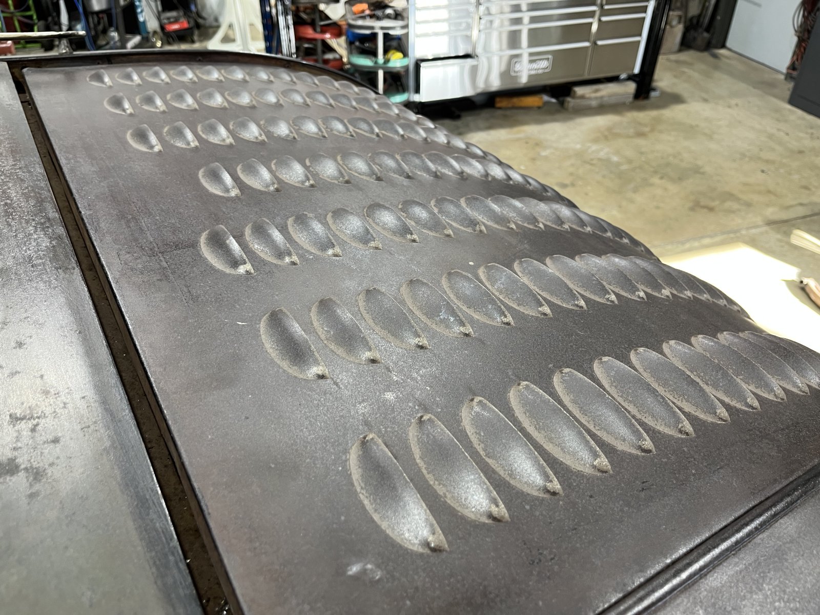

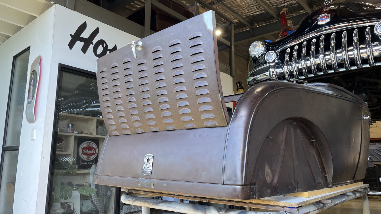

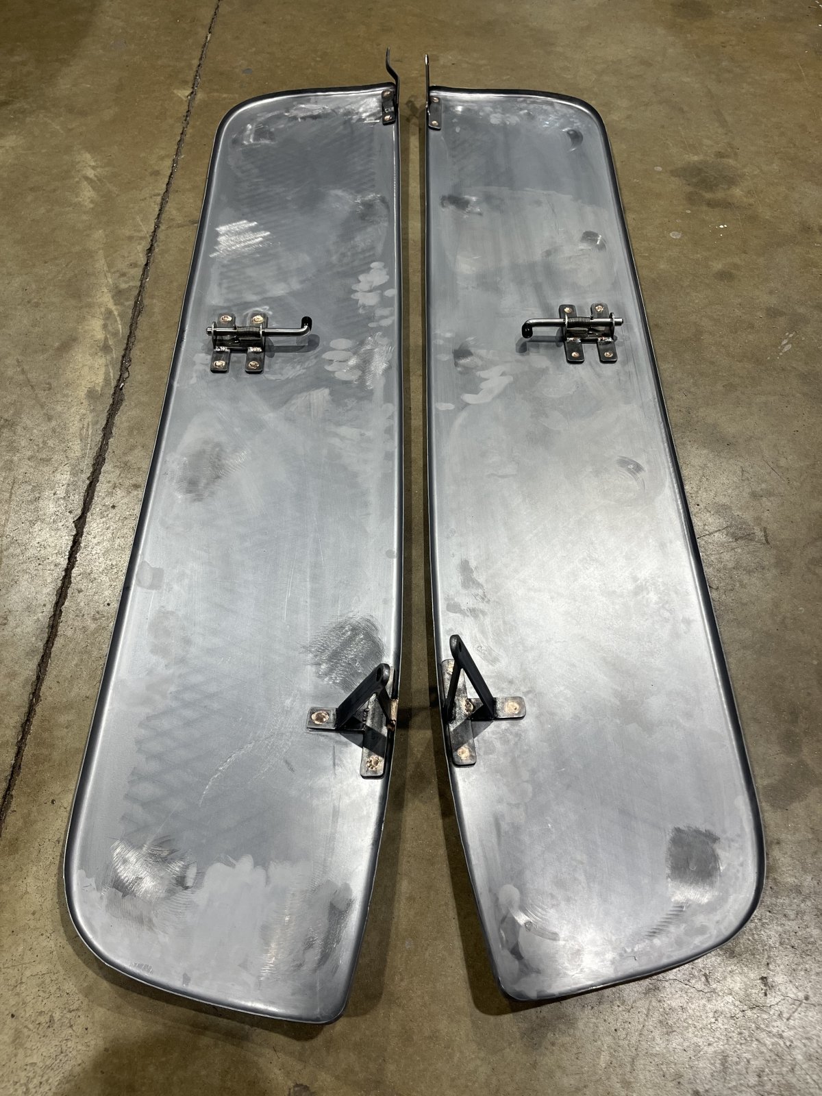

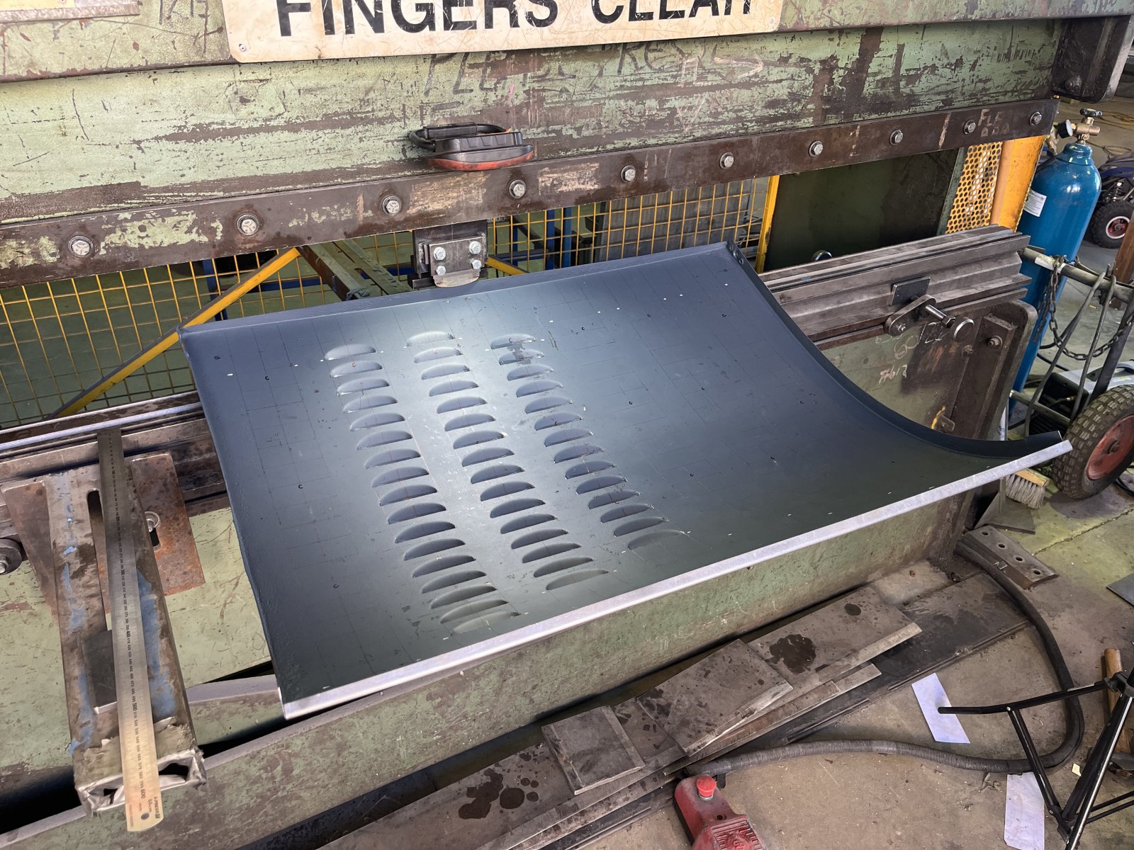

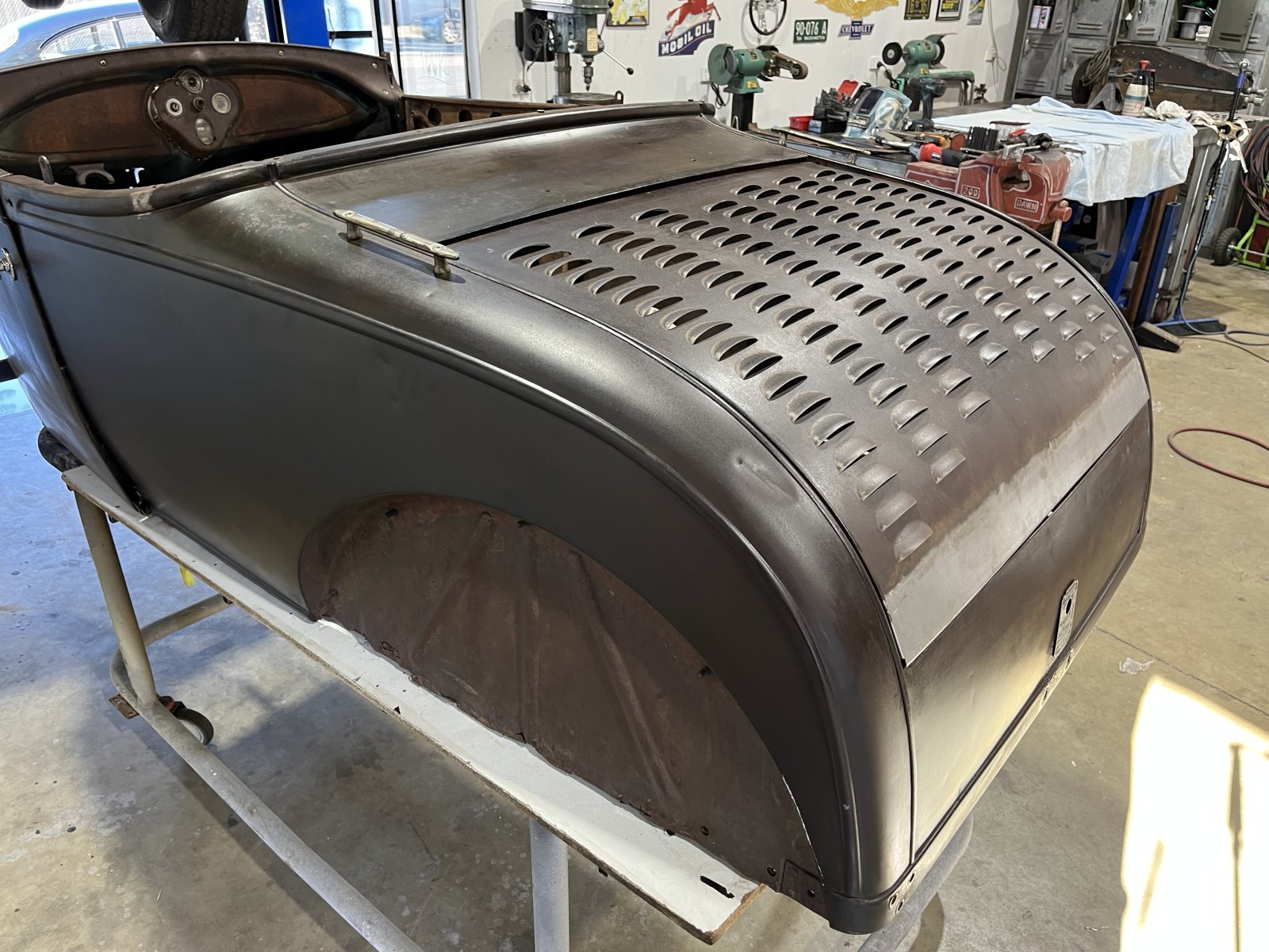

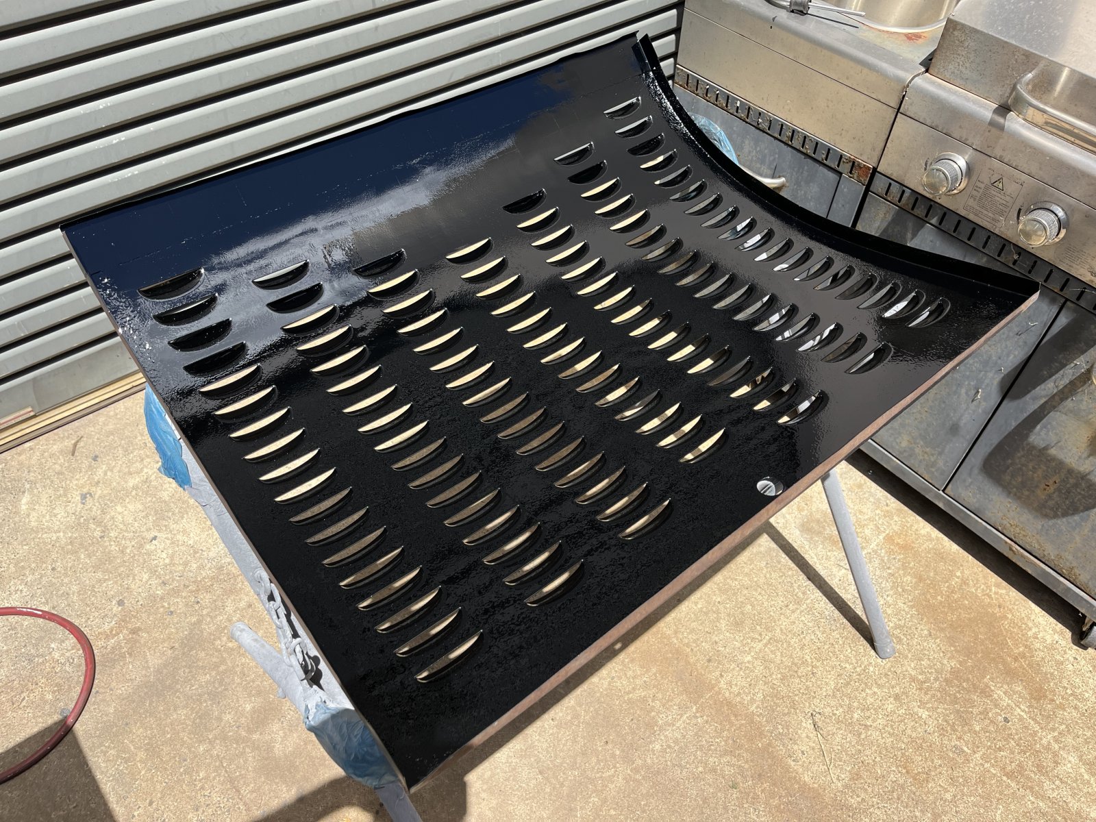

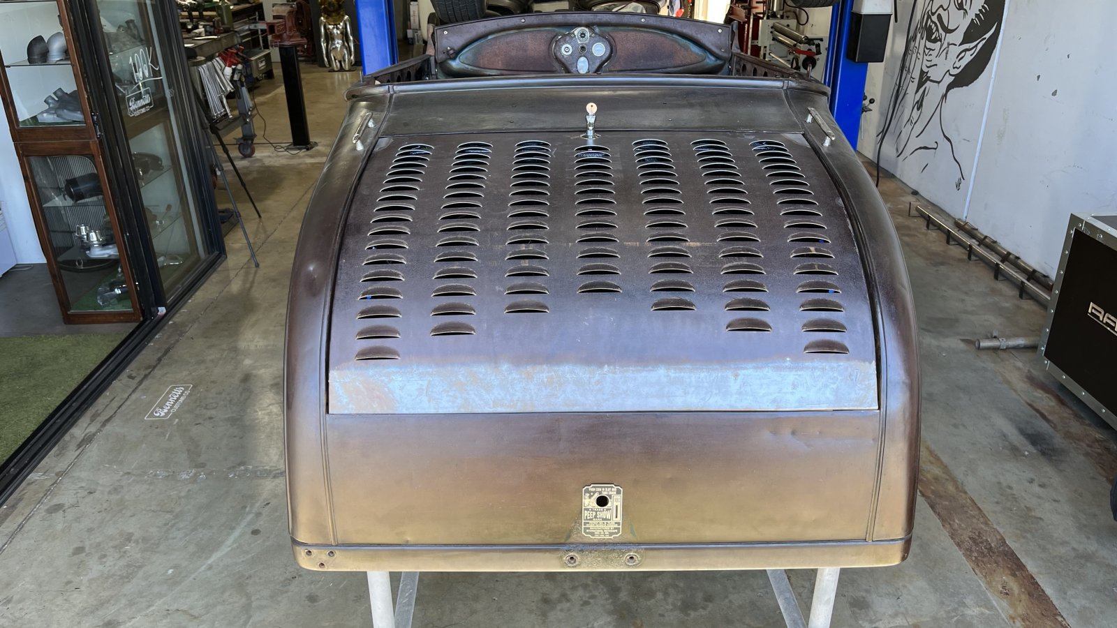

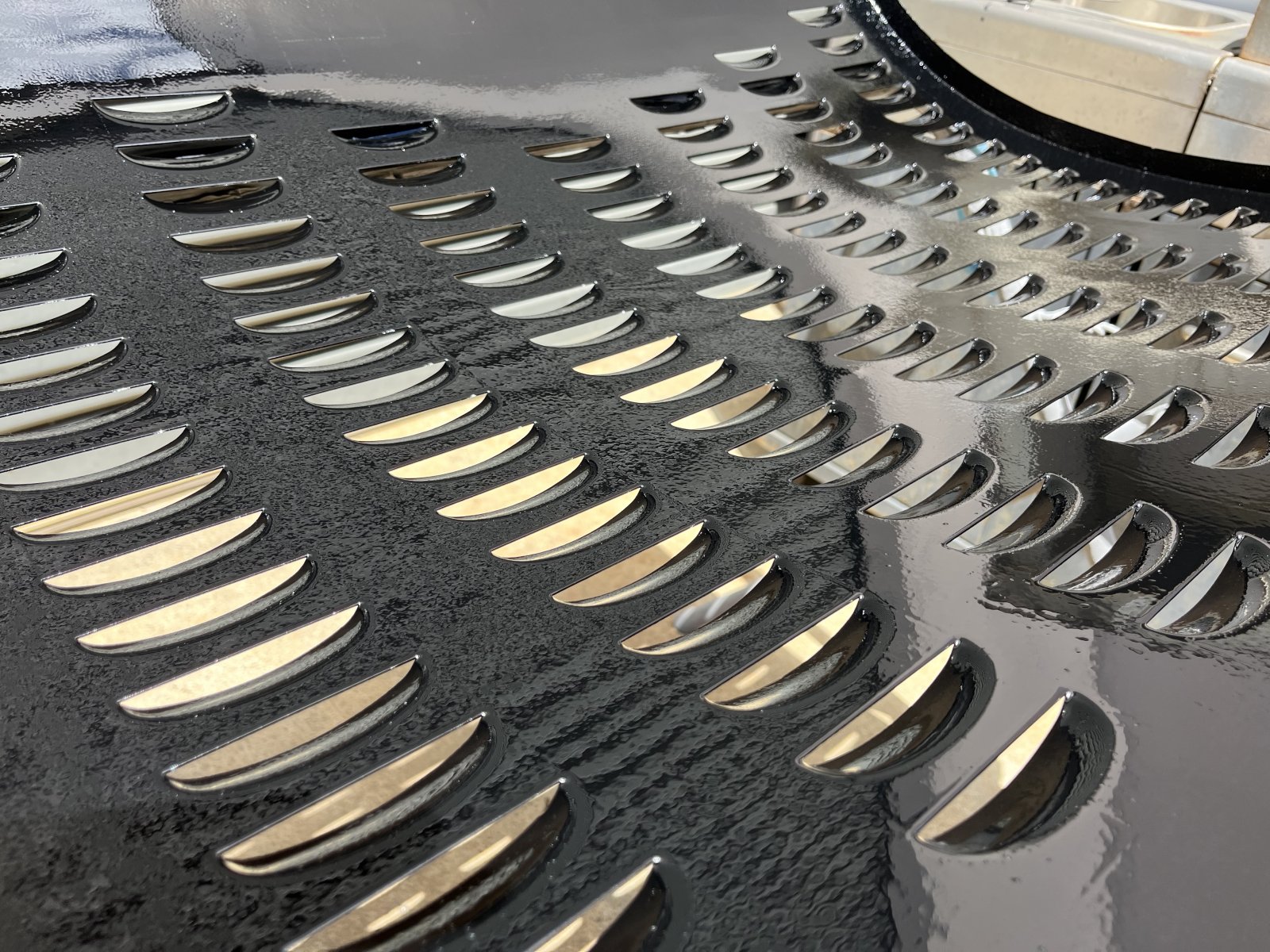

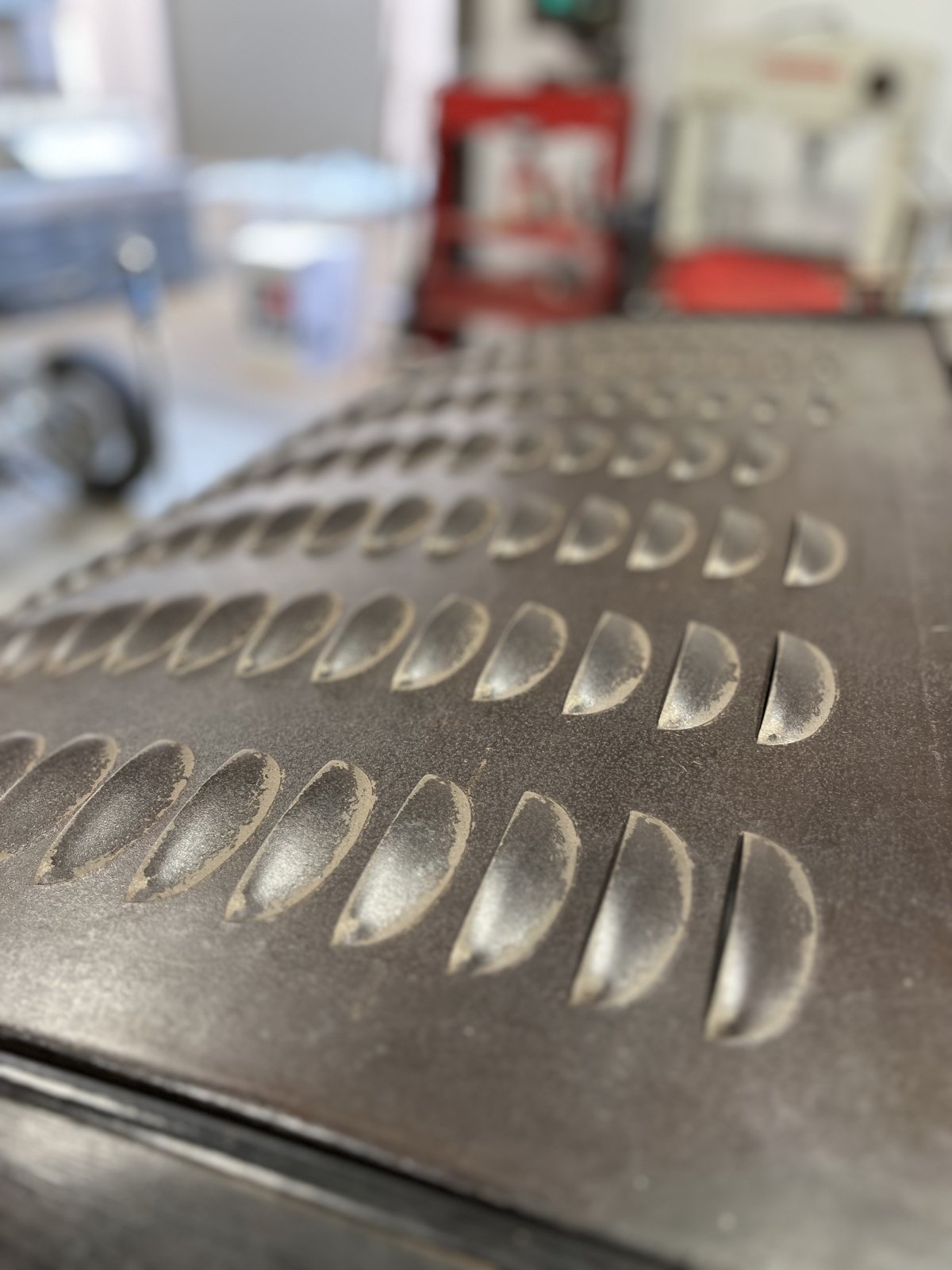

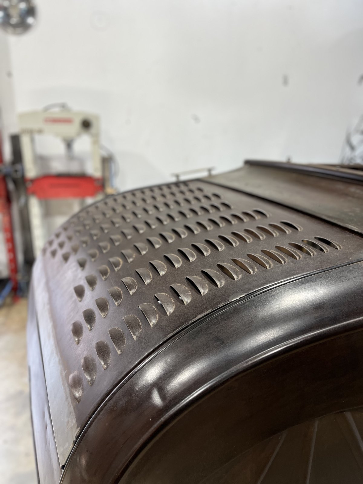

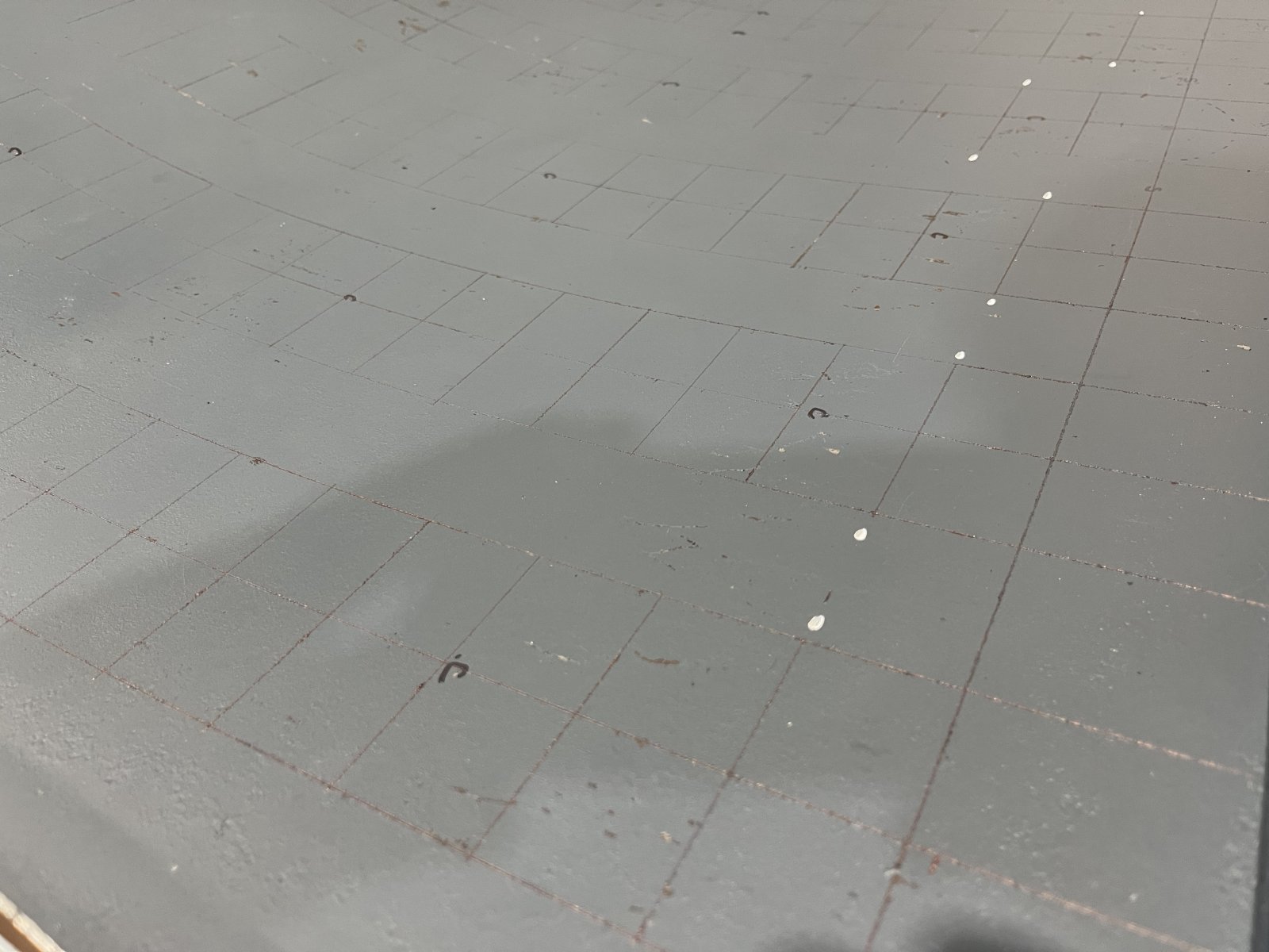

  2. Well a bit the bullet and punched 116 louvers. Definitely happy with the result they almost look like worn leather. A modified the press attachment to work 90 degrees letting the curve of the panel fit perfectly. More to come. F79E4F28-E59E-4B87-B9C1-9C0F58304681.jpeg 923638BE-F2A4-4B38-ABF5-8E8F3F1D58CC.jpeg 365B6EC5-E1FD-449D-9326-AEBD997739BE.jpeg 1042CB90-3028-4A31-8239-EA6A20D3D8B9.jpeg FEC22F0F-5E6D-4D19-B43F-FD1032893A00.jpeg DA02F303-92C7-4886-84BA-648C983FE973.jpeg 57523F53-7E52-41E6-BEEC-5E9374E09C3D.jpeg 56582226-10C4-4990-9B65-4F17BEAF1604.jpeg AA95EE1D-1B15-4F04-9E4C-A8AE83BD6E1A.jpeg

  3. 05snopro440

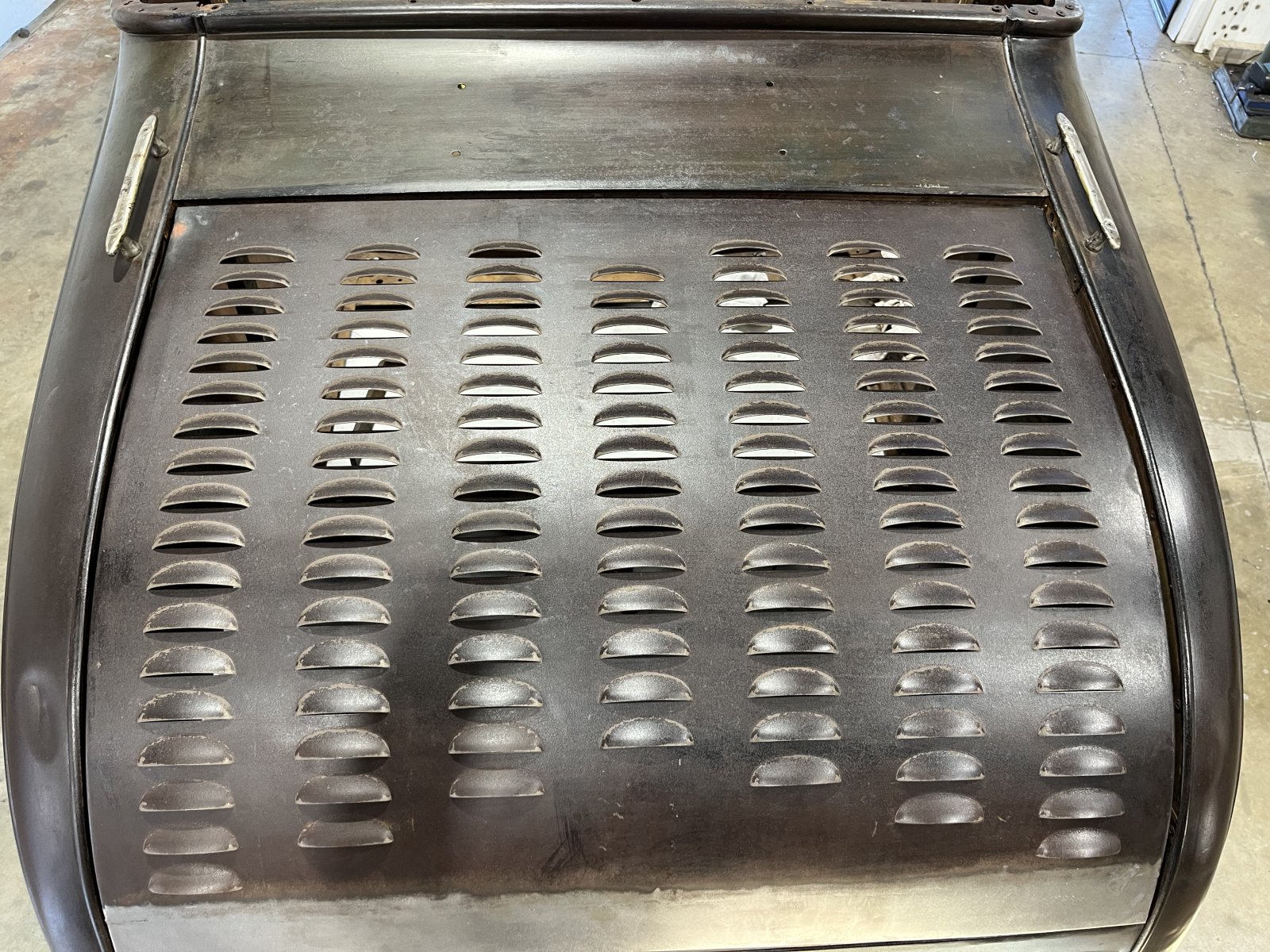

    Joined: Mar 15, 2011
    Posts: 3,003
    05snopro440
    Should be good for about 10 cool points per louver. ;)

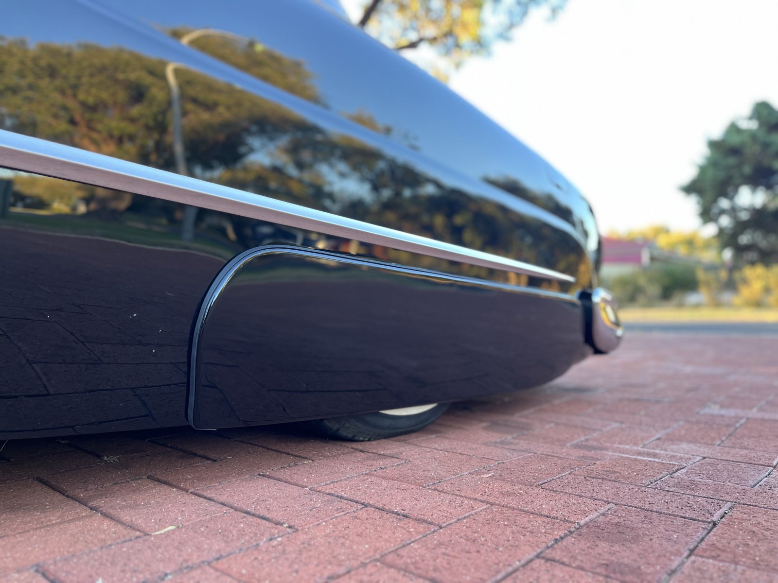

    Posts: 3,670
    GearheadsQCE

    I was thinking that you shouldn't louver it, but then you show it all done and it looks great!
    Leaving the surface alone makes it fit the style perfectly.
    Stogy likes this.

    That’s a great texture

  6. Was definitely thinking the same and then it hit me. If I don’t do it I’ll never know what it looked like. Luckily I like it so it will stay until further notice.. could be sooner than later haha

    I think today that apprehension is more prevalent...back then there were shiloads of trunk lids...must have been as so many old A bones found are missing them...

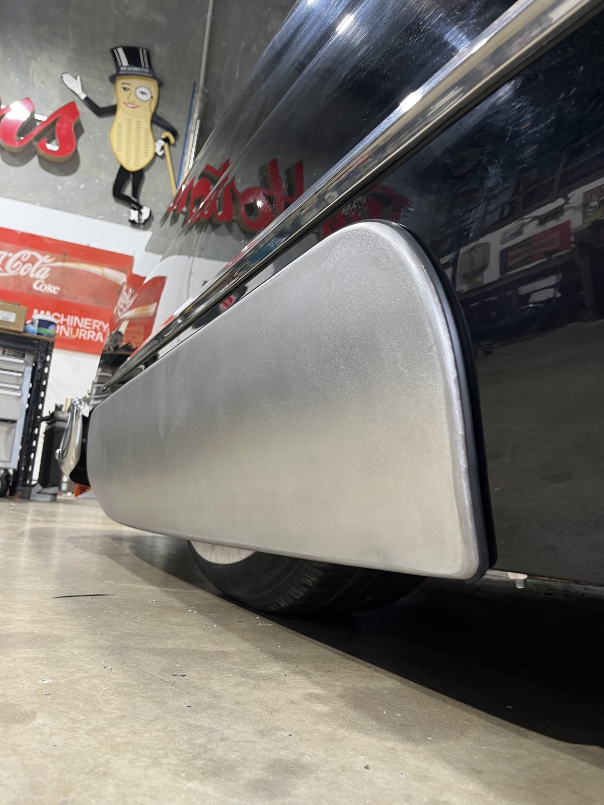

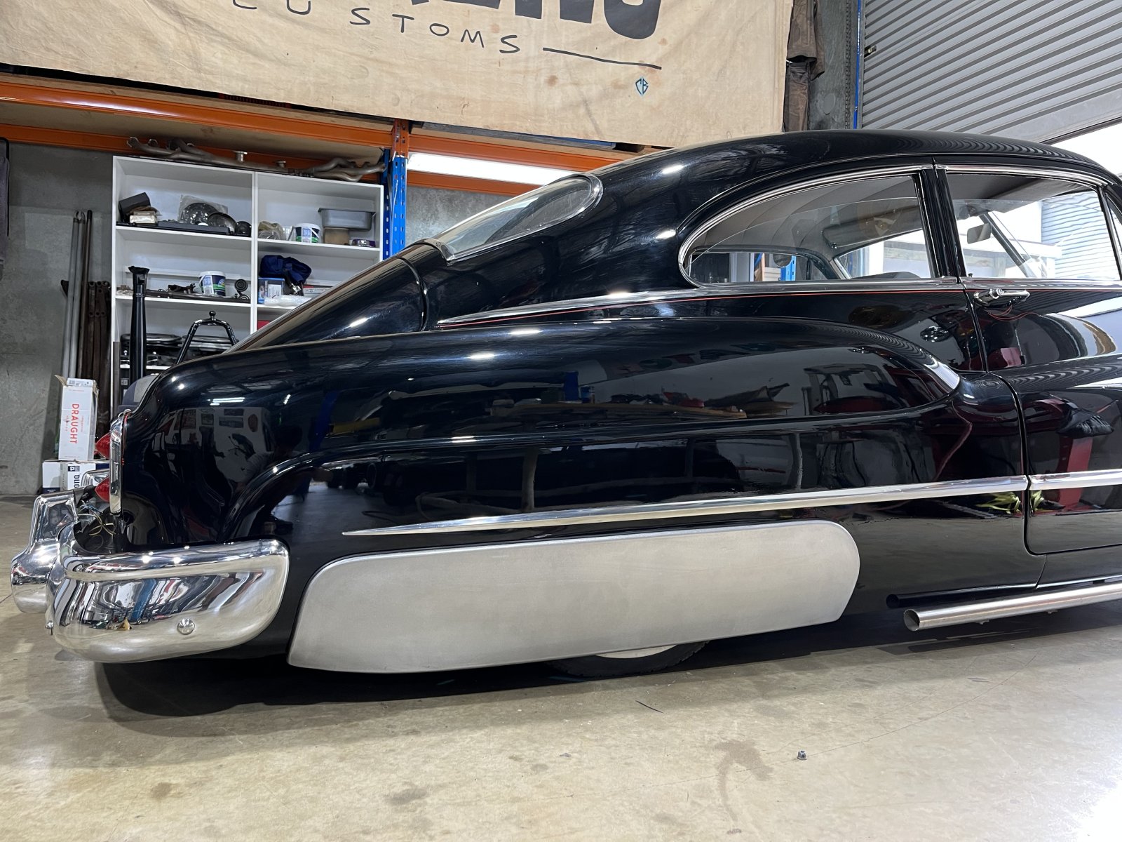

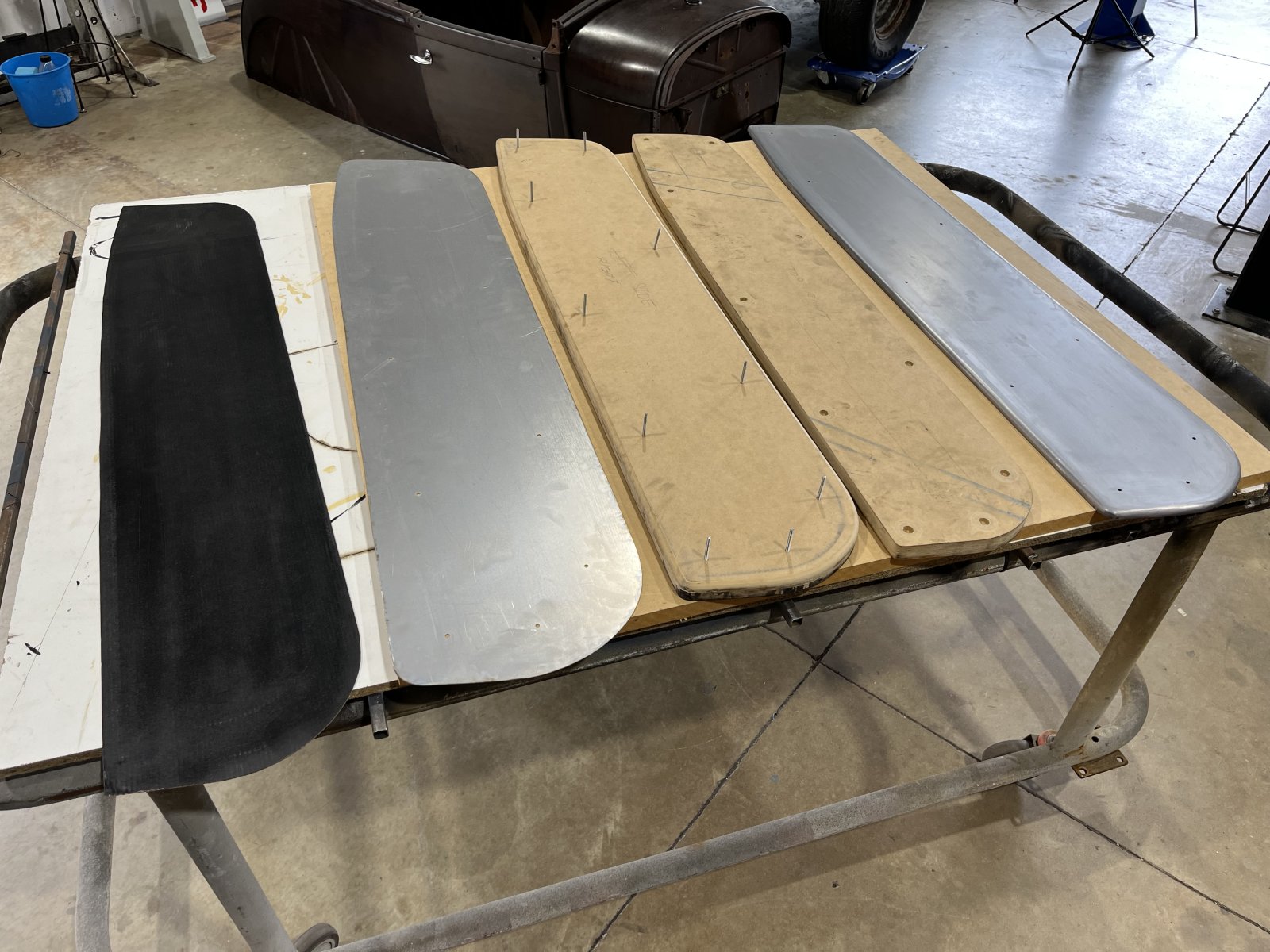

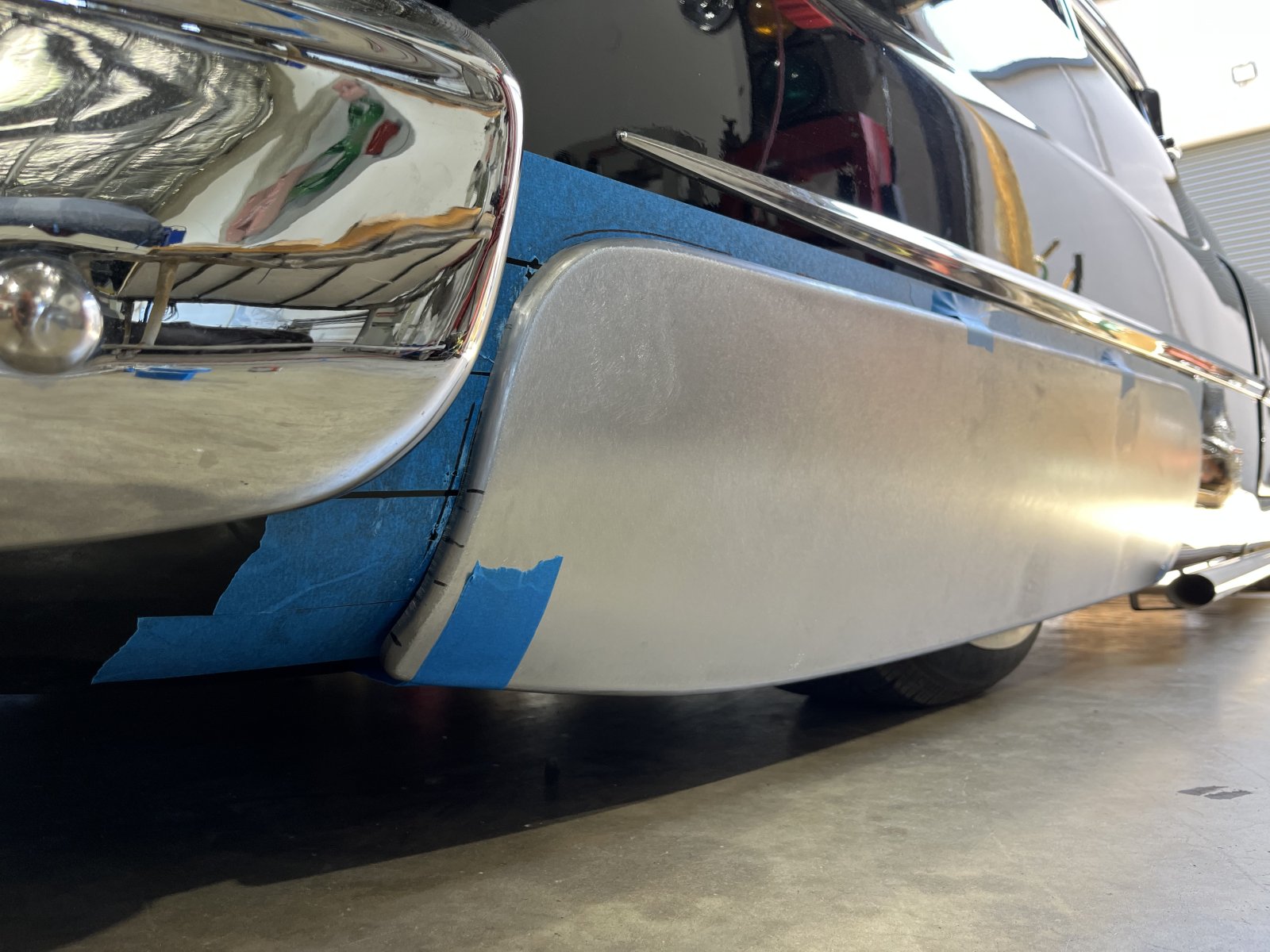

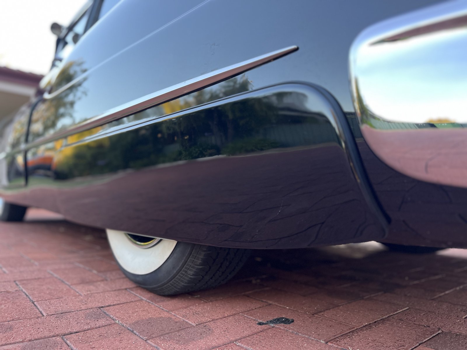

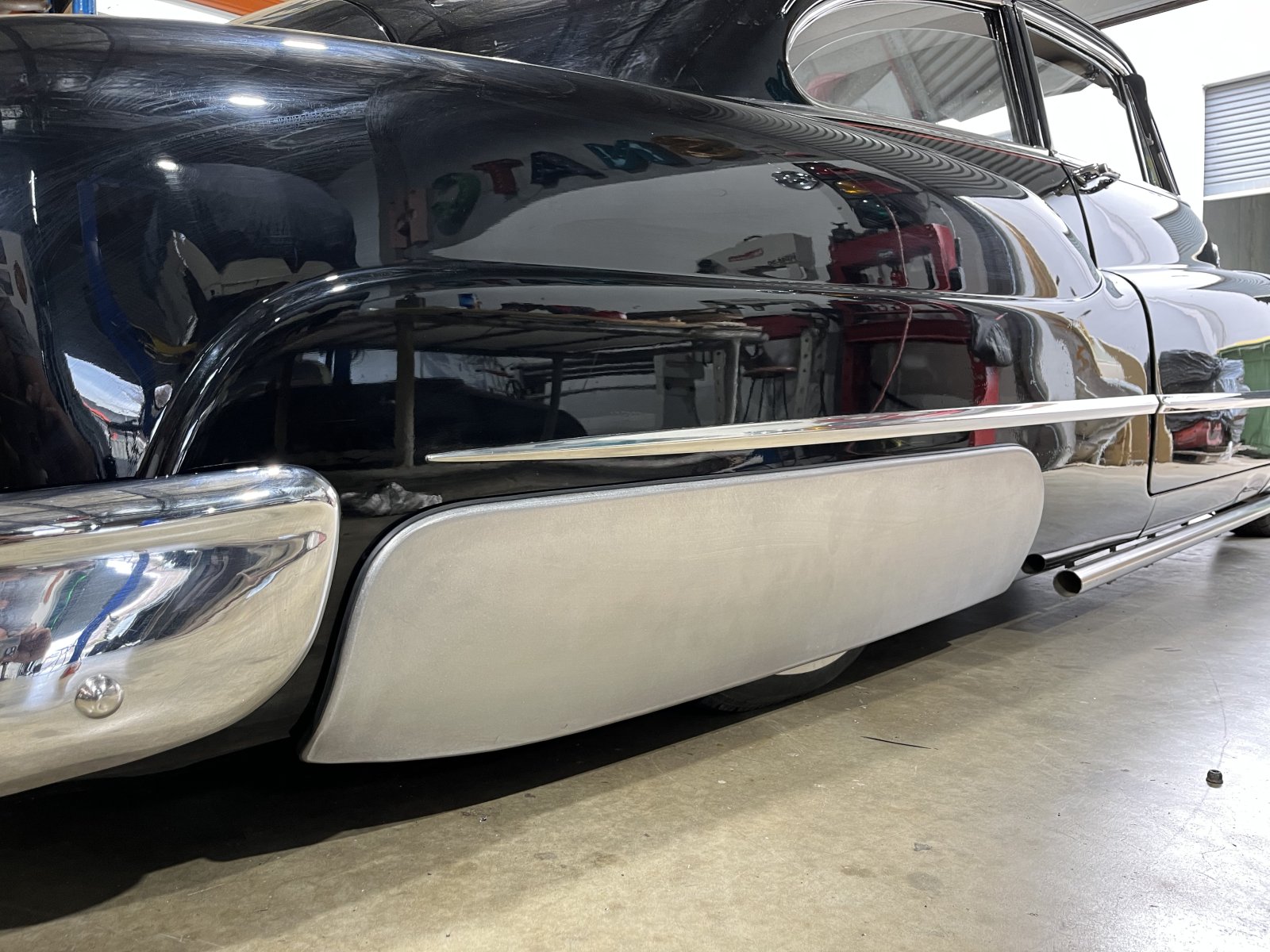

  9. While waiting for a few parts to arrive I started to hammer form a set of cruiser skirts for a mates ‘50 Buick.lots of wheeling on the English wheel. One sides latched in. Paint and new seals next. A577F460-DCB2-4C26-8347-98935B1E151D.jpeg C2E0EC81-86ED-4657-B260-70C3B6F0656E.jpeg CD0C9A96-BA79-4897-B441-5A9EEB9ABAB3.jpeg 673940E7-F1A9-4693-A5E4-B5849B49438C.jpeg 96211806-5BB4-45DE-A0CA-B0A9898D1994.jpeg AF603889-776A-4185-9FD5-8CA80C30C1EF.jpeg 44790A71-545C-4DBB-927B-F2A66DB8A057.jpeg

    Slick work with those skirts! Do you have to work the corners/edges in a certain pattern to get them to round over the edge(s) of the form without too much crinkling and bunching?
    Stogy likes this.
  11. I found about a half inch worked best. Anything more for the right radious had too much material.

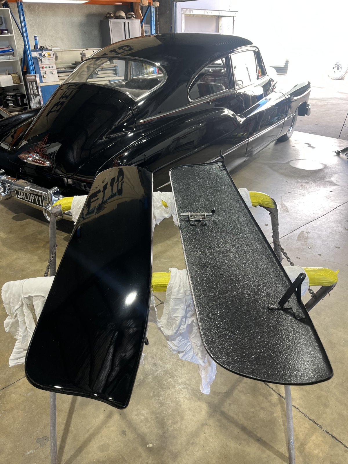

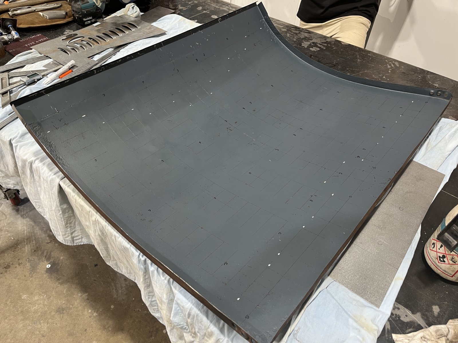

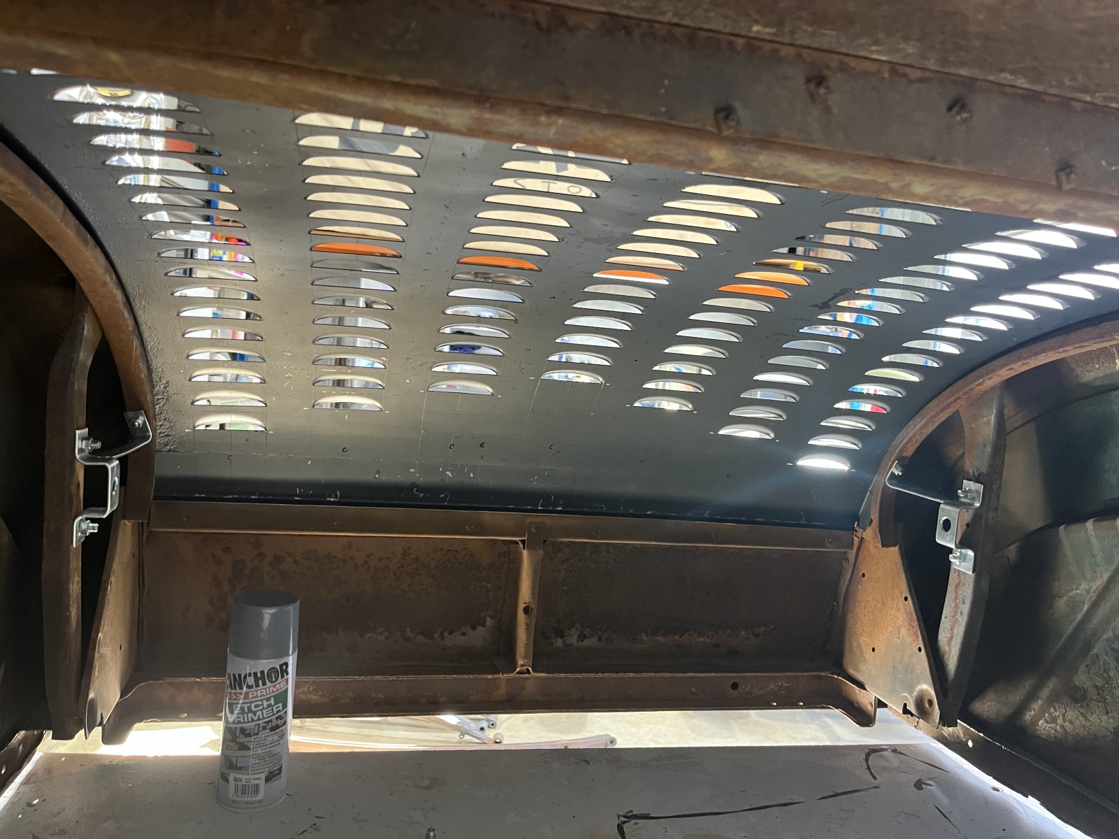

  12. Mocked up the skins today. Prior to painting them. I repair both top corners too where the original holes were to pivot on for the trunk hinge. I cleaned primed and painted the insides and will mate these tomrrow with our new latch and handle. Luckily the louvers didn’t hinder the opening and didn’t make contact to the lower trunk panel while opening. Now we can squeeze six blokes’ haha 9A6048E5-FBD7-4B23-8D02-6FB26A0BD49C.jpeg 9092D507-8F08-471B-91FC-DD7BCEA35210.jpeg CFB7970B-8CA3-4F82-AE7E-38BF71058563.jpeg 8513CE26-5149-406E-9088-3877F78A03C9.jpeg C6736C24-8E28-46DC-8436-A5F5F32B751A.jpeg
    Okie Pete, brEad, Joe Blow and 5 others like this.

    I really like the shapes in those louvers. Did you make the dies?
    Stogy likes this.
  14. They are staple ones I purchased from princess auto in (Canada) but I reshaped both the base and the male bit to replicate the early clam shell style.
    Okie Pete, hfh, Speedy Canuck and 2 others like this.

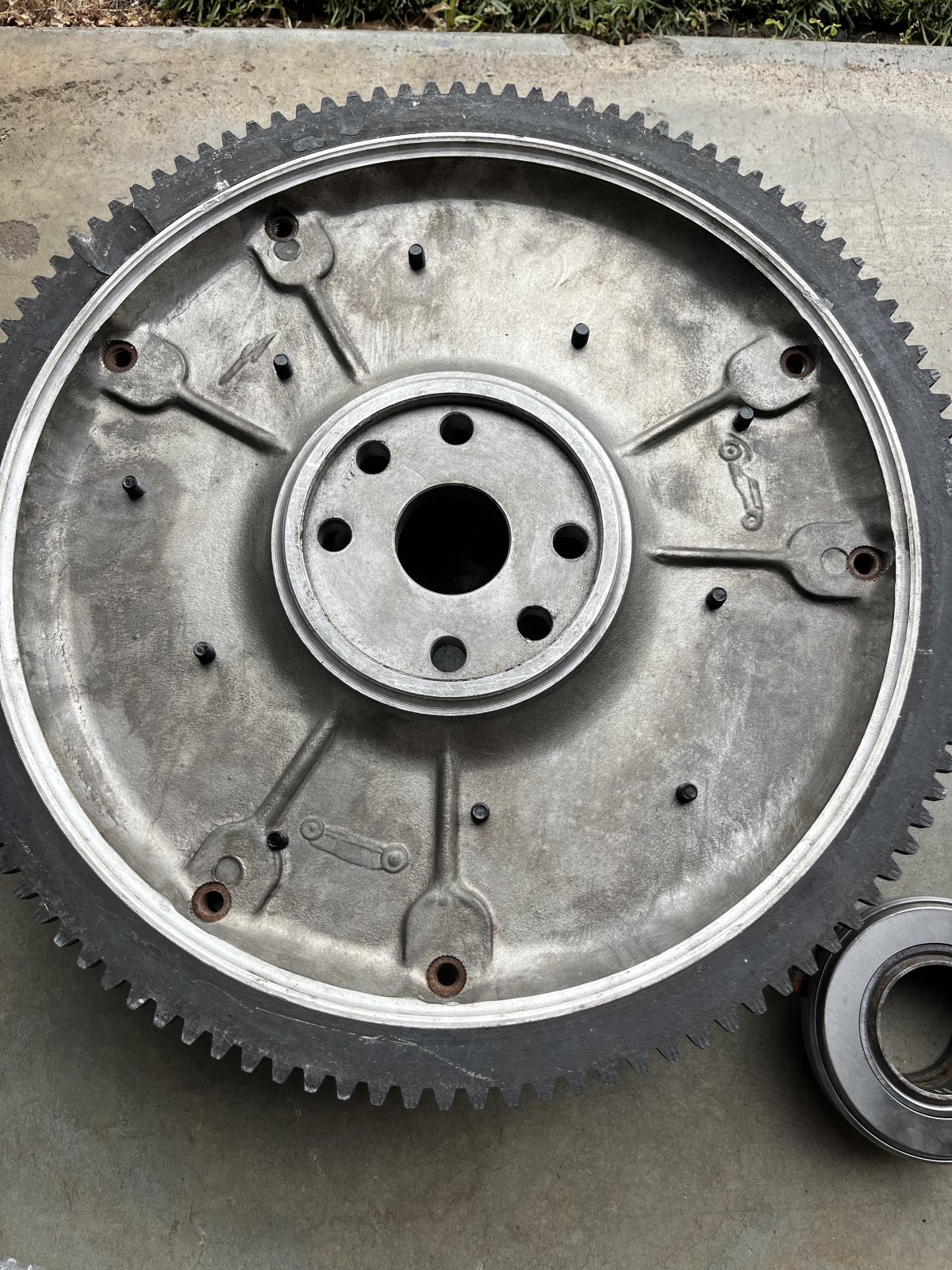

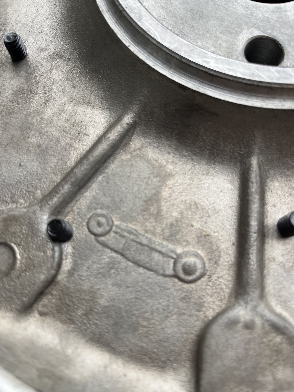

  16. Another piece of the puzzle checked- my mate Phil machined a steel insert for the NOS Edelbrock aluminum flywheel, clutch was faced and adjusted to suit. EC362EE0-D73F-471F-AA39-D6653F4A70F1.jpeg 3E0B1750-1BC7-4087-B864-368D2B2A470E.jpeg AED05D67-0791-4CB6-9269-3FF9838A889A.jpeg
    Stogy, JalopyJimbo, Okie Pete and 5 others like this.

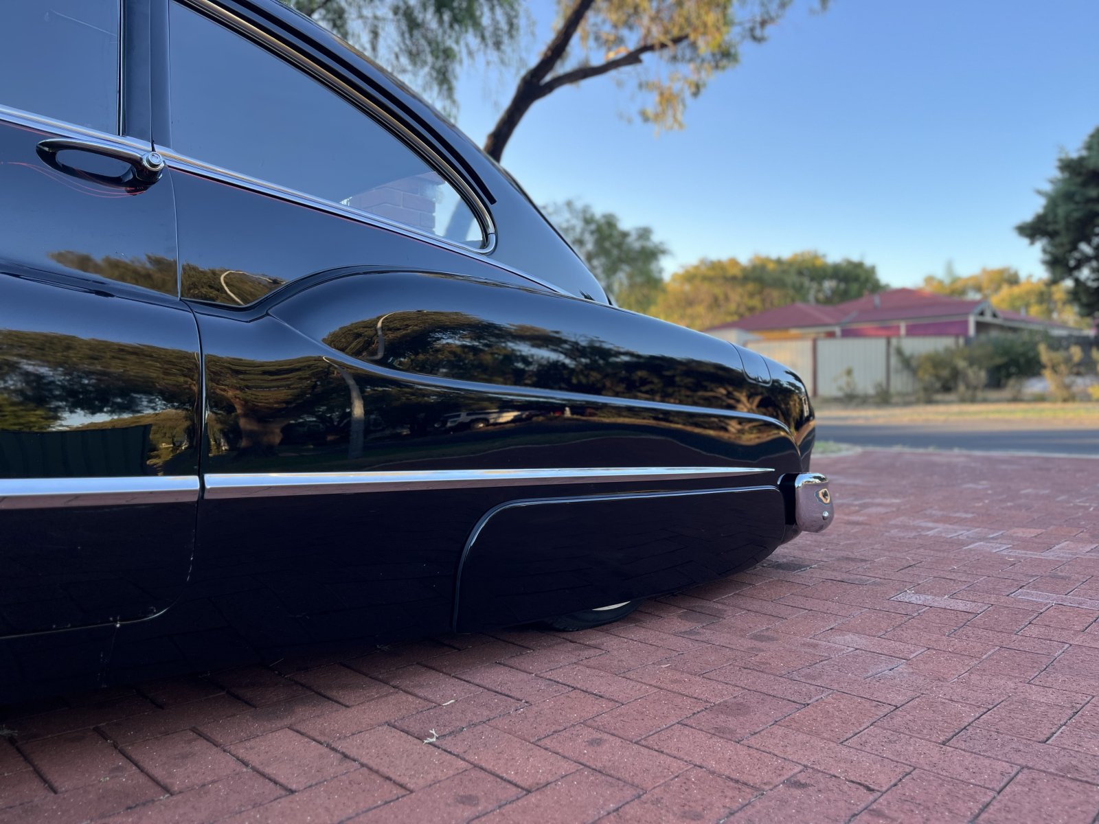

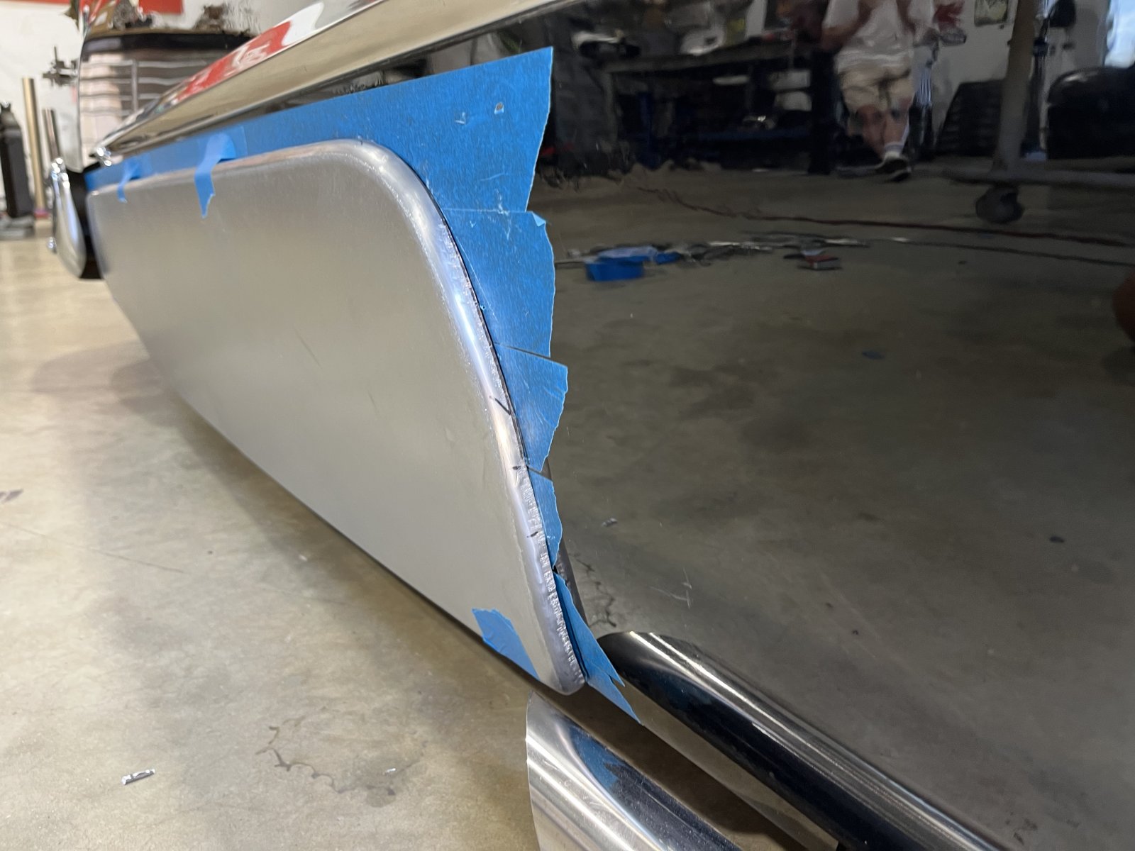

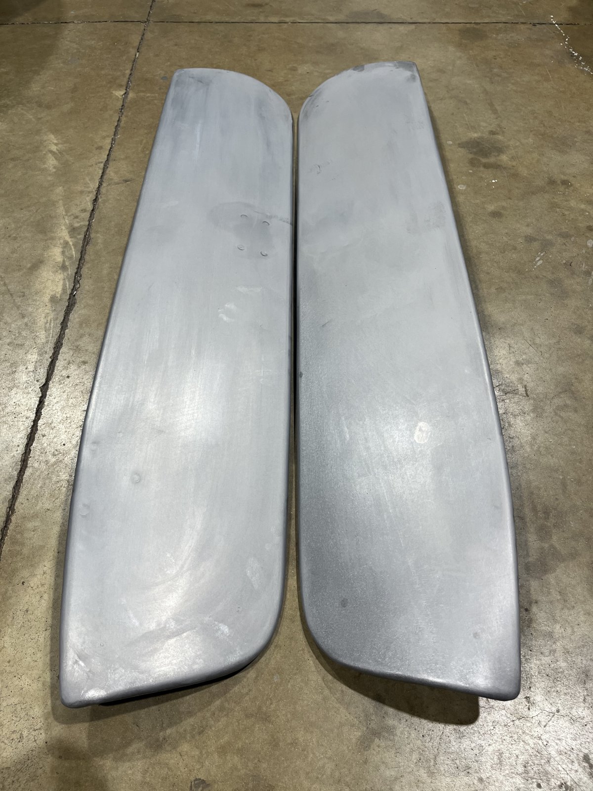

  18. Need to get back on the roadster. But had fun hammer forming these cruiser skirts for a good mate. Surprisingly for how simple and flat they look they have a lot of shape. F5096F3A-9A64-44A4-8031-2026DCA1A718.jpeg 755A8D98-5022-493C-B67D-89F9A20AE8AC.jpeg 644836FE-D4C9-483A-943D-C9B2D065B197.jpeg 0309B990-7341-4DA1-B67A-E4A2508CE32A.jpeg B226E748-2222-416E-9F92-C688889EDB48.jpeg FA631154-BC86-4870-AC3A-702596B1031A.jpeg 7112A561-54B8-4A73-9FB1-0072D74A79F1.jpeg

    Running out of superlatives for your work.;) Those skirts are killer.

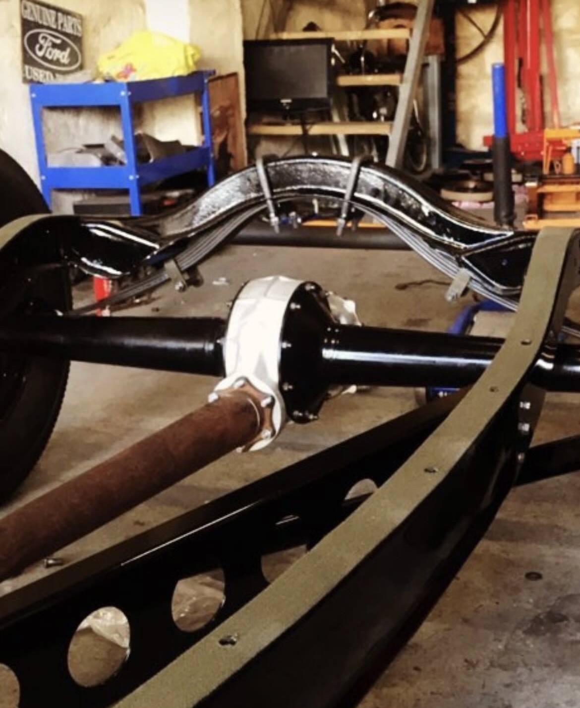

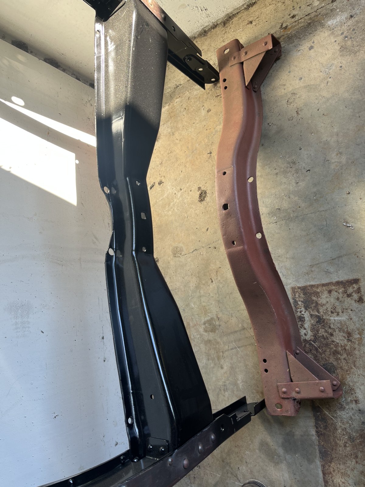

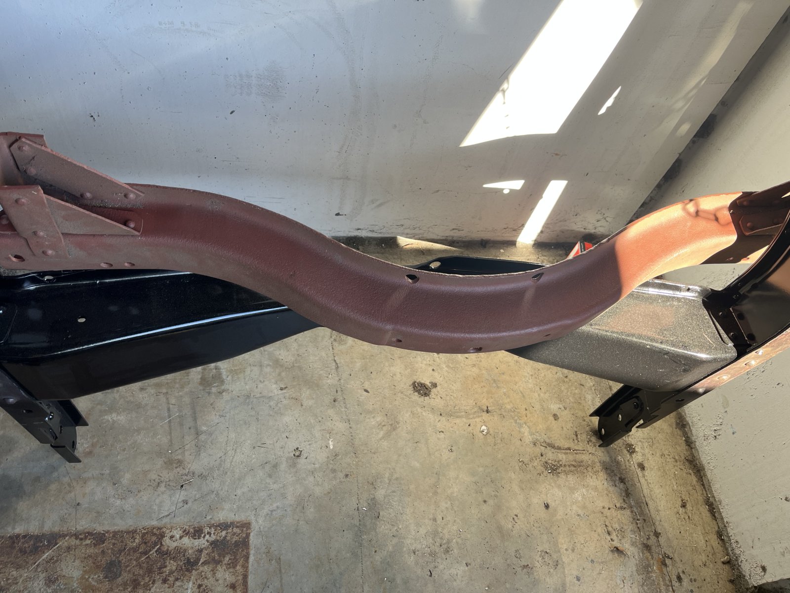

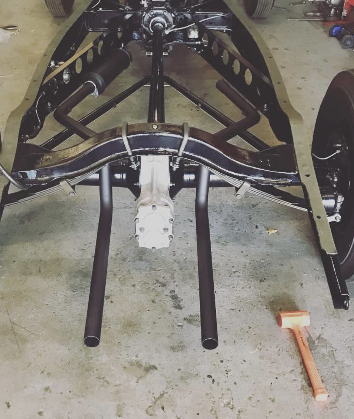

  21. Last shot of the Buick for a little while. Time to get the 32 frame back in the jig to graph in our model a rear crossmember. I plan to leave the 32 rear crossmember and blend in the model a. I spent a lot of time of those hammer formed boxing plates to cut them out, below is an example of a mate he did many moons ago. If you have any photos similar it would be greatly appreciated.
    DAD03B4B-B9A1-4D21-88A4-B6EEF301E2D6.jpeg E07C56A9-B8A1-4F43-A5AE-3AC170415480.jpeg 355C874D-E1E1-438F-AE24-11D5B954E5C9.jpeg F70124A3-E666-442F-A2E4-6343938AD36F.jpeg 196829DD-9EEB-47C3-933C-87E8A76FA705.jpeg
    BigJoeArt, Stogy, Okie Pete and 10 others like this.

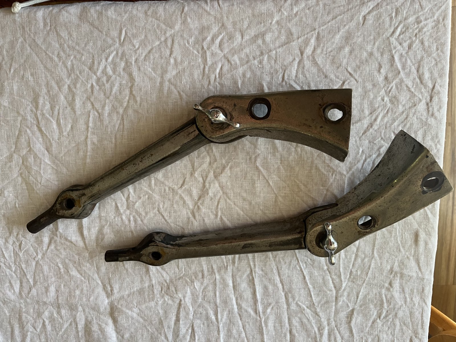

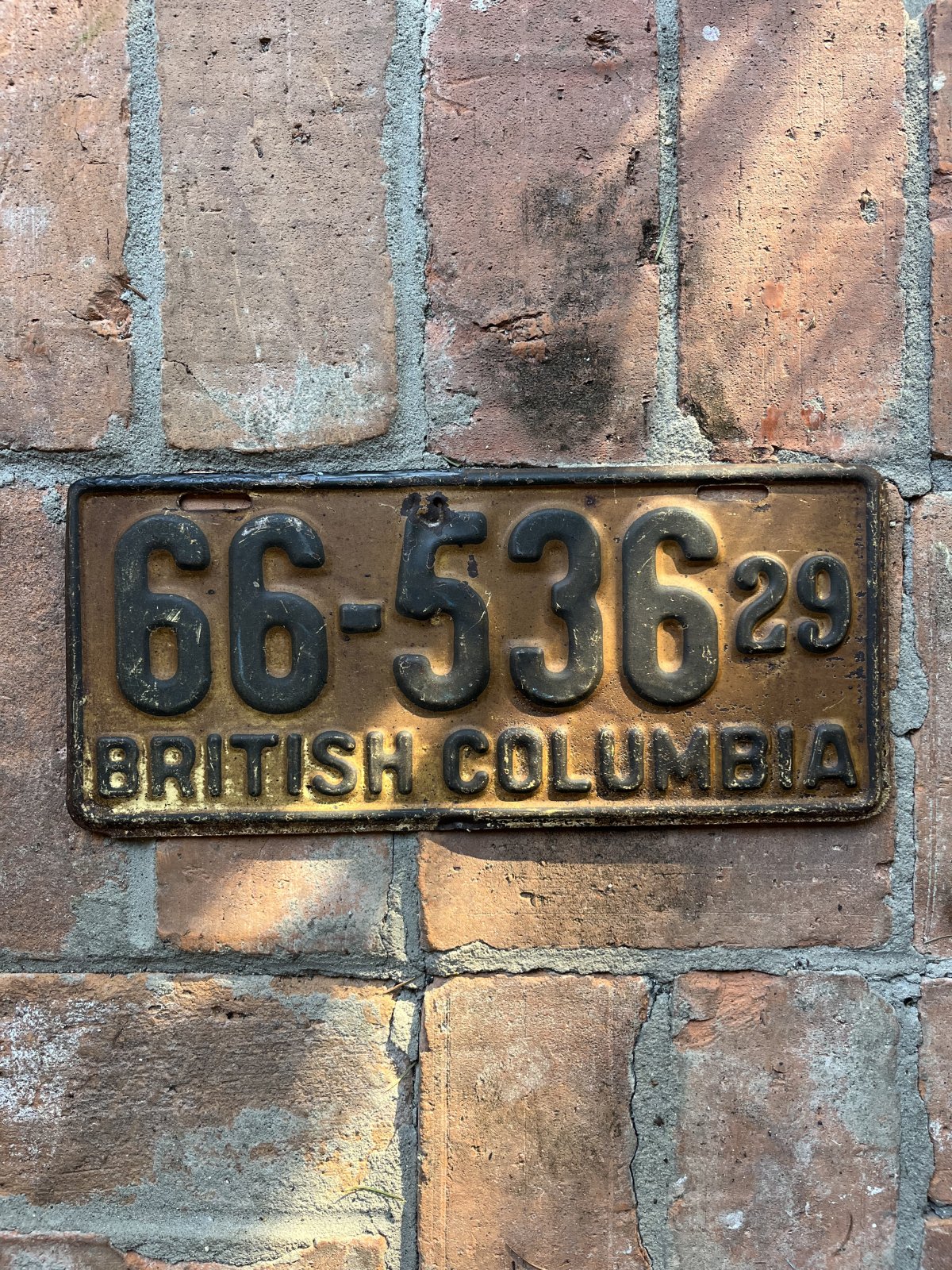

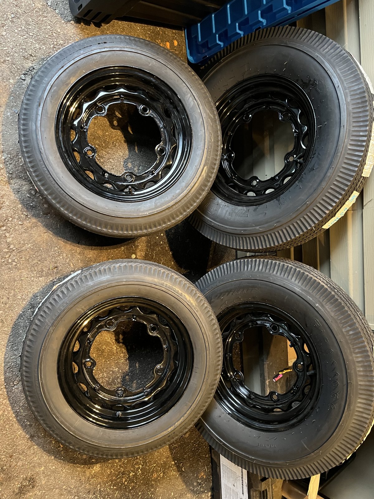

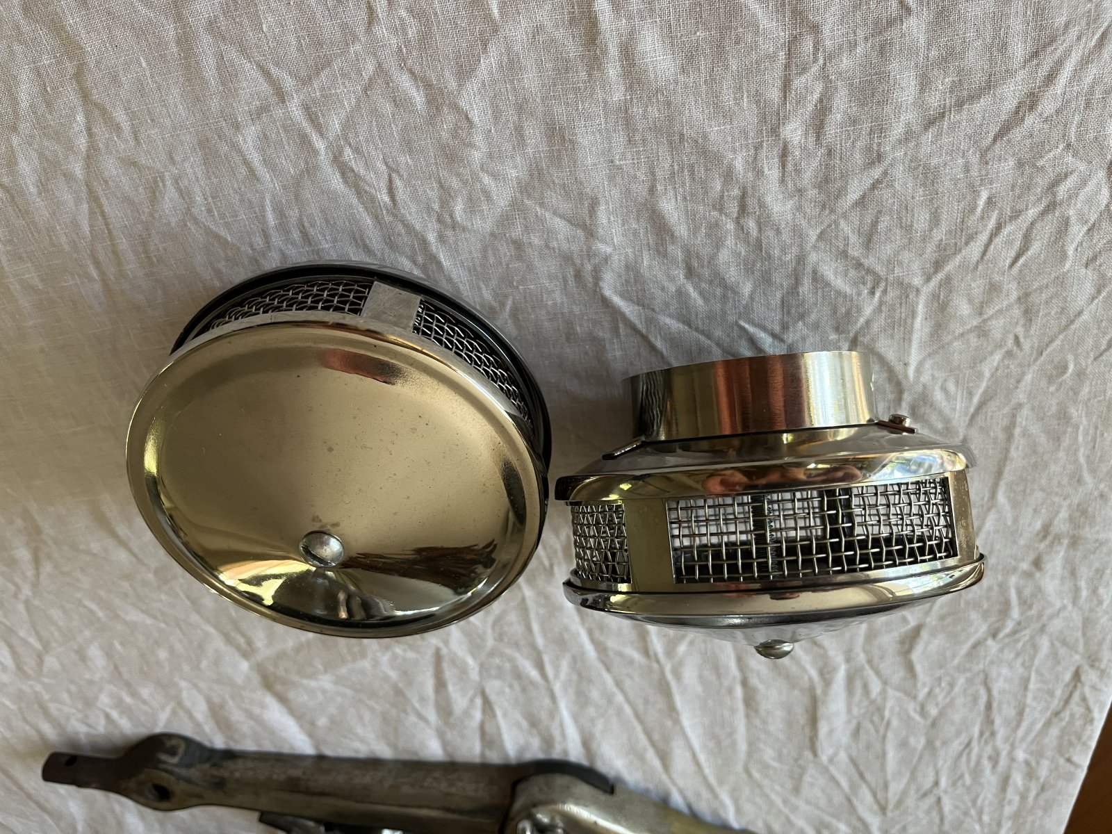

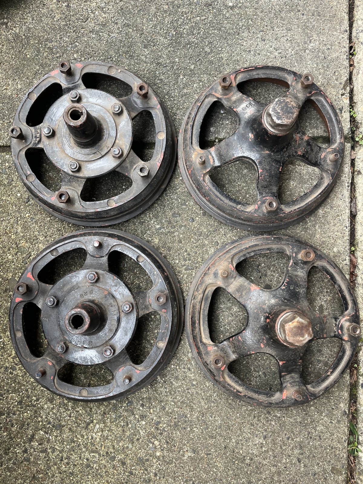

    Bryan Harris had a near old set of folding stancions. I managed to find a complete set of Rocky Mountain drums. I have another pair of rears I plan to run on the front. New shoes and wide five rims. A nice Mercury steering wheel. Some great looking air cleaners from Gear Drive. And a really neat old license plate from home. With the right year, I will be modifying the numbers to 53 - 666. Lots to get done and I want to have this rolling asap!
    9BBE65F9-C6C0-4C9F-8A72-58AEC1B2B36E.jpeg 88213054-42C9-42AF-9078-B047FF3C803F.jpeg B6831772-6516-489D-9459-22923951F702.jpeg B2910735-1C3E-4E4C-A270-FDDD3A3B0D4E.jpeg CE5B4536-911F-422E-A7BE-2F8C95AC877D.jpeg
    Stogy, Joe Blow, Okie Pete and 6 others like this.

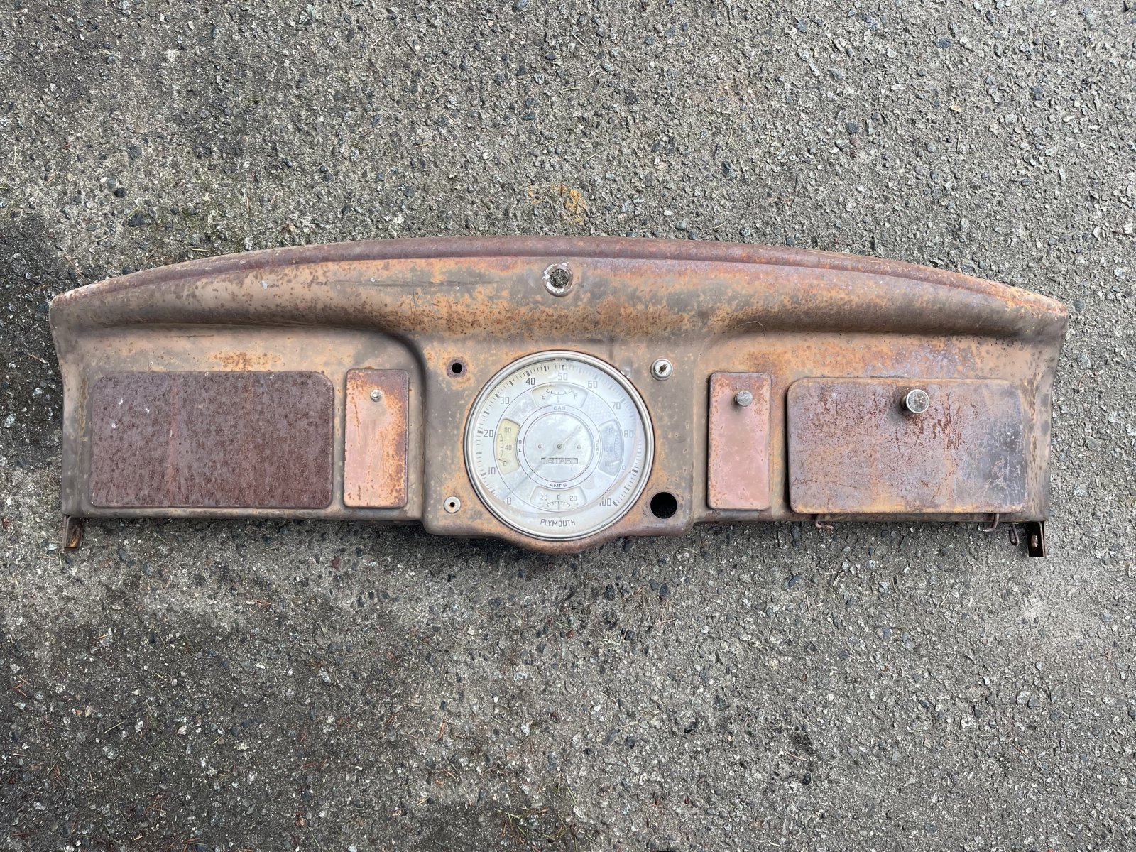

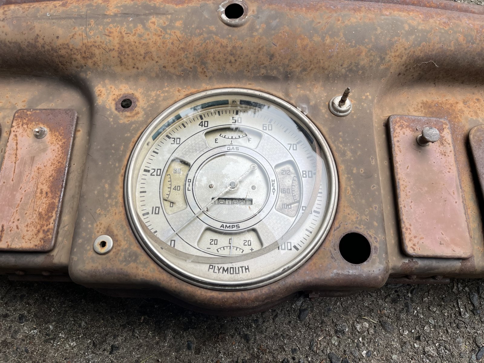

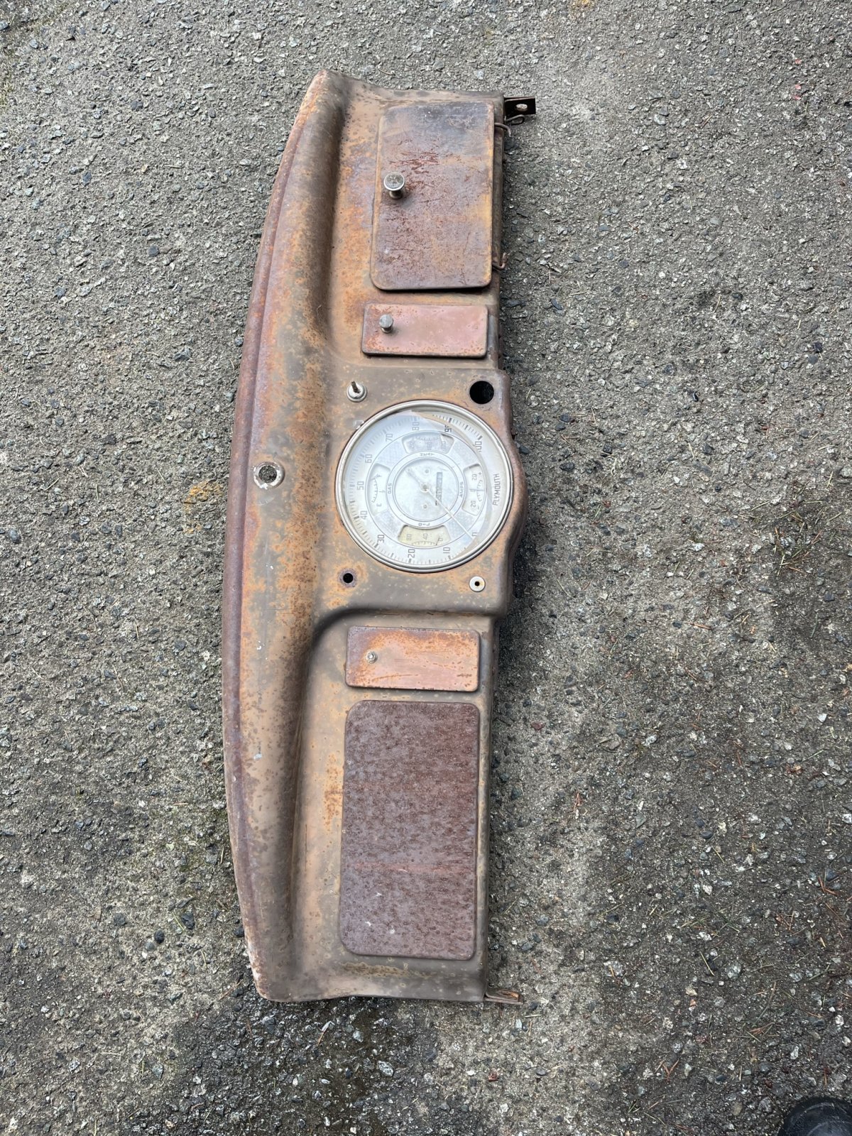

  23. I also managed to find a nice ‘36 Plymouth Dash as well. I’m hoping I could use this and still run the original fuel tank. A3A71DC4-C869-423A-8478-EF09403E5BA4.jpeg C0E3219F-D2B0-4C51-9D96-5A4ED34CCAE2.jpeg 56A9C71C-CB63-49AA-AB77-0F89B26DAEFD.jpeg
    Stogy, Joe Blow, Okie Pete and 7 others like this.

  26. The shark is fantastic. What year are the rear Rocky Mountain brake drums? Keep the updates coming.
    Stogy and jordabennett like this.

  29. I believe 35,36
    Stogy likes this.
