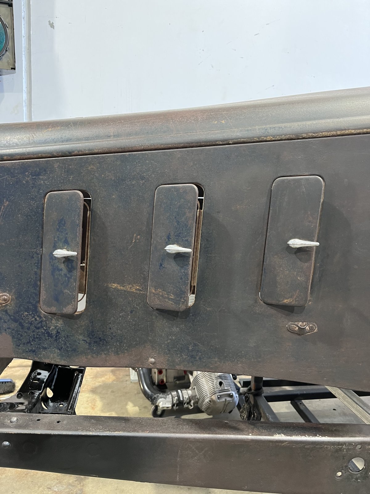

  11. Also scored this hood and sides. I planned on welding these into the model a hood and hood sides. I actually really like the body line belt it would be cool to bring that through the bottom of the fuel tank. Can anyone identify it? I thought Chevy, Buick, Packard but still can’t seem to find it. It would almost look good re shaped to a model a grill and not 32…

    Bringing the hinge line into the tank seam will set it perfectly.
    It looks like Cadillac at first glance... Caddy was pretty known for making the louver handles ornate like that. But I will say the motor was an inliner 6 or 4, probably with the narrow part of the hood, the design on the bottom of the hood sides almost lend to 32-35 area, I know the doors that are installed on the hood sides were not done for many years, by 34 most were all gone by then in favor of louvers. I would look for obscure brands that were around back then.

  14. Yeah your right about years I just can’t seem to find a make or model yet, lots of ‘close’ but not exact.

    I tried, the upward spear should be a giveaway but it isn't. Kool af but I can't find a thing to match. Era, I'd say no newer than 33 due to hood hooks vs a latch. Commercial perhaps?

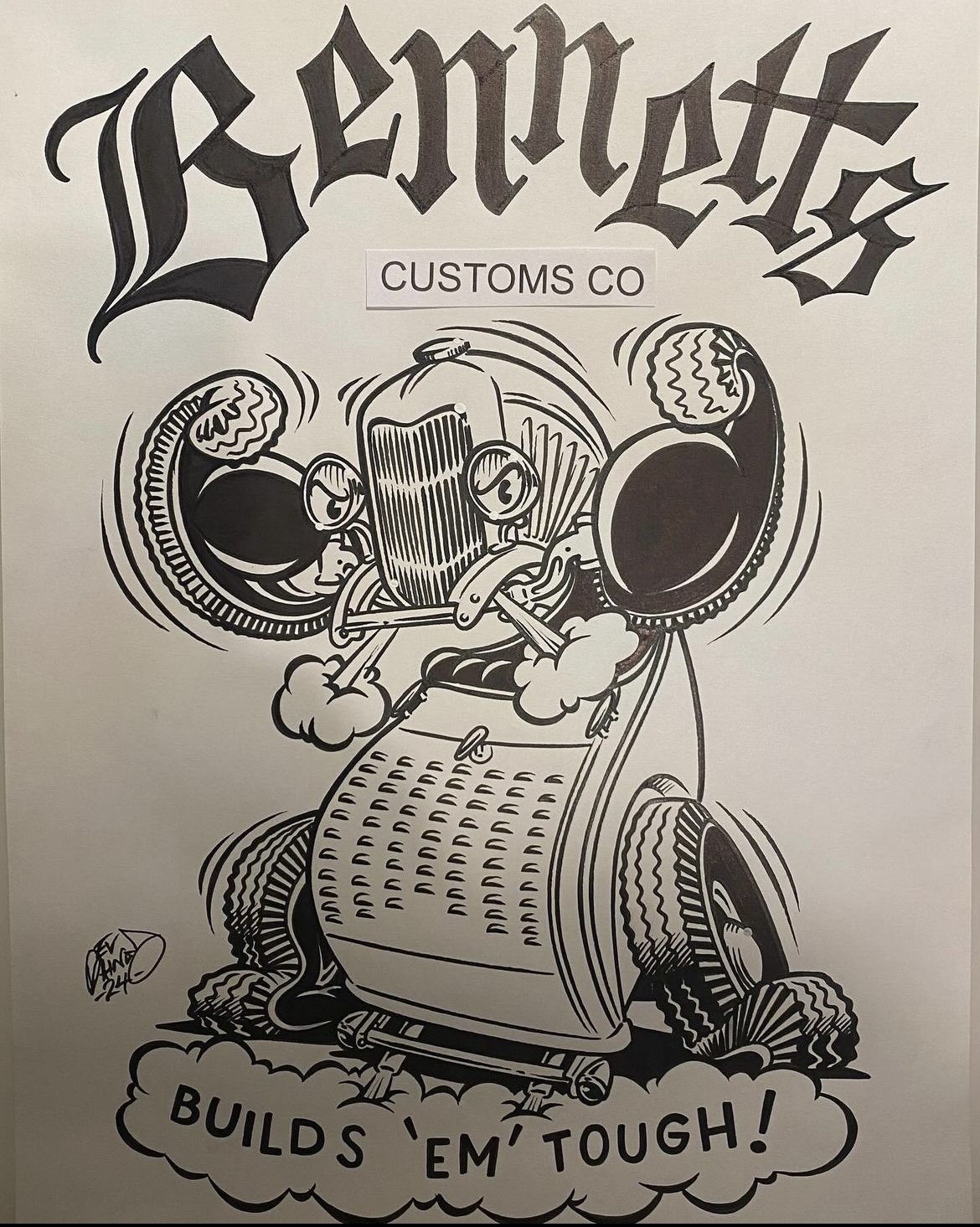

  23. A really cool drawing we will use for a new run of clothing for Bennetts Customs Co. Evan aka Mooty captured all the details from the number of louvers to the ‘39 Pontiac tail lights. I better get this thing back in the fire (figuratively speaking) 76A9C37F-12FE-4F0A-9943-2E04933A5E96.jpeg

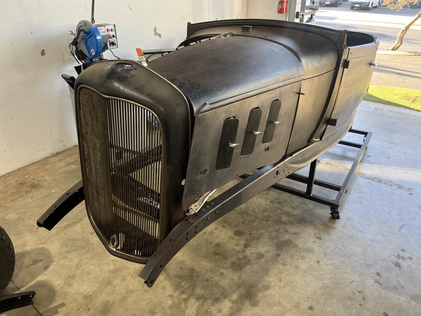

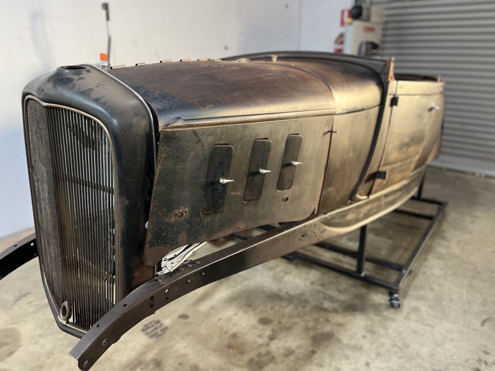

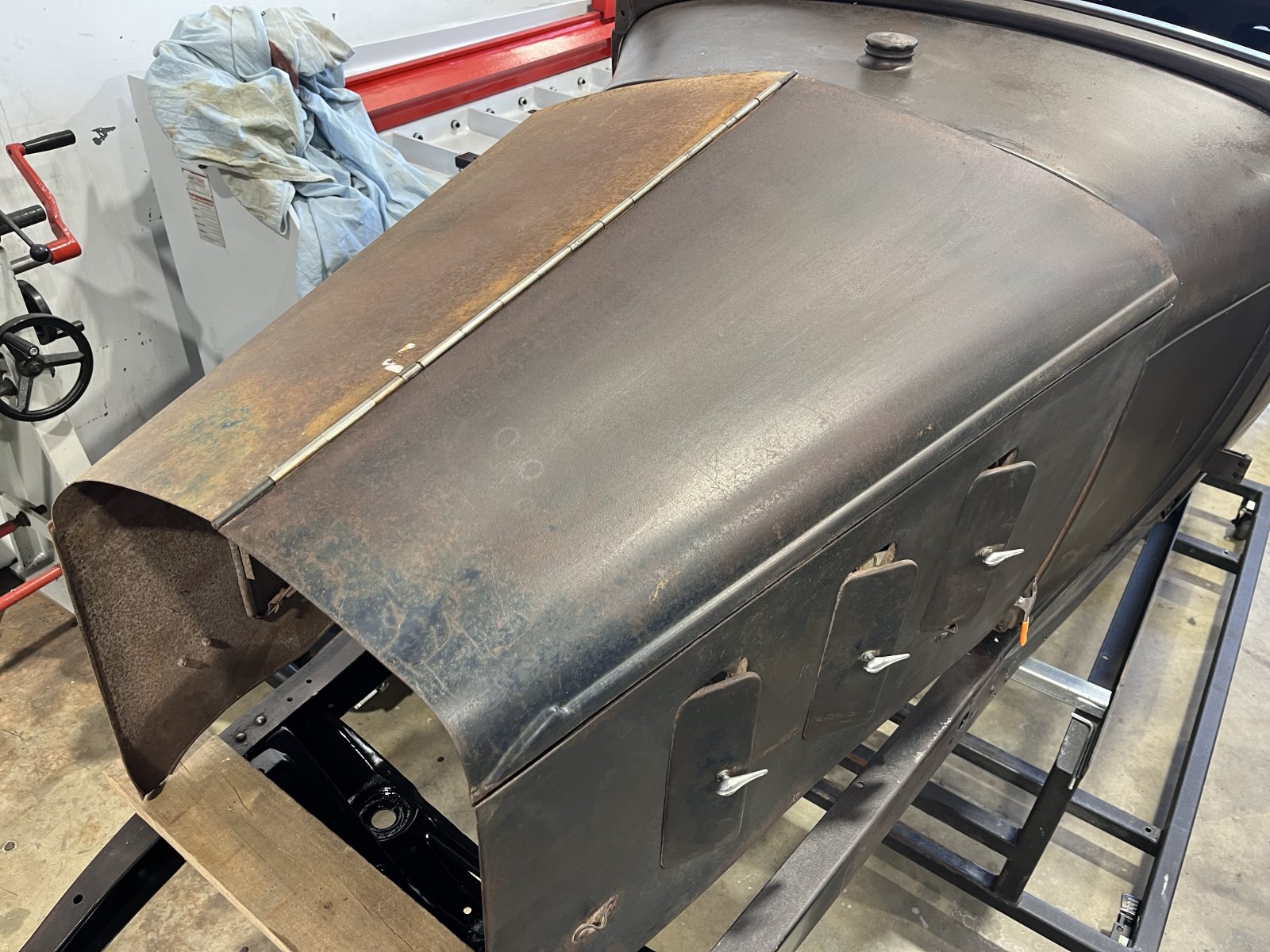

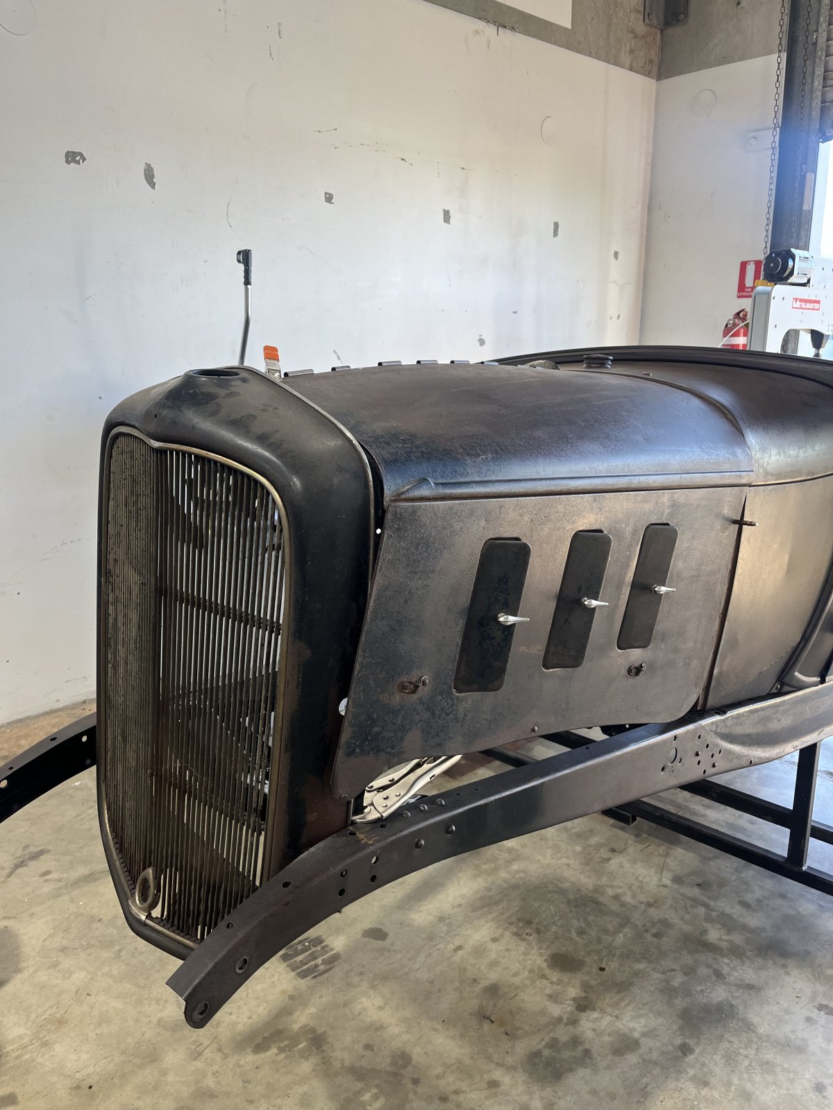

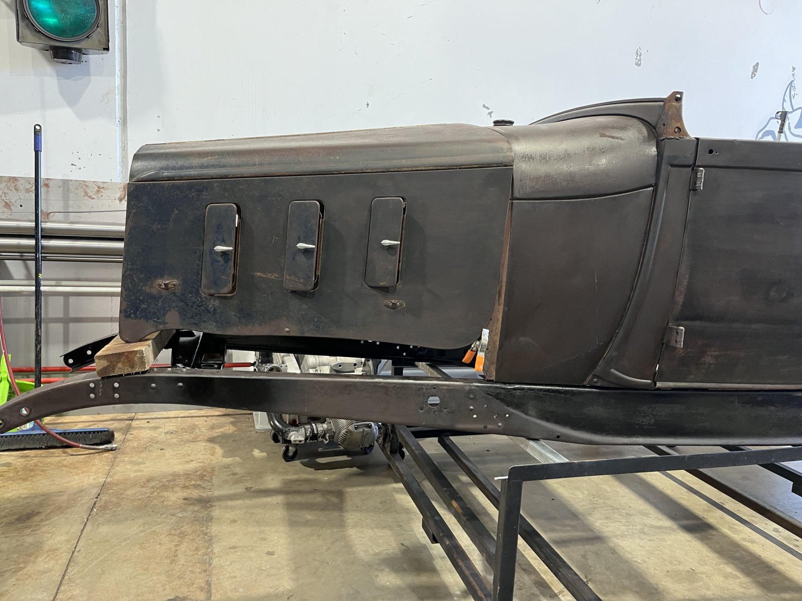

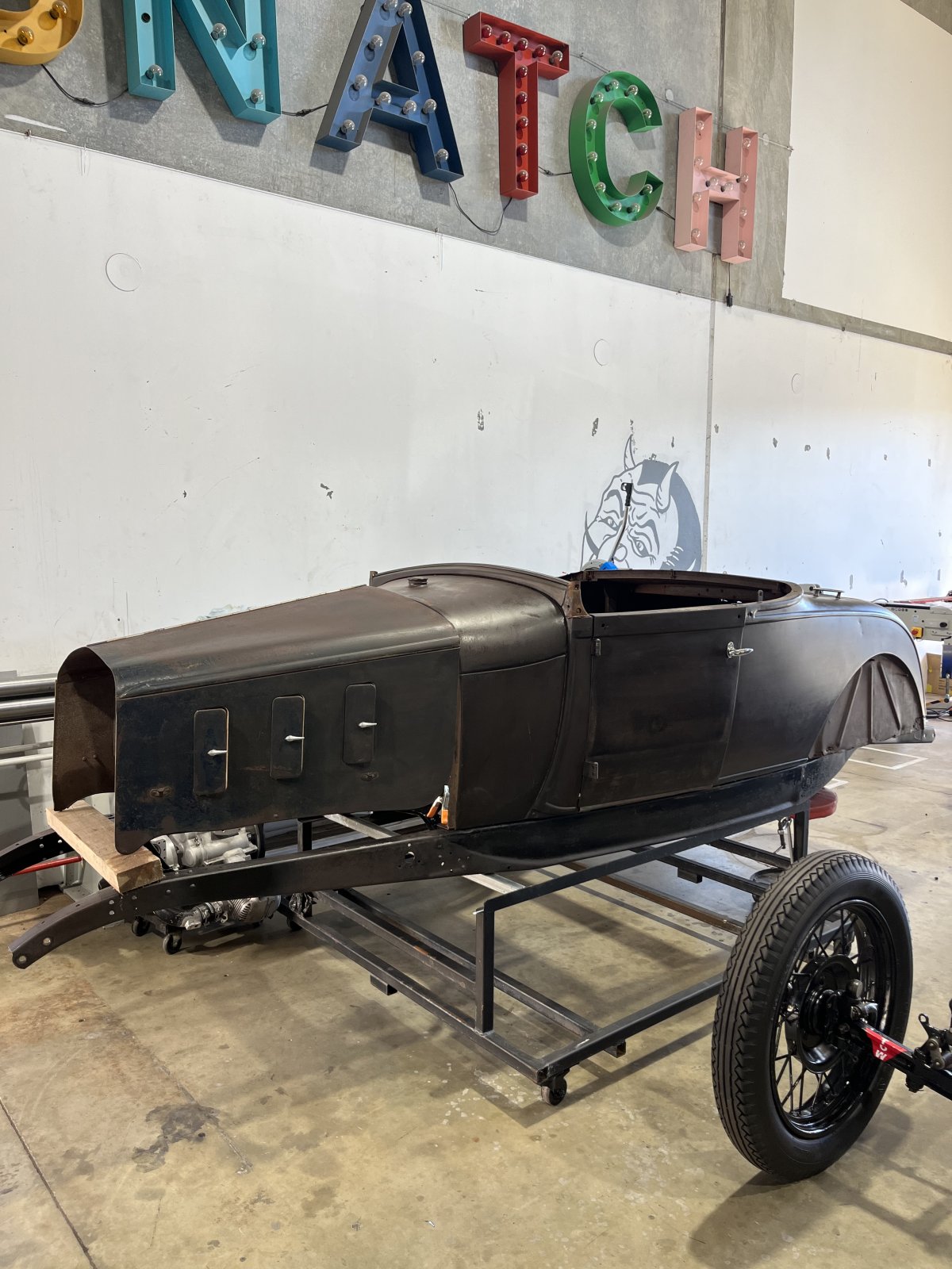

  24. Playing around with some ideas. A rough mock up shows the Austin hood in place. It will need a lot of work but I like the look of it. The bead along the hood side is something I want to bring into the side of the cowl (fuel tank). Make it look like it’s all supposed be there. 3ABD647D-609B-4DF8-B7EA-E0B646EED9C7.jpeg 5B2DC9C6-58BB-4749-96CC-2A83D1C36C26.jpeg 56AE0325-5DAD-4930-8D08-3DC6F1369C5C.jpeg 8792F91C-1A1A-4BE1-93FC-CFD55B6E866E.jpeg 73D7CB3E-B6D8-46DB-A0A4-C7F2B447B3EF.jpeg 0A6F2462-7D25-4215-BDC2-0C9934E0AD67.jpeg 37D2D299-3753-42DE-BF5C-41210DF9139A.jpeg 14D2D8AD-7E8F-49F7-811E-E06F76150303.jpeg 23228AFC-5D53-4CD7-9964-C5BF69F01306.jpeg

    Definitely need this on the back of a shirt! I need to order a couple of your other shirts anywhos.
    Loving the progress and metal work. Been making my way through your YT videos as time allows as well*thumbs up*

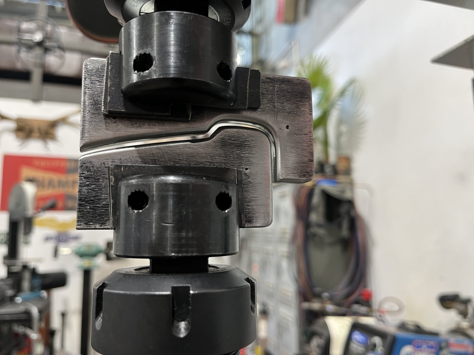

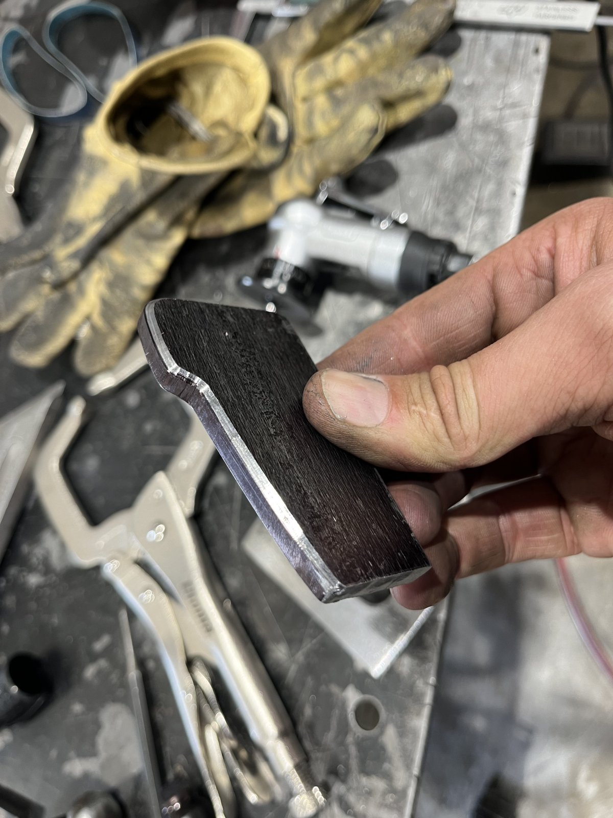

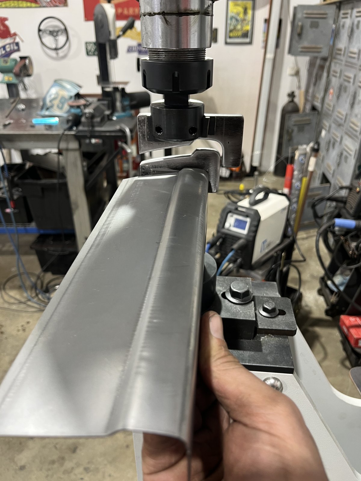

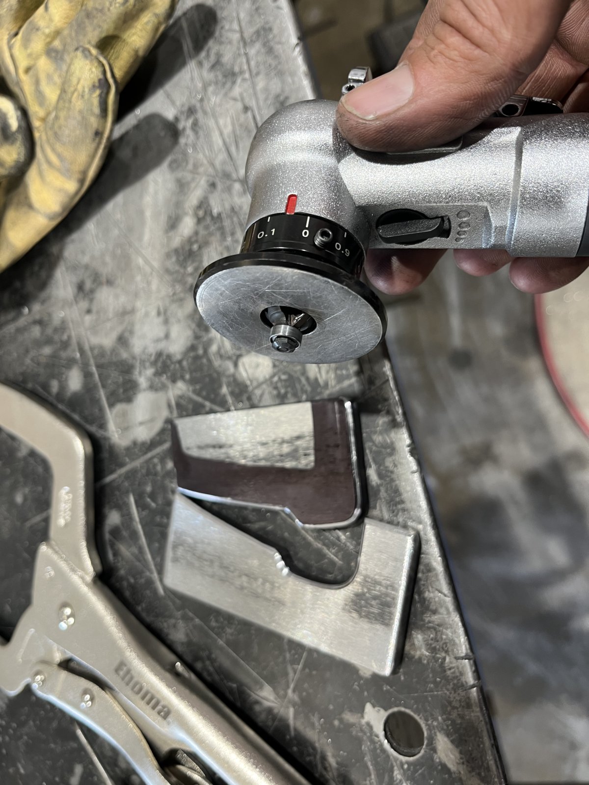

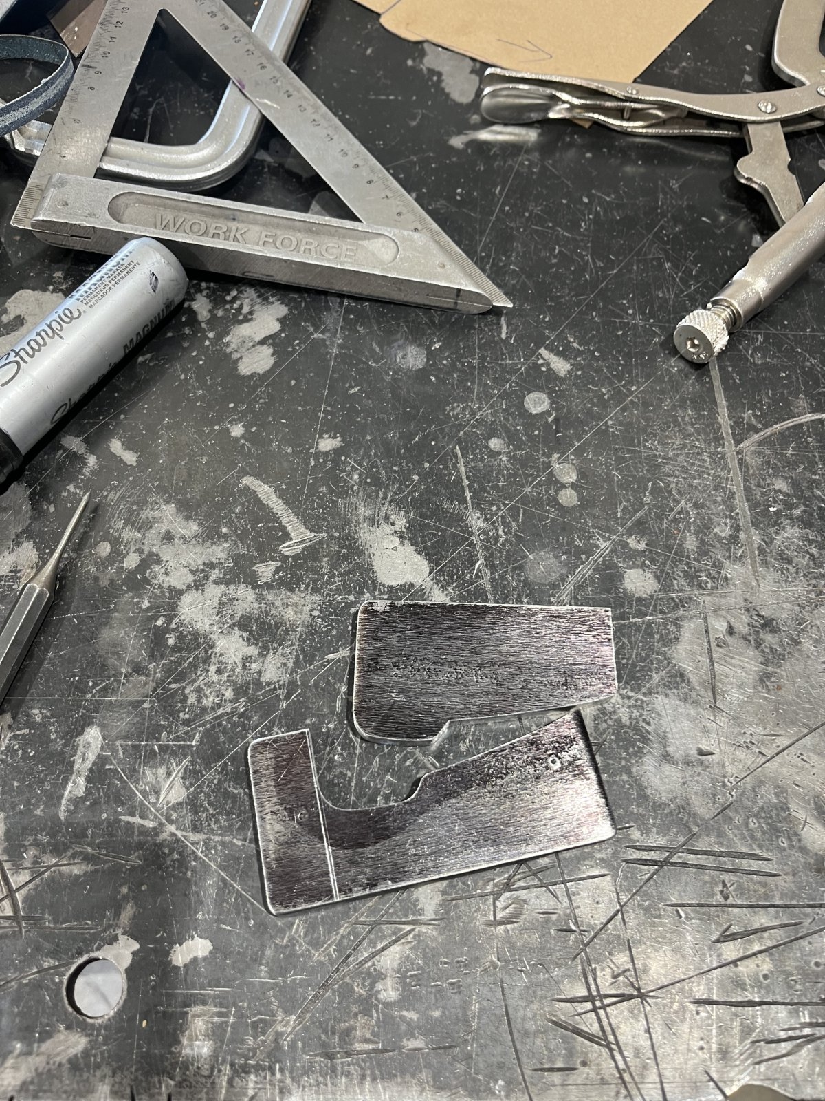

    Amazing work! Did you just use a router to cut steel? Is that a thing that people do?
    Stogy likes this.
  27. Thanks Jim! Much appreciated, should have the t shift graphic done in the next couple months!
    Stogy likes this.
  28. I just used it to chamfer the edge, a band saw was used and multiple files and sanding tape

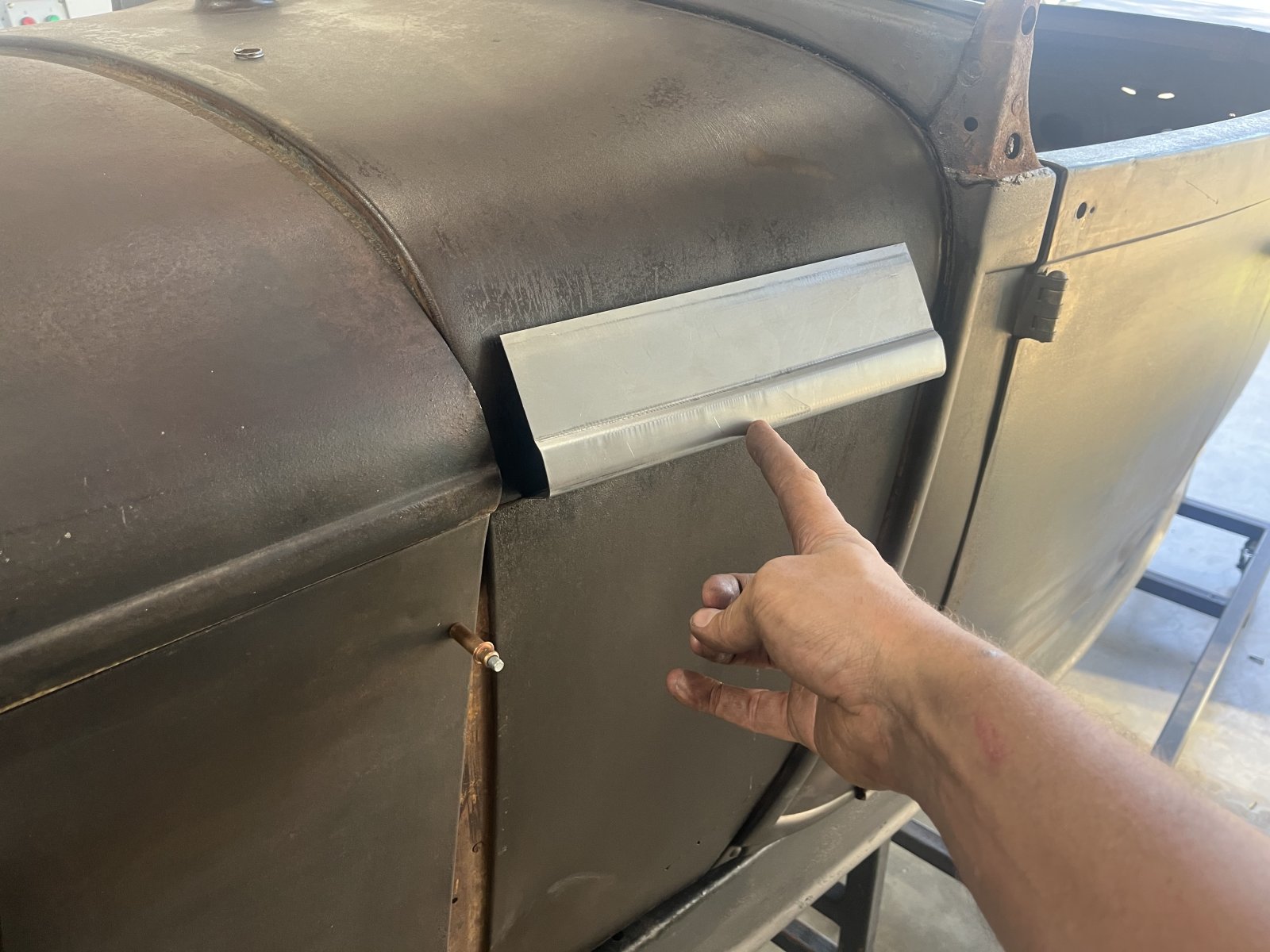

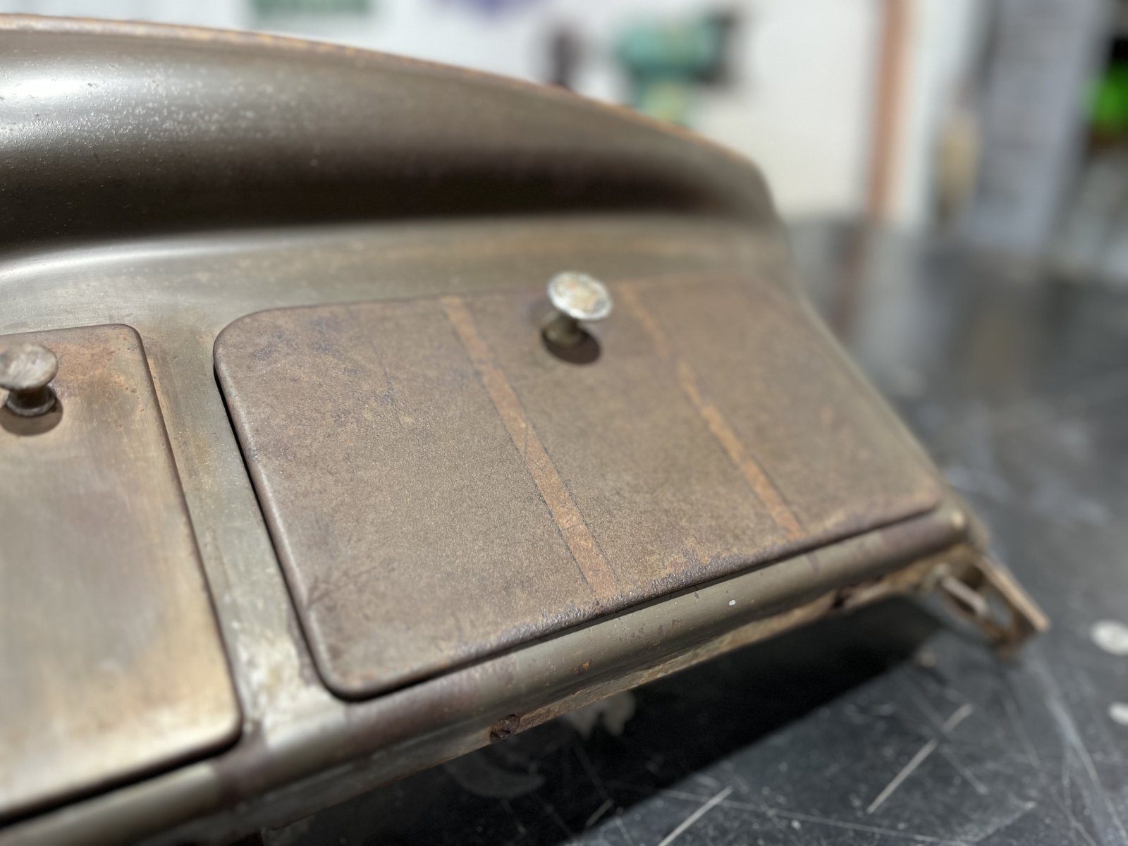

  29. Snapped a better angle of the body line this morning with the light. CC6CF84E-ECEC-4D43-9835-6A597B859C0A.jpeg

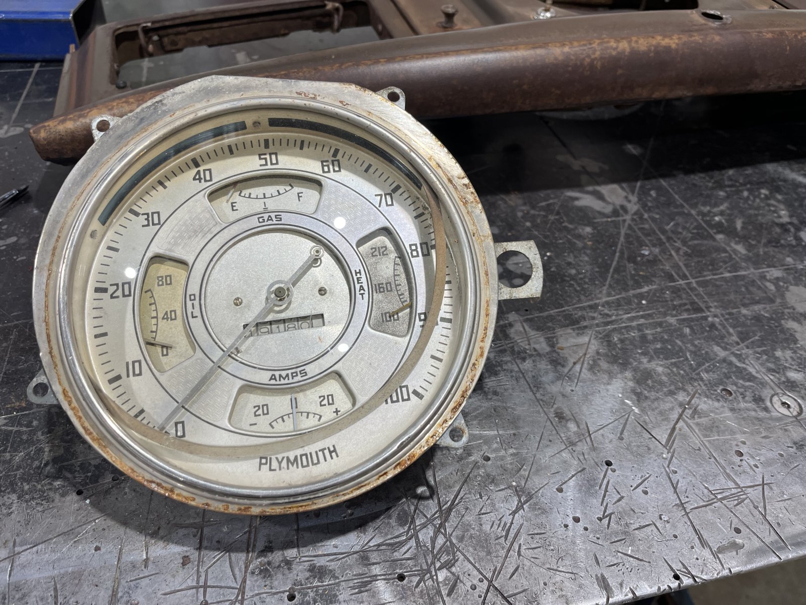

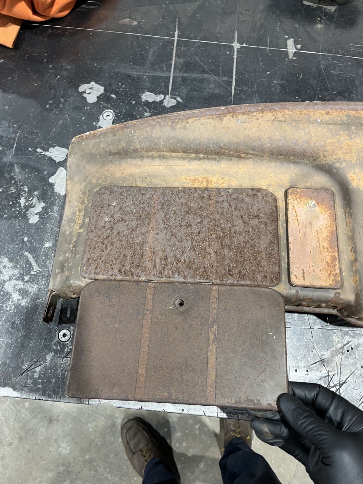

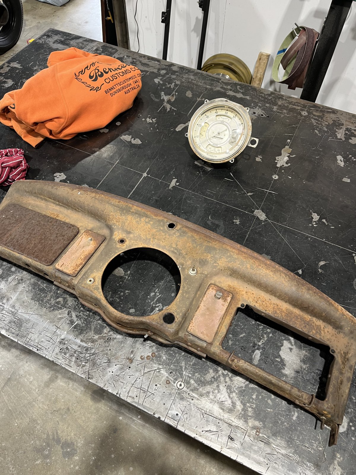

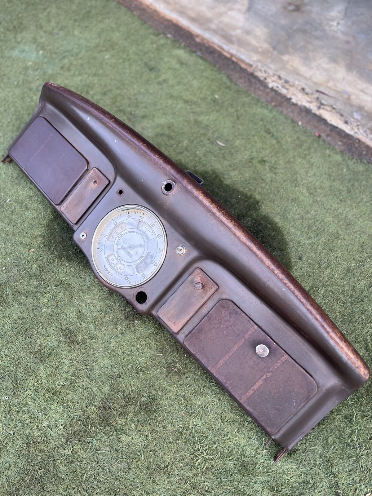

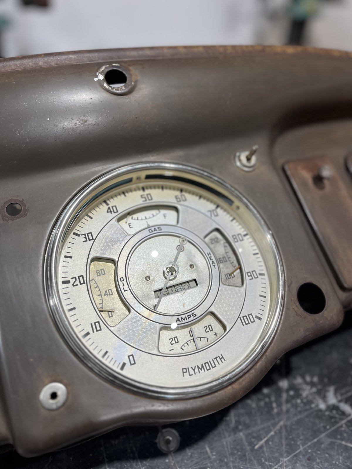

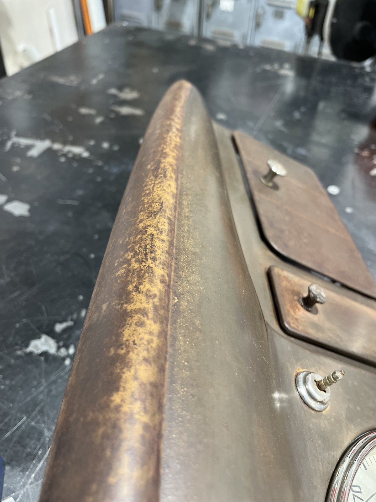

  30. Well the container finally arrived. First piece of the puzzle was cleaning the 36 dash to get it measured to fit. I still want to keep the under dash fuel tank with this setup. Maybe.
    Disassembled the dash and gauge- hit it with some Galmet rust converter. It worked a treat.
    52CF1740-D17A-422D-9D0E-60E6DBB5EA95.jpeg 2C71FF22-B551-40FB-BDE2-C0463989EFB3.jpeg 5F7DC563-EEB9-4816-AA9F-37F339A7E927.jpeg D75B65D5-2E97-4A42-8799-CC8BE52D478F.jpeg 5EFC14C3-BECB-4711-A192-D955363779DF.jpeg B22AE94F-5769-435D-969C-BC9552596751.jpeg 60BD7A8A-C4E6-4AF5-9EFD-4785FA9E2C9A.jpeg

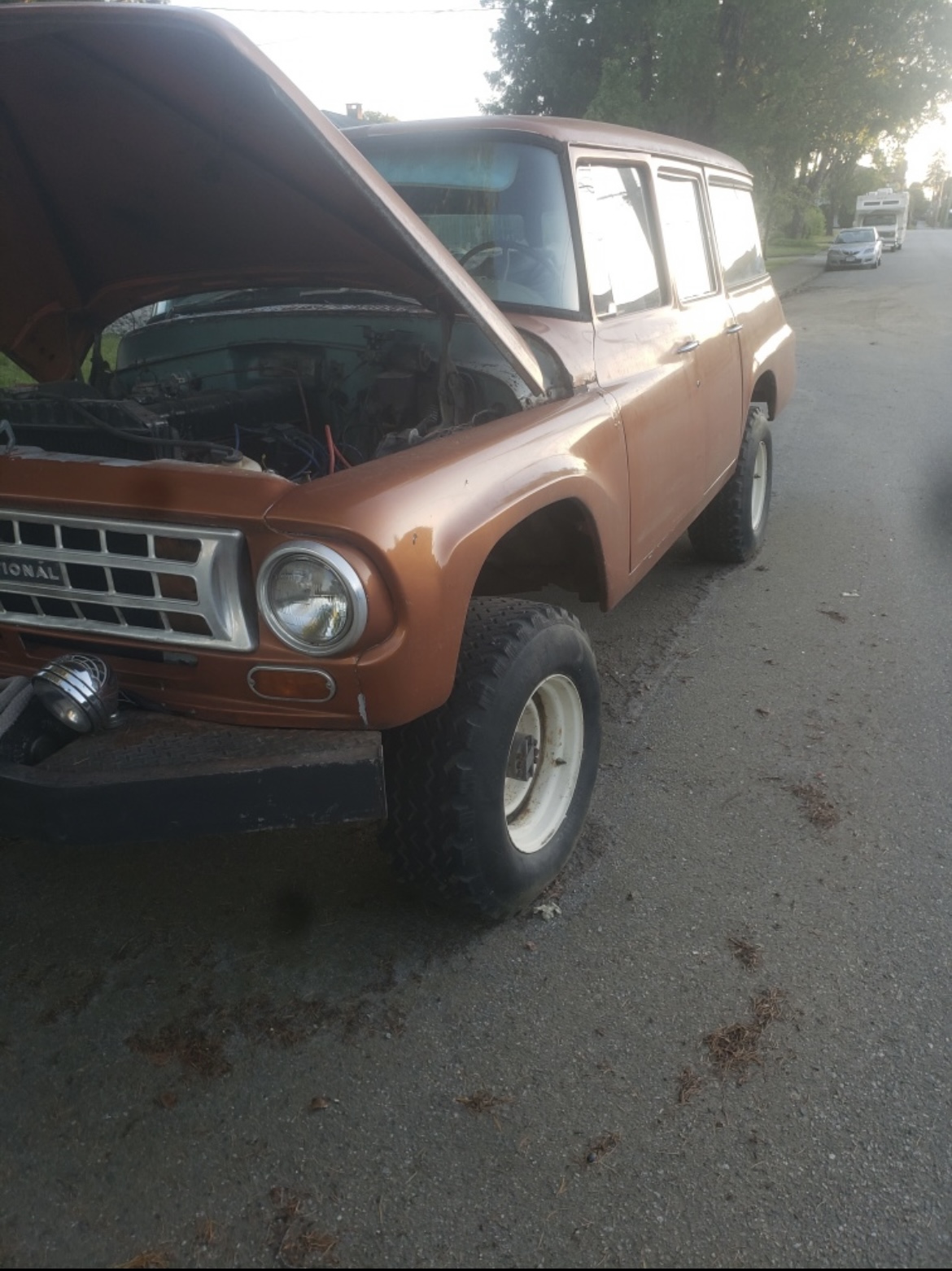

    Also I’m very tempted to get this ‘66 international Travelall for a hauler. anyone owned one, has the original straight six.
    I want to get some 9.00 16s for it and do some fun bits and bobs
