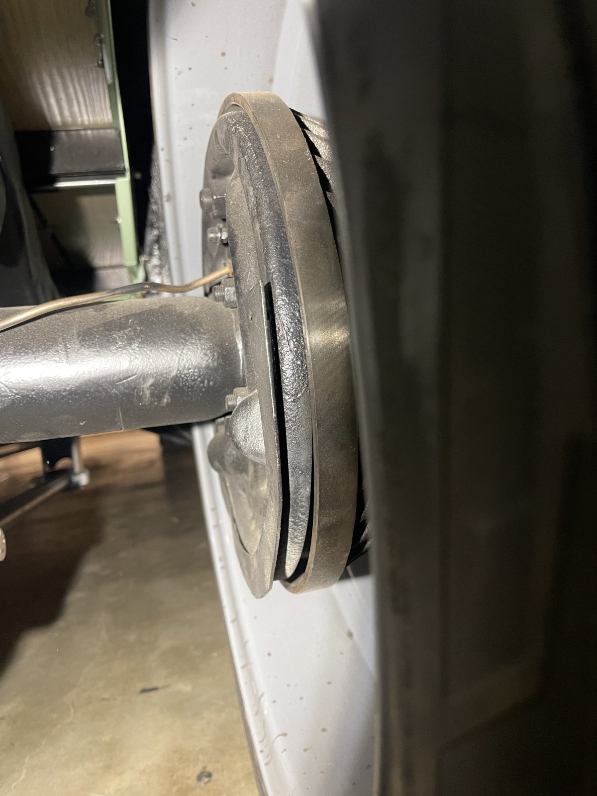

    IMG_6007.png What’s your guys thoughts on this? I picked up this 49 gmc pickup project half done that already had this 69 Camaro 12 bolt rear end. Yesterday on a drive I made it about 45 miles till I pulled over and heard some clunking from the rear. Sounded like I was about to lose my p*** side wheel. I pulled the wheel off and had some grease in the drum so it seems I blew the bearing but it didn’t seem to have a bunch of play. I had noticed the p***enger side seems to be bent on the same side I had the bearing issue?The truck drove okay so I’m ***uming it’s the rear end housing is bent and not the axle? Whats your thoughts from the picture? Thanks

    How about a shot of the whole rear end with different view's.
    2OLD2FAST likes this.
  3. SS327
    Joined: Sep 11, 2017
    Posts: 4,199
    SS327
    Could be bent backing plate?
  4. gimpyshotrods
    Joined: May 20, 2009
    Posts: 24,585
    gimpyshotrods
    Certainly looks like it.

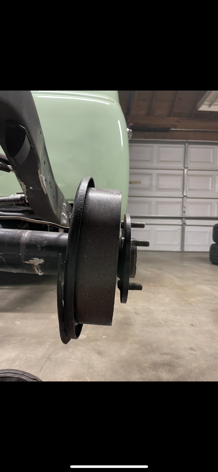

    IMG_6010.jpeg Does seem to be the backing plate now that I look at it. I’ve never noticed any excessive drag but I’m ***uming that could cause the bearing to burn up also? Whats the best way to fix a bent backing plate? Bend it or just replace you guys think? I’m ***uming I should probably double check the axle at the same time

  7. SS327
    Posts: 4,199
    SS327
    Replace the backing plate.

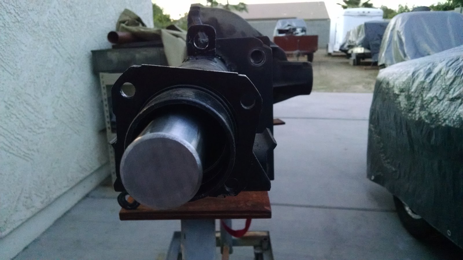

  14. My Dana 60 with 3/8" thick wall tubes was way off and needed to be straightened with a combonation of heat and a giant press 20230515_094147.jpg

    I don't think you could have tube bent enough to cause the backing plate to not align with the drum. You could have a bent flange or more likely a bent backing plate, or even rust on the flange keeping the backing plate from seating properly. Check the four bolts hold the backing plate on. While the tire is off, lift up on the axle and see how much movement it has side to side and up and down. It should be tight in all directions with just a slight in and out movement.
    What kind of wear marks are on the brake shoes?
    As far as grease seals leaking, 12 bolt axles have a hardened surface the wheel bearing rollers ride on,
    ( no inner bearing race ), axle wear causes seals to leak. There are kits available that relocate the bearing and seal. 12 bolts use C-clips to hold the axles in, you drain fluid, and pull the center pin to remove axles.
    https://pontiworld.com.au/usgmsp/product_info.php/products_id/5284
    For a fast and easy test, wrap a piece of stiff wire around a wheel stud and cut to length for a pointer. Bend wire to backing plate and spin the axle looking to see if the axle flange wobbles, or if the backing plate is bent. A dial indicator will do the same if you have one.

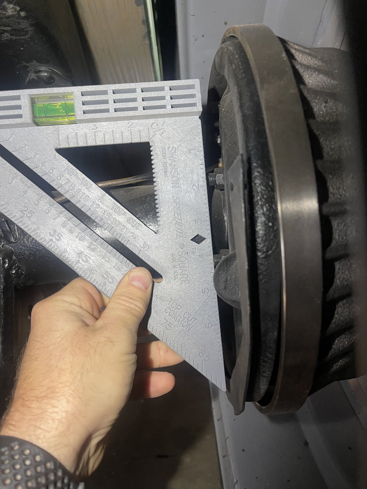

    IMG_6022.jpeg IMG_6026.jpeg IMG_6026.jpeg So I just used a square with a level real quick measuring off the backing plate bolts on the flange and the p*** side seemed to be a bit off vs the driver side. Next step is gonna be start pulling a part and dig deeper. Im ***uming if the flange is bent I’m looking at replacing the axle? I doubt any shops near me straighten axles these days.

    looks like a bent backing plate replace it but while it is apart indicate the axle flange

    Even if the flange is bent, you can still bend the backing plate in the correct location. The flange is 3/8" thick and really tight to the housing, it would be pretty rare for it to be bent without some sort of other noticeable damage.
    Just use my wire method, dial indicator, or steel rule and measure from axle flange to backing plate in four spots.
    With a couple of large C-clamps and short steel bar across the axle flange, you can pull the backing plate back into position. Just keep checking as you go and be sure the axle flange is straight first.

    As a double check, put your level on the lip of the brake drum.

    This is a 12 bolt that had a BUNCH of bad welding on it, it was in use, I'm sure trashing bearings, and wearing out the spline in the posi side gears?!?! Takes a lot less heat and welding to bend a tube than people think!!! That is a 1 1/2" dia. line up bar for narrowing rear ends IMG_20150413_055104735.jpg
