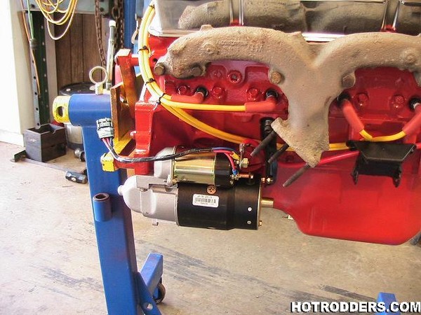

My 472 Cad came with a bracket that went from a front starter bolt to the block for support, from the factory. Just like pictured by Pete Eastwood.

I think being a mini starter doesn't change the need for a brace of some sort. The load is the same at the pinion to flywheel teeth. The teeth on both have sloped surfaces and the starter torque against the flywheel resistance tends to push the pinion away from the flywheel, twisting the mounting bolt in the process. That's my theory and I'm stickin' to it until somebody else makes a more convincing case for another cause... It seems to me what is different between a mini starter and the stocker is the sheer m*** and length of the OEM starter hanging on those bolts.. That, and the resistance to the aforementioned torque issue are likely two reasons GM felt the need for the brace at the front of the starter. Only one of those problems is eliminated by the lighter weight of the mini starter Ray
When Using a starter with 2 bolts in a straight line it's imperative to have the front brace When using a starter with stagered bolts that brace becomes more of a can't hurt and a good idea. Having the right mini starter bolts, and they are special bolts for them, makes a lot of difference. The shanks are over size, the knurles need to go past the starter and into the block.
