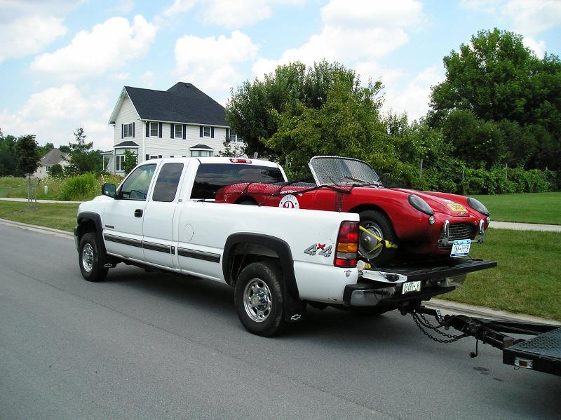

    Howdy all, I have been trying to get some pics to load so I could post this, but they are still resisting, so I am going to start with what I have.
    As some of you know I got to go to Speedweek '08 (for a day, beat's noting :D). I had to leave for a training semianar, but convinced Pops to stay and see the races with some friends.
    So I get this phone call on my cell about Tuesday, 'how would you like to drive a Bonneville car?'
    Uh- huh, 'which one is it dad?':rolleyes:
    Some humor ensues, but isn't particularly entertaining to repeat, use your immagination, it'll be pretty close.
    Suffice it to say I jokingly tell people here that "I left him unatended at Bonneville and he bought a car.":D
    We are doing maintenance and minor mods now that the car's home. We stopped by a friends' house on the way back home to clean the car and get a better look at what we had.
    Before we pulled the body off I got this picture.
    You can almost hear him making motor sounds, can't ya? :D (me too :D:D)
    The body isn't screwed down in that pic, the rear belly pan mount is broken (hence the larger body gap back there) and the stick looking thing behind the cage is the guide rod for the tank vent (so the hose makes it through the body when you are puting it on).
    We are making the pedals adjust so we can both drive it (they were a touch too far away for him and too close for me). We think we have most of that sorted out, of course we won't know for sure till we have it all hooked up and working.
    I have various pictuers of that, but Photobucket and my derrr-puter are not cooperating at the moment (I suspect it's more the connection than anything). So I'll post them here when I get them to go there.

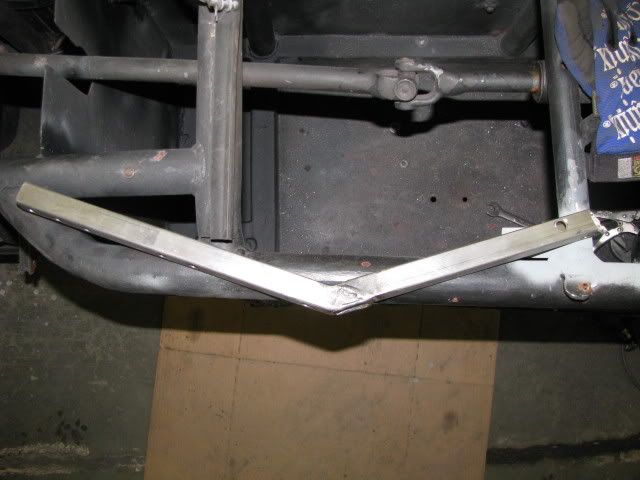

    Here is a series of pictures that shows the current level of completion on the adjustable pedal ***embly
    First one, a view from abbove with the left slider rail laid over the top of the cage. In real life it would be turned 90* so the 'bend' would be down.
    This is the upper slider rail bracket, note the 2 5/16 bolt holes 90* apart (yes we plan on Grade 8 bolts)
    This is the forward slider rail reciever socket (left side) at the firewall (16 gauge steel).
    Note: The rectangular hole you see in the firewall is to p*** the clutch cable and it's support bracket through (bracket just pokes through in the forward pedal position). We are sussing out a boot to seal this.
    Here's a side view, a 'benchtop mockup' of what it would be in the car. It would actually be level in the car, but I was off a bit as this is 'for intelectual purposes only'. :rolleyes:
    Note the high tech, race weight support brace to the right of the pic.;)
    And finally we have a top view of the left slider and rail ***embly set roughly to the forward position. We hope to use 5/16" lynch pins, if tech says no, we have bolts for them.
    The rail is 1/8" wall 1" square tube and the slider is 1/4" wall 1 1/4" square tube. It fits together much better than it sounds.
