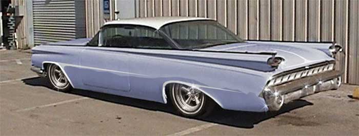

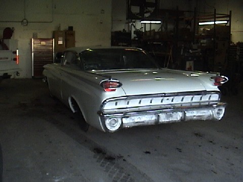

  4. [​IMG]
    Here's a few.
  5. SinisterCustom
    Joined: Feb 18, 2004
    Posts: 8,273
    SinisterCustom
    The top pic is a '60.
    You see more '60's than '59 and '61 COMBINED.
    To me, '59-'61 Olds were just the coolest of the GM's for those years!

  12. SleestakJones
    Joined: Dec 8, 2002
    Posts: 113
    SleestakJones
  13. I think I'd try and make it look less like a skateboard and go with the 15" supremes.

    My '61 Dynamic 88 also had the larger bolt pattern....5x5.....
    Mr. Jones.....the photoshop version looks SPOT ON!
    SWEET car.......

    Thanks man, I was pretty specific when Mike (4t64rd) photoshopped it, I think this was the 3rd shot.
    He rules.
