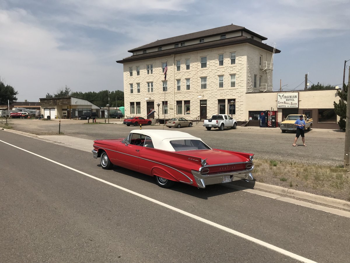

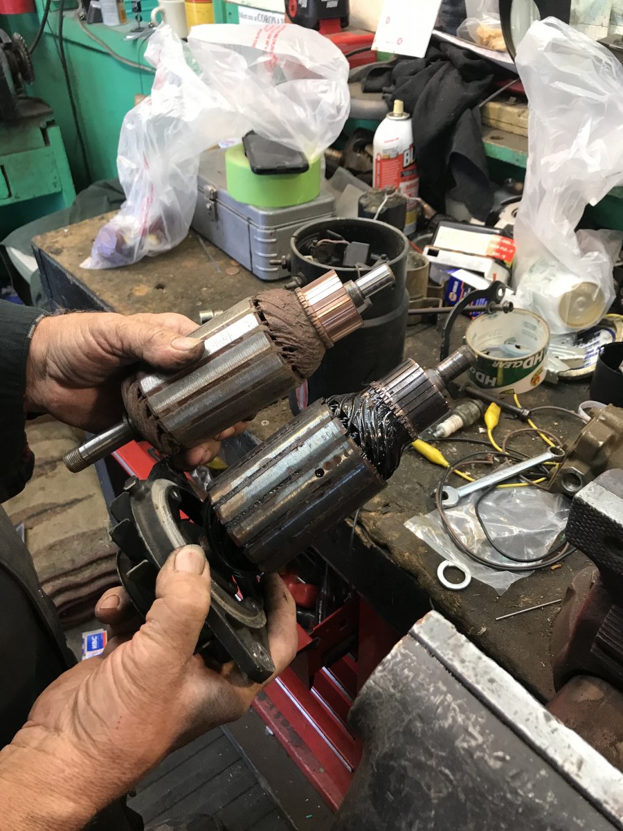

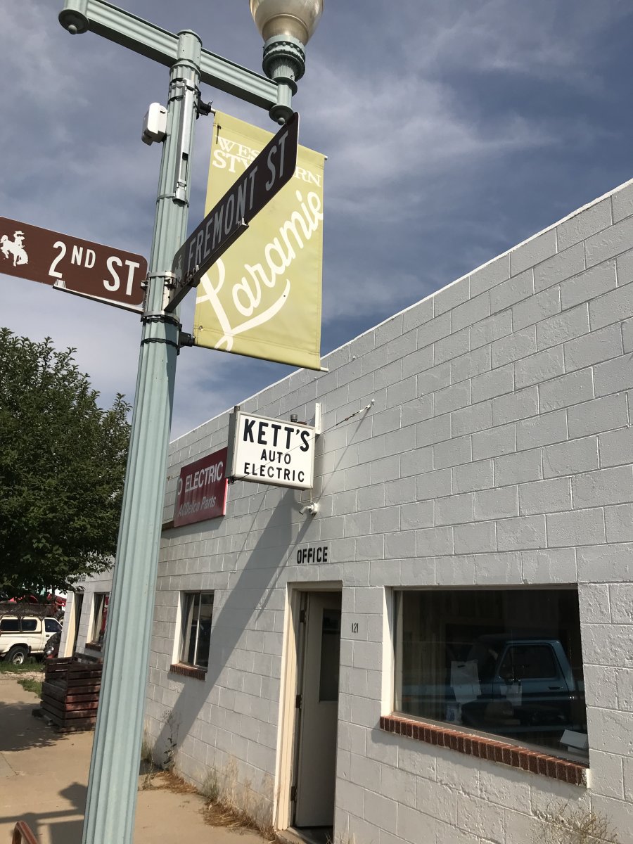

  1. The breakdown couldn’t have happened in a better place. Found a company by the name of Kett’s Auto Electric that opened in 1918!
    It turned out the regulator went bad so the generator stayed hot and roasted the armature and the ammeter gauge.
    They have a regulator, the generator is almost finished being rebuilt, a voltmeter is being installed and we’ll be back on the road.
    Amazing people at Kett’s!!!

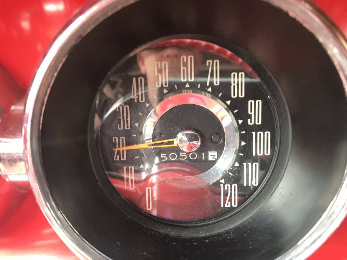

  8. Well....... got to Billings last night but stayed in a hotel that had their wi-fi powered by a hamster wheel so there was no updating. We were on the road this morning at 6:45 and made it home before 8:00 PM. The border crossing went smooth and we were through both the US and Canadian side in less than 30 minutes. The car ran great and averaged 13-14 mpg (US gallon) at 75-80 mph. The car drives amazing. I’m beat and heading to bed and will post some photos and details of the trip tomorrow.
    Here are a few photos though. The before and after odometer....... and a shot of the car with the skirts off. They had to come off...... just had no room in the trunk during the drive.
    Thanks for all the well wishes and offers of help........ I’d do the drive again in a second. lol

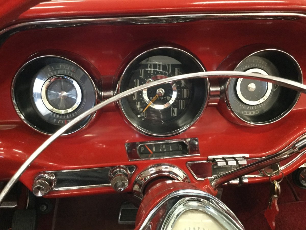

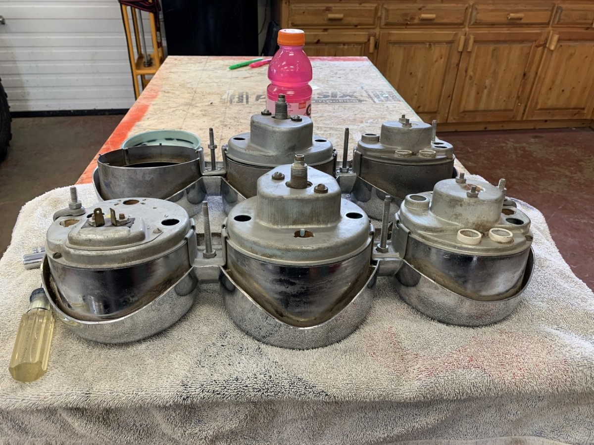

  9. Would anyone know where I could find a nice used or NOS ammeter gauge? Need to pull the ammeter fuel gauge cluster to clean all the smoke residue out. Might as well do it when I have a replacement gauge available.
    Thanks in advance.

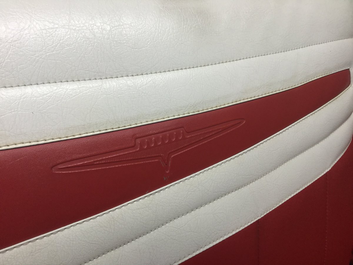

    Interesting upholstery pattern (is that Pontiac's original pattern or custom?):
    Where are you when you're in Missouri?
  16. That’s the original pattern. There’s actually an embossed logo in each the two upper red pieces.

    You might want to do a google search for the amp meter might be a tough find don’t know.

    Check EBay, CPR, get on the Ames Performance forums and ask around....just a few suggestions
  24. Thanks for the suggestions on the ammeter.

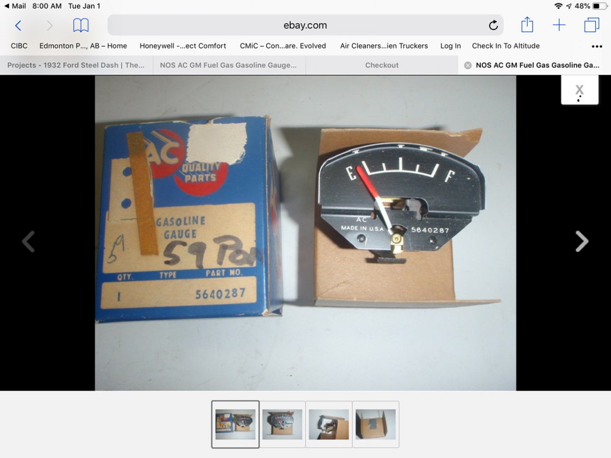

  25. Bit of an update on the car. Found a NOS ammeter and NOS fuel gauge on the auction site over the last couple of years. Pulled the gauge pod out last year and realized there was no cleaning the smoke damaged lens so started hunting for a gauge pod to salvage a lens out of. Found that last fall and now with so much free time on my hands, have everything back together and reinstalled. One lesson learned....... when you’re reinstalling NOS gauges, make sure you install isolation pads between the contacts and the gauge housing........
    Looks much better and I can now read the fuel gauge. I decided to leave the ammeter bi-passed and use just the volt meter under the dash. I’ll be looking for a more period correct one to replace the one installed. I can always wire the ammeter in, but with what happened on the trip, I’m just more comfortable with it the way it is. I do have a breaker to put on the regulator that Kett’s gave me. Maybe at some point I’ll do that...... just not now.
