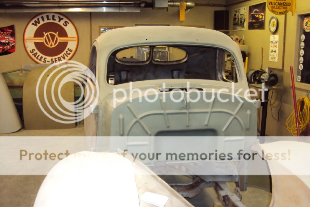

    A few progress pictures. I needed a break from the welding as i was having an eye issue so i did some bodywork. I finished the repair around the wiper holes and reshaped the windshield post. These were originally leaded in but i used all metal filler. [​IMG]
  18. ME.GASSER
    Joined: Sep 18, 2007
    Posts: 3,627
    ME.GASSER
    This shows the firewall finished.[​IMG]

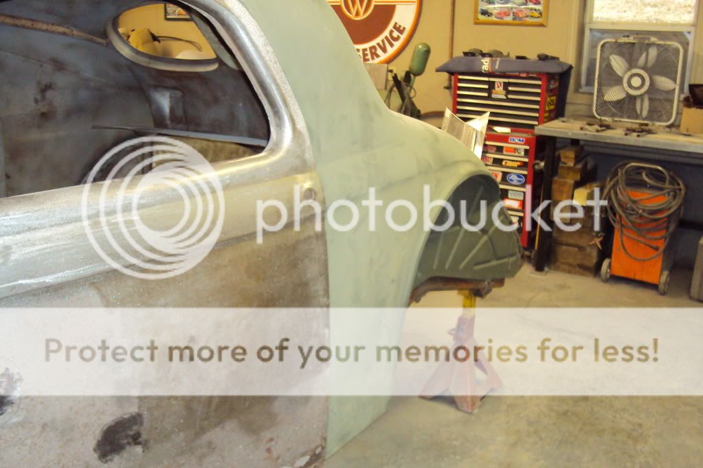

    I spent quite a bit of time with a shrinking disc and a slapping file to get the quarters in shape. [​IMG]
  20. ME.GASSER
    Posts: 3,627
    ME.GASSER
    This quarter panel need quite a bit of work from the belt line down. The old repair was done by beating the quarter in and covering it with a heavy coat of bondo. It would have made a good picture for the bondo abuse thread. The roof was in really good shape. It only took me a couple of hours with a hammar and dolly to repair it. Then covered everything with etch primer. Next i will be tackling package tray and the front floor boards. Once completed i will epoxy prime the inside. Stay tuned.[​IMG]
