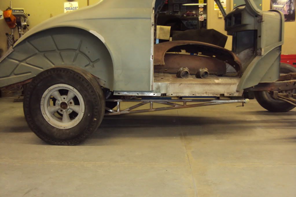

    It has been awhile since i posted anything on my build thread. The hand surgery didn't go well. I had to have a second surgery and i'm probably looking at a 3rd. I did some work on the car in the last couple of weeks. I finally received my deck lid from Randy Ferguson so i installed it and began to fit the tail panel. I will post pictures of the work completed to date.
  18. ME.GASSER
    Joined: Sep 18, 2007
    Posts: 3,627
    ME.GASSER
    [​IMG][​IMG]
    If you've been following this thread from the start you will remember that the donor sedan had been hit hard in the left rear. I knew that i was going to have to pull the floor back straight to get the tail pan back on. So the first thing i had to do was to make the car a roller. I had an olds rear and these 5 foot ladder bars that Jim Tinsmith had made so i temporarily mounted them under the car.
  19. ME.GASSER
    Posts: 3,627
    ME.GASSER
    I loaded the car up and brought it to my friends shop where we put it on his frame machine and pulled everything back straight. Then i brought it back home.[​IMG]
