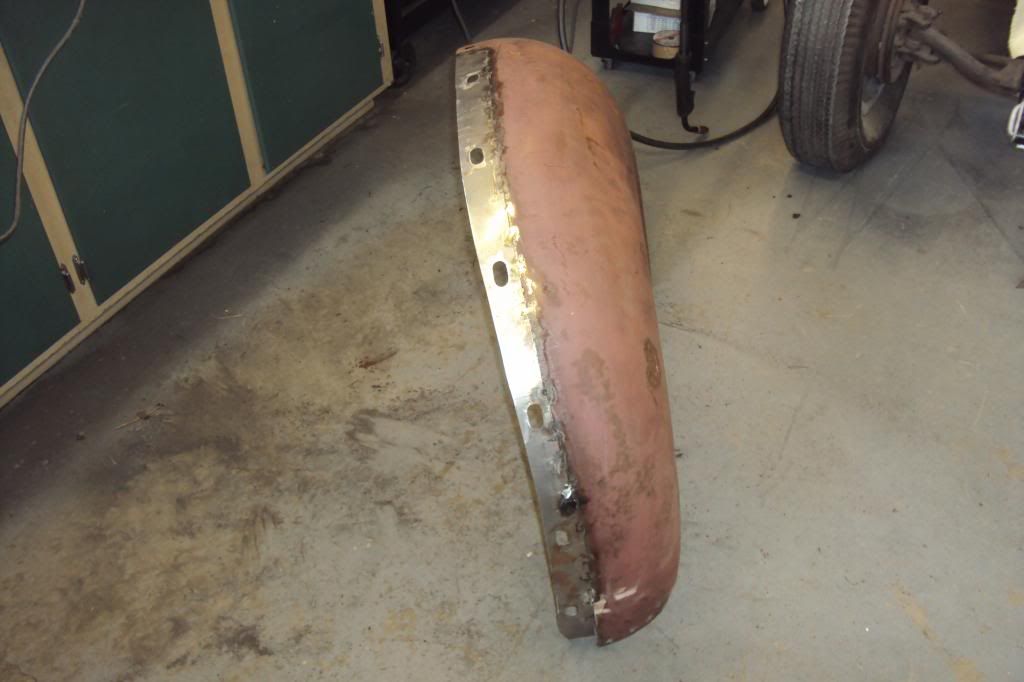

    I decided that while is was waiting for some parts to come that I would tackle the rear fenders. They are the only body panels left to do. I had a pair of 37 sedan rear fenders that I had used when I repaired the fender wells so I decided that I should use these as they would fit the best. They have some rust issues that I needed to deal with. So here we go.[​IMG]

    Welding complete. This little project took me all day.[​IMG]
