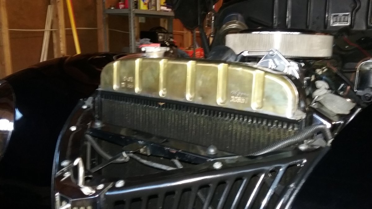

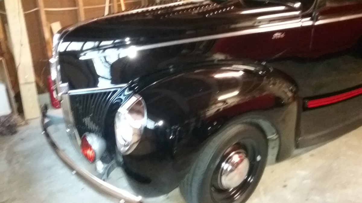

  21. This '55 Chevy radiator has been in my '40 since the late 60's according to previous owners I've spoken to. Mild SBC. I've owner the car for 27 years and had the radiator re-cored a couple of years ago. Hope it outlasts me. 20170408_070903.jpg 20170408_071021.jpg
  22. Nice fog light..
    lothiandon1940 likes this.
