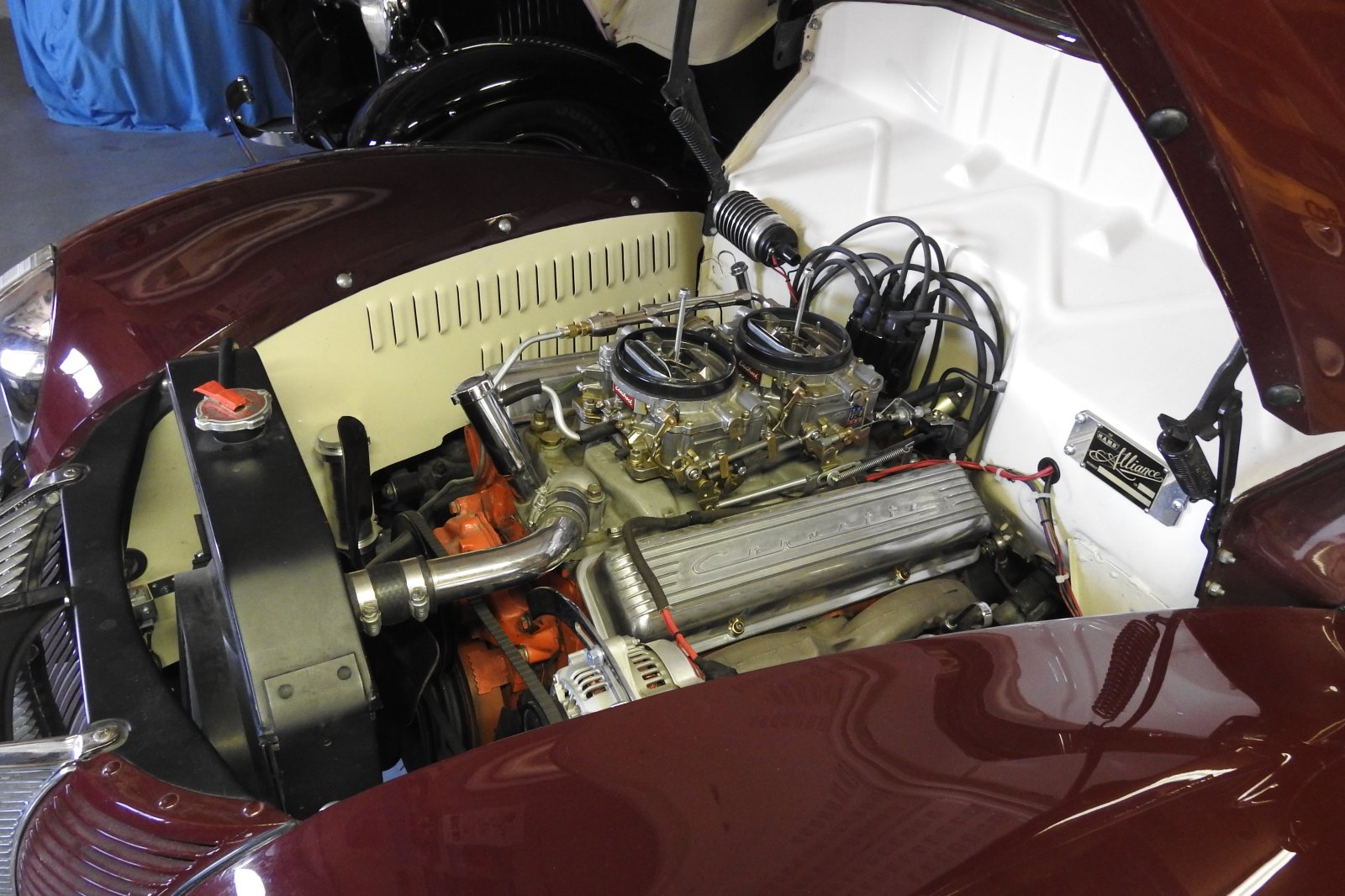

  5. LOU WELLS
    Joined: Jan 24, 2010
    Posts: 3,347
    LOU WELLS
    from IDAHO
    The 39 guy and PONTNAK123 like this.
