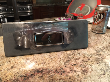

    This is a fun little project I did last weekend, I added a 41 mercury clock to the glove box door on my 41 PU, a cut that I could have made with a drill and a dremel but not a band saw, torch or cutoff wheel. Again, it took seconds. I could have got those corners a bit tighter, should have practiced on some scrap metal but a little body work will tighten it up. The grinding marks are from the studs I welded through the door to mount the clock and removing the factory knob holes. The diet root beer is from another project that includes Captain Morgan's rum.
