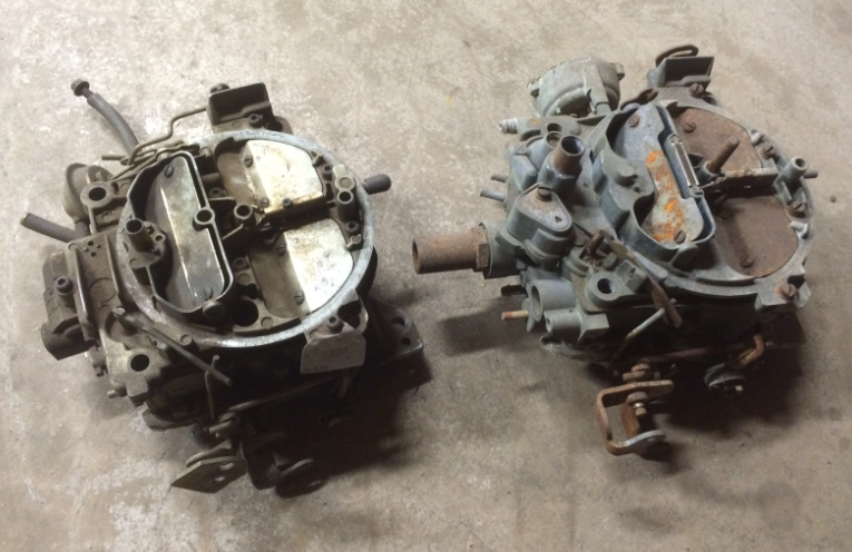

    To the OP - The one on the left has promise.
    Bandit Billy - If the OP's not interested, shoot me a pm with the part #. I might be.
