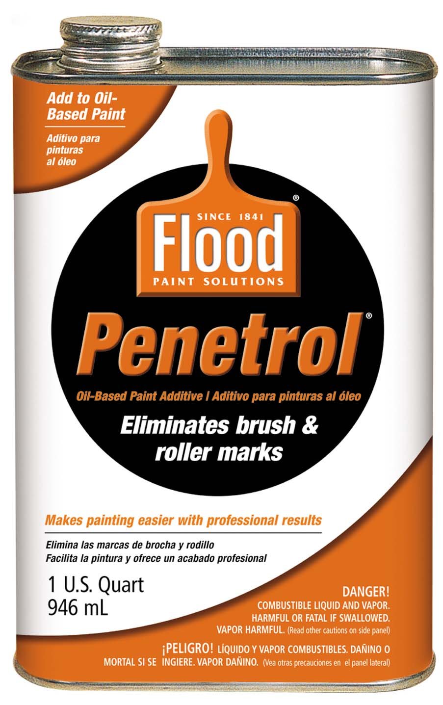

    I have heard of folks using Penetrol

    If you’re going to paint eventually don’t use an oil based product, think fisheyes…
    I think I would try a metal or aluminum prep…
