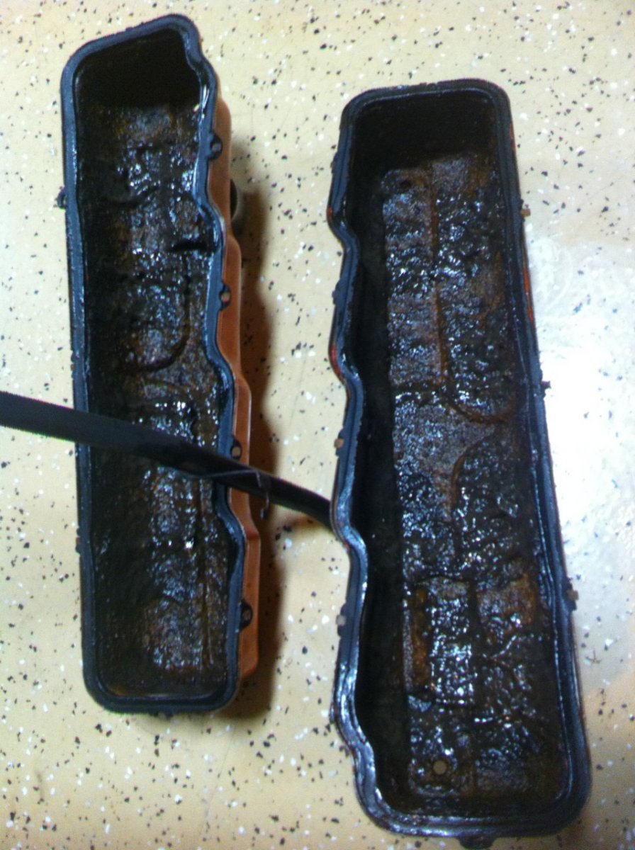

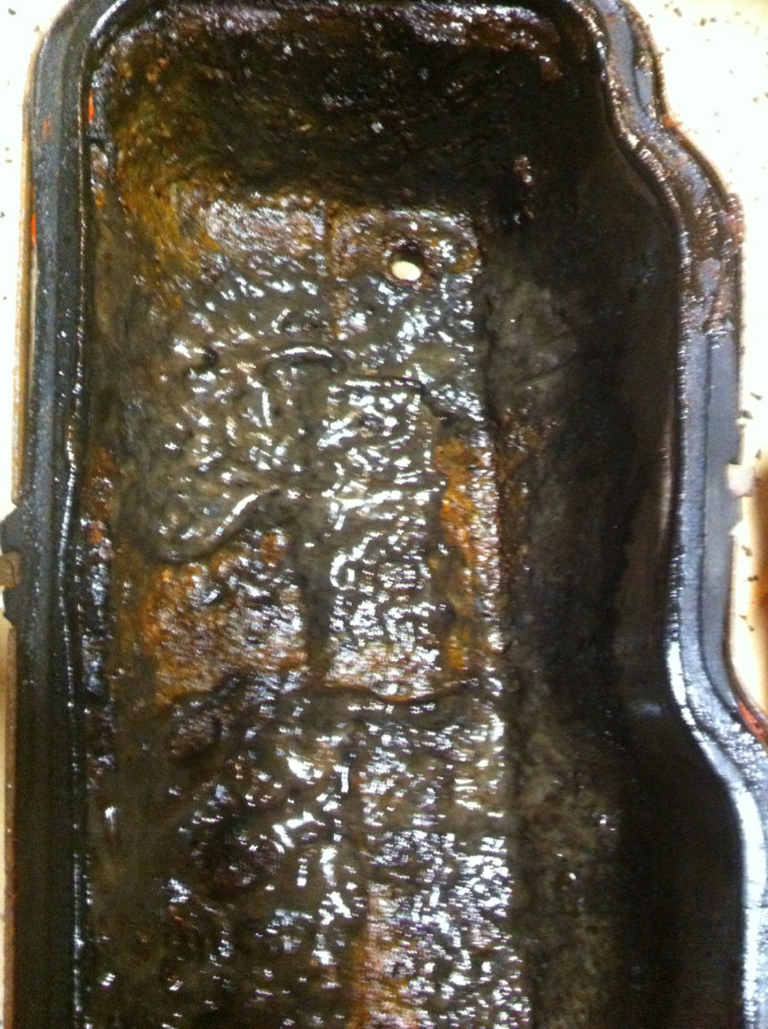

    Ok, getting a little confused since I'm reading soooo many different opinions on engine/parts degreasers...
    So I will show you my valve covers I removed yesterday & what ideas each of you have to degrease & clean these nasty SOB's.... 59valve covers.jpg 59valvecovers.jpg 59valve covers.jpg 59valve covers.jpg 59valve covers.jpg 59valvecovers.jpg 59valve covers.jpg 59valvecovers.jpg

    Greetings, if I were doing those: I would start by putting some cat liter in and soak up wet oil and get down to the stuck on crud, this will reduce the amount of liquid waste. Then I would keep them wet with wd40 during the day and let it soak over night. Then I would hit them with a strong degreaser. Out here in Oregon we have a store called "cash and carry" they have a red degreaser that I use, I have used most of the other and they work as well. I would pick one and go for it, weaker degreasers will still work, it just takes longer.

  4. Docwhit...........nice set of 318 Plymouth Poly valve covers........and whats so hard about it?............I'd get a few paper towels or even a heap of toilet paper and wipe out the covers first to get rid of as much as possible then use mineral turpentine or WD40 or even straight petrol, anything to soften the crud first then spray a good brand of water soluble degreaser and stir the pot or covers with more degreaser and an old paint brush...........after its nice and runny then I'd hit it with a hard water jet............I would expect to repeat this a few times, also replace those valve cover gaskets, they will be ****..................ideally don't do this underneath the wifes just hung out clothes line or wear your Sunday go to meeting clobber, the older clothes the better..........lol.........either way from the condition of these covers I'd say that you haven't done an oil change in a while..........just think what the sump will have in it.............lol..............btw is this why you intend to put the hemi in the Coronet?.............andyd

    If those valve covers came off your running engine, you may be in for some engine work. Sludge may be taking it's toll by blocking oil flow through p***ages. Looks like you may have some water mixed in with the oil too?
