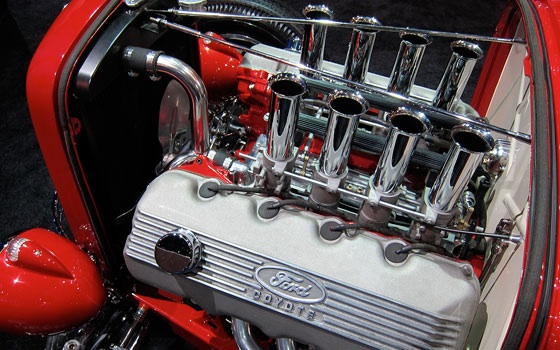

  19. Took a while, but you can finally get a ford engine looking good again with a bit of effort.
    Might blow your budget
    low-n-slo54 and Montana1 like this.

  21. There's just no way to beat a 5.3 swap,
    except on a traditional board
    Or if you actually want to look at it:)
    If those 2 aren't important a 5.3 swap is hands down the best.
    That coyote engine will be the swap fav of the future though IMO & They are in trucks as well, 30 less hp and way cheaper.
    It will fool you unless you are really paying attention.
    I doubt anyone here would have a problem looking at one
    There's always the northstar, and it looksright at home in a fenderless car with a bit of dolling up.
