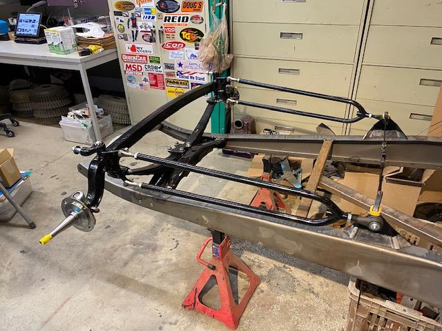

      175.2 KB
      220

    The speedway one above is far from ideal ,but thats what you probably get when you want a “kit” . Longer is better and the frame mount on the same side as the steering box.
