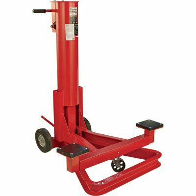

    I'm thinking about a lift. For years I've been using a portable air/pneumatic Fisher lift (looks like this one). My garage has one bay with a real tall opening & door, but about 9ft wide. Looking at lifts it looks like not expensive. What's the best for the money? The drive on ramp ones would be good for low clearance car (new Mustang).
    Thanks, advice.[​IMG]
