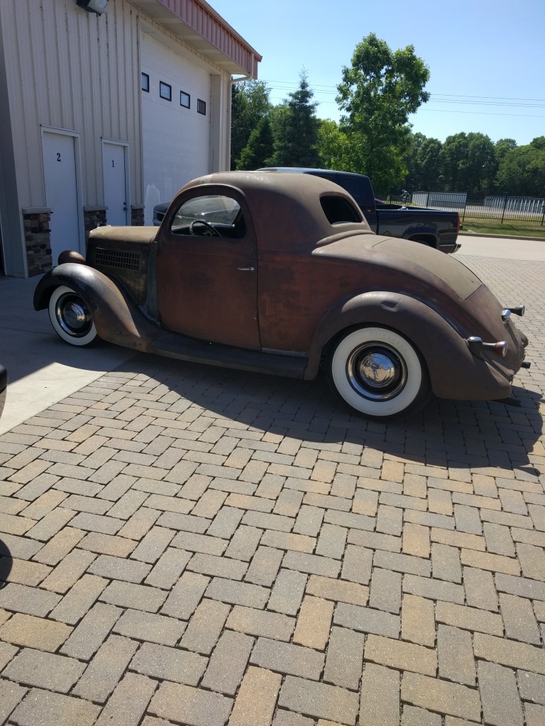

    1104sr_07_o-1936_ford_business_coupe- (2).jpg Big and little's rims 16x5 ,tires front 55ox16 and back 750x16. The brand Firestone or any other black wall brand you like.

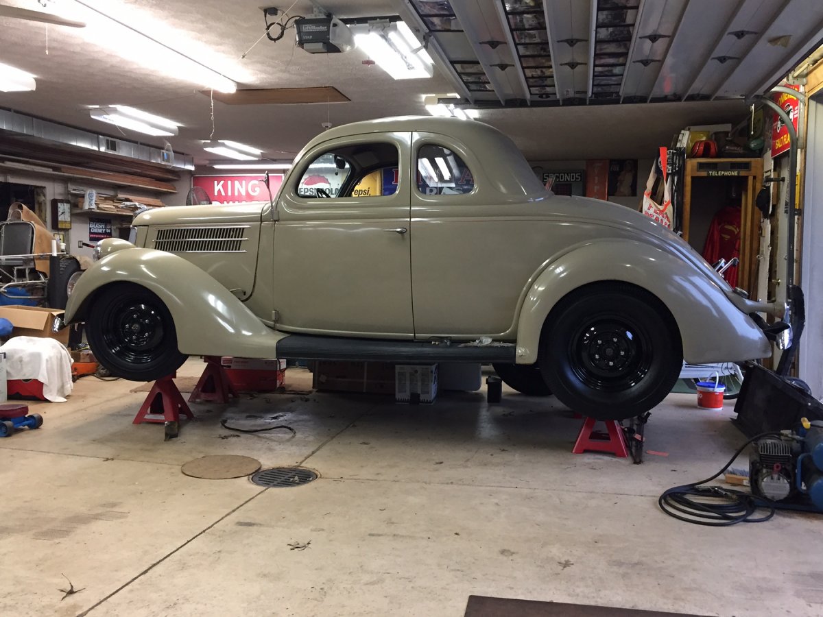

    I have Firestone 8.20-15 on 6" wheels for the rear along with 5.60-15 on 5-1/2" wheels front.
    If you are looking at radials :eek: , no picture; but Cl***ic 165/80r15 & General 215/85r16 work after a fashion.

    Thanks ....a couple of nice looking coupes there...great stance and tyre/arch fit.Is the top one Amory Green by any chance?
