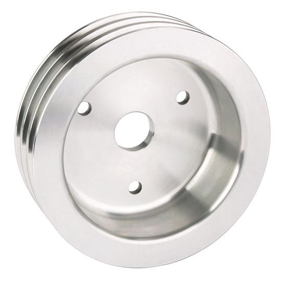

    I'm toying with the idea of using a 6/71 just like that. Would stock type pressed steel Chevy multi-groove pulleys work, or would it need aluminum ones machining up?
    Or..
    Speedway sell aluminum triple pulleys for $38, might be an idea.
