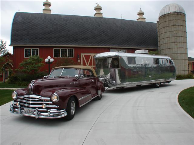

    You mean shiney like this? :D It's hard, dirty, work. Google 'Nuvite' polish, it's what I use. Also go to "Perfect Polish", and then, buy the stuff you need from "Vintage Trailer Supply". They'll hook you up!
    Nice caravan, BTW. I like the little fenders.
    Brian

    Forget about Zoopseal, it'd cost more than your caravan. Just the polish alone is good for at least 2 seasons here in Michigan.

    I'd be so pissed if I got stuck behind that thing at night , the glare would be murder.

    That Trailer is awesome Brian, would love one like that one day, i'm happy with my new purchase for now though, the fenders are a nice touch.
