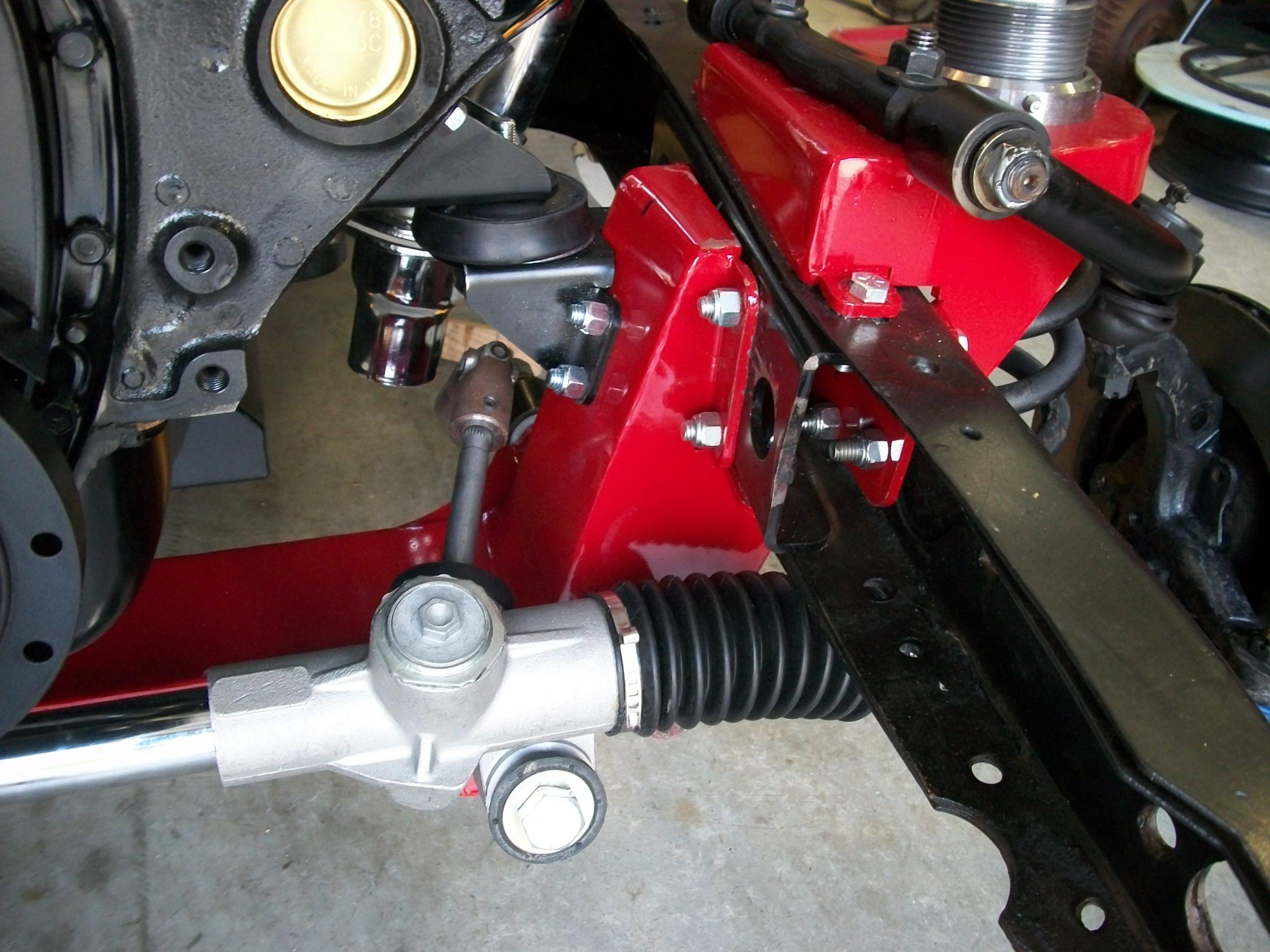

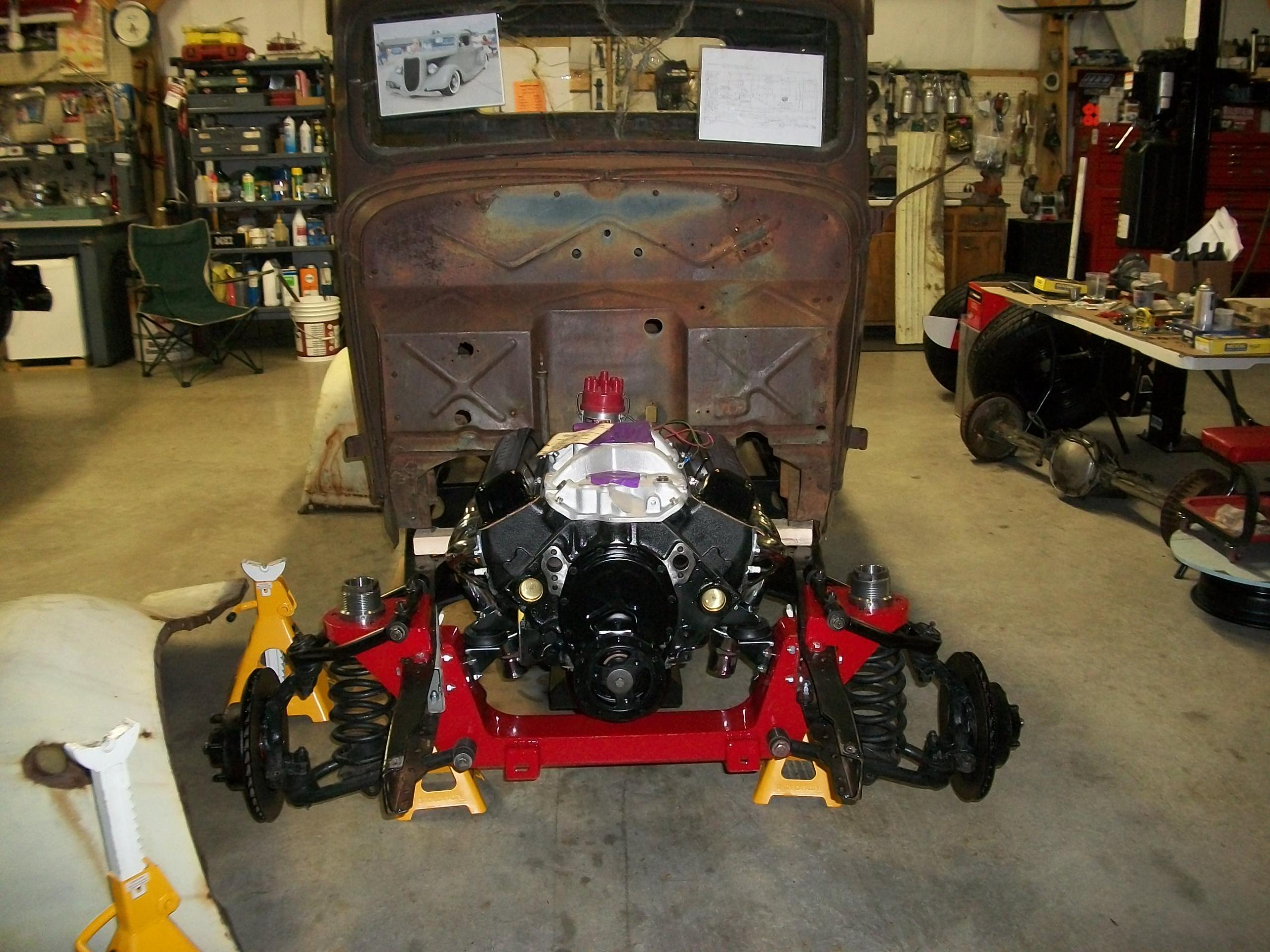

    Here`s the Speedway bolt-in on my `36 truck but I gathered all of the other parts seperately.
    Would not do another bolt-in as it`s much quicker to weld in and the Speedway was $300.00 higher as a bolt together.
    No it`s not prepainted....
