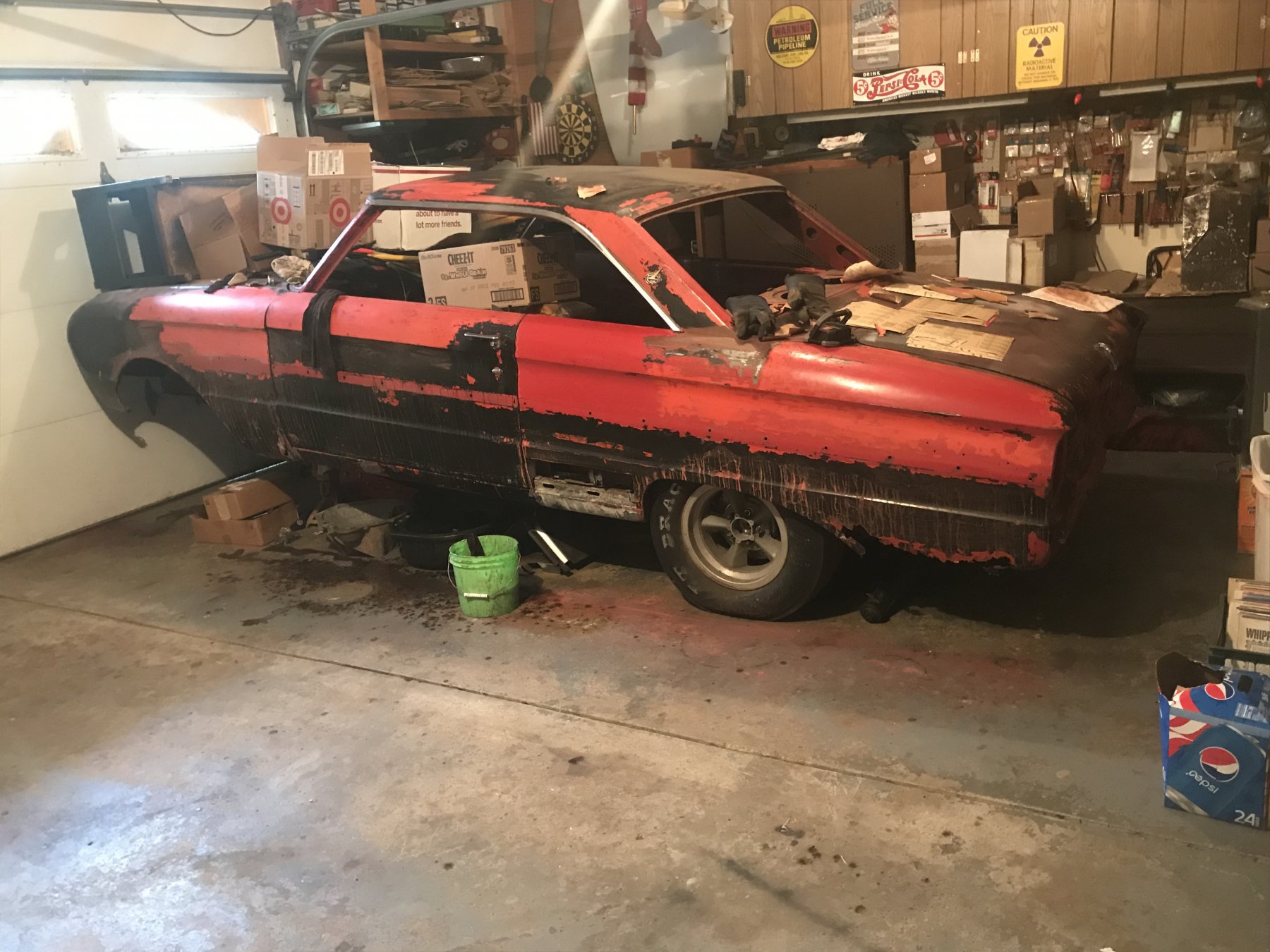

  1. I’ve been messing with my 63.5 Falcon lately and the last couple of nights fooling with the paint. Car is a Rangoon Red under brush painted black And a long long ago sprayed Orange. I used oven cleaner on the black a few years ago and was able to get get some black off but the orange seemed to be bonded too well. I had used a razer blade on the top of the rear drivers fender to remove both orange and black but I was seriously damaging the remaining red underneath. Then I said screw it and hit the black with 150 grit then 320 on the orange. Because it’s what I had and wasn’t thinking too far ahead. After I realized the the Red under all that crappy paint might look good acepting all the dings and stuff I hit the quarter with some wax and was surprised at how good it seemed to look. At that point I realized I needed to rethink the process to get rid of the Black and Orange and then maximize the remaining Rangoon Red. So that is the basis of my question. Even with the 320 I proved to myself I could get theough the Orange and leave maybe enough Red to do something with. That said I need some grit advise for those layers and then suggestions for color sanding or polishing the Red to best effect.

    I cant tell which pic is which in the progress, looks like an old bank robber movie when they paint the get away car with water base and drive thru a car wash. :D

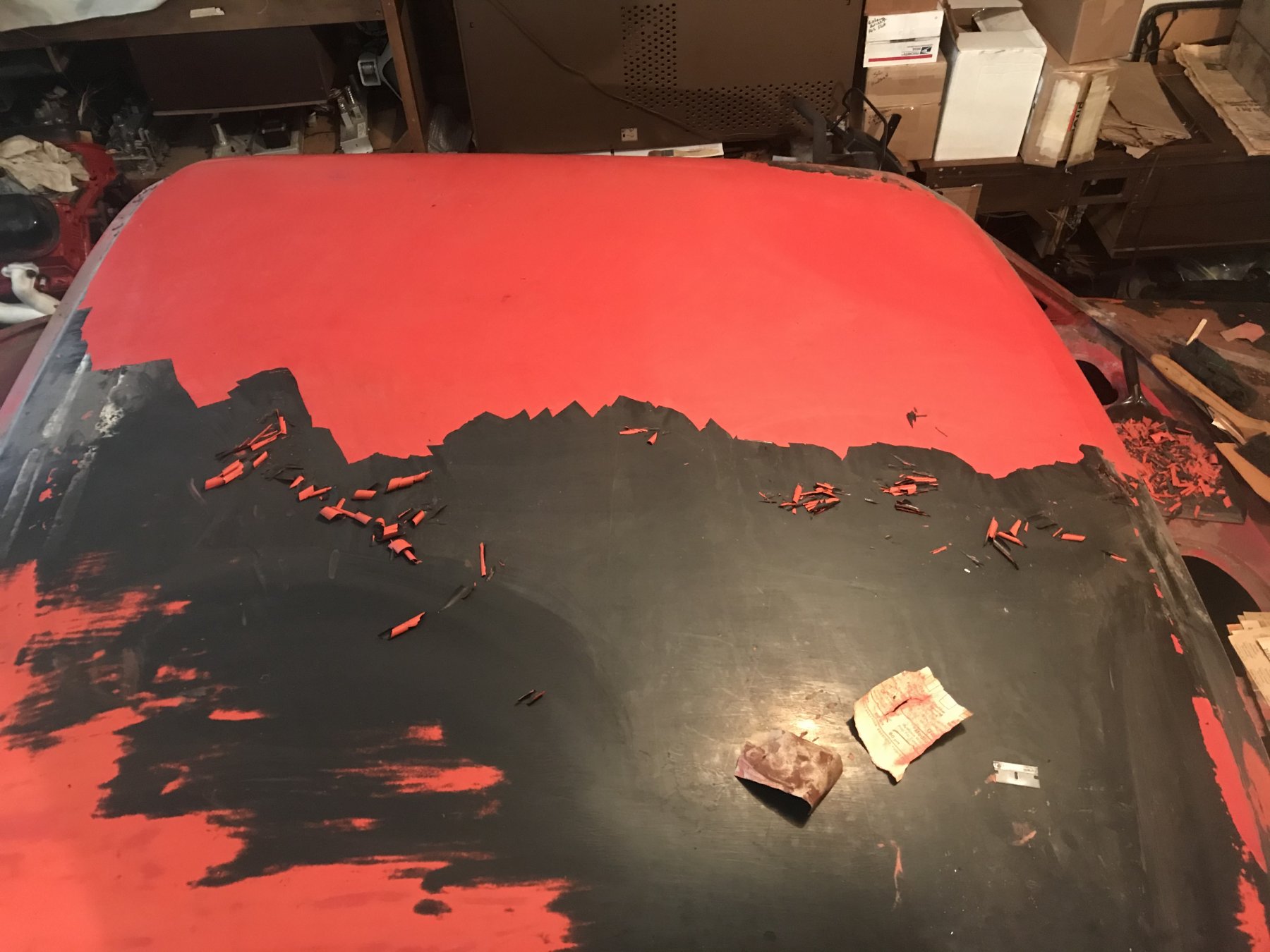

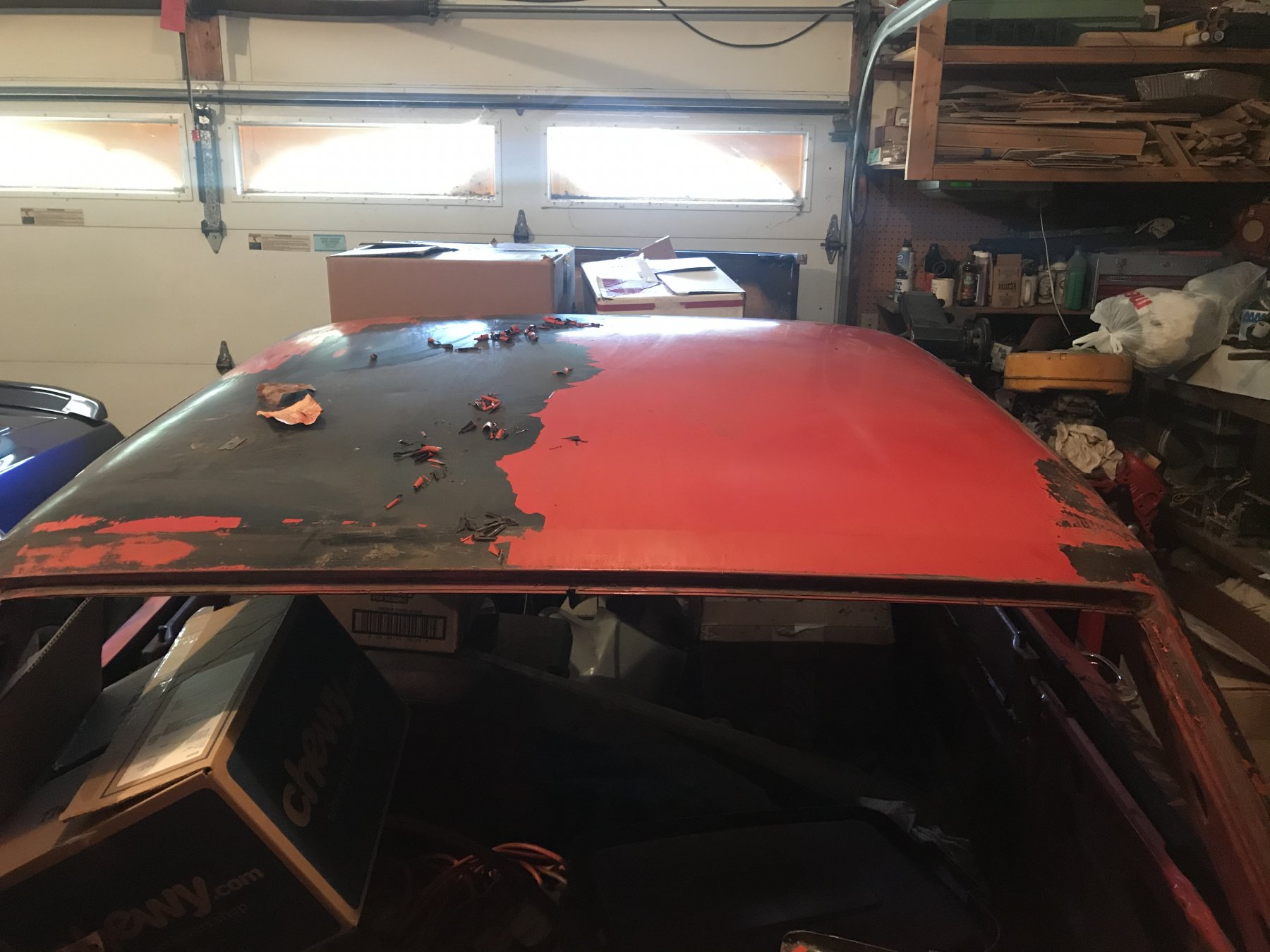

  19. Got backhome last night and hit the passenger sife roof with a razor blade and realized it was taking both black and orange layers off nice and clean. I had long ago used some oven cleaner on the passenger side with limited success but I bet these two layers came off easy because of that earlier attempt. It looks like they just lightly scuffed the original red and then sprayed the orange over that with no primer. Anyway those layers came up pretty easy. Took about 30 minutes to get that half done that far. I’ll be careful around the edges though. Will see how the other half goes . Had a lot of pulls where I was getting 6-8 inch sections that would just peel and curl right uphad a few foot plus curls so it seems to be going good on the roof.

    If you can get it all off, and then just blend in the bad spots or areas where you have to do repairs, I say why not? You'll have to strip off that black and orange to repaint it anyway, so really even if you end up repainting the car later on you're not wasting any effort doing it this way. And if you can get some years of use out of it with the old paint mostly intact I think it's a great idea.
    If you hit some tough or difficult spots, it probably wouldn't hurt to do the oven cleaner again, even if it's only to soften up the top layers.

    from that last picture, it looks like you may be on to something.........
    Keep us updated please !
