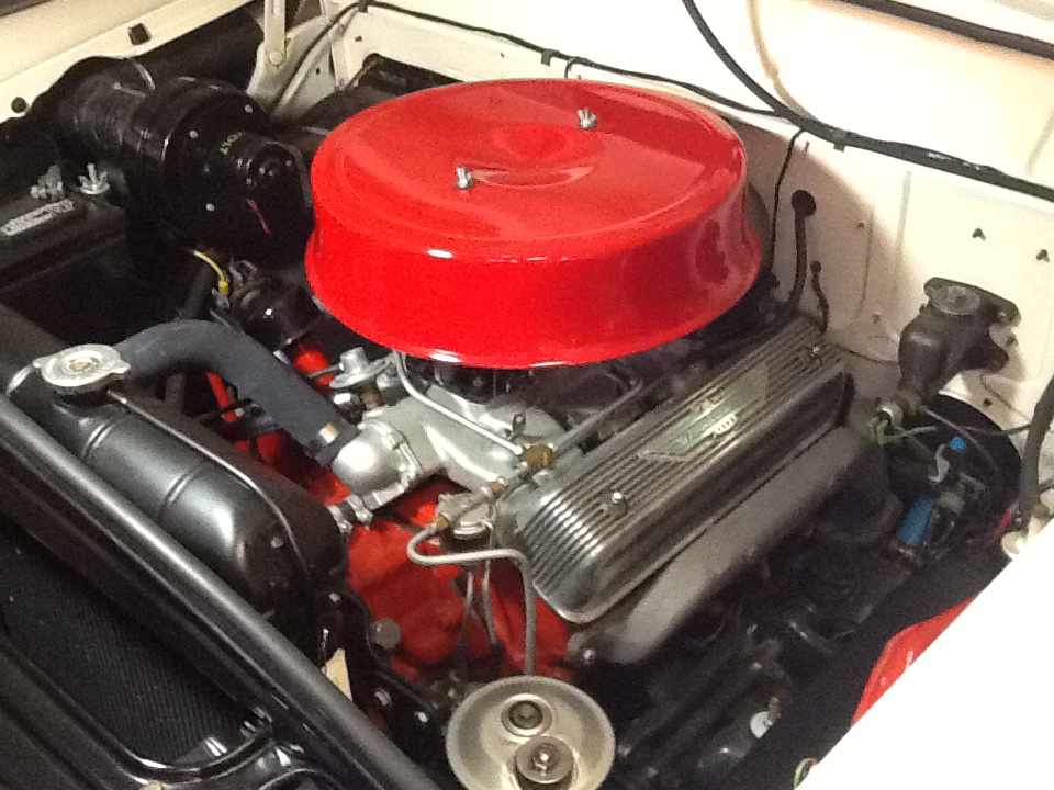

    The best clear I have ever found is U-POL Clear #1 UV Resistant in an orange and silver can. I found it at an automotive paint store in Fountain Valley Ca. It's $25 a can. I've used it over many brands including Krylon and Rustoleum on stuff for my wife's garden which is outside 24/7 and after years the garden art still looks new. The air cleaner in the photo has this clear on it.

    Thanks jimmy six......I'll try to find the U-POL Clear locally....looks like it will work for me...:cool:
