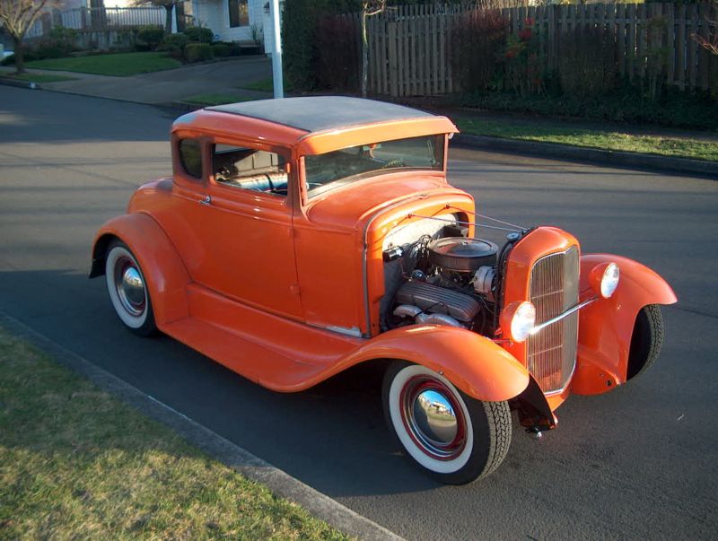

    I used a Halibrand quickchange cause i like the look on the back showing the whole rear on an A.

    Drhotrodmd..thats a bad ass A.!!
    always liked that car, like it more now..

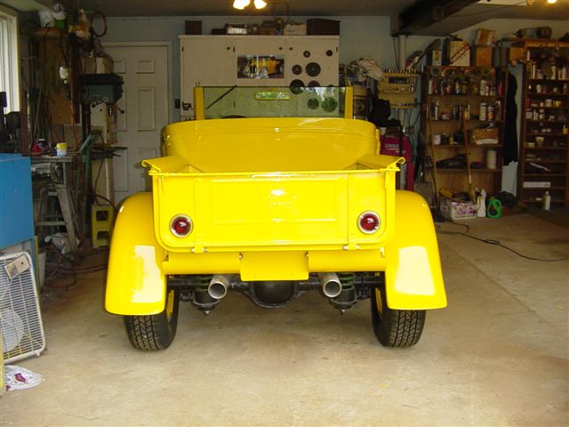

  19. I have used a 76 Granada with an 8" rearend and 3.55:1 gears in it. This is a really potent package, but hard to find. The attached picture shows the rear of my roadster pickup with a 1988 S10 two wheel drive rearend in it---good strong 10 bolt Chevv rearend, and 53 5/8" from wheel mounting face to wheel mounting face.---using stock 7.5" wide chev rims.---Brian

    briangus, i wonder if being a pick up bed insted of a tudor body makes any difference?
    I have the same rear in my 53 chevy, it is a good rear end and easy to come by.
    I'll have to see if the different body style has an impact on how this rear end would fit up and look like
  21. I honestly don't know how it would work on a sedan body. Logic tells me they should, since model A rearends were all the same for sedans, coupes, and roadsters and roadster pickups, and that is a stock width box. If it was me though, I would try and measure the distance over the body at the highest point on the sides of the car and compare it to the width inside the tires.---I am running P235-R75-15" radials, and I just ran out to the garage and measures 45" inside to inside of the tires at the narrowest point (bulge of the tires).
