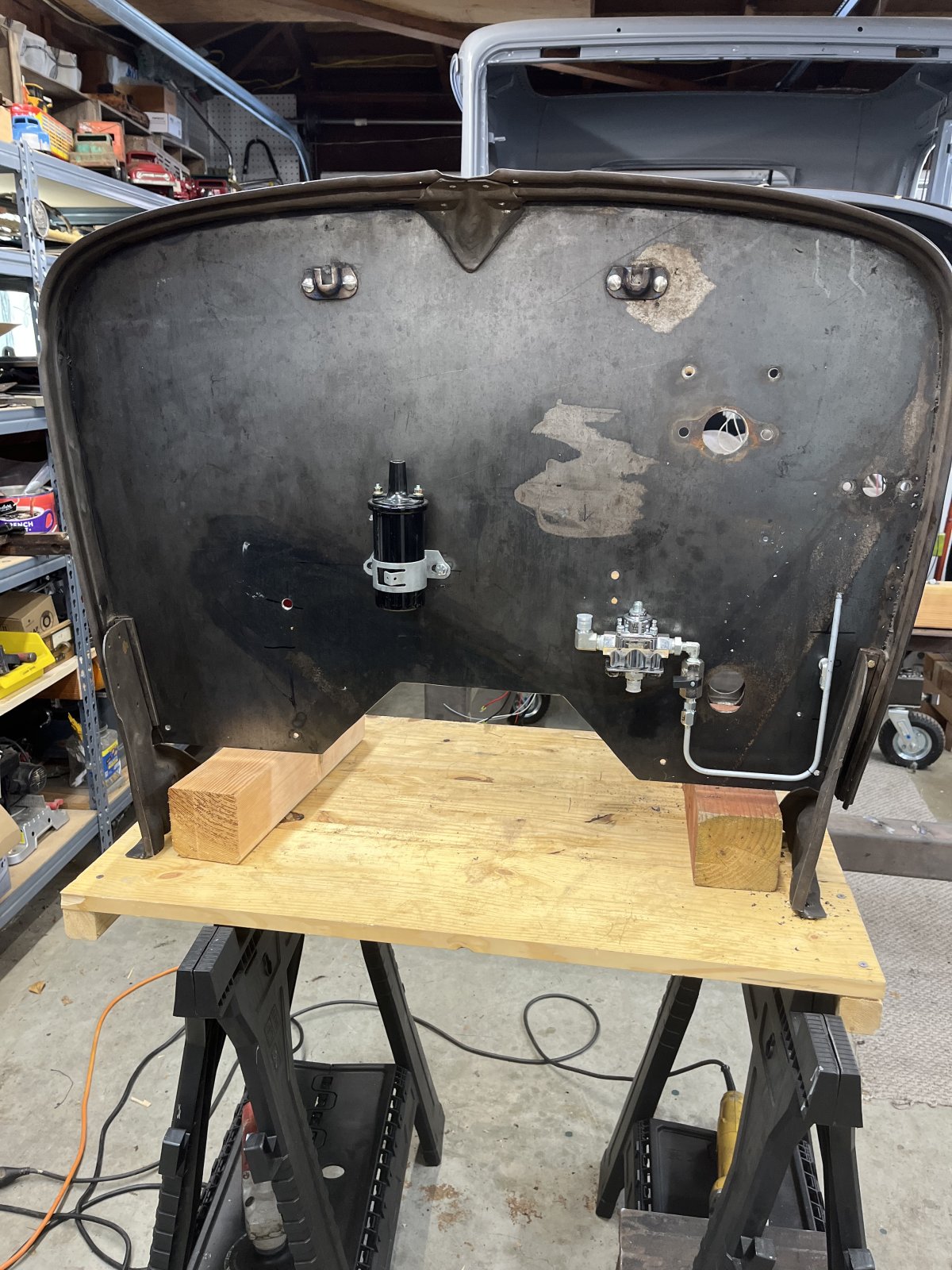

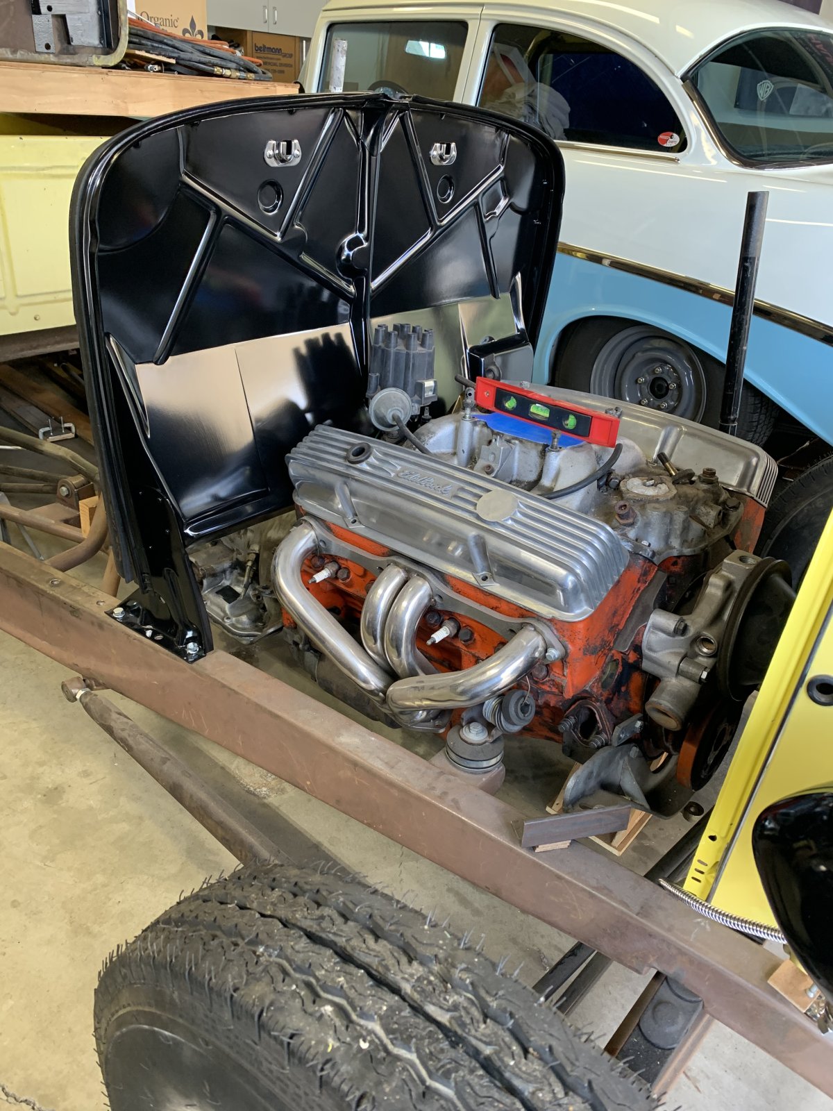

    Find a beater fire wall with the proper body flange and build a flat fire wall IMG_5522.jpeg IMG_4958.jpeg

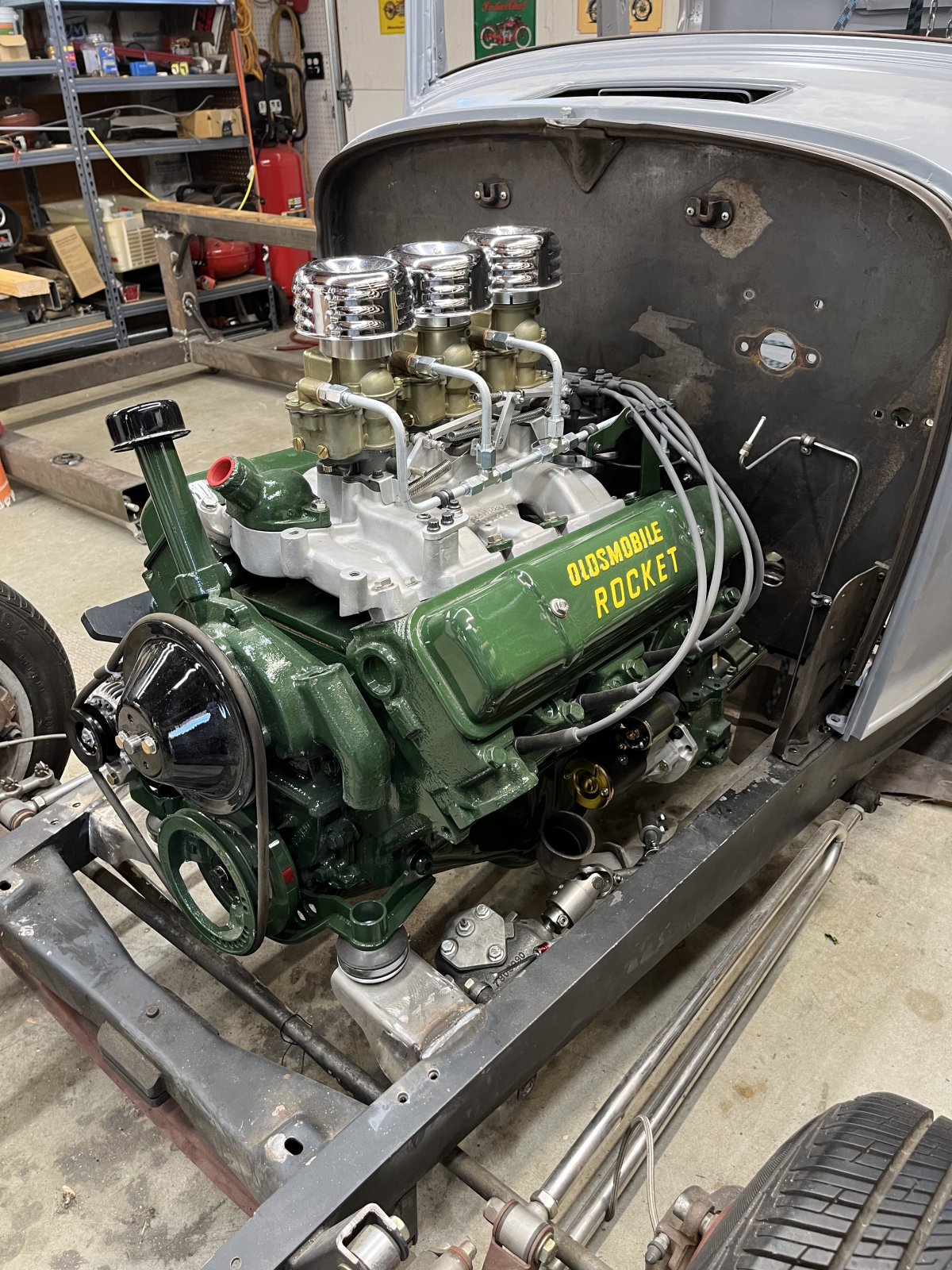

    If you seen this one. History, flattened in the 70’s then cut in the early 2000’s and engine was set back. I brought engine forward and rebuilt firewall with what was left. That’s why it’s missing 4 dimples. 07BC4A00-86EA-4F18-8B78-9A4B06BA2C79.jpeg
