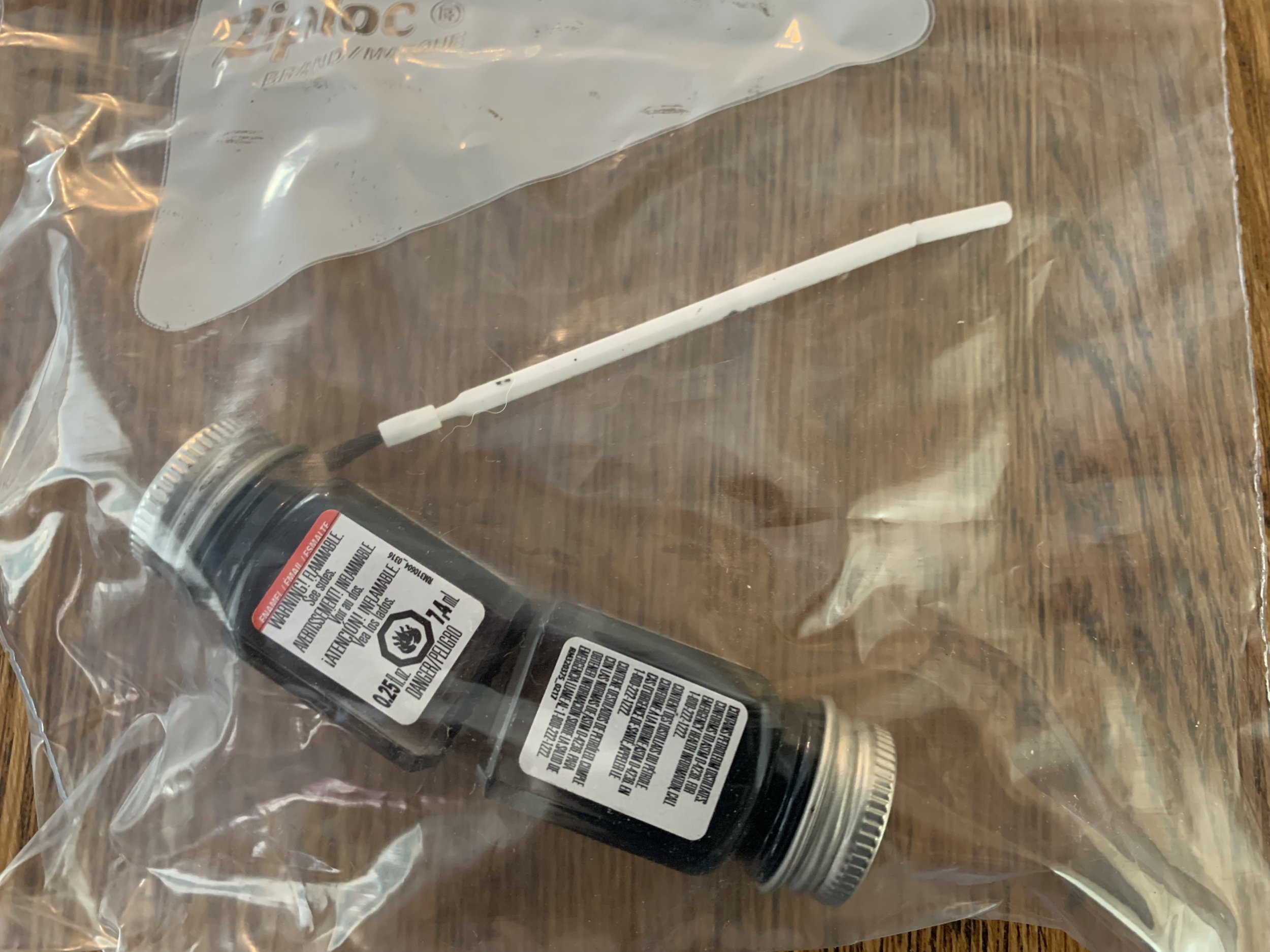

  7. 5window
    Joined: Jan 29, 2005
    Posts: 10,019
    5window
    Can't read the labels-what is it?
  8. Bandit Billy
    Joined: Sep 16, 2014
    Posts: 16,144
    Bandit Billy
    Testers model paint. I can almost smell the glue from here.
    5window and Just Gary like this.
  9. RockyMtnWay
    Joined: Jan 6, 2015
    Posts: 672
    RockyMtnWay
    It’s enamel.
    When I want to thicken it up, just shake it up and let the lid sit for a bit and then dab the paint that’s thickened up in the lid.
