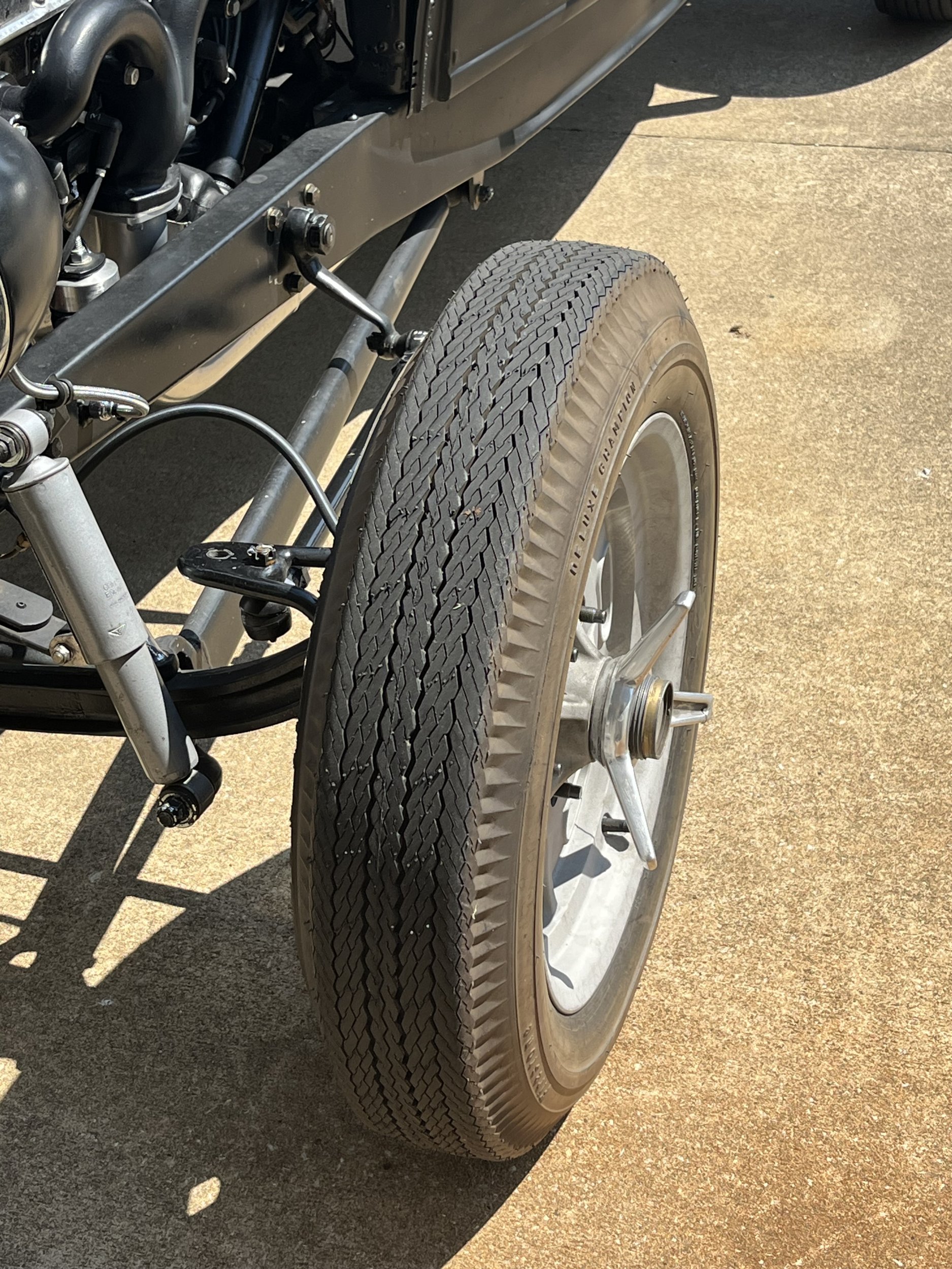

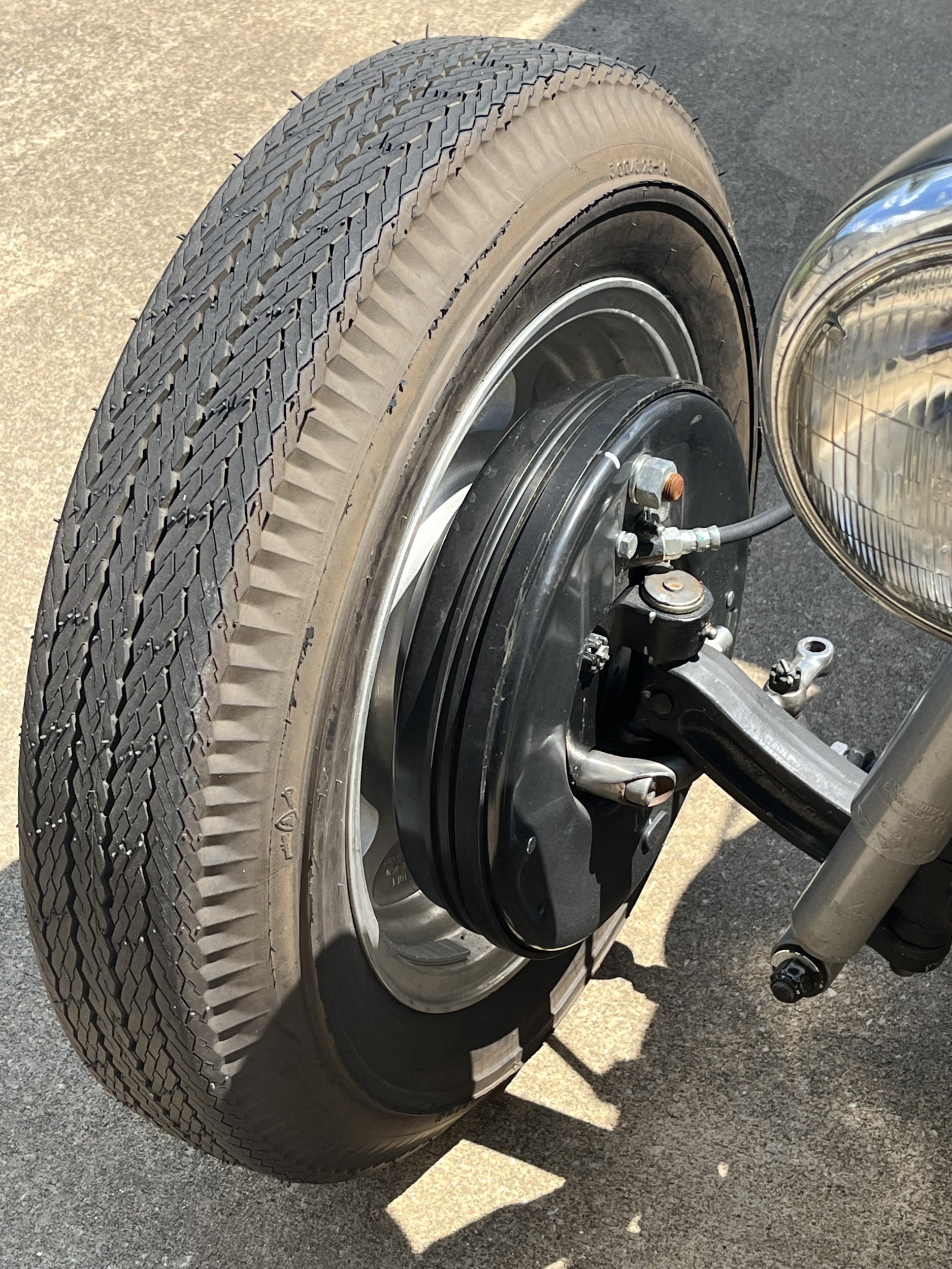

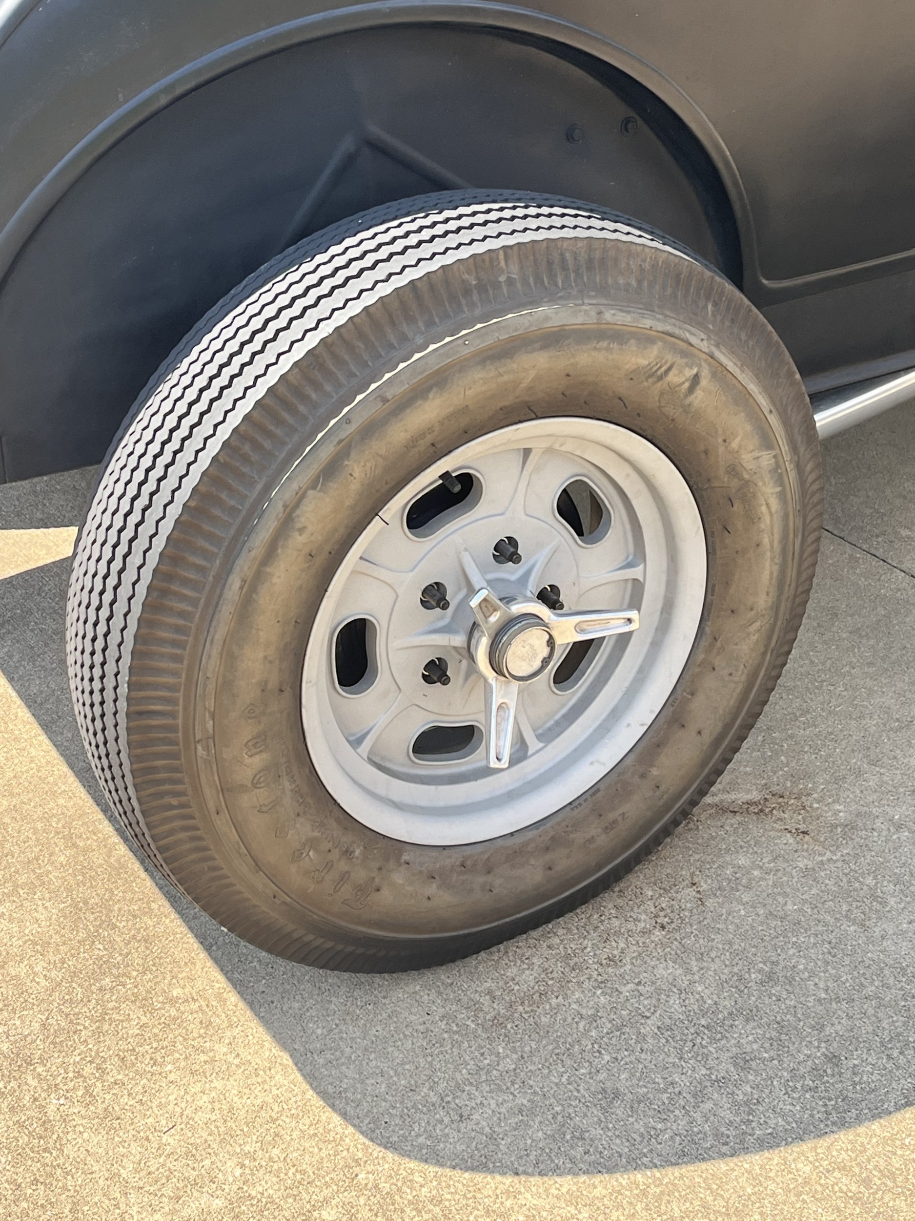

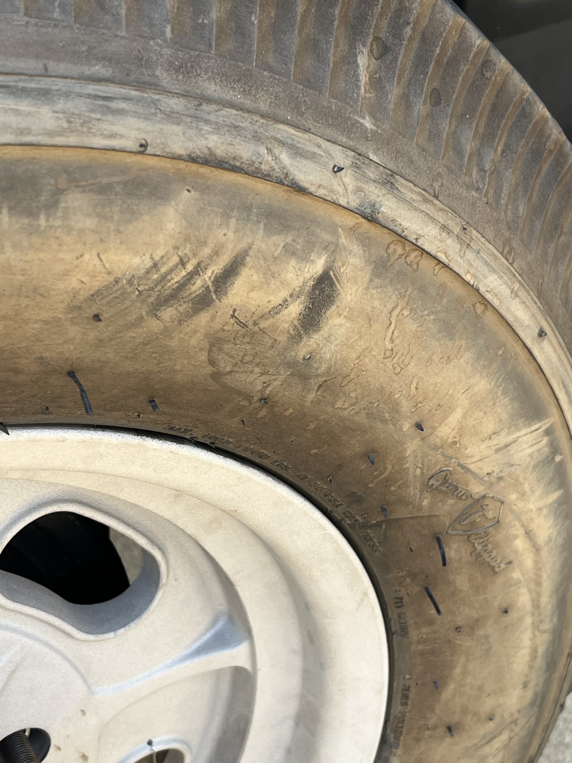

    I’ve got some Coker bias ply Firestones on my coupe. I love them. But, they are turning a nice uniform brown color. I assume that it is surface oxidation(?). Not sure how old they are. No cracks, no problems, they drive great. The fronts are newer than the rears, but they have the brown discoloration too. What’s the best way to turn my brown tires black again? I’m hoping that they can be dyed. I’d rather not have greasy lotion all over them…. If it is a product that I need, please recommend a brand and a source.

    Photos added to original post. So just for clarification, Westly’s Bleach-White works on a non-white wall tire?

    The browning is called blooming and is caused by antiozonants, chemicals that rise to the surface of the tire rubber to protect it from degradation due to ozone and UV exposure, get some Naptha at your local Ace Hardware or Home improvement center, put it on a rag and wipe the tires down the brown will disappear. HRP
    jet996, ***Area-51*** and hotrodA like this.
  16. Choppedcoupe
    Joined: Oct 17, 2016
    Posts: 251
    Choppedcoupe
    That sounds right!-they are more brown with every minute they are in the sun! I’ll give that a try.

    Bleche -white did pretty well, but I had to use a Scotch bright pad and probably went over each tire 4-5 times. The pie-crust edges were very tedious. I’ll look into that MacGuires cleaner next. But, Ive got black tires again. Thank you HAMB.
