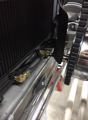

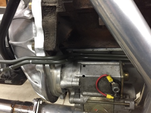

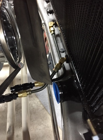

    I've been asking this same question and a few others about trans coolers to local shops and on a couple other web groups. Here's what I decided to do.
    Running the cooler in the bottom of my Walker Cobra radiator, period. If it runs hot I can always add another cooler in series pretty easily.
    I ended up using 5/16 hard line except about 9" or Fragola PTFE braided and coated line for a flex section. Still needs some clamps and hangers but I have it roughed in now. Everything is still finger tight right now.
    SPark
    cooler1.jpg cooler2.png cooler3.png cooler4.png cooler5.png cooler6.png cooler7.png
