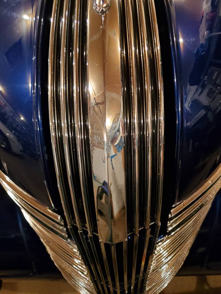

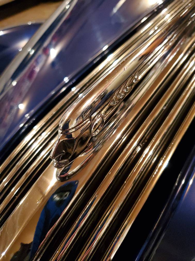

    My 37 Pontiac has similar hood trim. I applied black pinstriping tape in between the ridges. Been on there for over 20 years. You can find pretty much whatever color and width you want.
    Hnstray, Rich B. and loudbang like this.

    Here are some photos of the pinstriping tape I used on mine. 20191118_195035.jpeg 20191118_195113.jpeg
    Sent from my SM-G970W using The H.A.M.B. mobile app
    kadillackid likes this.
