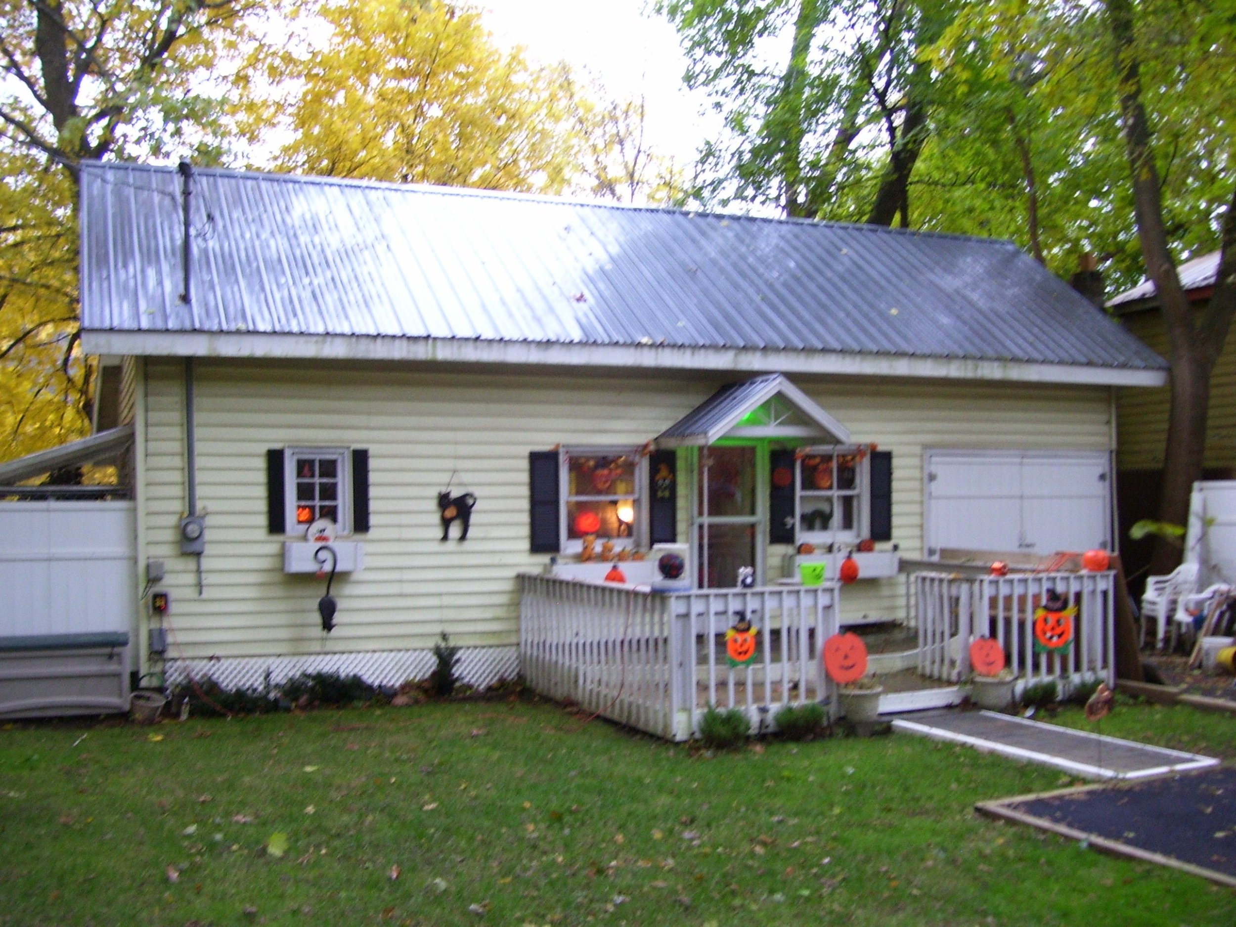

    Yes that's how I did the new roof on my house. Cut 4 sheets at a time with a carbide fine tooth in a skill-saw...and then pre-drilled them, all 4 at the same time.
    Looks like just a boring little house...
