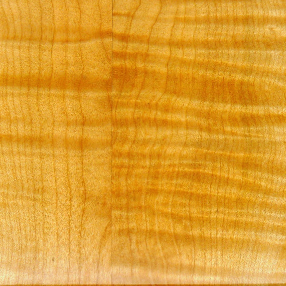

  13. When I was doing antique furniture restorations I loved the look of Tiger Maple wood.
    chryslerfan55 and juan motime like this.

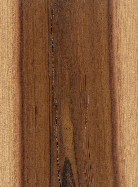

  27. deathrowdave
    Joined: May 27, 2014
    Posts: 4,868
    deathrowdave
    from NKy
    I’m sorry I’ll try this again IPE pronounced ( ee pay )
    Atwater Mike and chryslerfan55 like this.
