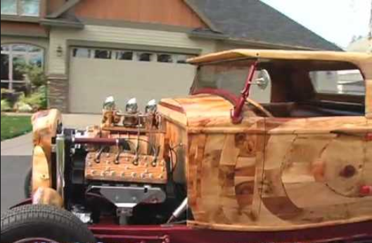

    Supposedly Myrtle trees are only grown in the holy lands and in Oregon. Both have legalized pot. o_O I do not vouch for the accuracy of this statement but it makes it's use unique I would think. Unless you build your entire car out of it. Which has happened. It is pretty hardwood.

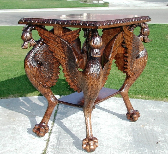

    I carved this table from cherry and stained to walnut. Should have used mahogany or walnut but had a ton of cherry to get rid of. finished in furniture urethane varnish which is a very durable finish too for interior projects but I like the auto paint better for car parts.

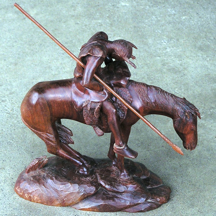

    Carved this End of the Trail statue from walnut. Urethane varnish finish too.

    I haven't seen it in a couple of years, it was a regular at Beaches cruise in every Wednesday night. Was that just a carbureted SBC under the fake wood flathead and blower covers?
    the walnut carving is very nice.you are very talented
