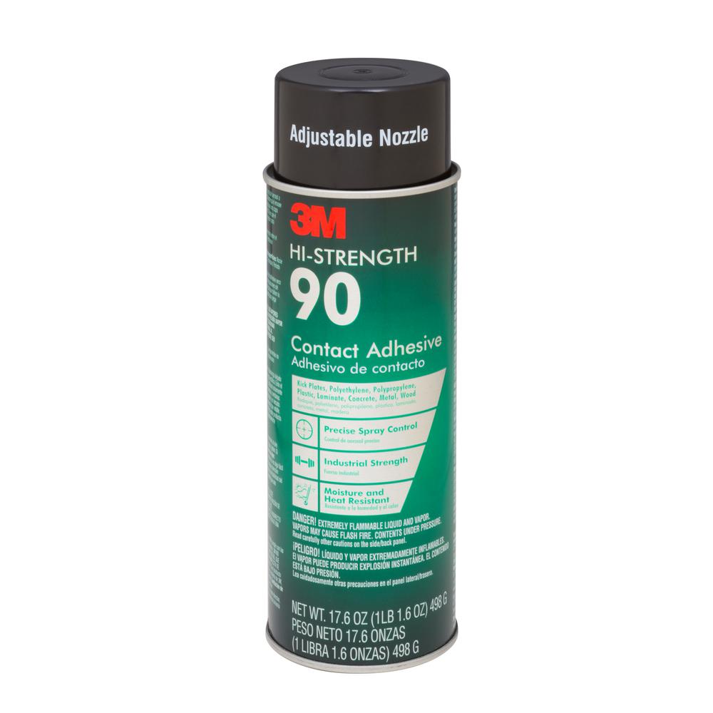

    The only problem I've had with sound deadeners may have been self inflicted (but not intended)-I sprayed my Car with Lizardskin (both heat & sound), them I put Dynamat Extreme over the top of the Lizardskin-
    It worked great- until it didn't- the Dynamat stuck great everywhere except the roof- now, mind you, my Car still isn't finished (unless Upholstery Jail keeps it 6 months it'll finally see the road this Year), but I have an area where it just doesn't stick- (yes, I used the Roller)-
    Thinking of my options, it's either use an Upholstery Shop glue like Dap Weldwood Adhesive, or take out the Dynamat (on the Roof anyway, it's stuck like glue everywhere else)- and possibly apply more Lizardskin-

    image.jpeg This is a good adhesive available at HD.
