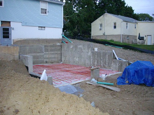

    I know not everyone can afford it but radiant heat in the cement is the way to go. I just finished my 24X30 with heated floors and cant wait to put it to the test. No worries about getting things too close, explosions, or fires. And no more cold feet while your head is sweating or getting down on a cold floor for me.

    I agree with hoggyrubber. I'd say electric is best if open flames are an issue. I have a 220volt electric heater in my shop. I also like Big Jim's option but if the water or glycol is heated by an open flame boiler, that can **** in explosive fumes from the shop work area, that's probably not good either.

    The furnace is in the house over 6' above the garage floor with a fire door between it per local code. A lot of thought went into doing it right. If it was an existing garage I would use forced hot air with the ignition source as far away from the floor as possible.
