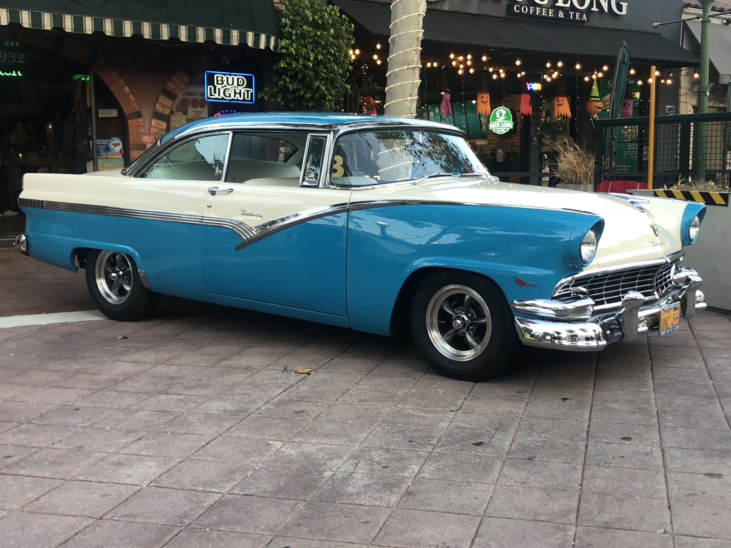

    I would think you like a skinnier rim. I have used 215/75/15 wide whites on both 5” and 6” wide rims and they looked great on both. They are currently on 6” steel. I also had 215/75/15 on 6” Torque thrusts and the fit is good and fills the fender perfect. IMG_7128.jpeg IMG_6758.jpeg
