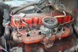

    55 chev pu good 005.jpg 292's have staggered motor mounts as stated, and the fuel pump is at midway on side of block instead of towards the front on other GM sixes of that era.
    Also the block is taller.
    I got one that's goin into a 55 Chevy p.u. that is my next project...
    update: 292 in my 55 up and runnin great for a few years now, not bad on gas but I'm an easy driver
    RustyDogg likes this.

    If ya don't mind, who's flanges for intake and exhaust?
    Thanks,
    -Vector.
  3. Jethro
    Joined: Mar 5, 2001
    Posts: 1,967
    Jethro
    Made my own flanges from 3/8 x 3 mild steel. I used a intake/exhaust gasket for a pattern....there are several people on the "bay" that sell nice cnc plasma cut flanges.

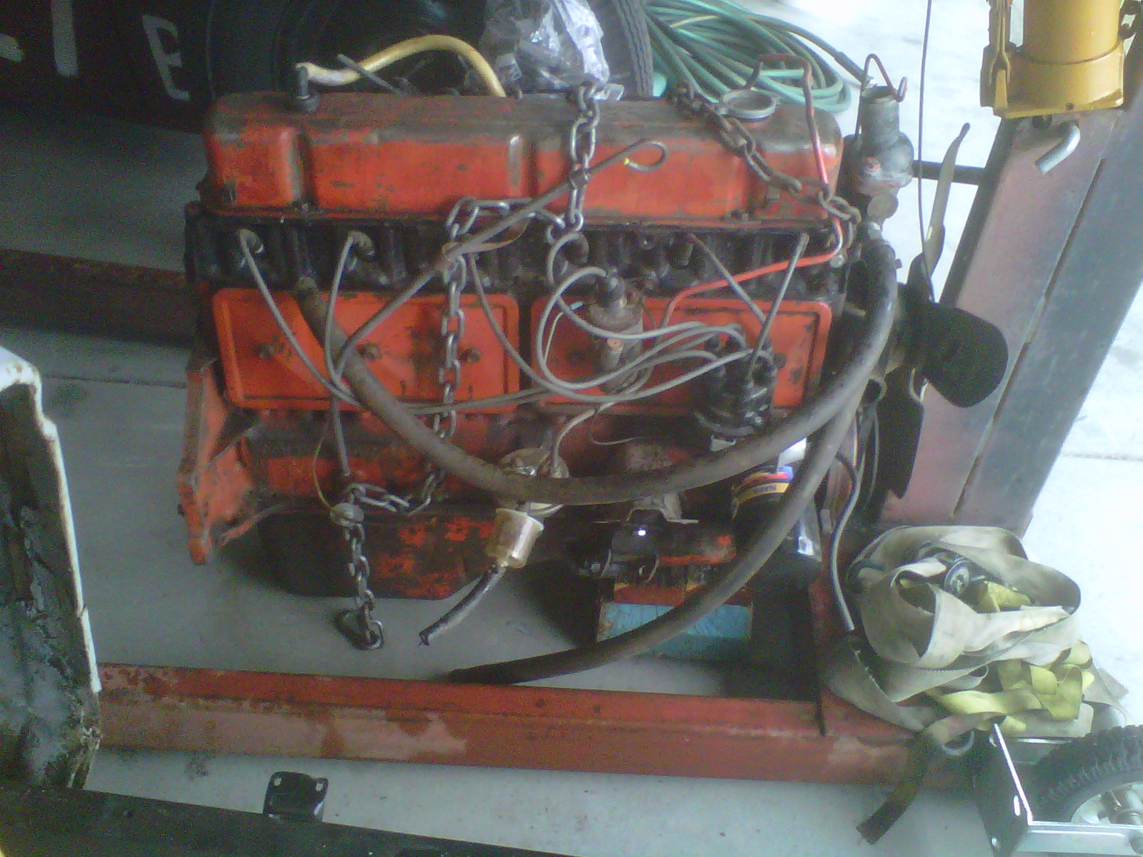

    Has anyone modified a 292 to use the same type of front ch***is mount like on a 235?
    I picked one up yesterday :D and would like to fit it into my '41 without welding extra mounts onto the ch***is if possible.
    I guess I could get a plate machined up to fit behind the timing cover???
    Any advice/help would be greatly appreciated.
    Cheers,
    Mark.

    Your talking about useing a mid. or fornt mounting plate? Many do this to mount the motors into alterds or dragsters.I don't see why you couldn't do it.

    Yes, exactly a front mounting plate. Does anyone have any pictures of how this has been done on a 292?

    There should be four (4) holes, 3/8 x 16, on the front of the block. Two (2) on each side out board of the timing cover for this purpose. Good luck and let us know how it goes.

    Thanks, that sounds like the best solution - I will check it out this weekend.

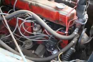

    Had one and sold it. Was in a friends 80 short bed,did better burnouts than the 350 he put in. I'm looking at a 1980 C25 reg cab long bed. Thing sounds mean. Question on it is,should I drill the inside starter bolt out and put a longer bolt in with lock washer/nut? It seems to be stripped and I can't tell if its the bolt or the block...

    Forgot,its a 292/TH400 trans..starter bolts come up from the bottom..
