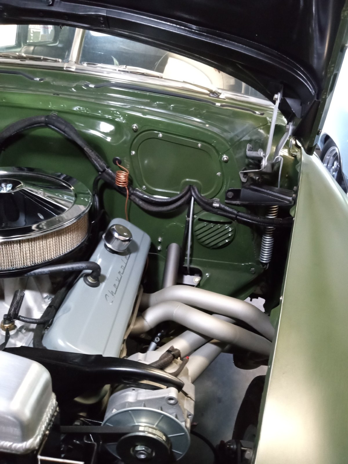

    1950 Chevy Business Coupe.
    Speedway Motors fenderwell headers for 55-57 Chevy. Part # 930C4
    You have to heat and bend the p***enger side collector inward to clear the bottom of the fender. Driver side I didn't have to.
    Firewall is stock and in stock location, but you have to do the normal modifications to install a SBC or BBC in these cars. The triangular ribs that run vertical down to the frame mounts have to come off. The original parking brake ***embly has to be removed. On Big block installation, the p***enger side frame mount at base of firewall has to be notched for the cylinder head to clear.

    Thanks for the detailed answer, I appreciate it

    Thanks for the pics and details, doesn’t sound like too bad of a job. Nice clean looking install
