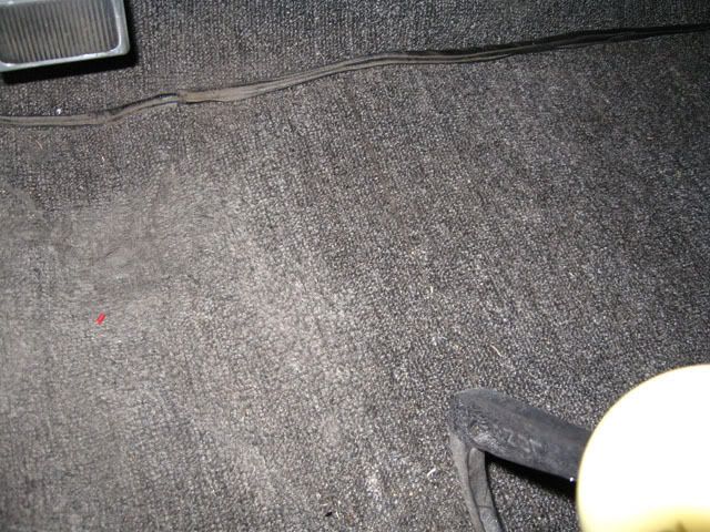

    I have a 427 Chevy in mine, Ill take some pics tonight for you. Just a 4" recess firewall, small hump for a 5 speed, no tunnel. With the radiator in the stock location there is no room for a decent fan. I will move it forward an inch or so next time its painted. And even with blockhuggers they burn the side panels. I run just the top of the hood. Steering is tight with one heim in the middle.

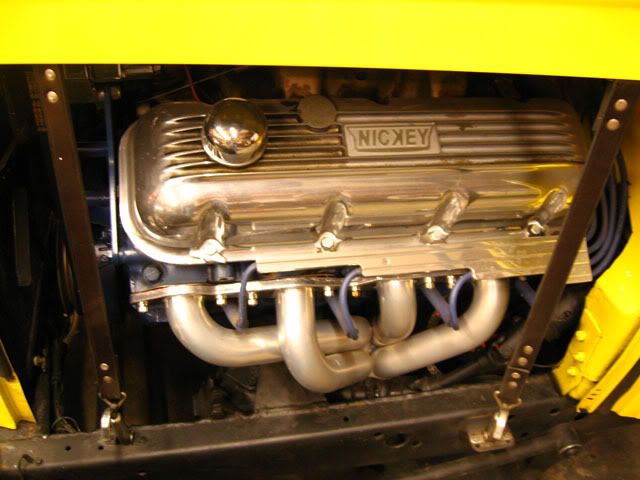

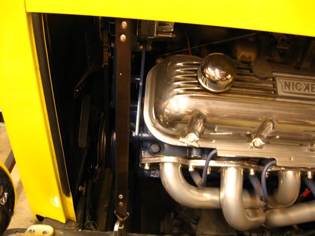

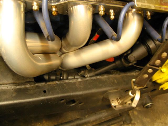

    click each pic for a bigger version
    The hump is very small almost flat floor
    Mines a highboy chopped 4 "
    The front is so close all I can use is a ****py
    flex fan. With http://evanscooling.com It keeps
    cool even in 115 degree weather standing still
    the back could be a hair closer
    The steering is the tightest, stock manifolds would
    probably fit inside the hood sides, these fit but burn
    through a little
    It sits low in the stock heavily boxed frame, the pan is about 4 inches
    or so from the ground. I rarely s****e it and only on huge speed bumps or really steep driveway angles
    Its a 427 chevy with a mild cam and single 4 barrel. It has a 5 speed
    richmond and a 2.8 gear 9inch rear. I like the gearing for the highway because I take it every year all over the midwest. Its real torquey and can start in 1st or second easy and third if you wanted to. The A is so light it just spins from a start and with the locked rearend can be real exciting. It feels like the cam is kicking in around 70 or 75, it just wants to take off at that speed like your standing still.
    Not that I ever drive that fast :D
