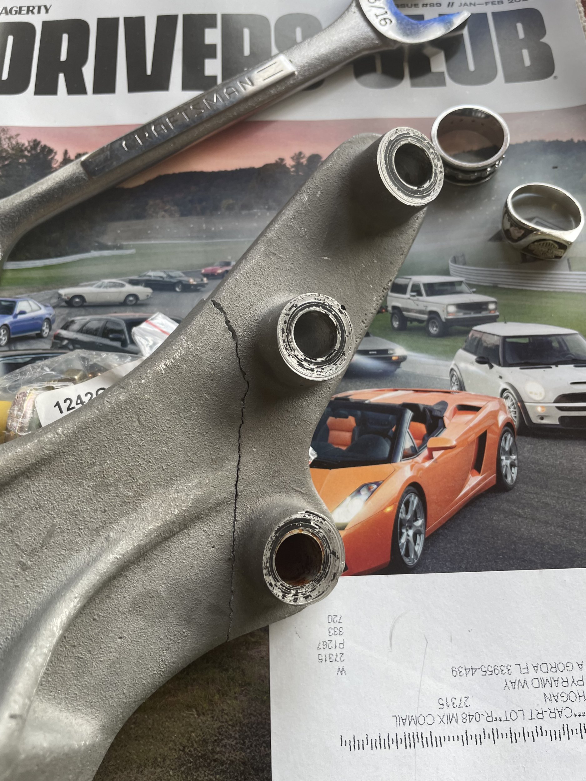

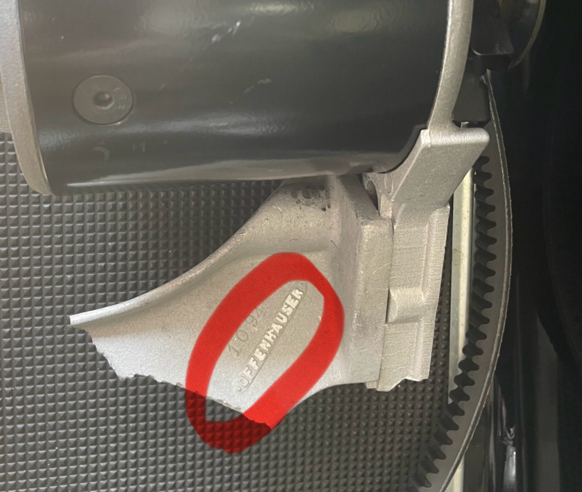

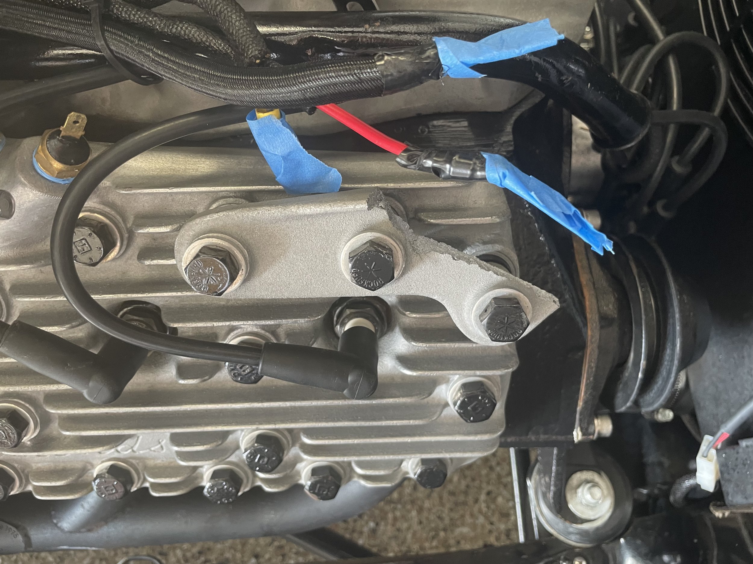

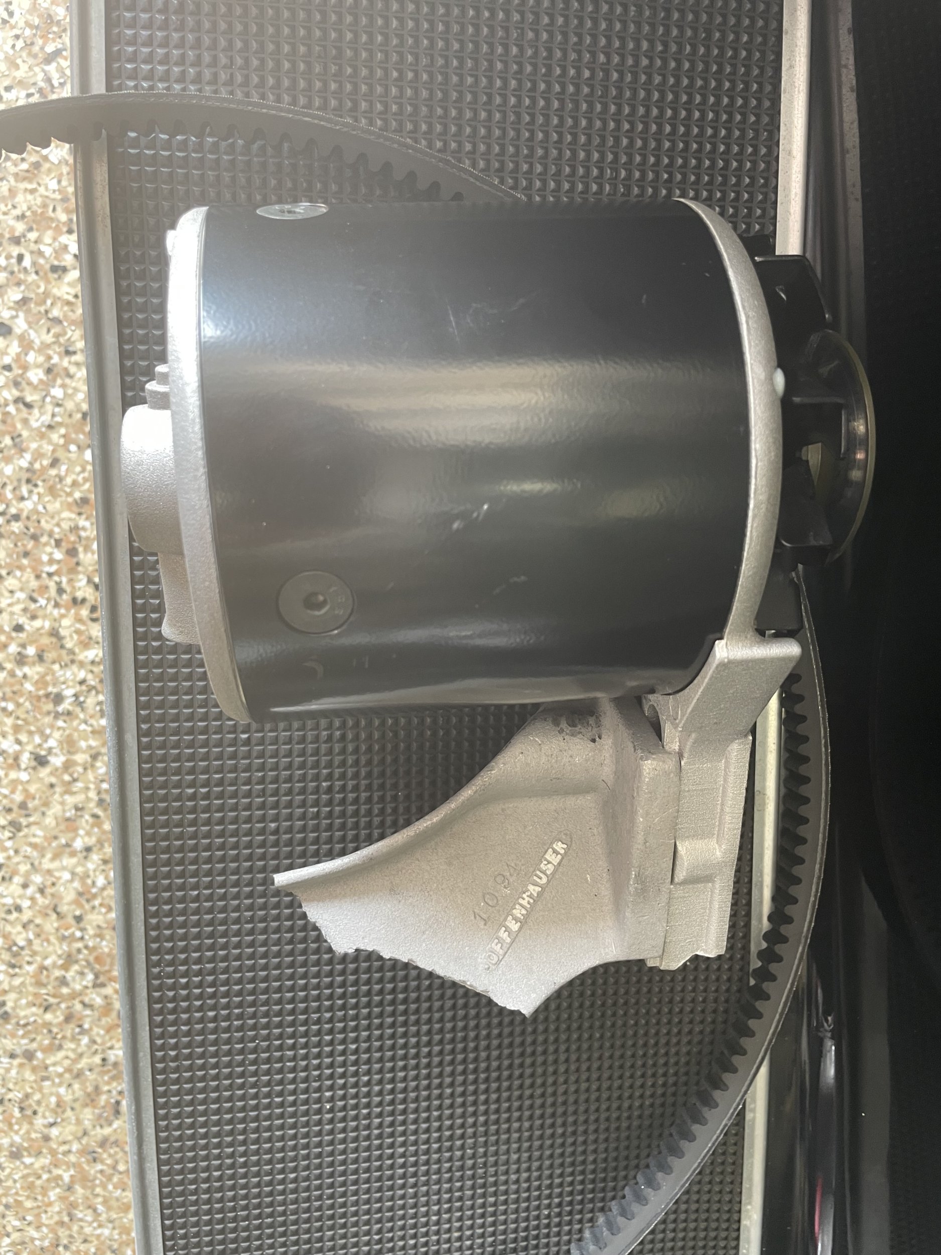

    Running down the tarmac heard a thump pulled over? Gen-set hanging by wires. No belt no water flow towed home. Any ideas! IMG_5302.jpeg IMG_5304.jpeg
  2. Did you happen to initially install it without spacers to keep it above the fins? Am wondering if it was somehow cracked during initial installation?
    Also, how tight was the belt? Maybe you over-tightened the belt and it created a lot of stress/load on the bracket (that would be my best guess). You don't need a lot of tension on these wide belts - many folks tighten them way too much.
    You were fortunate that this didn't cause a big/major issue when it happened . . . the Hotrod Gods were on your side that day!

  10. Fordors
    Joined: Sep 22, 2016
    Posts: 6,736
    Fordors
    Speedway sold the bracket, they had nothing to do with the design or manufacturing. It is an Offenhauser product.

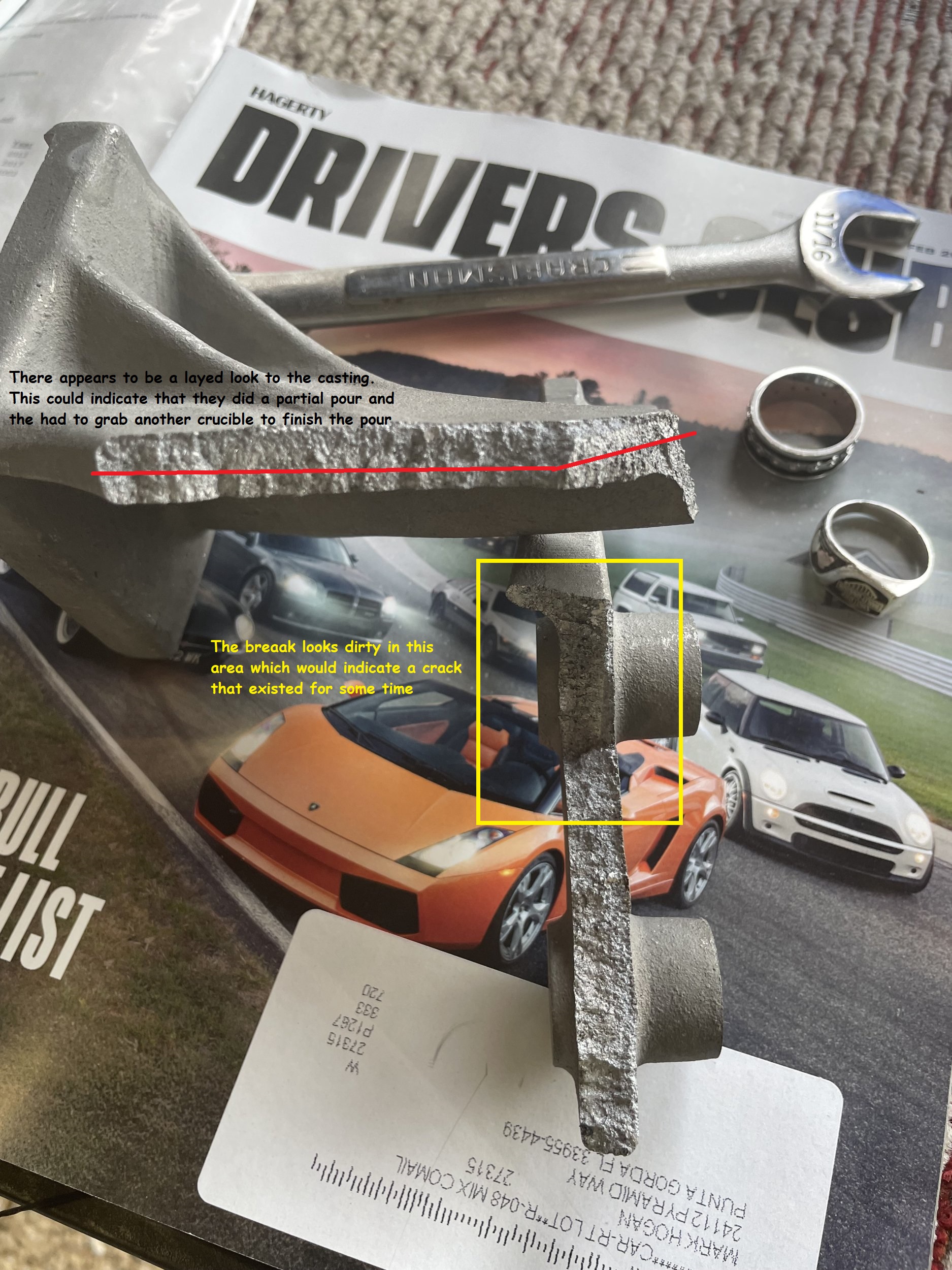

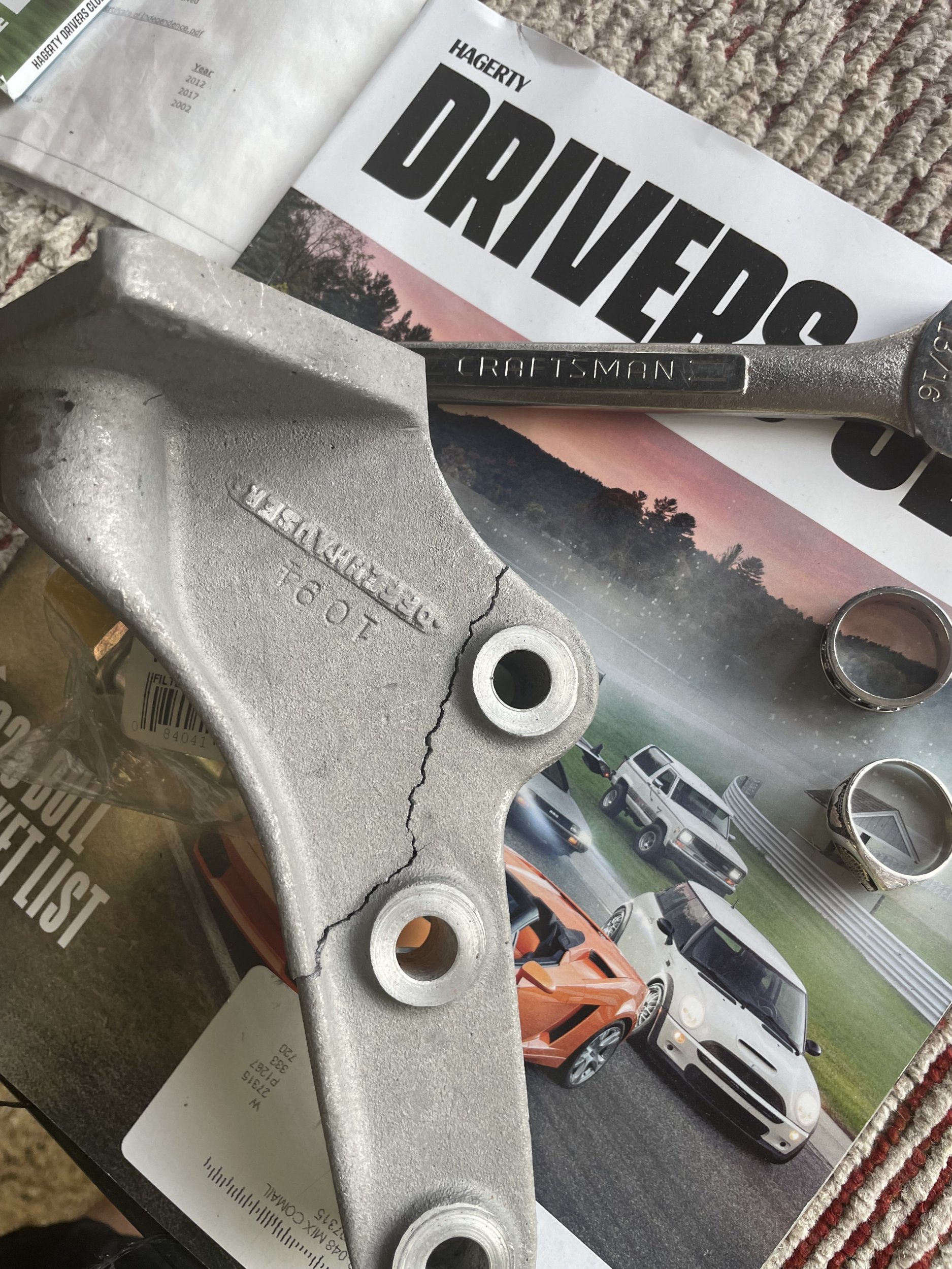

    Show photos of the crack faces. That will show if it was a bad casting to one the had been progressing for some time.
    mark hogan and mad mikey like this.

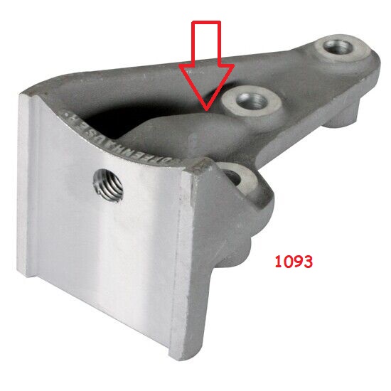

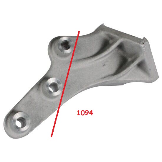

  15. 29Sleeper
    Joined: Oct 25, 2023
    Posts: 700
    29Sleeper
    from SoCal
    Looks like a problem with the mold or design - the 1094 p***enger side bracket has a clear path with no gusset. The drivers side 1093 shows a gusset that would prevent the break.
  16. mark hogan
    Joined: Jul 27, 2022
    Posts: 167
    mark hogan
  17. mark hogan
    Posts: 167
    mark hogan
    Just wondering the brand of the 1093? Looks like way better design !
  18. 29Sleeper
    Posts: 700
    29Sleeper
    from SoCal
    They are both listed as Offy one is to mount the generator on the drivers side 1093 and the 1094 mounts it on the right. IMG_5307.jpeg

  19. abe lugo
    Joined: Nov 8, 2002
    Posts: 3,367
    abe lugo
    The design could've have a raised rib edge and longer gussets. Maybe gussets off the bolts.

    Looks like an alternator in your picture; did that require higher belt tension than the "loose" tension normally used on flatheads. Maybe add a rib to bottom of the new one.
    Stogy, Speccie and Budget36 like this.

  25. Unkl Ian
    Joined: Mar 29, 2001
    Posts: 13,504
    Unkl Ian
    The design is one issue.
    And the alloy used, is a question mark.
    Was it made in USA ?
    Is it a real Offenhauser piece, or a cheapo imported knock off ?
    Not all Aluminum is the same.
    continentaljohn and mark hogan like this.

  28. Fordors
    Posts: 6,736
    Fordors
    Offenhauser, cast and machined in California.
  29. mark hogan
    Posts: 167
    mark hogan
    Amazing the beef put into the driver side arm. P***enger side is a weak design I see.
