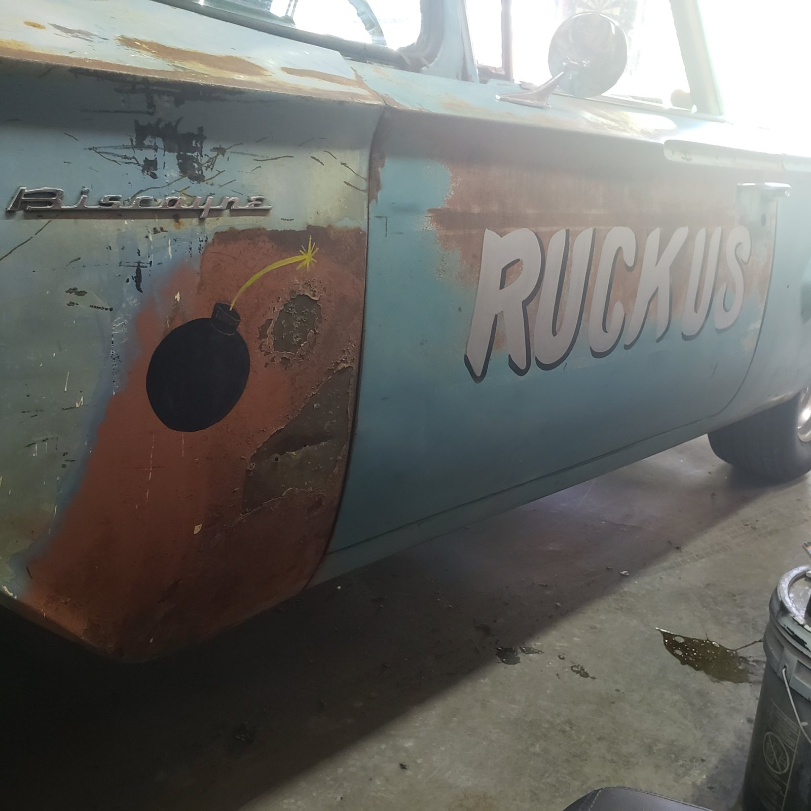

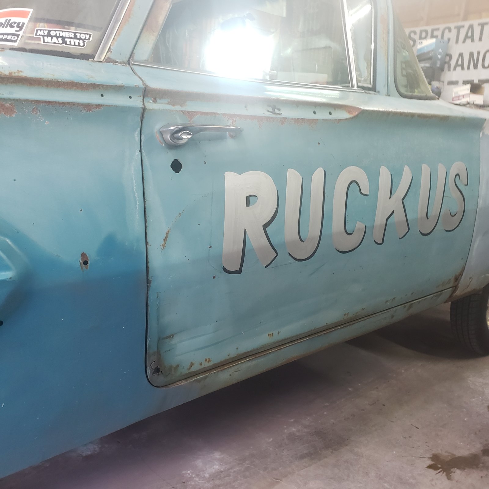

    The "R" looks a little fatter than the rest of the letters...like it might have been an "F" at one time...kind like a tattoo cover-up;):D

    ****, I didn't know it had to be perfect jack! I should've gotten vinyl lettering :rolleyes:

    I Love the Bomb on the fender!!! :cool::cool::cool:

    LOL The lettering is fine buddy...but you aren't fooling us. I just think you started out with ****US...and had second thoughts.:p
