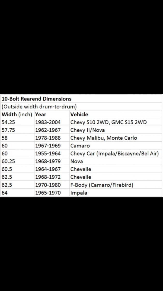

    Doing some reading and found that the 60 impala has a 64" wide rear end. Is there a go to replacement for these or are they able to hold up to some abuse?

    This should help you pick out a replacement rear end
    http://www.carnut.com/specs/rear.html
  27. Budget36
    Joined: Nov 29, 2014
    Posts: 15,370
    Budget36
    A ‘93–‘97 f body is pretty dang close. I a ‘95 rear out back I’ll double check. You’ll have to cut a bunch of stuff off, but should trip over them in pick and pull yards
  28. fastcar1953
    Joined: Oct 23, 2009
    Posts: 4,159
    fastcar1953
    These are x frame cars with coil springs. may be a little harder to find a rear axle. some later models had 12 bolt rears.

    I was wrong, i looked at this again and i had the wrong years. So apparently this is the same as the tri five? 60"? Screenshot_20201119-140854_Gallery.jpg
  30. fastcar1953
    Posts: 4,159
    fastcar1953
    yes but coil springs instead of leaf springs. may have to do a 4 link.
