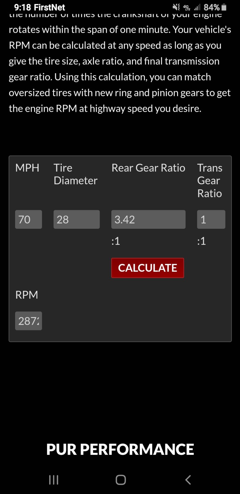

    Screenshot_20230524-091802_Samsung Internet.jpg Pretty much dead on lol. But yeah it's 5000rpm. Guess the video was a bad idea. It's all good fellas. I'll figure it out. I'm not far from fuel injection and an LS :p

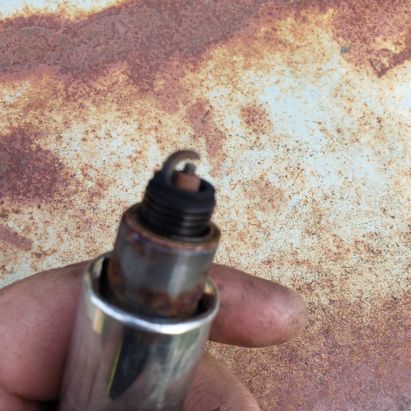

    OK my brotherhood of the hot rod, I have made big improvements today. I stopped and picked up a timing recurve kit for an HEI, But knowing that if I used it, Mark would take me out of his will, and I don't want that to happen. So at the recommendation of a few, I unhooked the tachometer and went for a ride, no difference. Then the words of @Johnny Gee kept ringing in my ear, "what's the plug gap big daddy?" So I pulled #1, it was at .045. But I noticed that my burn pattern on the plug was WAY further than it was the other day, way past the turn on the ground strap, I'll attach a blurry picture, but the plug was hot and burning my fingers... so I grabbed my timing light and went at it, 14⁰ initial, 36⁰ all in. I dropped it back to 12⁰ initial, and went for a drive, hell yes! Progress! So I pulled back in, grabbed the light, and set it at 10⁰, reset the idle mixture screws and went out again, 6000 rpm like nothing, minimal stutter, and still if I lift just slightly it goes away. I'm gonna drive it to work tmrw and if I get time I'll gap the plugs at 35? See how it does coming home Saturday morning. Track opens at 10, time runs start at noon. Feel like I'm making progress now though :D

  17. 427 sleeper
    Joined: Mar 8, 2017
    Posts: 3,371
    427 sleeper
    You got plenty of fuel. Try going down one size and see what it duz. ;)

  20. 427 sleeper
    Joined: Mar 8, 2017
    Posts: 3,371
    427 sleeper
    Yup... It's pretty sooty on the outer ring.
  21. tomcat11
    Joined: Mar 31, 2010
    Posts: 1,150
    tomcat11
    You're a little rich big daddy. Watcha got there?

  25. lippy
    Joined: Sep 27, 2006
    Posts: 6,856
    lippy
    from Ks
    I'd take a fresh set of plugs with you and throw em in at the track. Run it thru the traps and kill it in the lights and throw it in neutral and coast around the corner. Pull a couple of them and have a look. And take a pic and post of course. Take your jets with you. And don't run any octane booster it will color them. Once you read em then throw the **** in the tank:) Lippy
