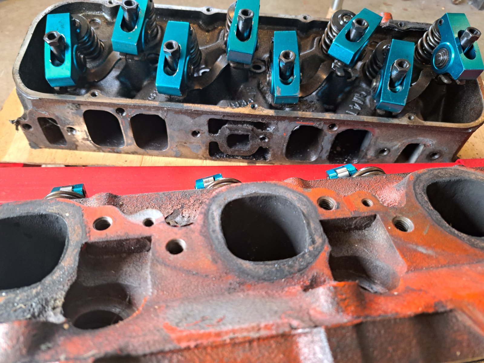

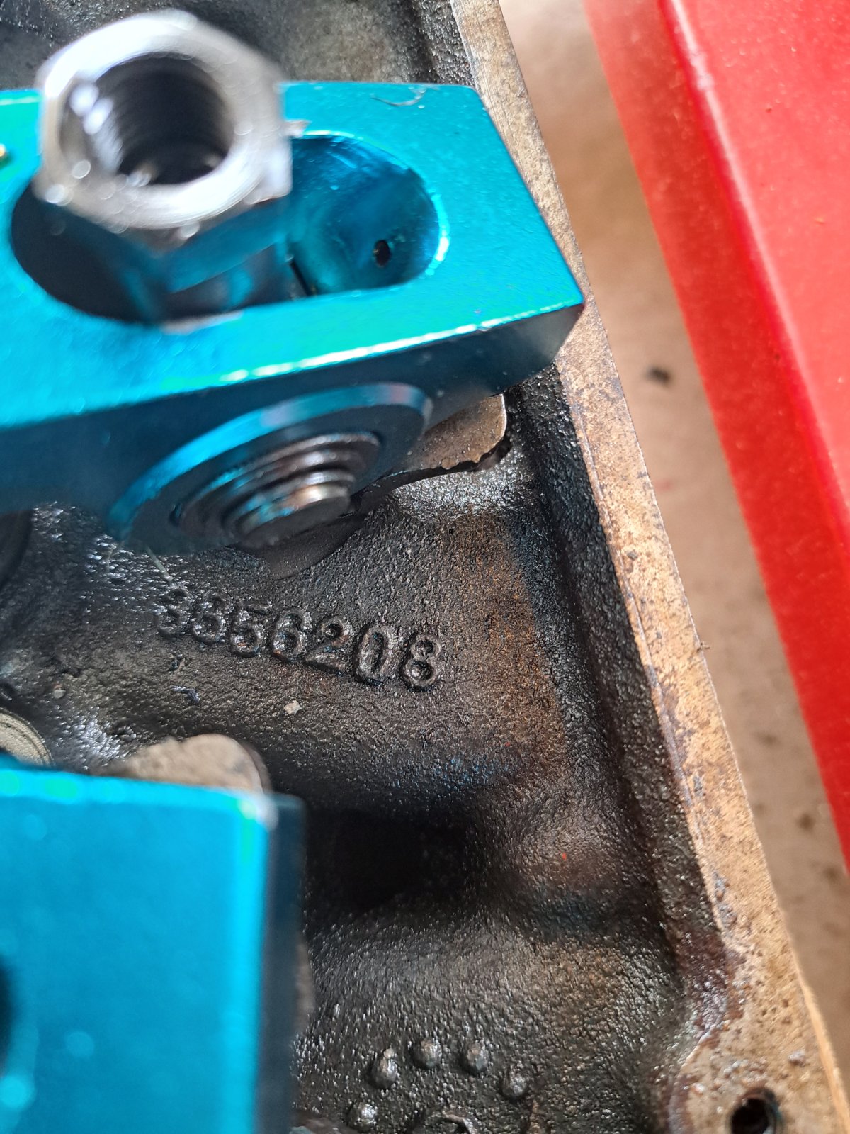

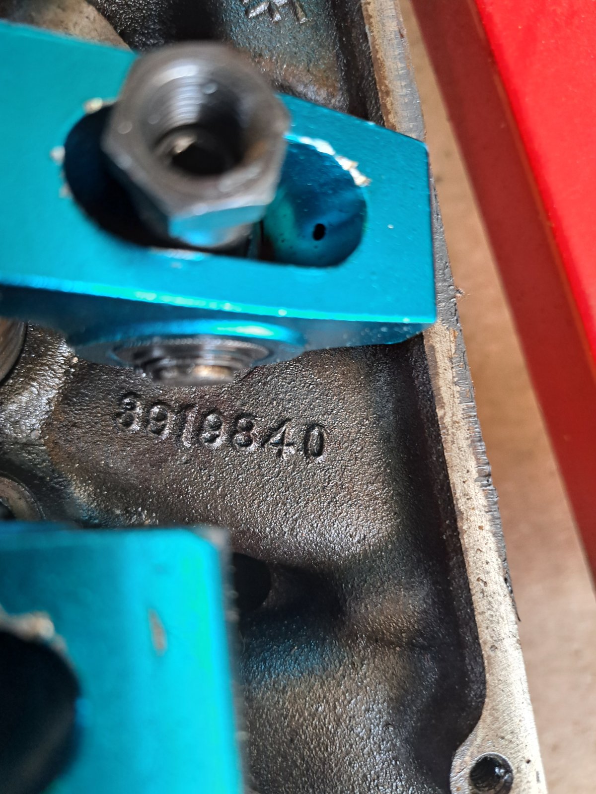

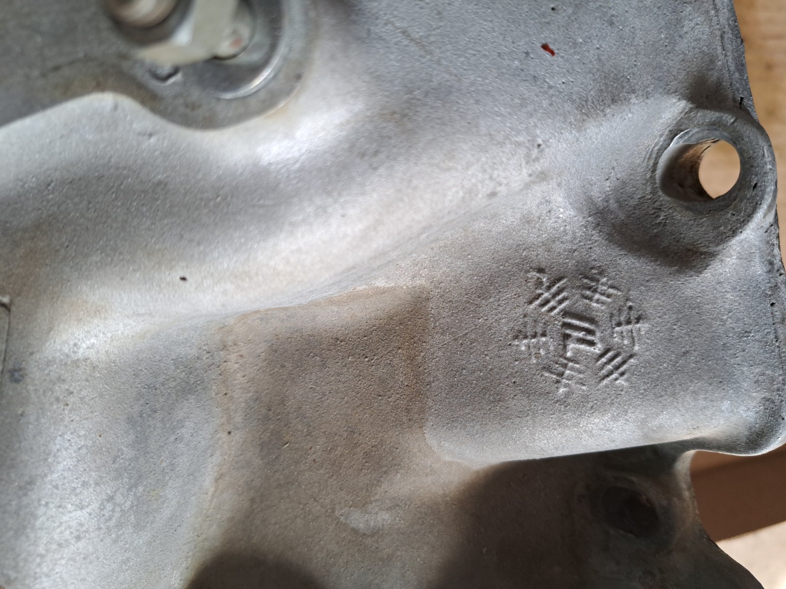

    20230525_165705.jpg 20230525_165730.jpg 20230525_165803.jpg No, sorry I did not mean that. There is a Winters L88 427 intake, as well as the heads from the 396.

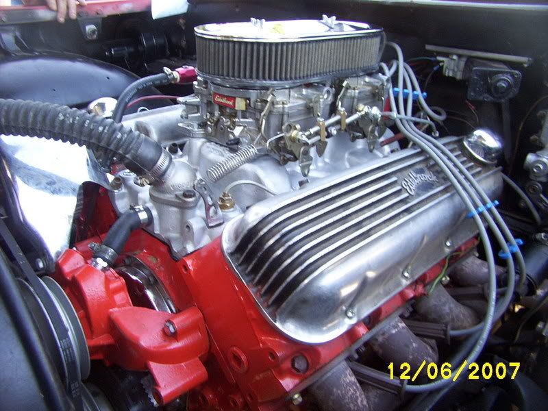

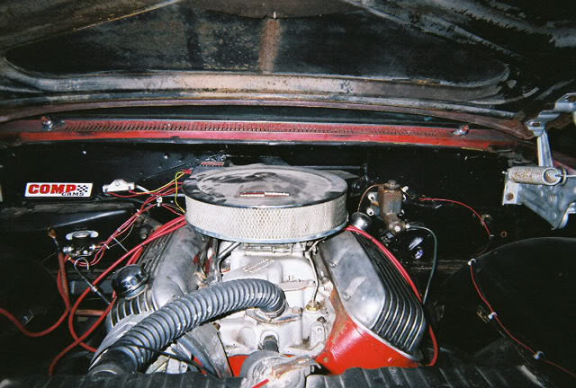

    LLoyd, Here are a couple pictures of my 427 sitting in my 59 El Camino over the years for inspiration. It was actually a 454 with a 396 Crank and L88 Pistons, but I never told it that when I Hammered on it.

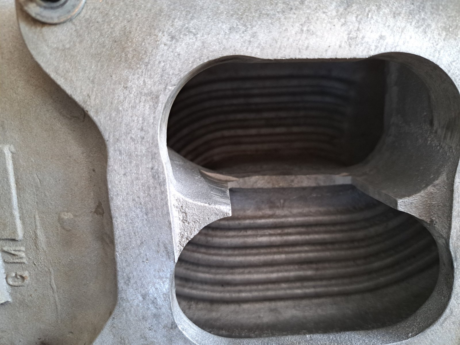

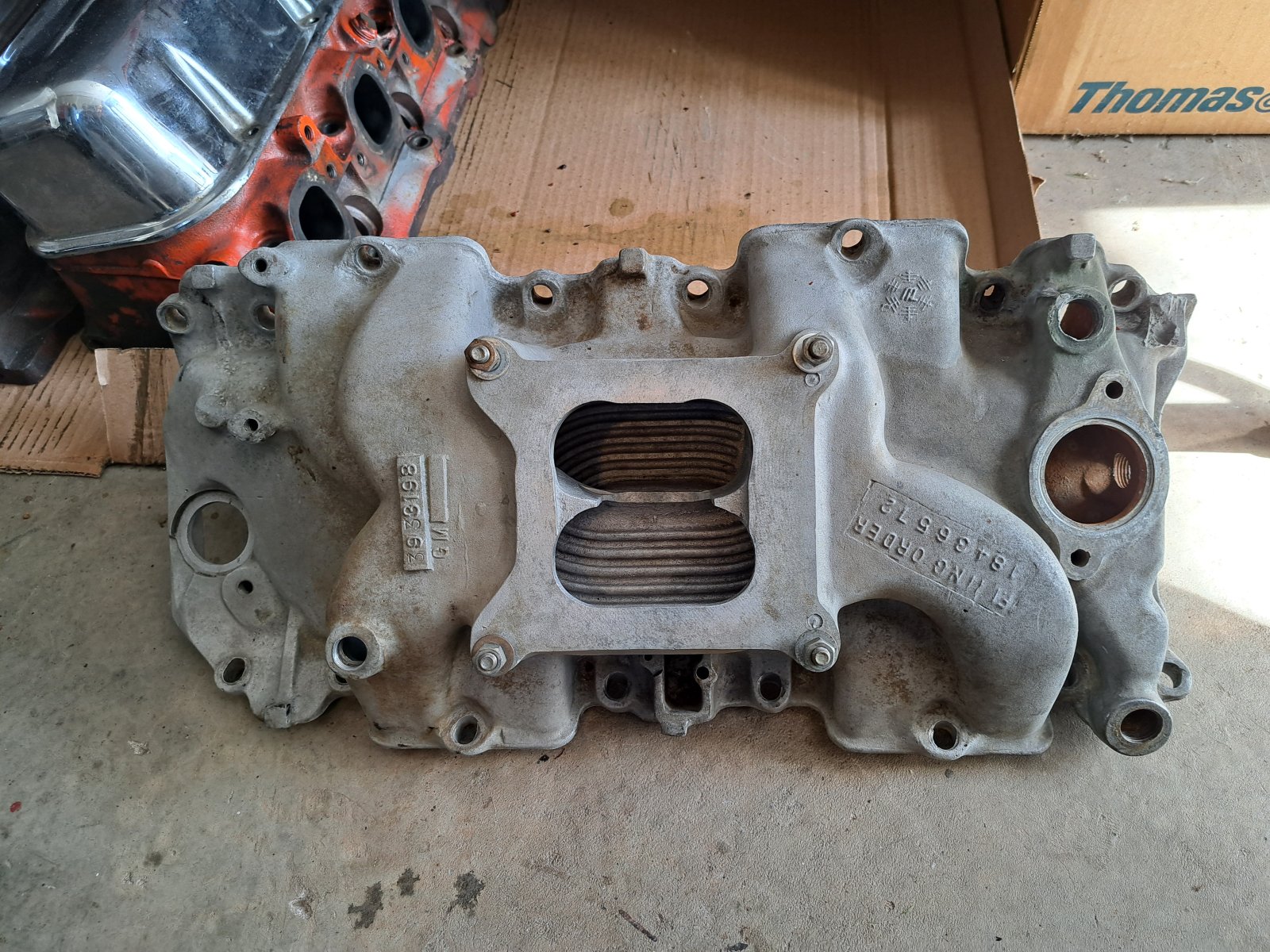

    20230526_164445.jpg 20230526_164451.jpg 20230526_164452.jpg 20230526_164457.jpg 20230526_164500.jpg 20230526_164506.jpg here's the intake, alternator boss broken, so mount it on the other side or low mount. Vette guys say it isn't worth much because it isn't uncut. Guys, what's a fair price for this stuff?

    Well I’ll go 150, but Chevydude has to cover shipping;)

    real L88 manifolds did not have a center divider, so that one is uncut. real corvette guys should know that. I think a fair price for the intake and heads would be 2 tickets to Lloydstock!!

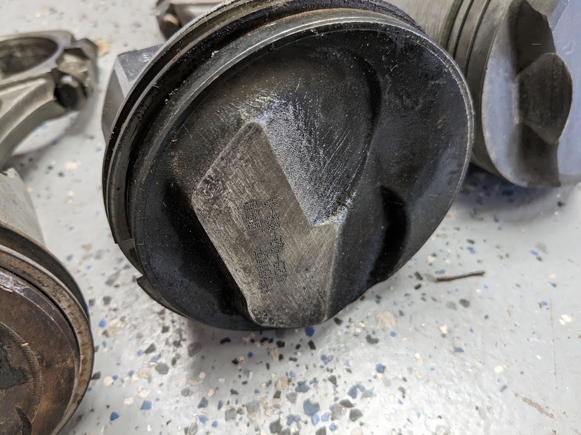

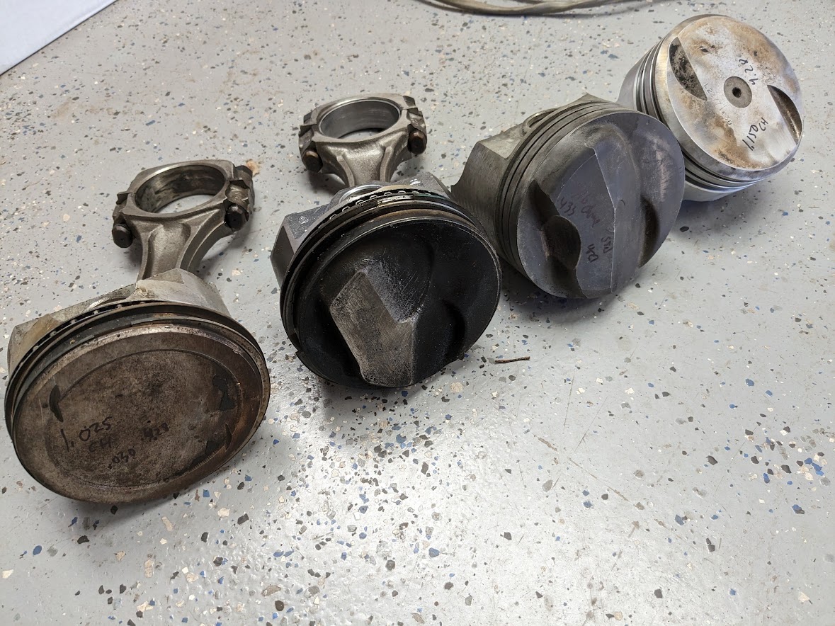

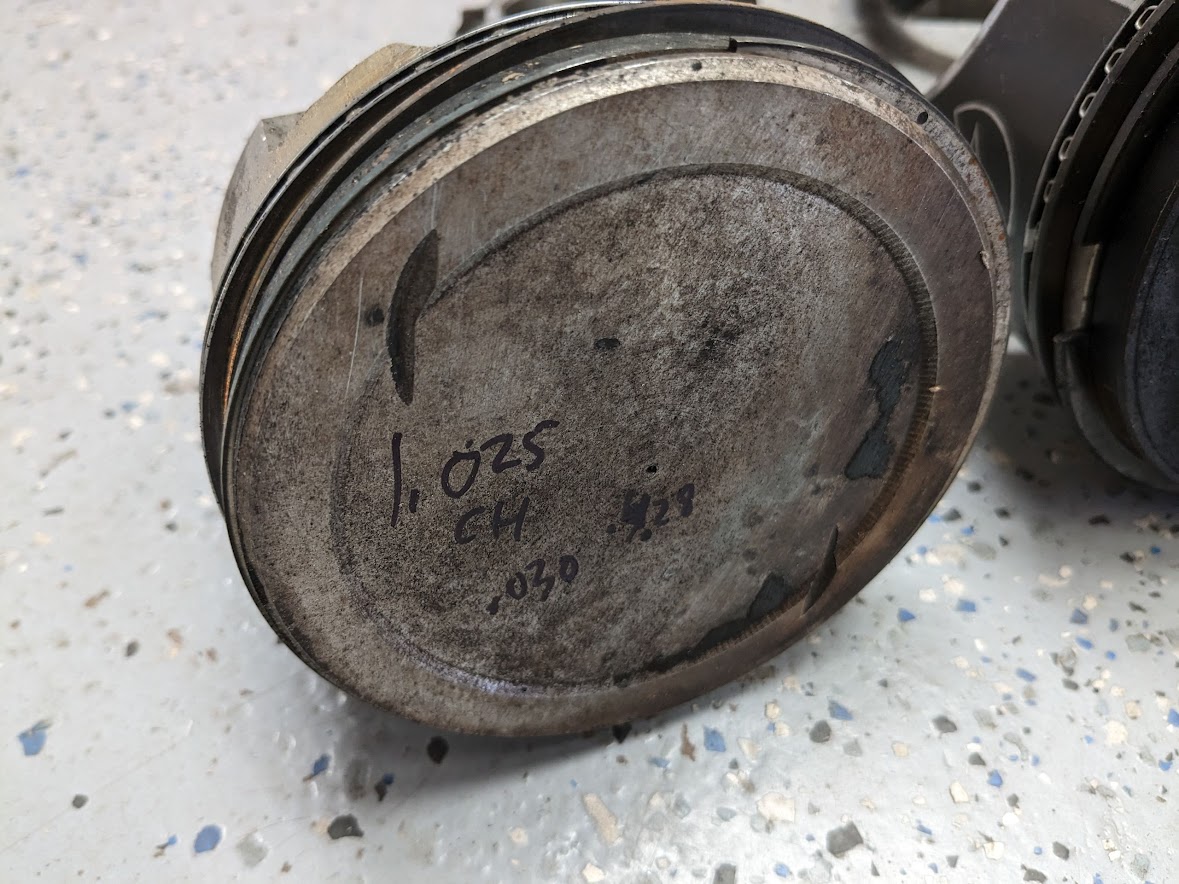

  27. squirrel
    Joined: Sep 23, 2004
    Posts: 60,034
    squirrel
    Not sure that any of this will help...as usual.... :)

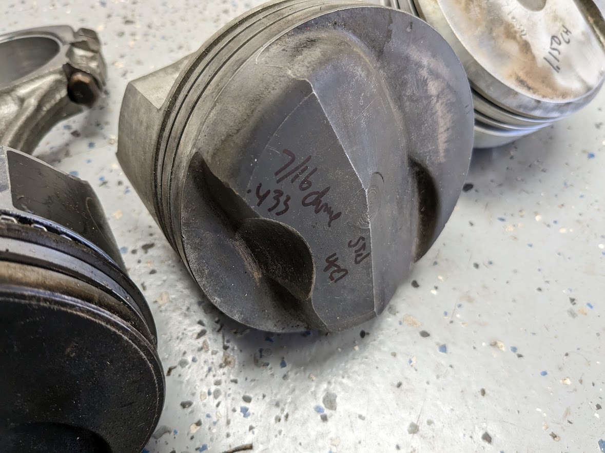

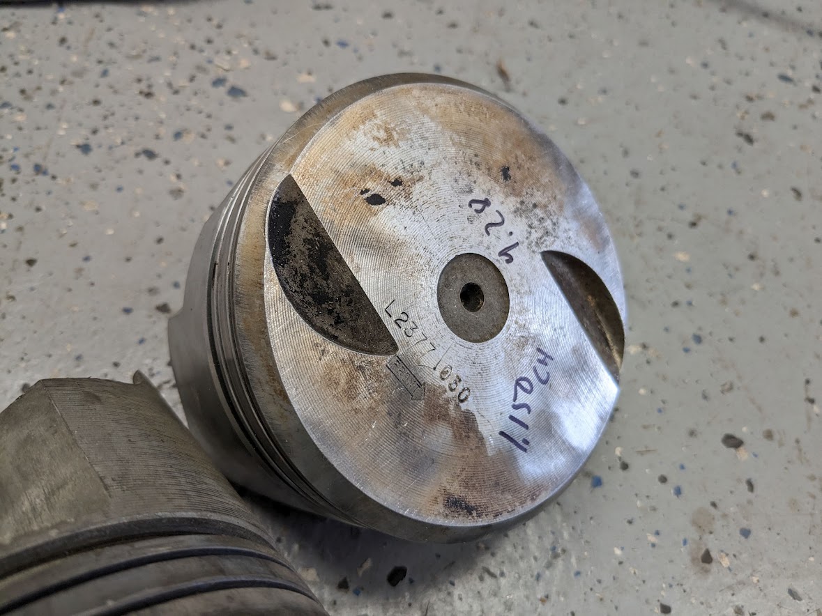

    a row of pistons
    flat tops cut down 1/8" to make a 496 stroker. Not much dome thickness left, and you'd need a 1/4" stroker 454 crank.
    hyper .060 oversize .340 dome
    original L-88 I think, you'd need a 396 crank and good fuel for these! plus a standard bore block, which is hard to find.
    Flat tops. 030. I have a block to put these in, to make a normal 454 with. You'd need closed chamber heads to get compression with them, but if you could find some early rectangular port closed chamber heads, like off a 375 hp 396, they'd be great.

    My machinist offered me a set of .030 flat tops, but I'm gonna stick with the heads i have. I believe he told me speed pro domes are $330, bore size doesn't matter.

  30. Lloyd's paint & glass
    Joined: Nov 16, 2019
    Posts: 10,905
    Any reason not to run these pistons? Screenshot_20230603-092439_Samsung Internet.jpg
