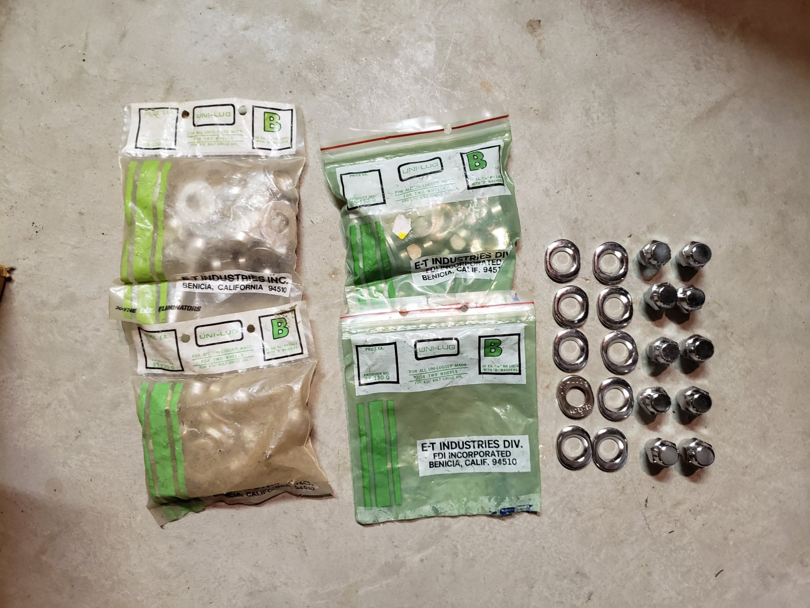

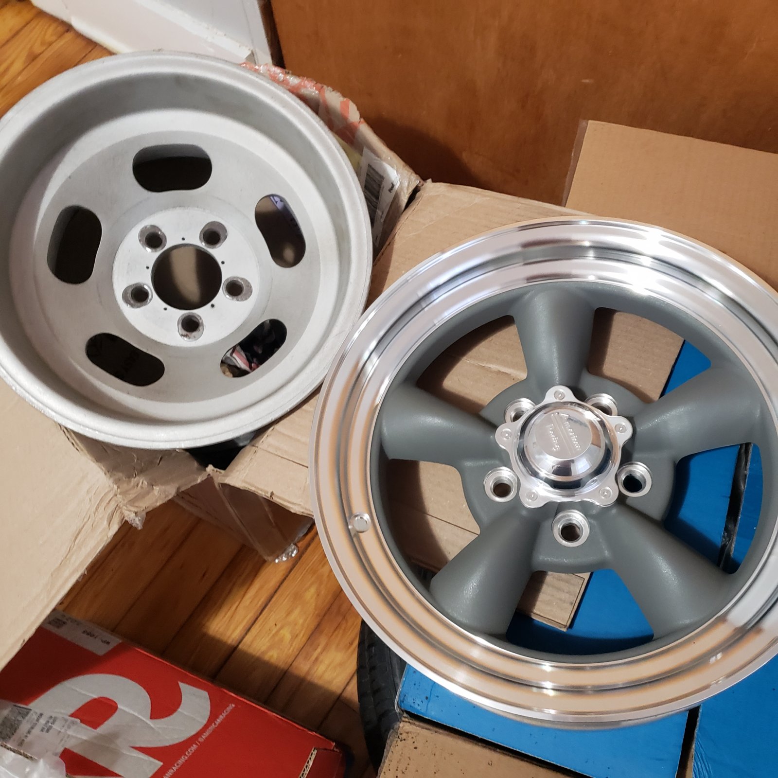

    I am a bit relieved, bought a set of slots from @Radicalratrod , thought they were Ford, but they have the oval washers, so turn the washers around and they're Chevy. So, if the rear end in the car is worthy, I still have wheels! Oh and the American racing TT2 showed up, I don't hate them. I have the feeling that I can learn to live with them :D 20240710_204625.jpg 20240710_204707.jpg

    Those slots are ET's. you have to use ET lug nuts with those

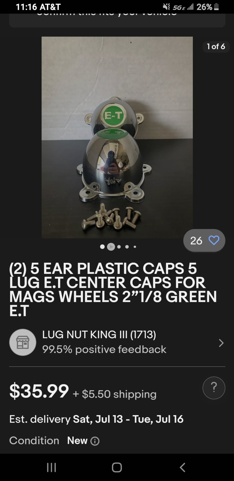

    That means he needs a pair of center caps. I think they look like this. upload_2024-7-10_21-56-23.jpeg
    Came off the 14s on one of my boat trailers. Won’t work with bearing buddies.

    Lol I immediately jumped to Google after Mark said that! Yeah they're available. Scared me though lol

  20. Those E-T wheels use different washers for different bolt patterns. What you have are 4 1/2" & 5" when flipped. 20230323_120444.jpg
    These are GM 4 3/4" NOS but you can still buy them from Team III wheels I believe. They come washers with the correct lug nuts.

    That's what Moriarity told me, said that the hole in the middle is 4 3/4". Thanks for the help, I'll order some :cool:

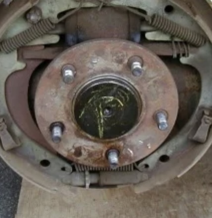

    I borrowed a picture from Boston Camaro on an earlier thread, this is his 9.3 axle

    Not Olds/Pontiac brake drum.
