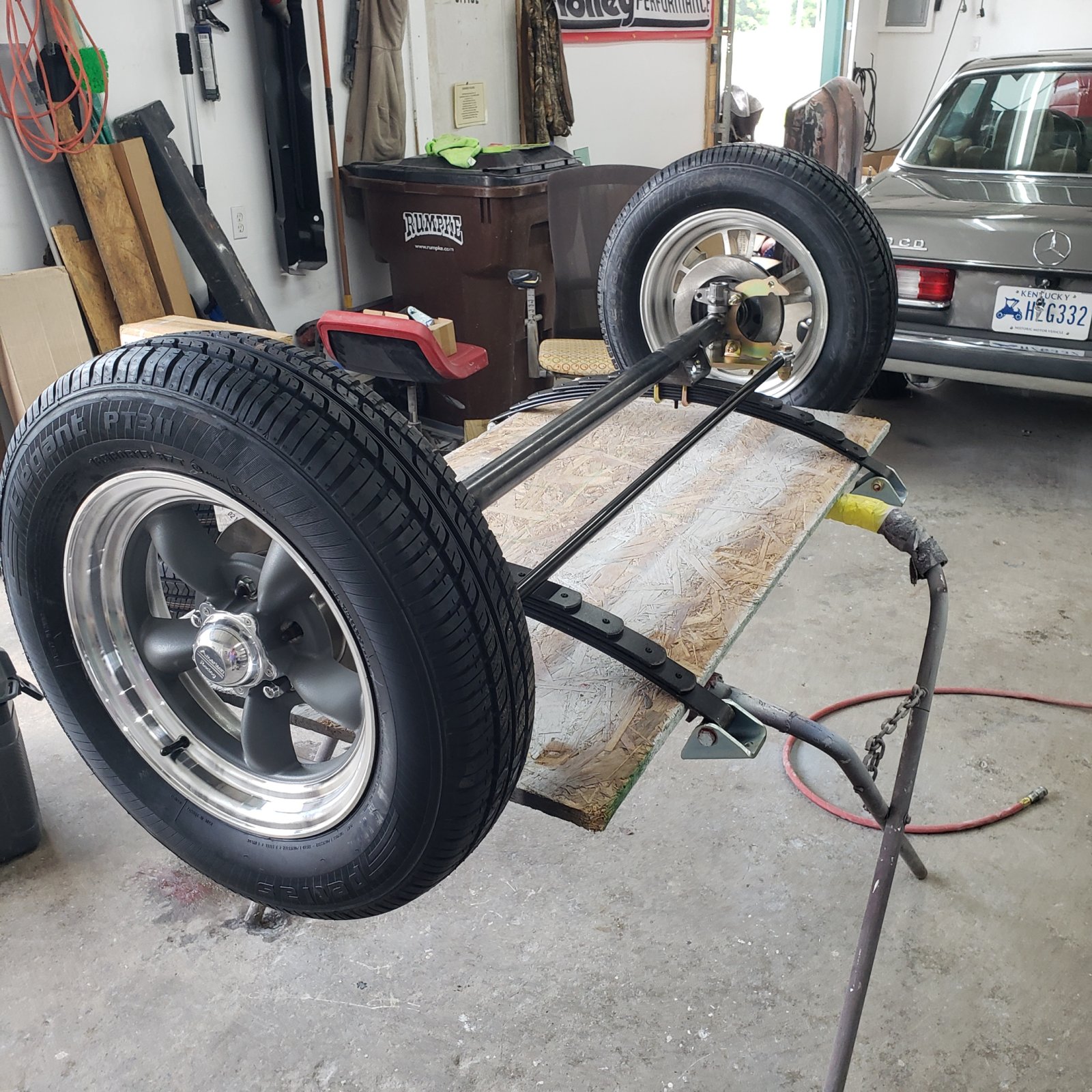

    Took a few and threw the axle together. Caster isn't set before anybody asks lol. Just tacked so I can put it under the car. 20240726_162550.jpg 20240726_162604.jpg

    Looks great...be sure to flip over before you install it;)
    By the way, I believe you are right. Everything I've read indicates the shackles work best on the rear of the spring.

    Joined: Nov 29, 2014
    Posts: 15,368
    Budget36
    I always thought so as well…for stability.

    Just because........I used a front axle from a 51 Chevy Truck. Chevy seemed to think the shackles worked best in the front. Others used axles from Ford vans. Ford seemed to think they worked best in the back.
    Many have noted it really didn't matter much either way and based upon actually factory set ups that seemed to make the most sense to me.
